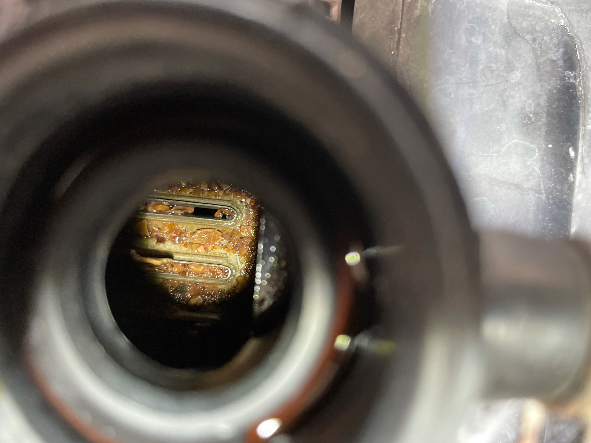

Old Jun 7, 2021 | 04:00 PM
/\/\ike's Avatar
Joined: Jul 2017
Posts: 6
What is this!? I also took the top line off and you can see some sort of thin brown flaky material lining the inside of the part of the motor where the hose connects...

New rad, heater core and fluids doing that in a a year, strange, definitely need a couple flushes. maybe the PO was running it on Tap water or pond water?, I don't think mixing green Ethylene Glycol with Toyota Red would do that, toyota didn't use the Red Ethylene Glycol till 1999.
I noticed yesterday at 95*F outside temp, AC on, while climbing big hills, on my scangauge my temp was up to 215* but the dash temp gauge was below half still, I normally run 193*F rock steady, but yesterday my trans and rad temp hit 200-215 a couple times.
Definitely odd, it does look like tap water or that they overheated and threw pond water in lol. Will report back after flushing and swapping radiator.

Bear in mind, it might take more than one flush to get all that rust out. Maybe one with a flush chemical of some kind, and then a few with just clean water. Then replace the radiator with a nice CSF 3 core all metal one.
Maybe the thermostat, too. I hate to think how much crud had collected on it. Same with the hoses. How much of that crud has collected in them? That stuff is pervasive (my big word of the day!). You MIGHT even want to do the water pump. Or at least take it off and rinse it out with the garder hose and a spray nozzle, you know?
