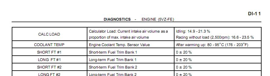

According to this link the water is just fine.
http://www.ncttora.com/fsm/1996/SIL/...zfe/preche.pdf
Attached Thumbnails 185 Degree (F) ATF Temps with cooler in 90 (F) degree outside temp, is this normal?-coolant-temp.jpg
Old Aug 1, 2010 | 09:13 AM
mt_goat's Avatar
Joined: Nov 2002
Posts: 10,666
Likes: 5
From: Oklahoma State
Originally Posted by nexgen91
... I asked the tech who did the timing belt and they put in a 190 degree thermostat, which seamed kinda high, is that the stock temp??
Stock is 180, I run a 160 myself. That being said, 203 isn't too bad, just at the top of the normal range.
