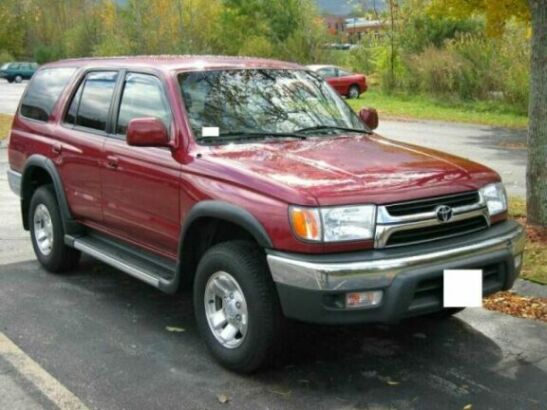

Old Oct 15, 2003 | 01:01 PM
Matt's Avatar
Joined: Oct 2002
Posts: 91
From: Massachusetts
Recent pic...

I got your e-mail... did you want me to post the pic, or is the attachment you posted fine? The pic I have is the same angle, but it is a bit sharper (not as blurry).
Old Oct 16, 2003 | 03:52 AM
Matt's Avatar
Joined: Oct 2002
Posts: 91
From: Massachusetts
jacksonpt,
no need to post the pic I emailed you. I finally shrunk down the one that's posted. Thanks though.
