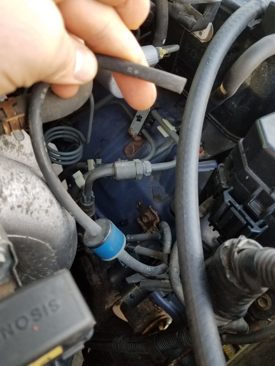

Here is the hose in question if it helps.
Nubs

Can you take a pic a little farther away?, especially the EGR vacuum modulator.

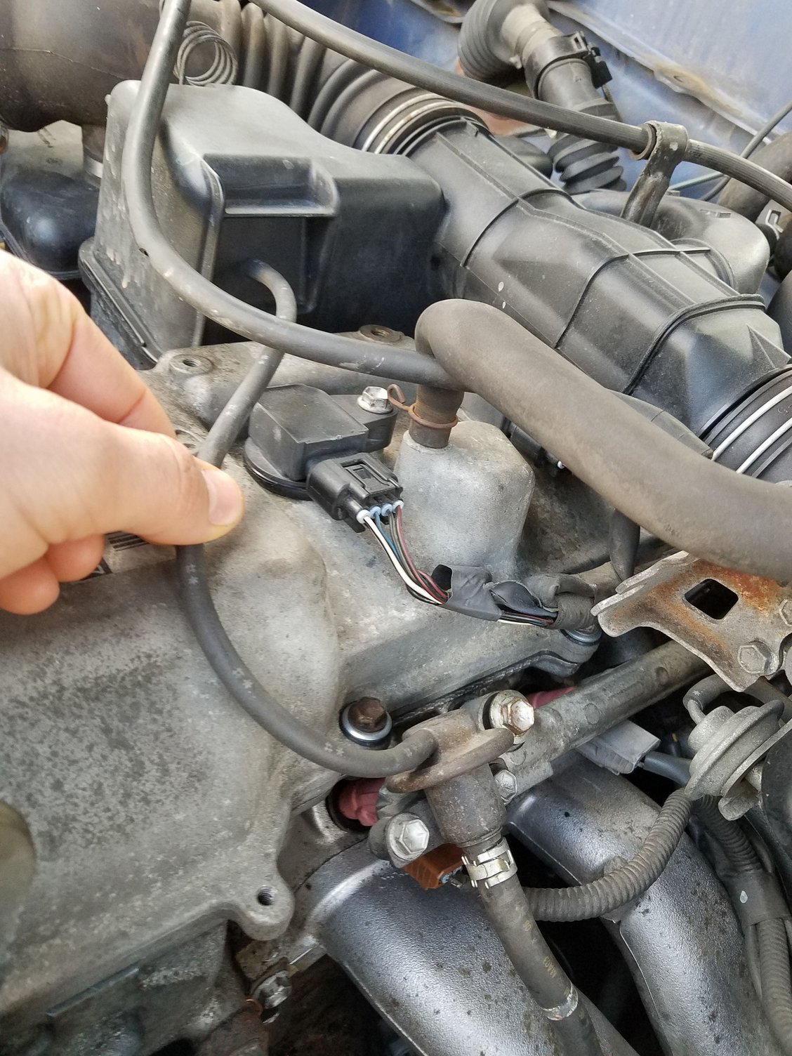

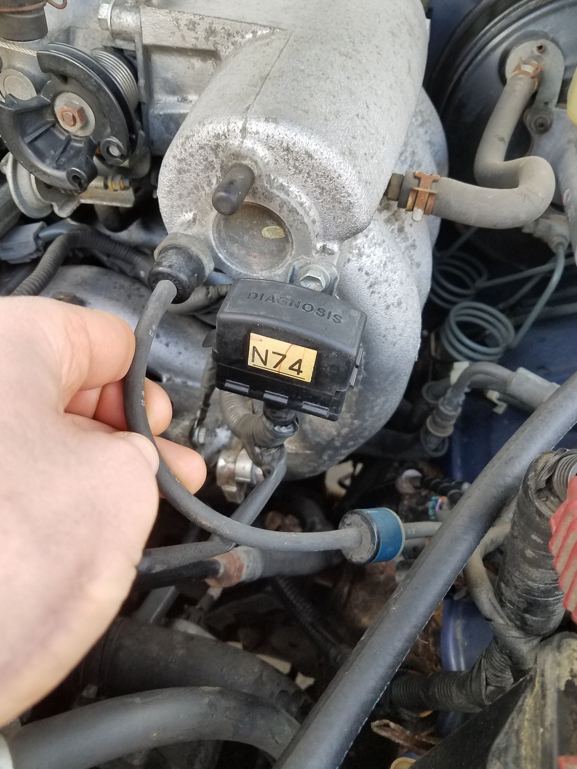

I figured it out earlier today. I attached the line off the front of the fuel rail to the front of the manifold instead if the intake box, and the 4x4 vacuum line was not connected. Shown is the proper routing. I had this attached to the front of the manifold.
Where the 4x4 vacuum goes...
