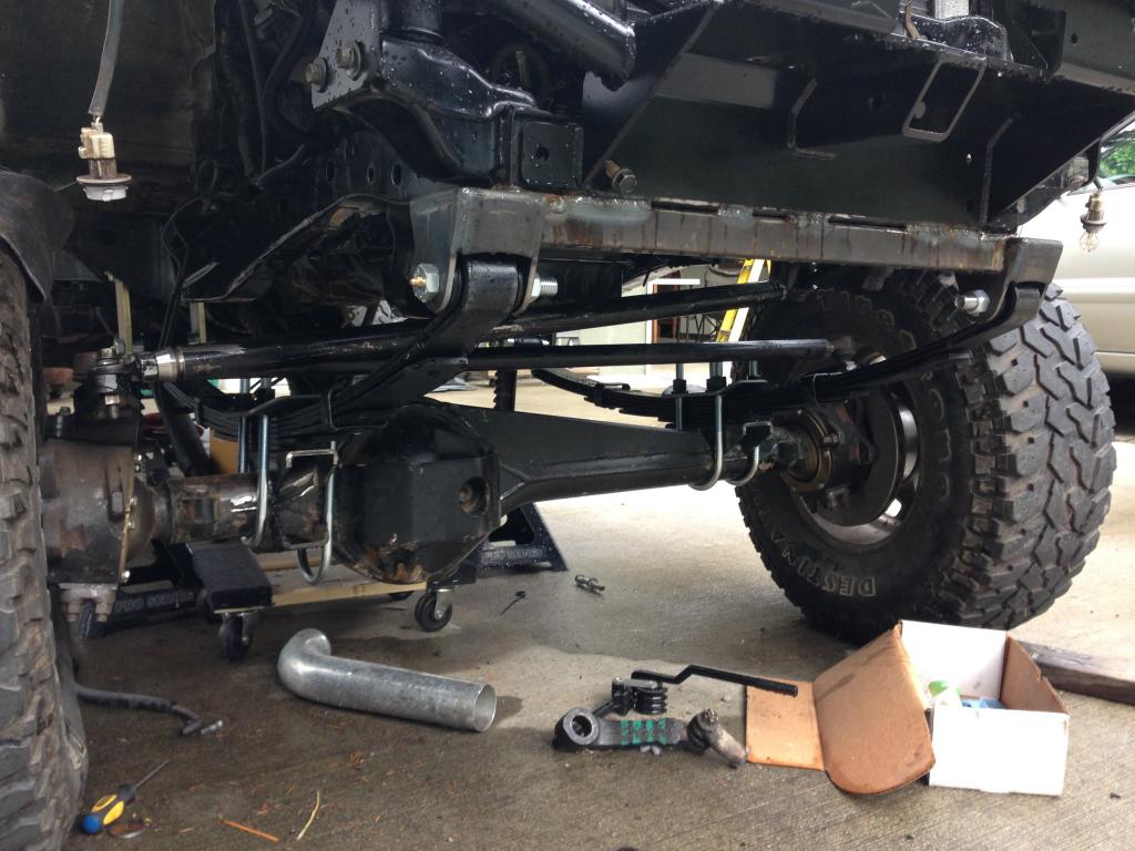

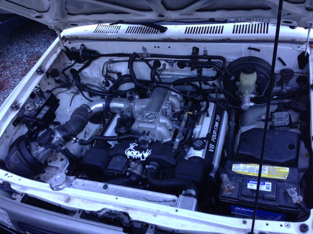

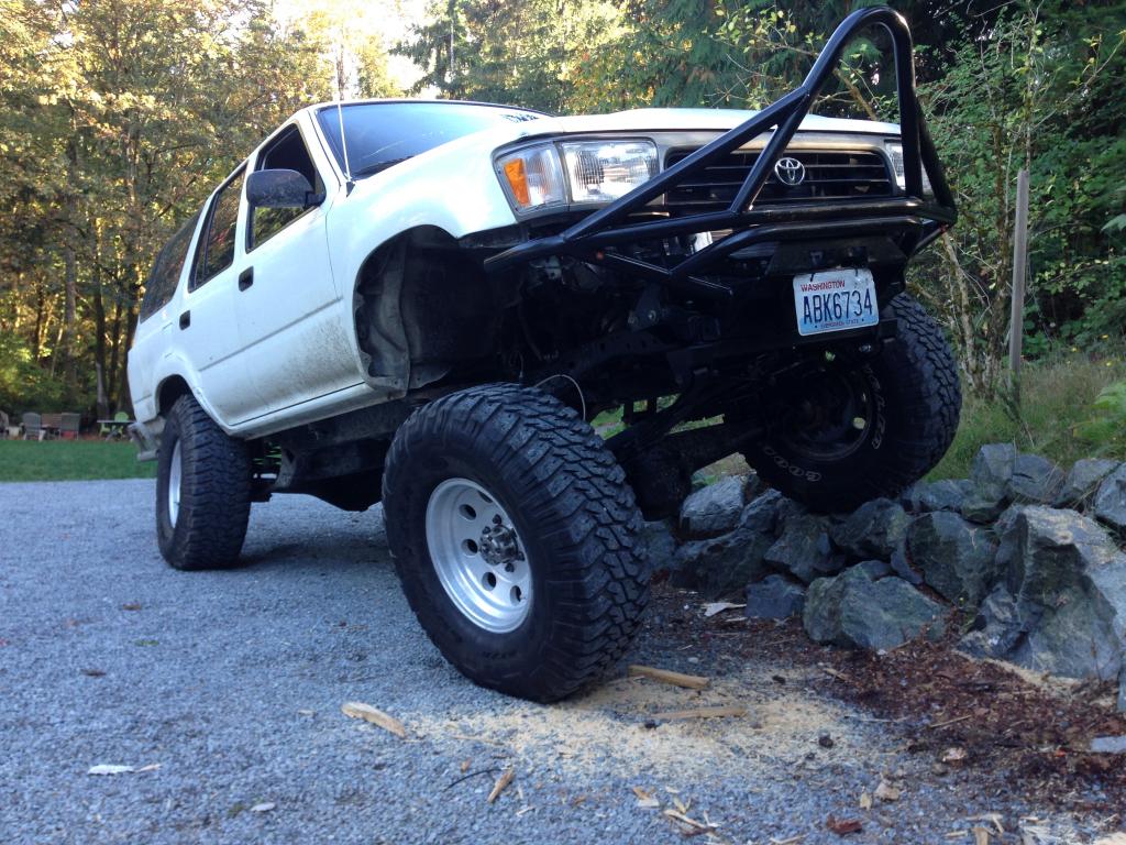

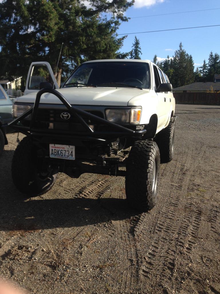

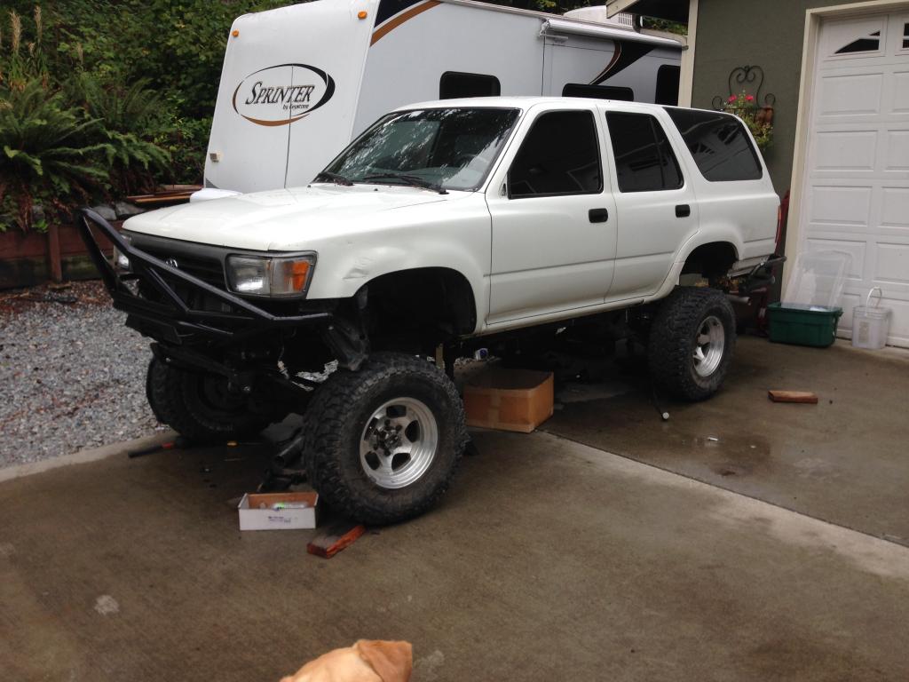

So I ended up exchanging the 3 link and bought the leaf sas kit. This was more in my budget and a lot easier. I finished up everything, got the solid axle under it and put some 35" MTRs. I had to shorten my rear driveline, make exhaust, and a few other misc things. I finaly test drove it the beginning of September and its a blast to drive. The power and acceleration is defiantly worth the hassle of the swap. I have 4.30 gears in now and it doesn't seam like I have 35s. I can cruise up hills in 4th and 5th gear no problem. I will take a video of acceleration. Ive taken it on some trails, nothing crazy because i don't have 4x4 yet. I need to finish extending my front driveline and match the rear end gears to the front. I figured this was a perfect time to install the new elocker. The swap has given me no issues so far, I have no check engine lights, no overheating issues, everything seams great and Ive put around 2000 miles on it.

The lift did turn out to high, I bought the 3in TG leafs but its taking for ever to settle. For gas milage is 16-17 miles per gallon this is mostly city and some highway.
