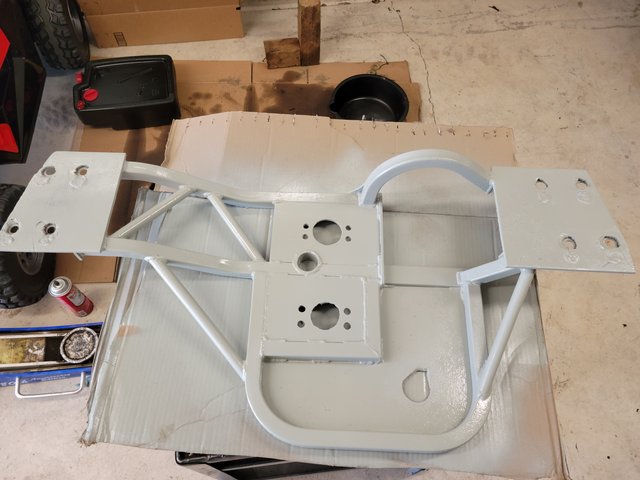

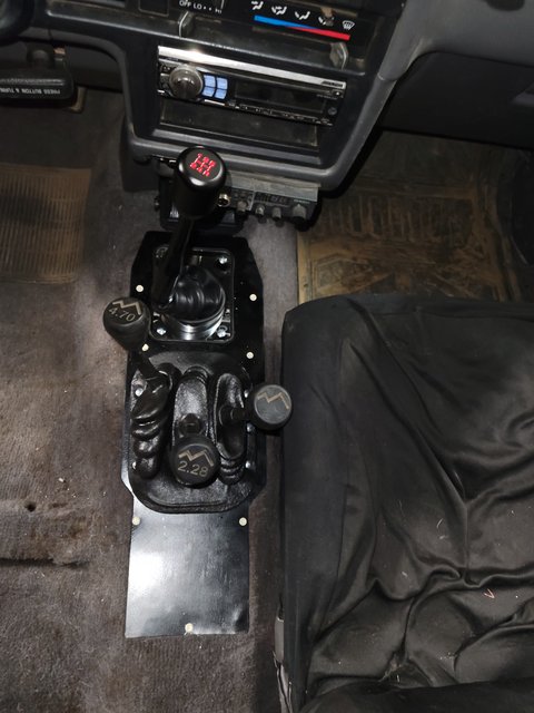

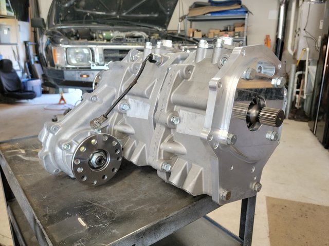

Cleaned up the trans to t-case adaptor and got it installed on the cases.

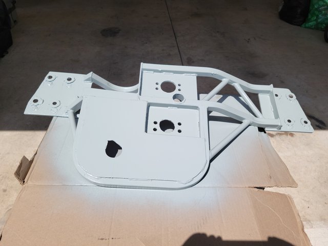

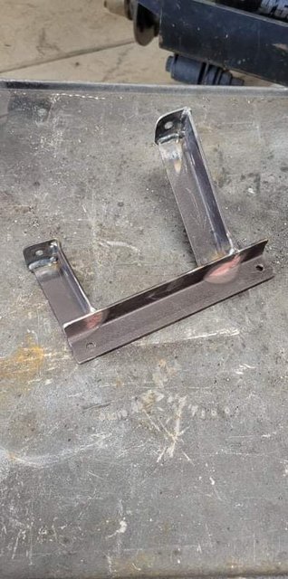

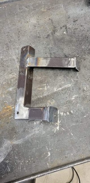

Then I set myself to modifying the cross member. Originally there wasn't a spot to access the crawl box's drain plug. Mainly because it was right above the 1" square tubing that was the backbone. With some careful measuring, I figured I could save one side of the tubing and out came the hole saw.
Then I cut a piece of tubing that would fit and give all of the structure back.
I welded it all up...
And gave the whole thing a fresh coat of industrial gray paint.
It's been pretty warm, so everything should be dry now. I will bolt up the cases to the crossmember and get it all back in the truck this week.

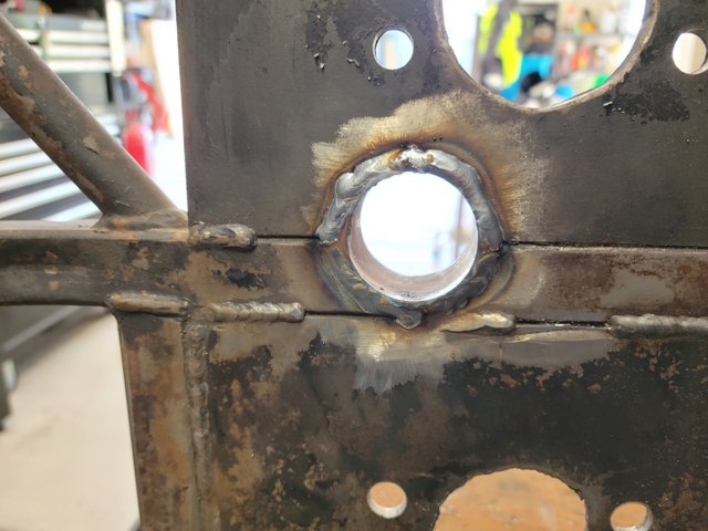

Are those welds 'spozed to be smooth like that?!
j/k. Nice work.

I actually wasn't very happy with the look of the welds. I should have taken a bit more time and planned my travel. But they are strong. :shrug:

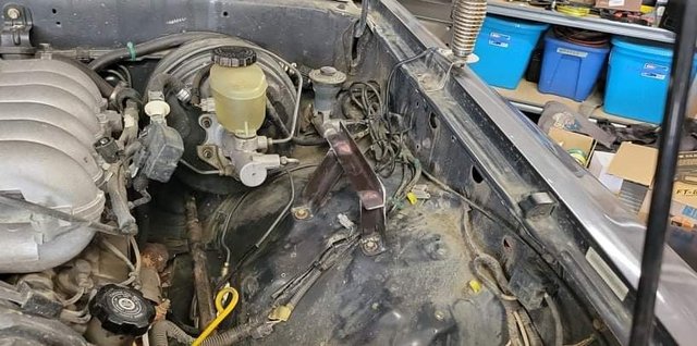

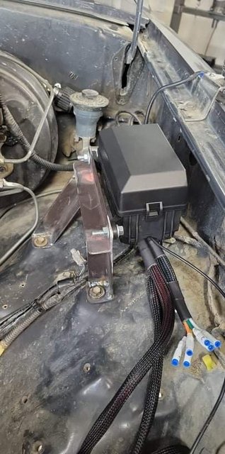

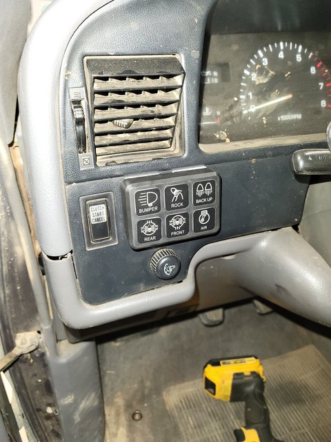

And finished up my aux switches and wiring the lights. My air compressor is on backorder, so that didn't get installed. Air lockers will be happening in the future, but I got the switches all set up for them. But my bumper lights, rock lights, and back-up lights are functional.

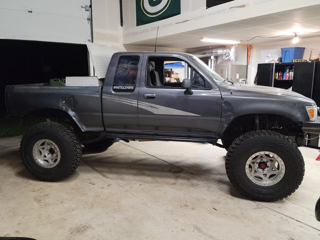

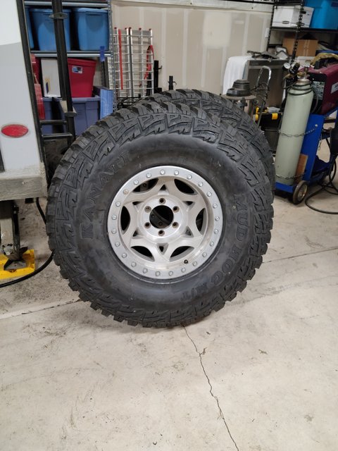

And I finally got my wheels and tires back last Thursday. I must say, these ended up being a poop show... That being said, the shop that was doing them (Bones Custom Creations in Oregon City) really bent over backwards to get them to me as quickly as they could. They are stand up guys and I really appreciate all of the hard work they put in... And they look amazing!

2) The nasty noise that I thought was a throw-out bearing is still there. However, it is also load dependent (like a u-joint). I replaced the u-joints already, so I'm at a loss to what the noise is. Maybe a pinion bearing? It sounds like it is coming from the trans area, but it could be. I can't think of anything in the trans that would be making noises like this. The t-cases are new, so that wasn't the issue. My thought for now is pull the rear driveshaft and drive it around in front wheel drive and see if the noise is still there. I'm really not sure what the implications are of this if I just ignore it.

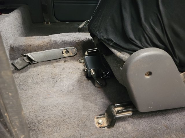

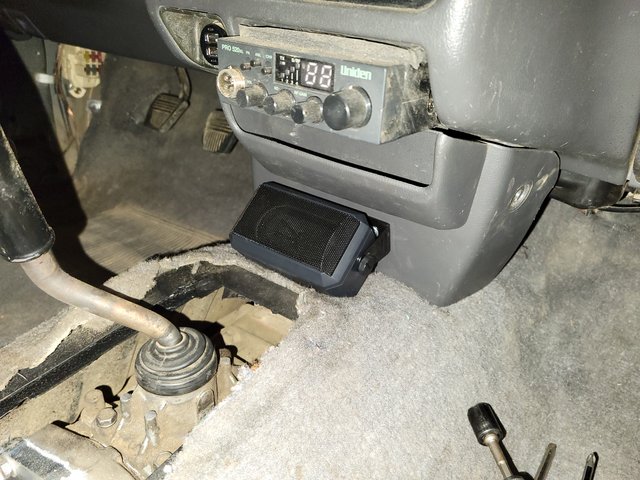

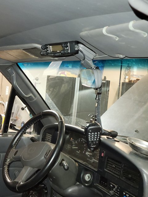

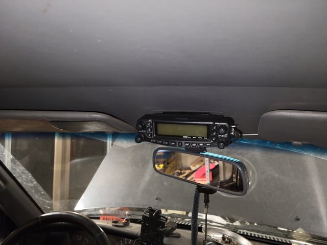

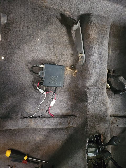

3) My fancy ham radio won't turn on. I'm really hoping it's the cheap Chinees cable I used for the remote face.

looking at the wiring for your ham radio under the seat it looks like the red wire might be tweeked at the connector-

bearing noise could be the output shaft bearing - i know they are brand new cases..i had this issue.

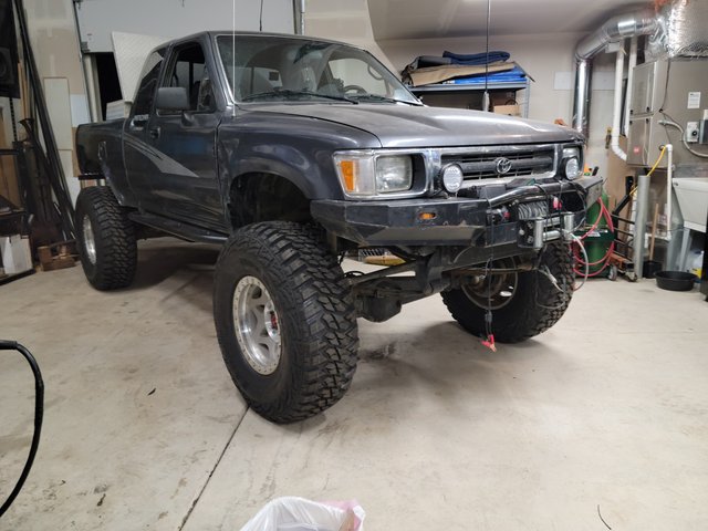

But your tires look great. Was going to say gnarley, but that sounds pretty 80s and I don't want to get banned.
but again it could be the throw out bearing. I took my 97 Tacoma (bought new) into toyota with 14K on it, they thought the same thing. 6 weeks later toyota had rebuilt the transmission 2x's, i still had the noise. it never went away. if you trailer the truck i would consider this a sort of non issue
Yeah, I will double check everything on the radio tonight. It's more frustrating than anything, but I do have backup comms if needed. And I do have a speedo app on my phone, so that will work for now.
The odd part about the driveline noise is it was happening before. I assumed it was the throw out bearing, so that was replaced when I did the clutch. Literally every part that would obviously be making that sound I have replaced.

2) The drivetrain noise is still a mystery, but I did find that the t-case was hitting the body. I made a bit more room with a hammer and prybar. That made the noise a lot easier to pinpoint. I believe it is in the driveshaft. I will try to confirm that tonight, but that is a lot less worrisome.
3) The cable I used to remove mount my Ham radio face is faulty... Radio works fine attached to the base. Easy peasy.
