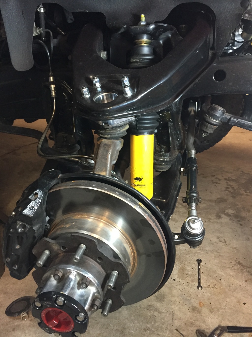

After I got the truck running, the next step was fixing the horrible suspension. I got a full Old Man Emu 2" suspension kit with leafs, shocks, torsion bars, steering stabilizer, etc. I bought it from Rocky Road Outfitters, who had the best price by far. I heard a lot of bad reviews, of people complaining it took however long to get their parts. But if you call ahead and ask them which items in the kit are backordered, you can be informed before purchasing and have a pleasant experience. I didn't mind waiting for the parts, so I would rather pay the lower price.

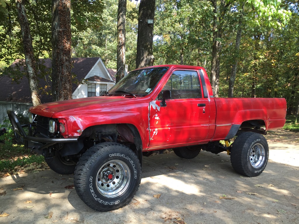

Here is the truck before the lift
The rear end sagged bad, and the shocks were the original to the truck, so needless to say the ride was abysmal.

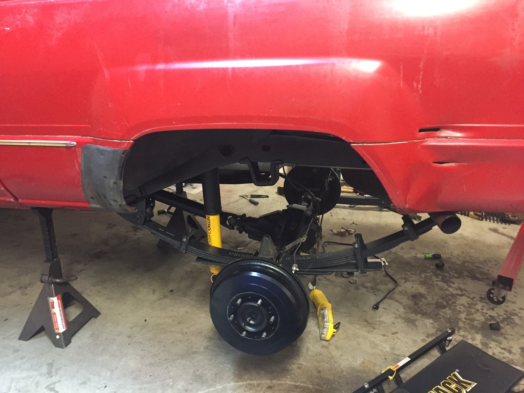

Here is the rear mostly installed

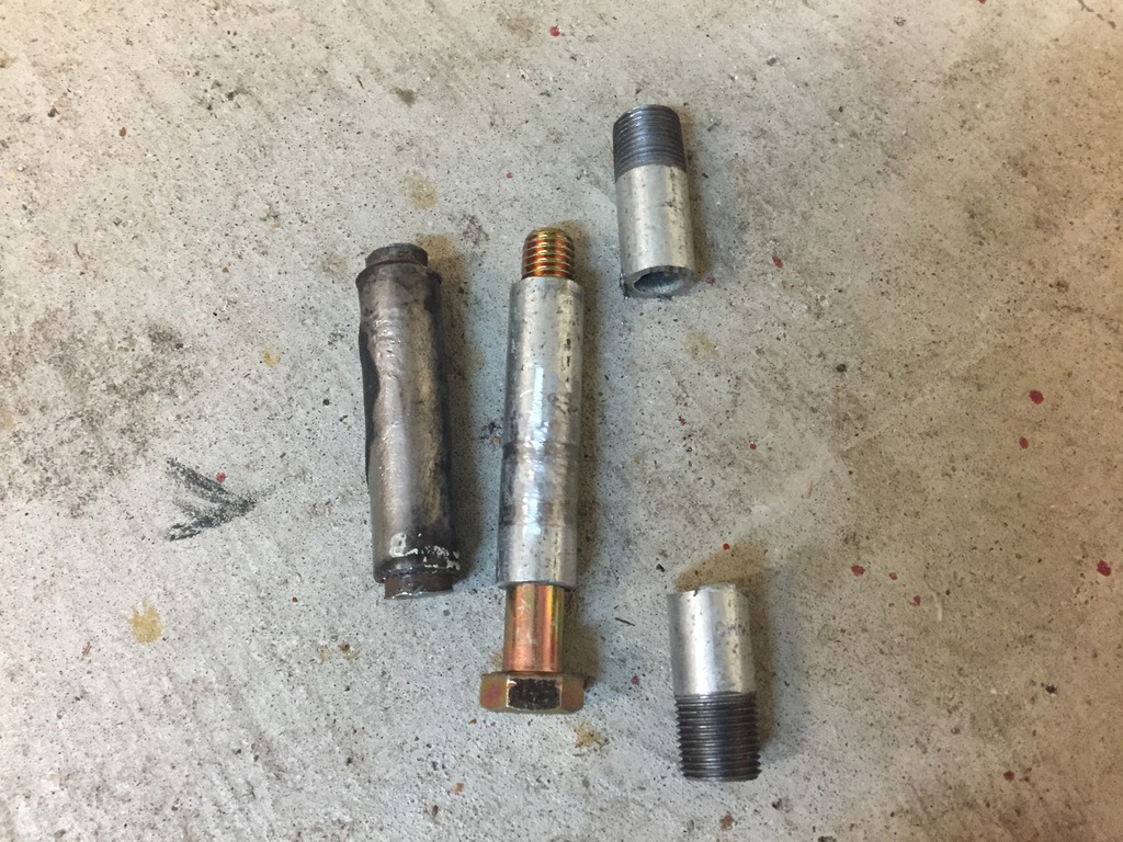

The only problem I ran into with the rear was the front leaf spring bolt being seized inside the metal sleeve that you have to remove from the bushing. I had to cut the whole bolt out. Unfortunately that left me without one of the sleeves that I needed. Fortunately I was able to find at Lowes some sort of pipe extension that had the perfect outer diameter, but too small of an inner diameter. I was able to solve that problem easily by drilling out the inside to fit my new grade 8 bolt.

The front end went very smoothly. I installed the new OME shocks as well as some of 4Crawler's 1.5" ball joint spacers. I haven't installed the torsion bars yet.
At the same time I also replaced all the inner and outer tie rod ends with new Sankei 555. They appear to be very good quality.

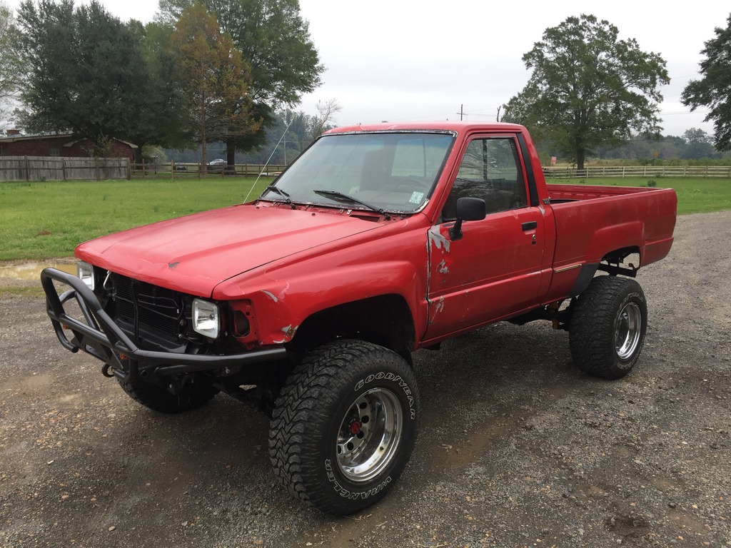

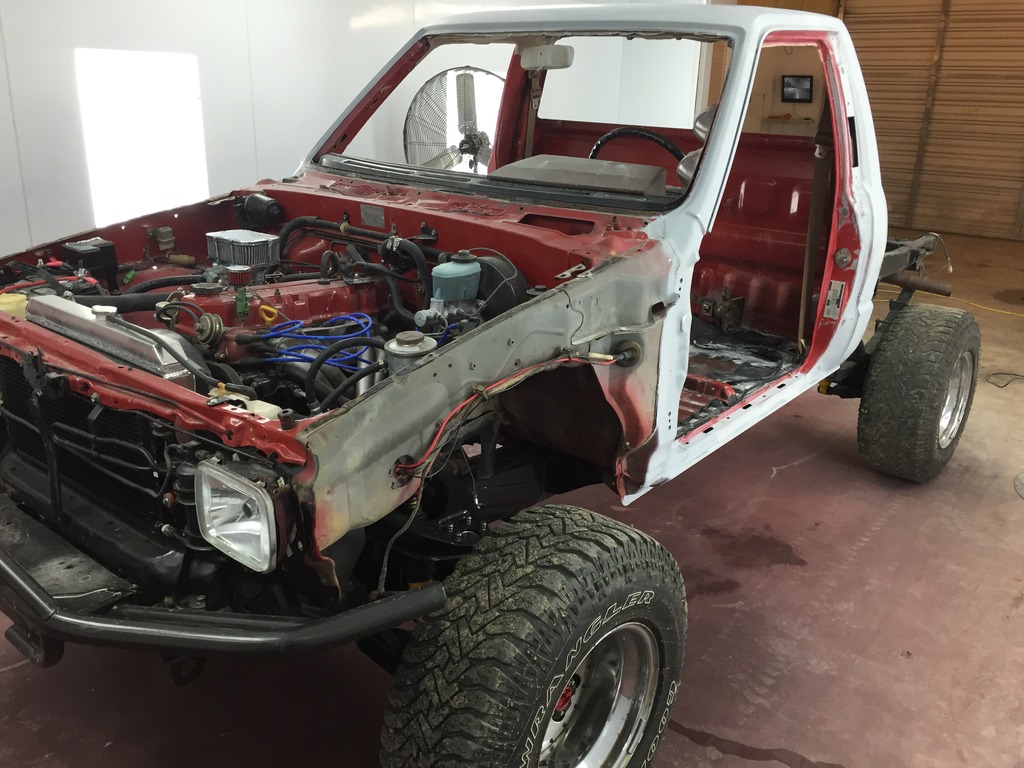

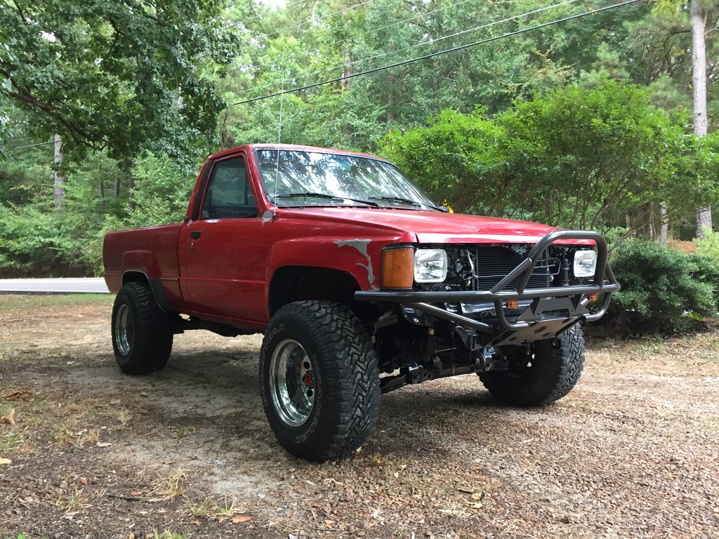

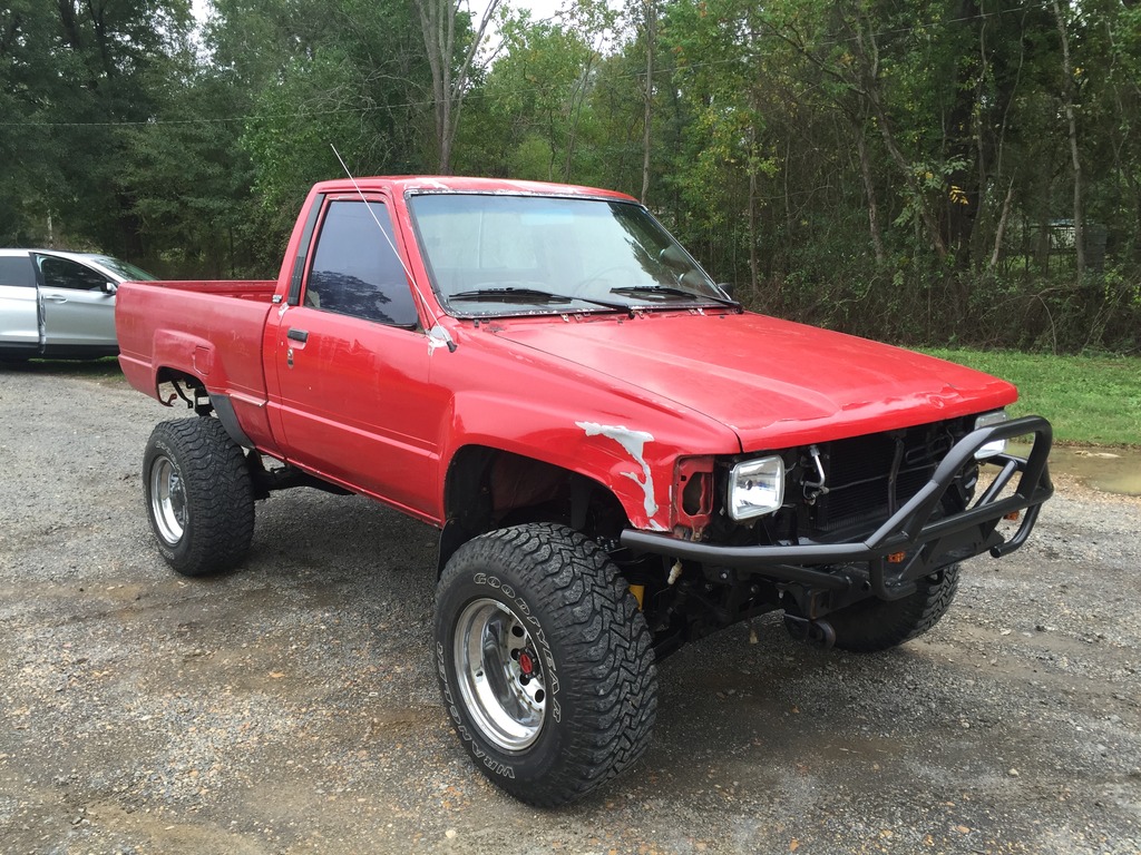

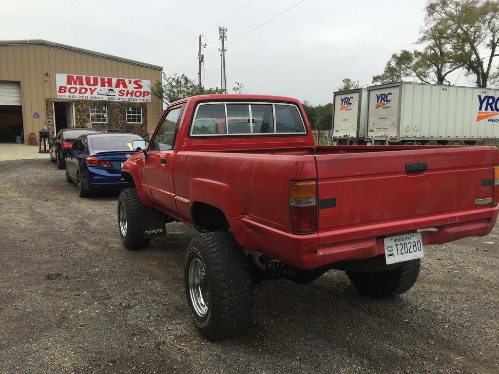

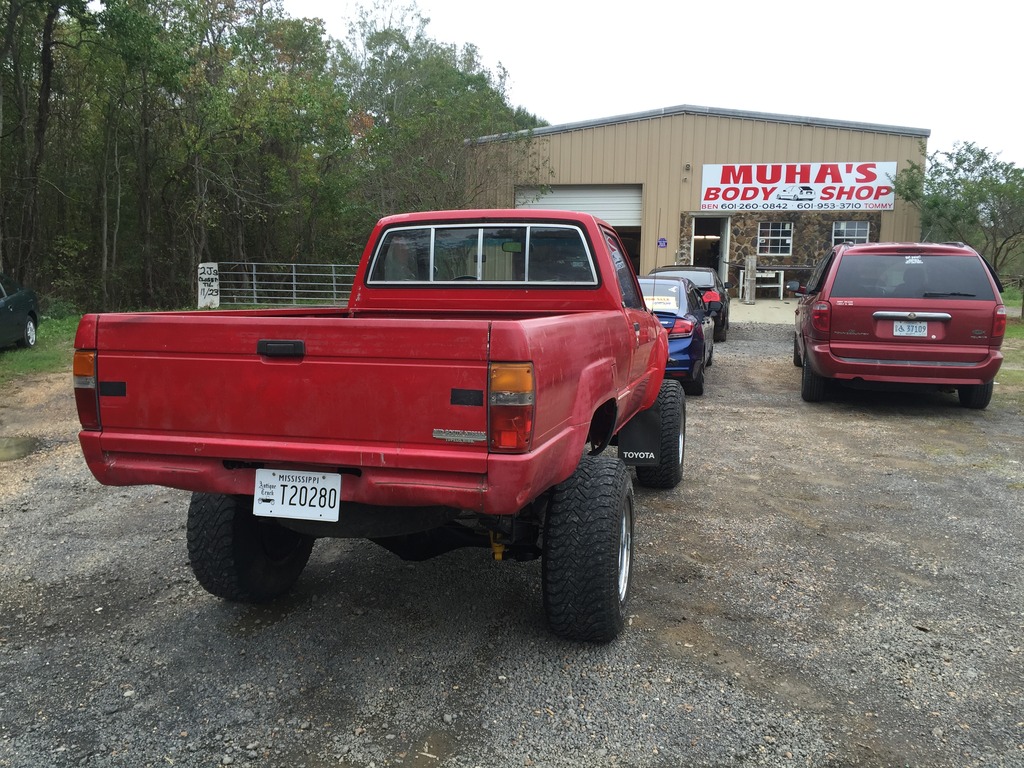

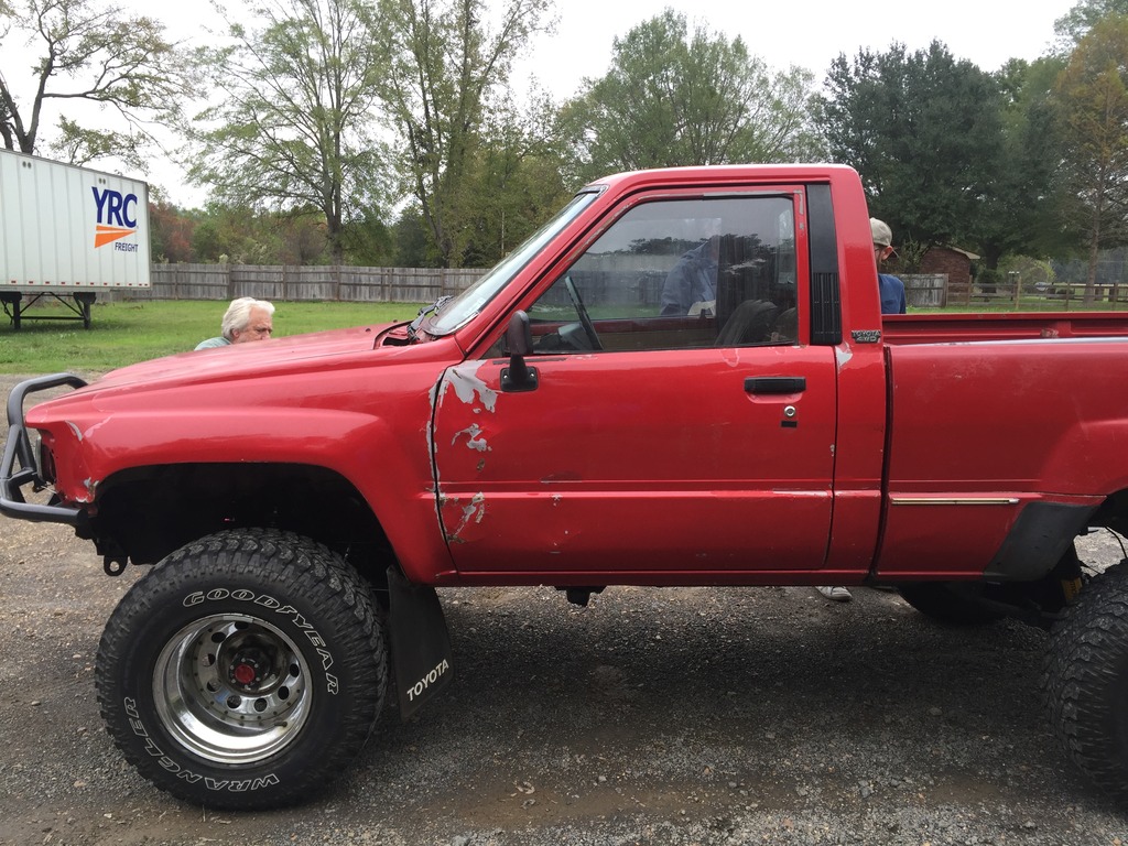

Alright, so here are a few "before" pictures of what the truck looked like before body and paint.
Also, the condition of the body and paint really is worse than it looks in the pictures.

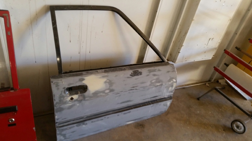

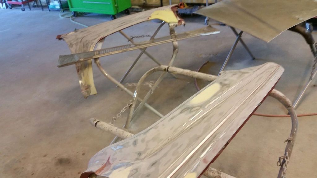

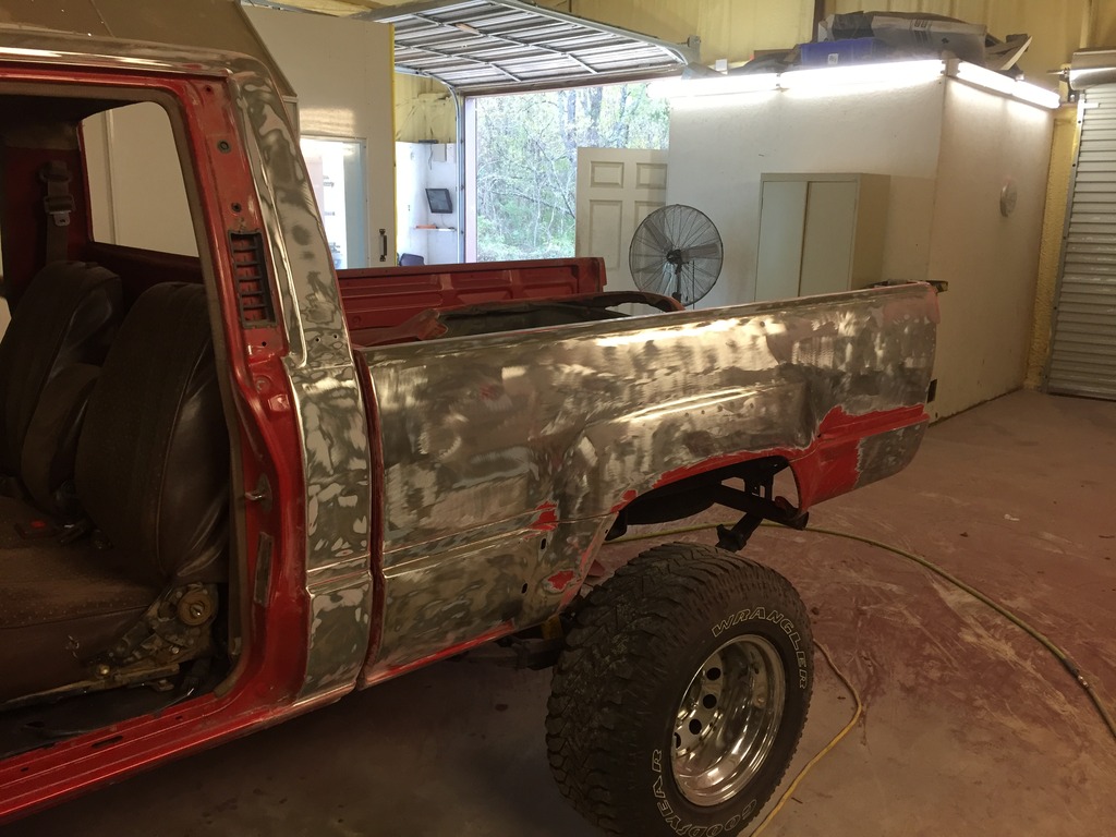

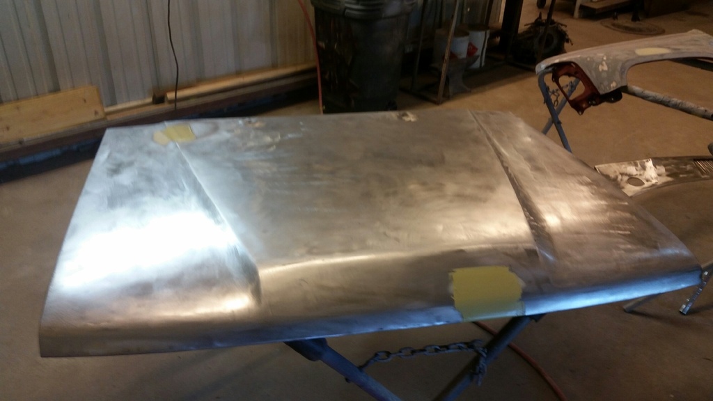

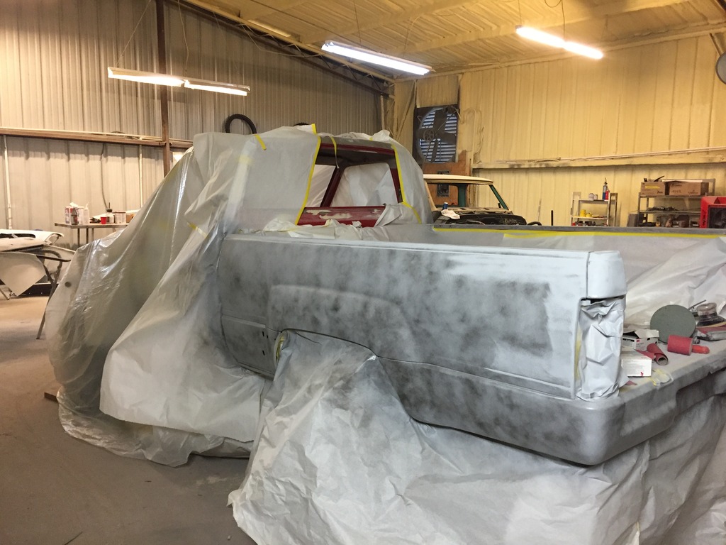

I got new doors and fenders, well used OEM. I'm not a believer in the aftermarket stuff. I found some doors with the vent windows, I really like that feature.
They stripped everything down to bare metal, fixed all the dents, and then started from the ground up. It was a big job. It took the shop about 5 weeks to complete. I dropped in once or twice a week to see how things were going. They let me do some blocking as well as help out in reassembly once the truck was painted.
Here are some pictures from the process

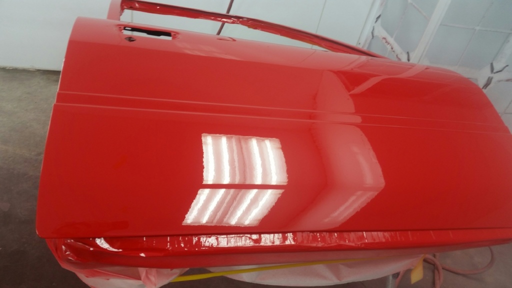

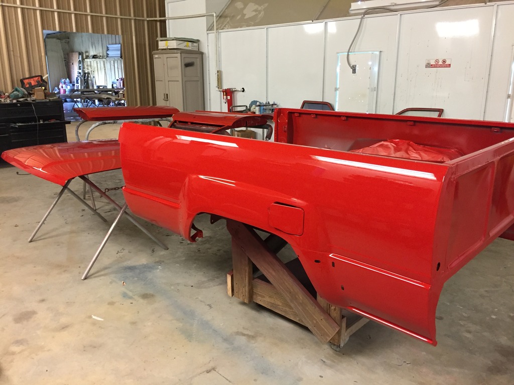

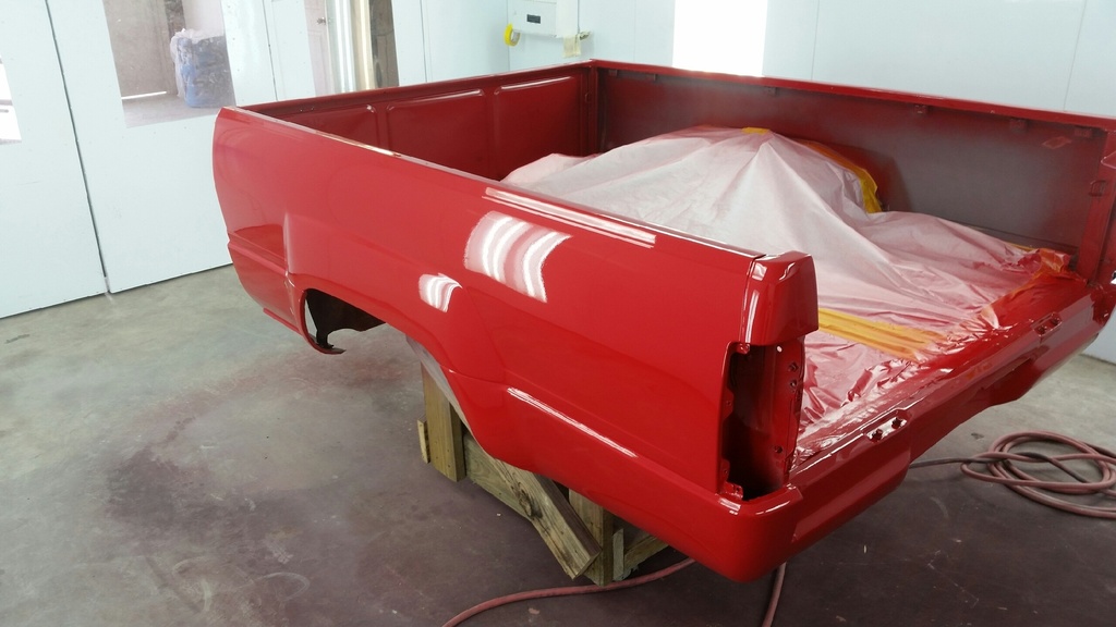

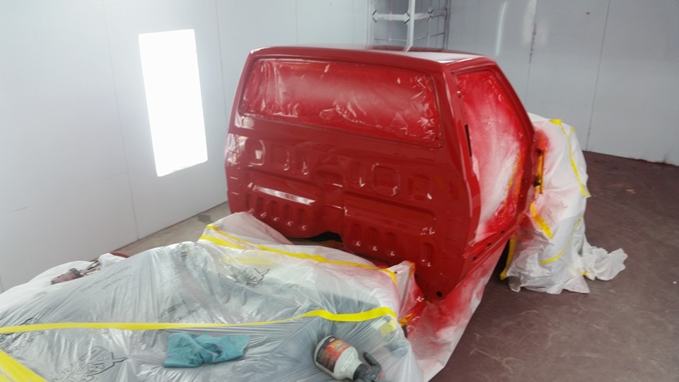

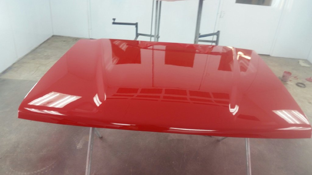

And here is some paint starting to go on the pieces.

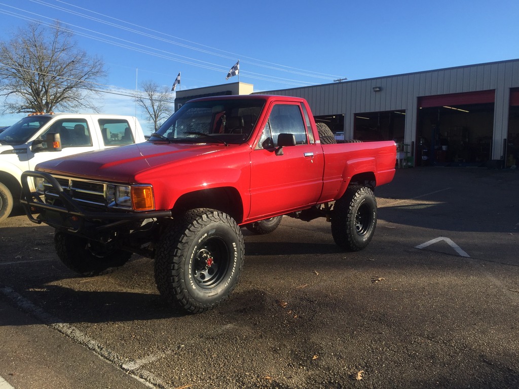

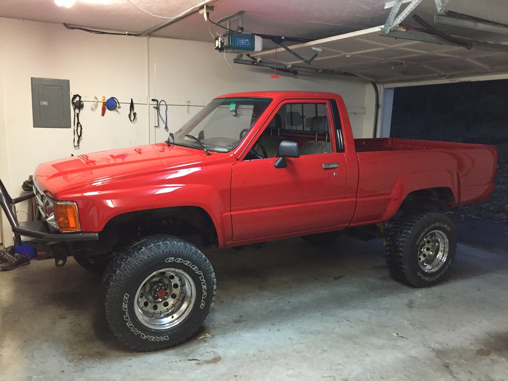

It may look just about new but it's still far from it! There will always be some pesky little problems... Right now I'm trying to track down some pesky little water leaks.

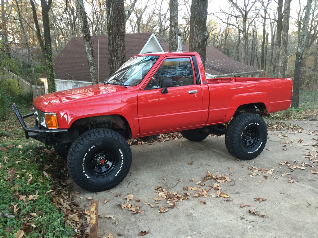

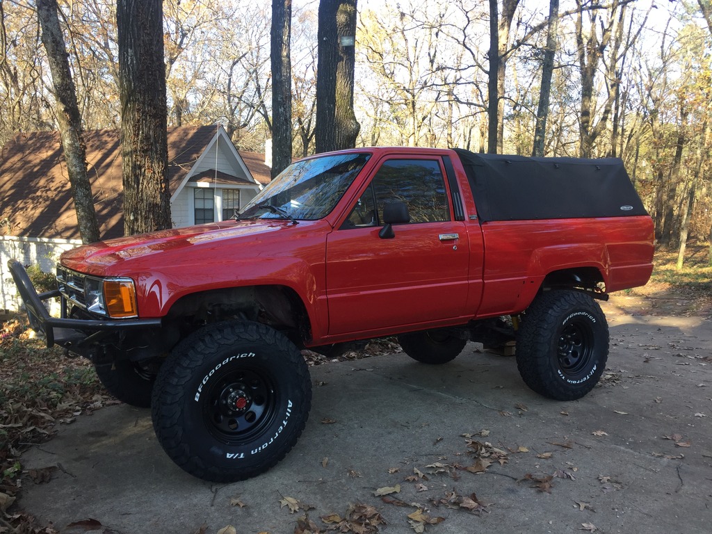

Here is the truck all put back together.

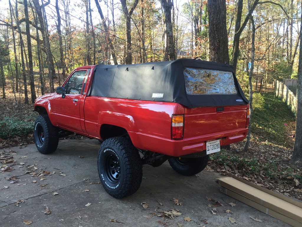

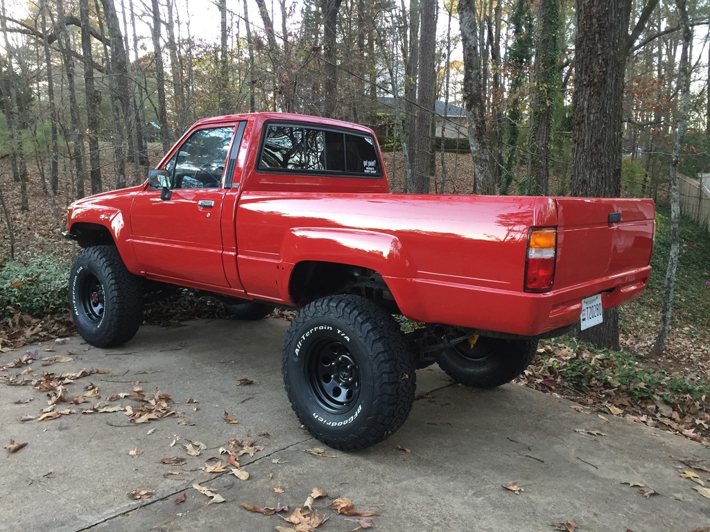

As soon as the paint was finished I installed my new wheels and tires along with a Softopper that I got.
I got 33x10.5r15 BFG All-Terrain KO2's and mounted them on some Black Rock Series 997 steel wheels in 15x8 with 4.5" backspacing. Even with almost factory backspacing they still stick out of the wheel wells a small amount.
Here are some pictures with the Softopper installed. So far I have nothing but good things to say about the product. Everything is very high quality and it looks like it will hold up very well.
