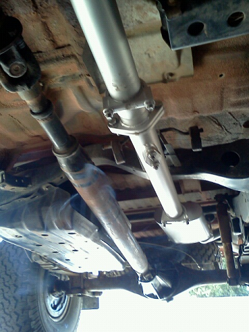

more build pic's
tried to get the full run of the exhaust for ya. and a pic of my new rear diff in.

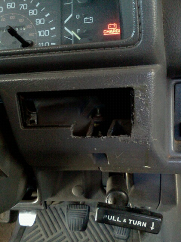

dash mods
got some new stuff to add to the build. looks like a good spot for my new switches, and clineometer

the hole wasnt quite big enuff so i cut with a knife! lol seems to fit well though. then i cut the cover plate in half and put it back in. now i just have to clean the glue from my old velcro for the stereo remote.

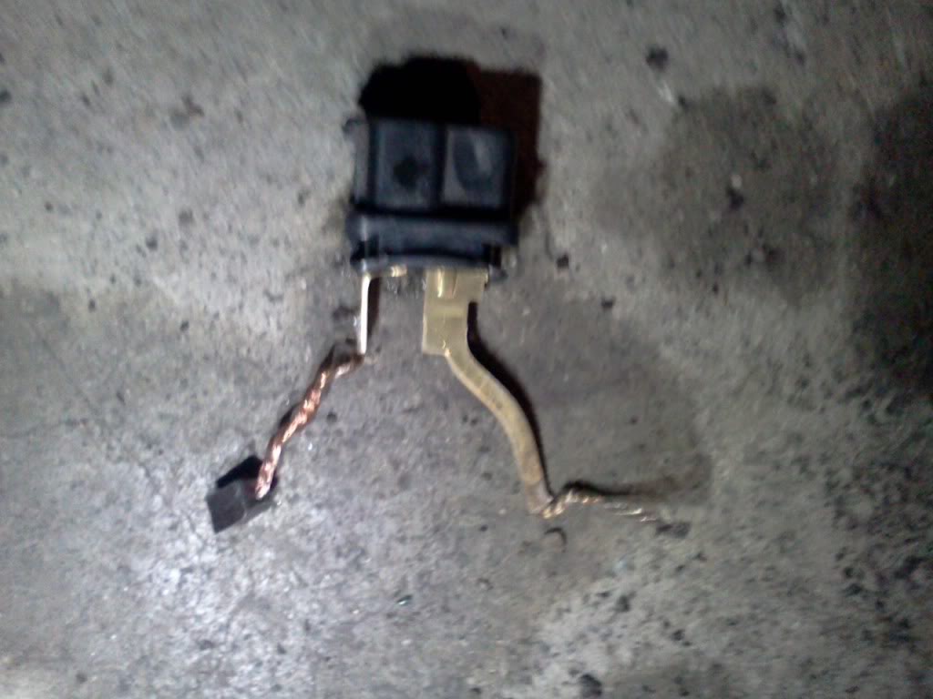

ac problems

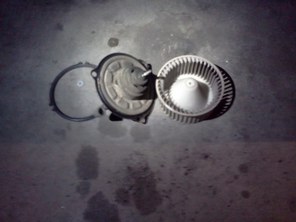

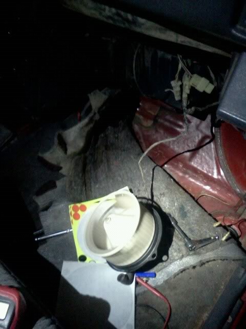

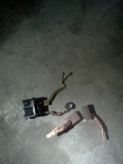

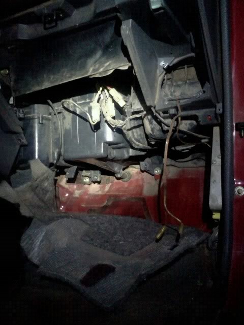

so my AC decided to stop working the other day, and its summer time! I got to get it fixed asap! so started tearing into it last night found that ther was power going to the blower motor when i turned it on so i could only assume it was the blower motor... so i tore it out.

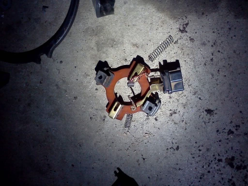

i tried blowing it out with compressed air and plugging it back in unmounted. it would spin, but just barely. so i decided to tear it apart to see what was wrong with the motor. i cleaned it with electrical contact cleaner as i went. it was filthy, all of the dirt on the ground was from the motor!
got it apart and........ brushes are toast!! haha one is missing compleatly and the motor has been running off of the spring that goes behind the one brush, it even ate it down to about half the original size.
i found a new blower motor at o'reilys for $35, but im going to try and find new brushes at this electrical supply store tonight. maybe i can fix it for just a few dollors and some know how. trick will be to find a similar size brush with the wires coming out of it.

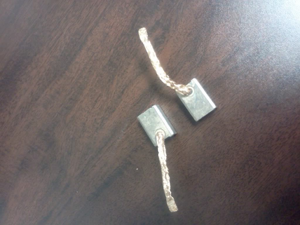

found a place that had quite a selection of bruches in theyre show room, but they were going to be closed by the time i got of work so i ran over theyre on my lunch break. and after i spent an entire dollor.........yup just a buck

NEW BRUSHES!!!! They may be a little big but if so i will just grind/file them down a bit to fit. then all i have to do is solder them on and reassemble. $1 is way better than $35! GO KNOWLEDGE hahaha

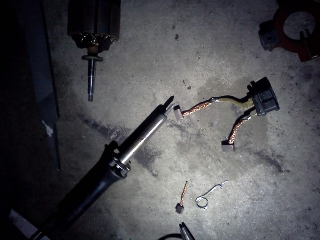

got to workin on the truck again last night. My new brushes ended up being way to big, so i had to file them down.

the file took a while to do it, but i didnt have a bench grinder available. once they were the right size i whipped out the soldering iron
