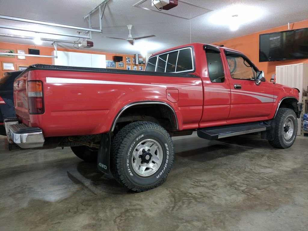

Well, after 20 some years its time to make this truck look presentable again.
If you subscribe to Expedition Portal you will have probably seen my build on there too. I just figured I'd add one to Yotatech as there is so much more Toyota technical information here. EP has given me some great advice and I love that site so we will see how it goes here.
Pictured above is what I'm starting with. A 1993 Toyota SR5 v6 extended cab.
About 15 years ago I purchased new leaf springs from Northwest Off Road Specialties (to lift the saggy backend) along with new torsion bars. I installed the springs but never did anything with the bars. Except store them in the basement.
The truck has run great over the years. It only has about 140000 miles on it and for the last few years I have only added about 1000 miles per year. In fact one year it was only about 800. It just sits in the garage and is used to run leaves and lawn clippings out and run to the home improvement store.
But now its starting to show its age with a rust spot here and there especially above the wheels. The rims look tough. It needs some beautification.
So the plan is to repaint the wheels. Repaint the truck. Put larger tires on. Possibly lift it more, due to the new tires. Put the topper back on and also have that painted. Put a rack on the top and make it a bit more of an expedition style truck and maybe do some exploring and camping with it. And we will see whatever else along the way.
So here goes. Hopefully I'll get lots of ideas and help along the way as I don't have much knowledge in the automotive world. I could build you a house, but for some reason I get a bit nervous when it comes to autos.
1st thing to do....Wheels!
