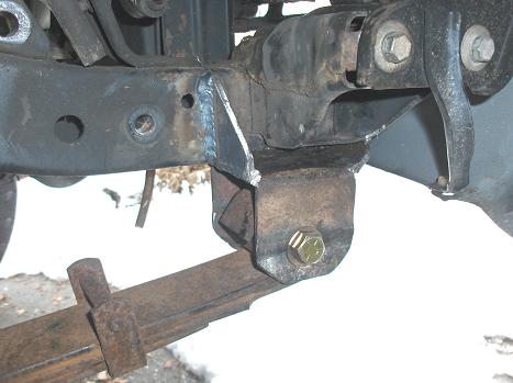

pics

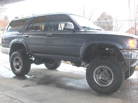

Here is the runner after the SAS and 31's, the custom front leaf mounts my friend made for me and the 1980 front axle i used with the high steer arms on it

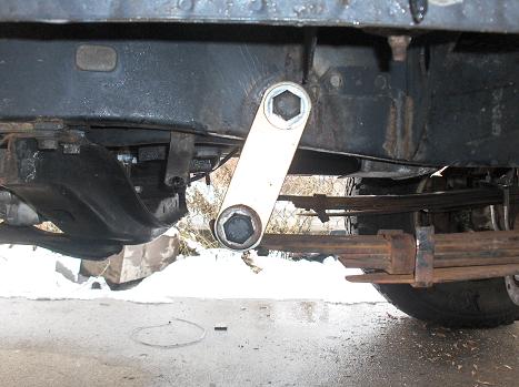

more pics
Here is the shackle angle and a shot of the front mounts fromt the side, and the front shot of axle installed but it looks low because i needed to still add 2 leafs in pack to leavel it out

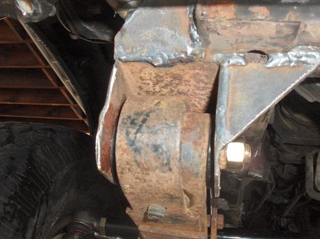

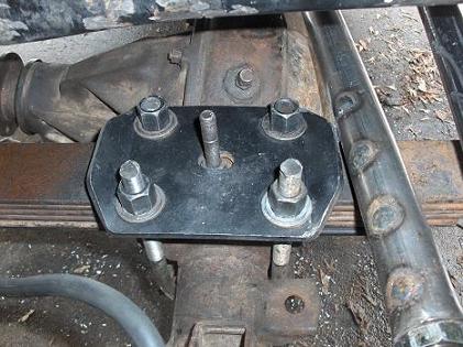

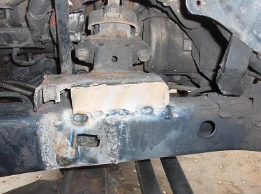

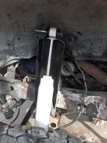

here is my ubolt flip kit with ghetto ubolts and a make shift tierod till i got my new one, as well as me plating the engine mount with some scrap steel i had laying around. I used the ford shock towers for front upper shock mounts

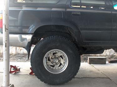

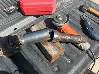

Here is the 35's i put on shortly after i SAS'd it, the lockright i put in the rear, and lengthening the stock 1980 front drive shaft which ended up being to short at full articulation and would come out if you hit the brakes on a up hill, so i replaced it with a square drive shaft

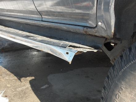

carange

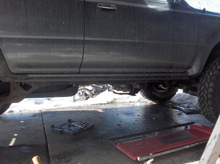

After a trail run in Eden when i only had the rear lifted i thrashed my runner boards so i tore them off

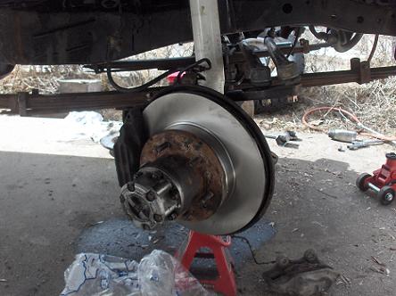

Oh and here is the 1976 FJ40 vented rotors that i put on with my V6 IFS calipers

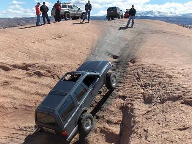

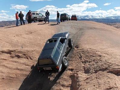

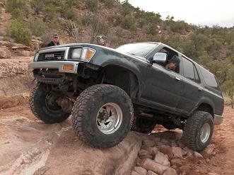

Here are a few of the rig it's first trip to moab, all mods done and coming out of one of the hell's tubs, the pis are in the wrong order for some reason
Attached Thumbnails Sparticus's 1991 4runner build up thread-hpim2225.jpg   Sparticus's 1991 4runner build up thread-hpim2222.jpg   Sparticus's 1991 4runner build up thread-hpim2223.jpg
