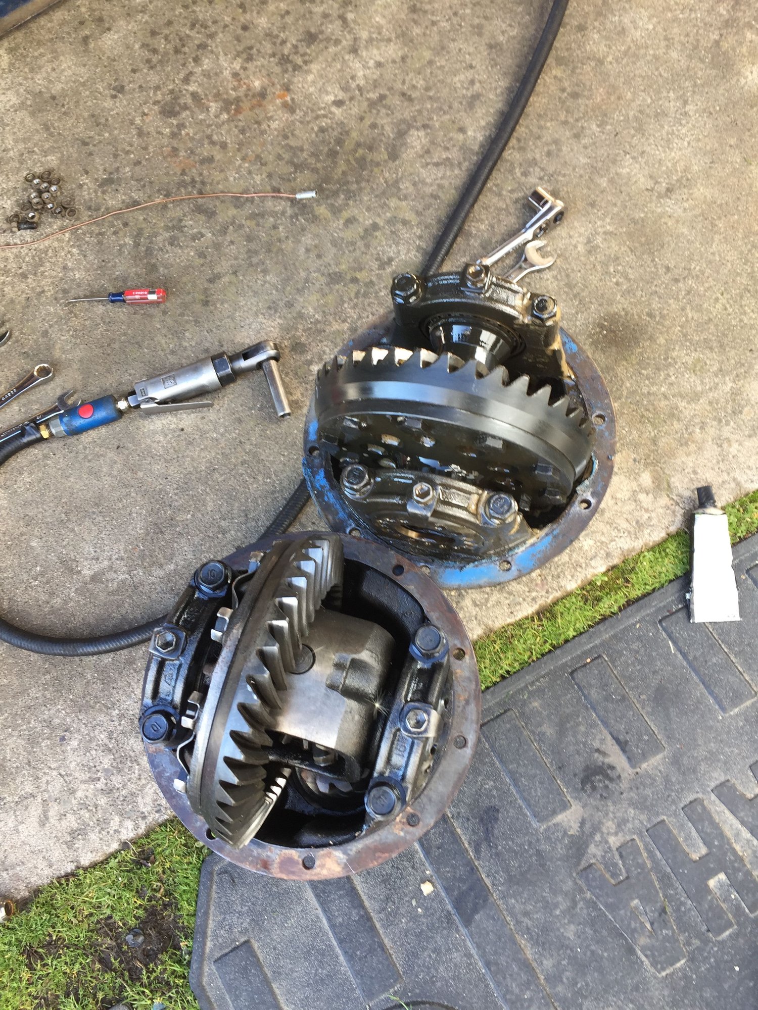

Also a few days ago my rear diff decided to kill itself. That was fun getting home. So now it has 2 blown up diffs. Anyways I ordered new gears for the rear and threw a 4.10 open diff in it so it would move. Still have to order a new front locker. Im missing my truck.

Gnarly. Sounds like someone needs to get ahold of ZUK!
