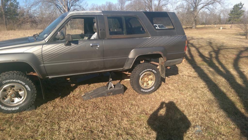

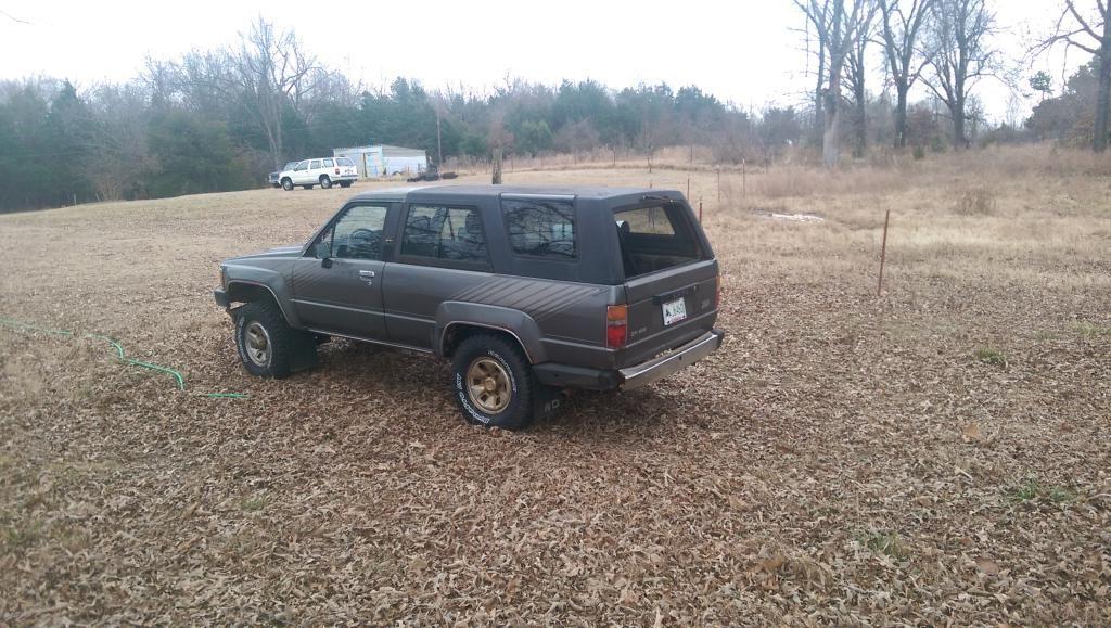

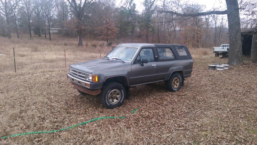

In HS, I dove one of the first 1984 4Runners to ever come to the states. Like a dumb HS kid, I pretty much trashed it every which way I could before the Engine blew from too many high RPM shifts on the original Timing Chain. I found myself needing a replacement for my 2wd Nissan Pathblocker, and saw this 1987 4runner on CL for 2000 so I went to have a look. 1500 dollars later, I drove it home.
Only picture I took of it as it was when I got it home.

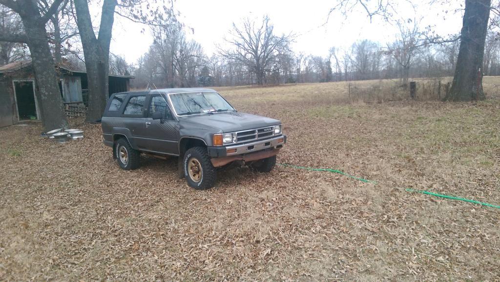

First I put some new stock size tires on it and took it for a quick spray at the car wash.

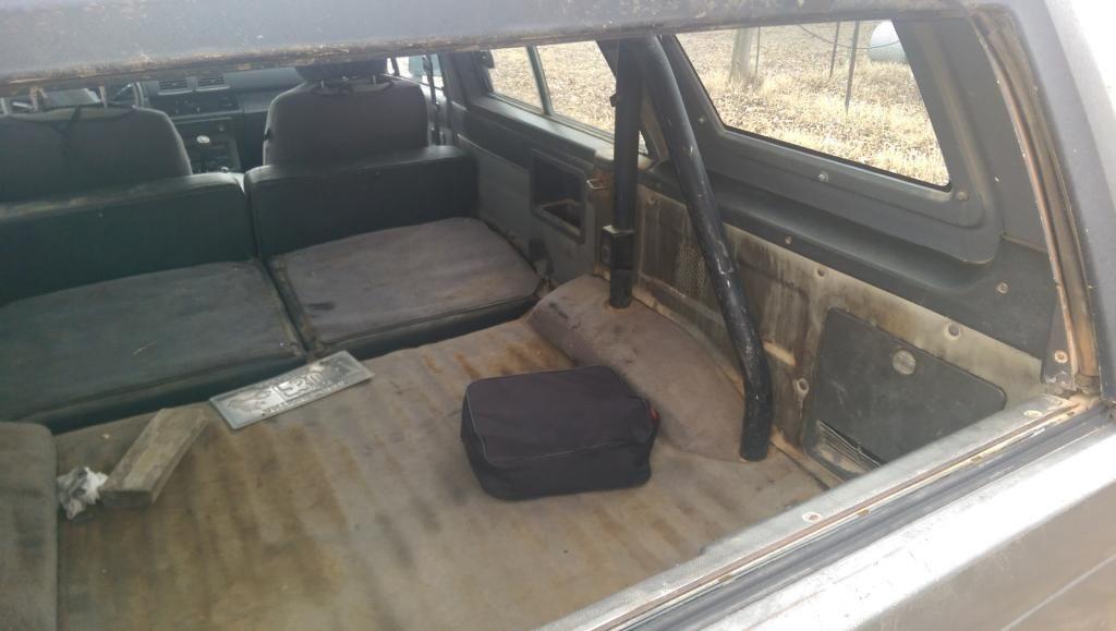

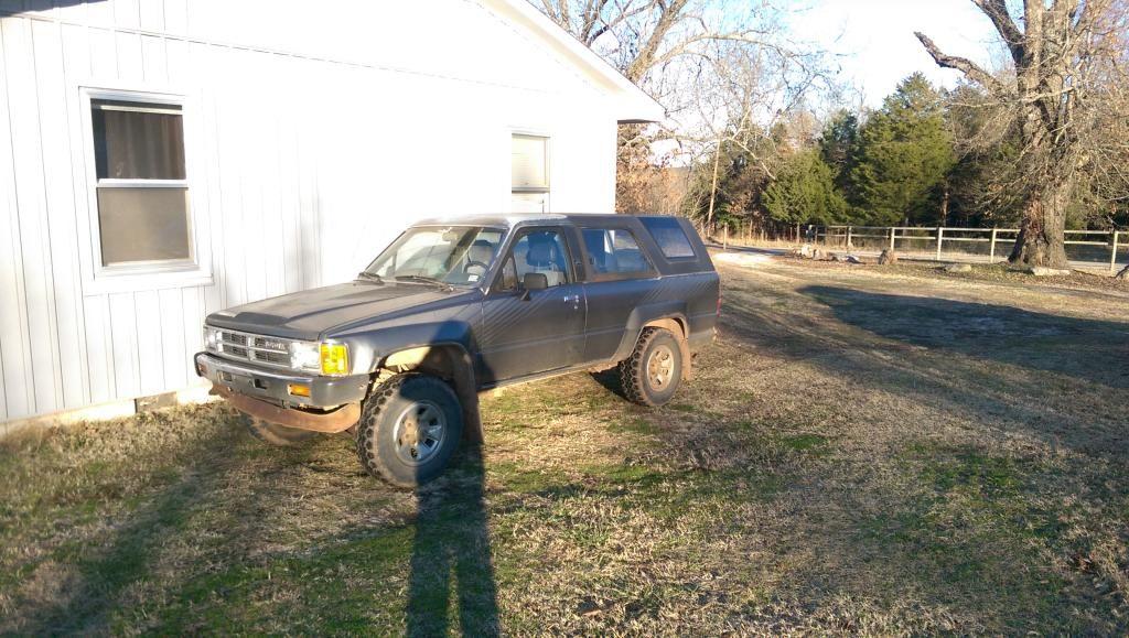

Not sure what the brownish stuff on the side panels is.. Guessing it leaked at some point.

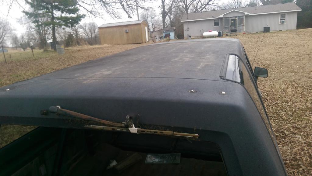

Also not sure Why For someone put screws here... Roof Rack?

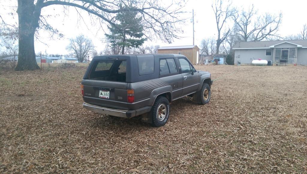

Dirty Dirty

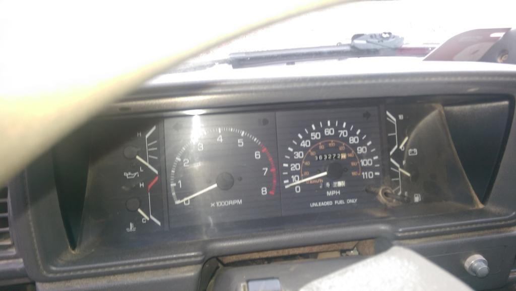

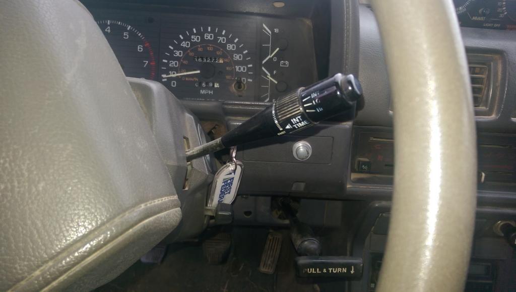

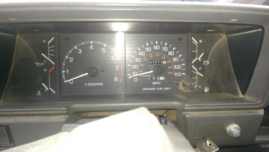

Chassis has 363262 on it after driving it the weekend I got it, Then 100 miles to our work and back, then to the beer store. (Engine supposedly has about 40k on it. It does run smooth and the Timing guides are good for now) The Silver button is the starter. All I can guess is someone was to dumb to check/replace the starter relay since I still need to turn the key while I button if I expect it to start when its cold.

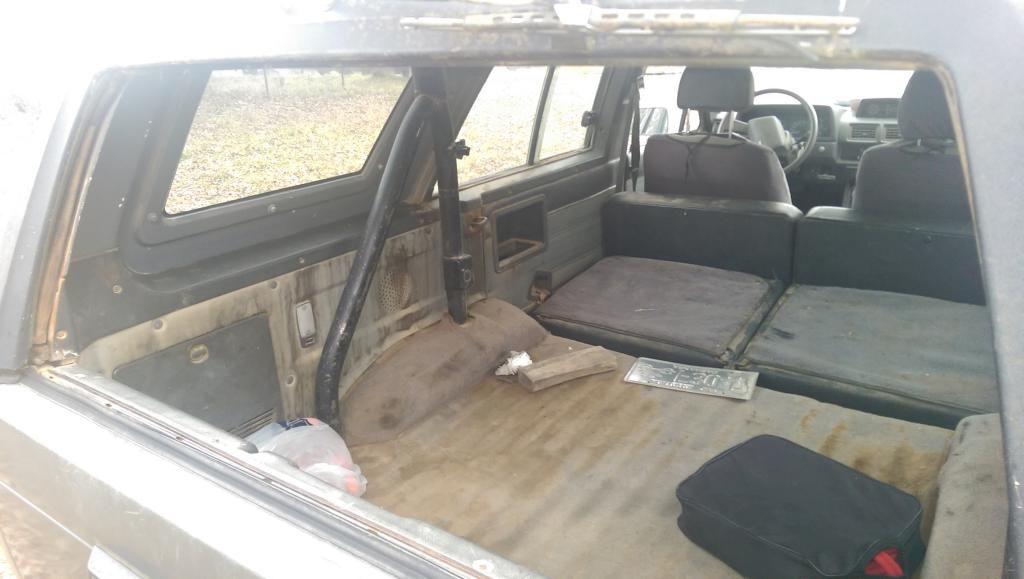

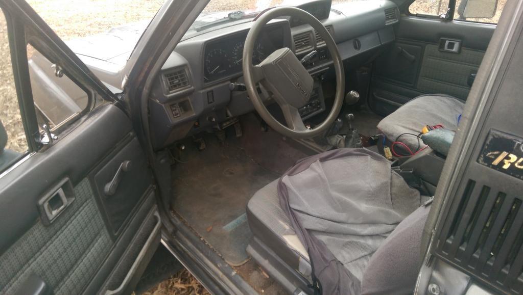

Cracked Dash and more Dirt

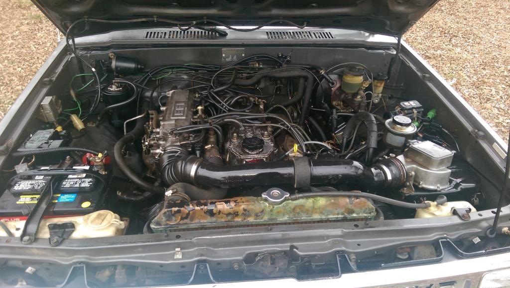

The Engine after Knocking the layer of wet oil and dirt off... Gonna take some scrubbing to get it much cleaner.

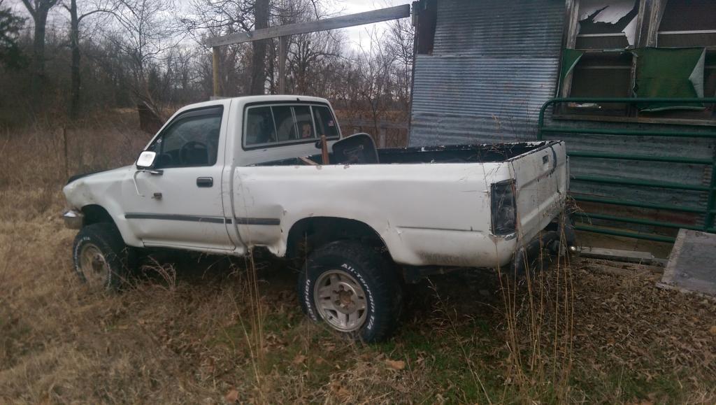

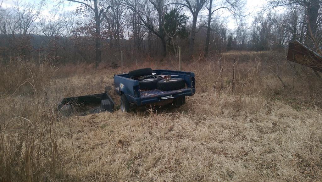

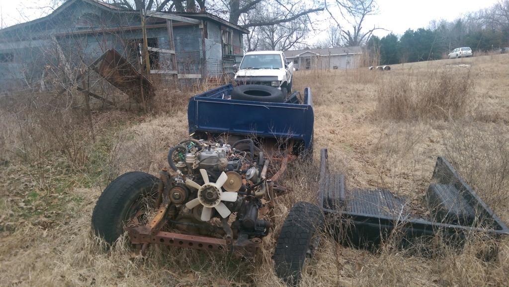

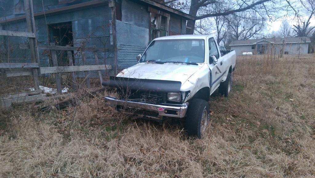

Luckily I had a skill for junking Toyota 4x4's when I was younger, and a bad case of the pack rat, so I've got a part or two... Got to go drag still another out of the field but here are the parts trucks I have sitting here..

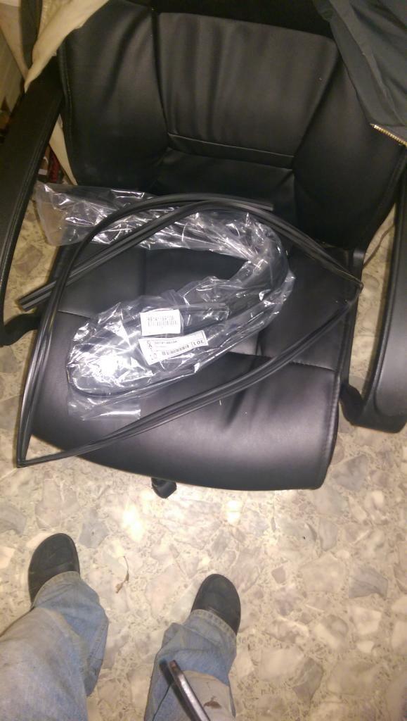

126 dollars for 2EA - RUN CHANNEL s - aka the seal around the widows.. Weatherstrip at 25+ bucks per bend...

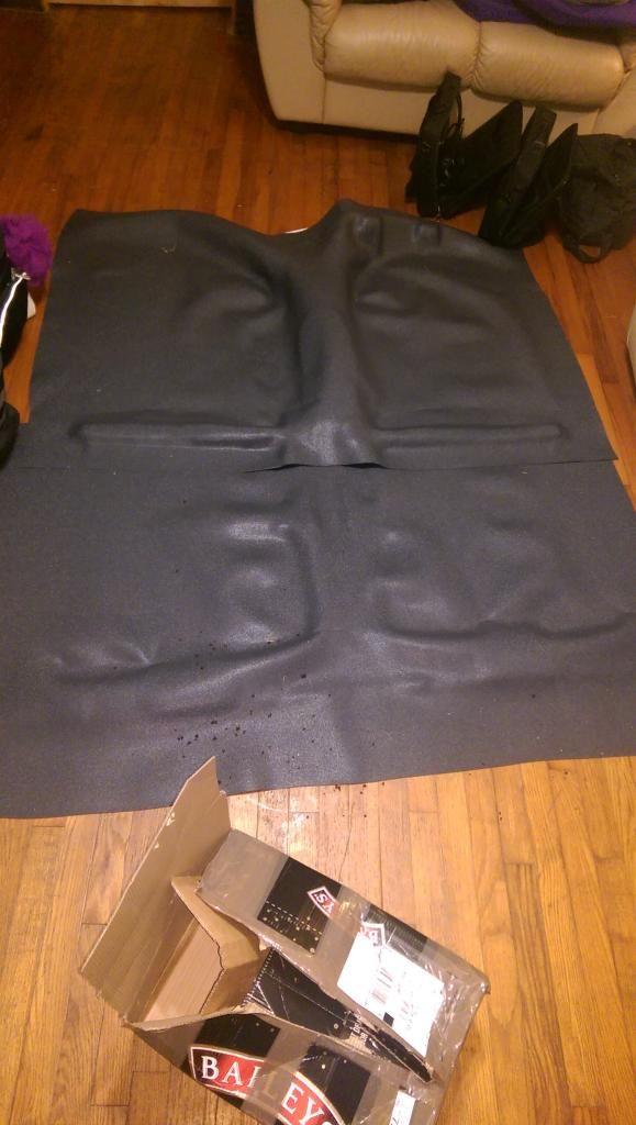

Vinyl Floor Mat and the Box my coils for the ZUK mod shipped in.. Apparenly they wither like the Irish, or they steal boxes for shipping from a liquor store..

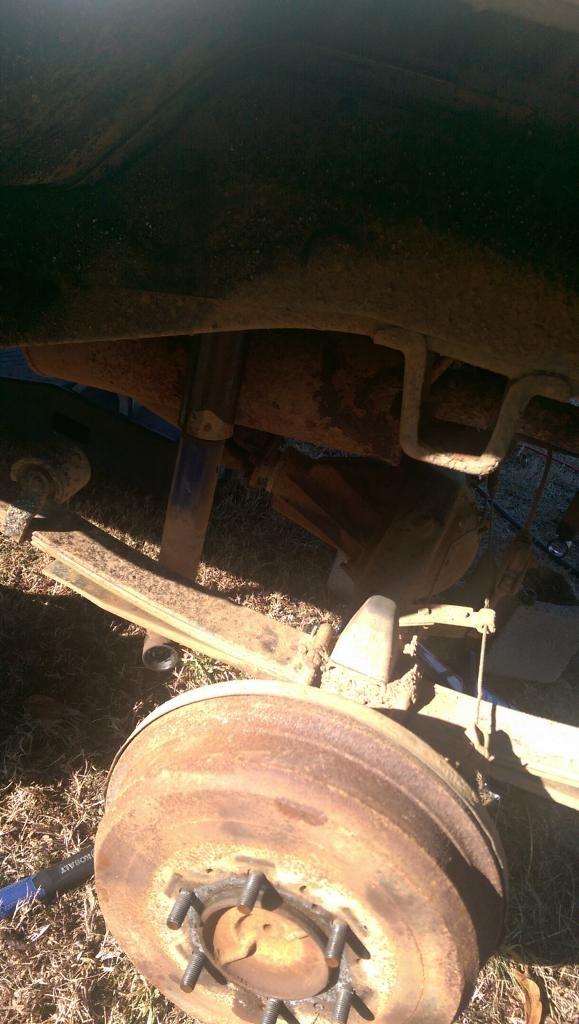

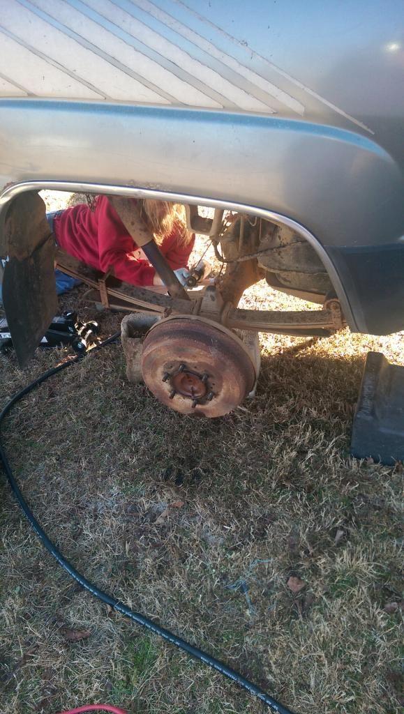

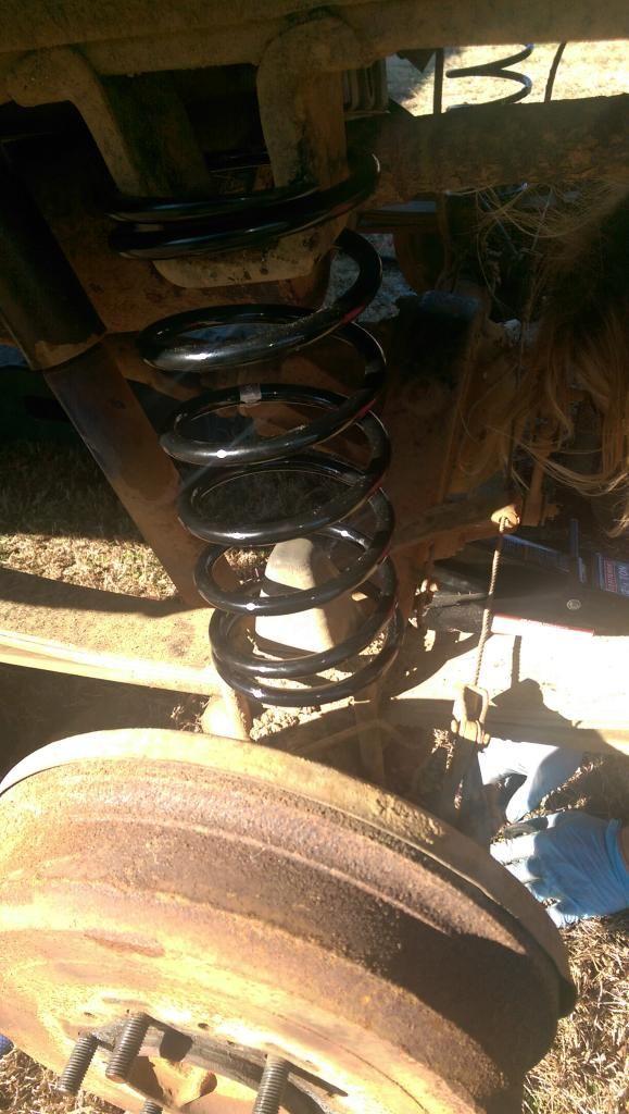

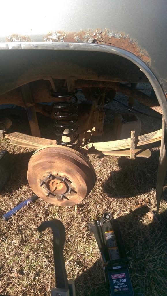

So today we did the ZUK mod to keep from bottoming out all the time until I get the chance to actually fix the suspension. I forgot to do the measurements of what it did, but it did take ir from super sag to stock height. I got my spings from the infamous ebay link - http://www.ebay.com/itm/290014099615?_trksid=p2059210.m2749.l2649&ssPageName=STRK%3AMEBIDX%3AIT
I am pretty sure it would have been a little cheaper to order them direct from Southwest Speed, but I didnt realize that until later. http://www.southwestspeed.com/?sec=view_part&id=139
In any case I went with the no Cut method and used the 11" 125lb rate springs.
Up She Goes

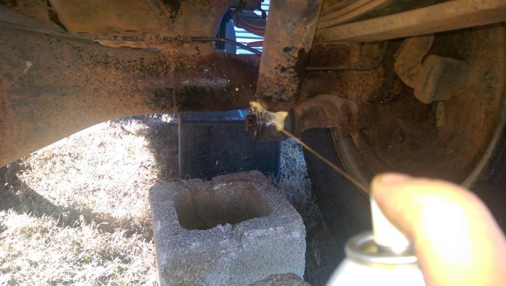

PB Blaster is awesome
I decided to use the unbolt the shocks method of making it possible to slip them in.
In
Apparently we forgot to take after pics... Will try to remember to so so Tamarraw. Only took an hour or so, spent the rest of the day changing fluids on it and our other two money pits...
