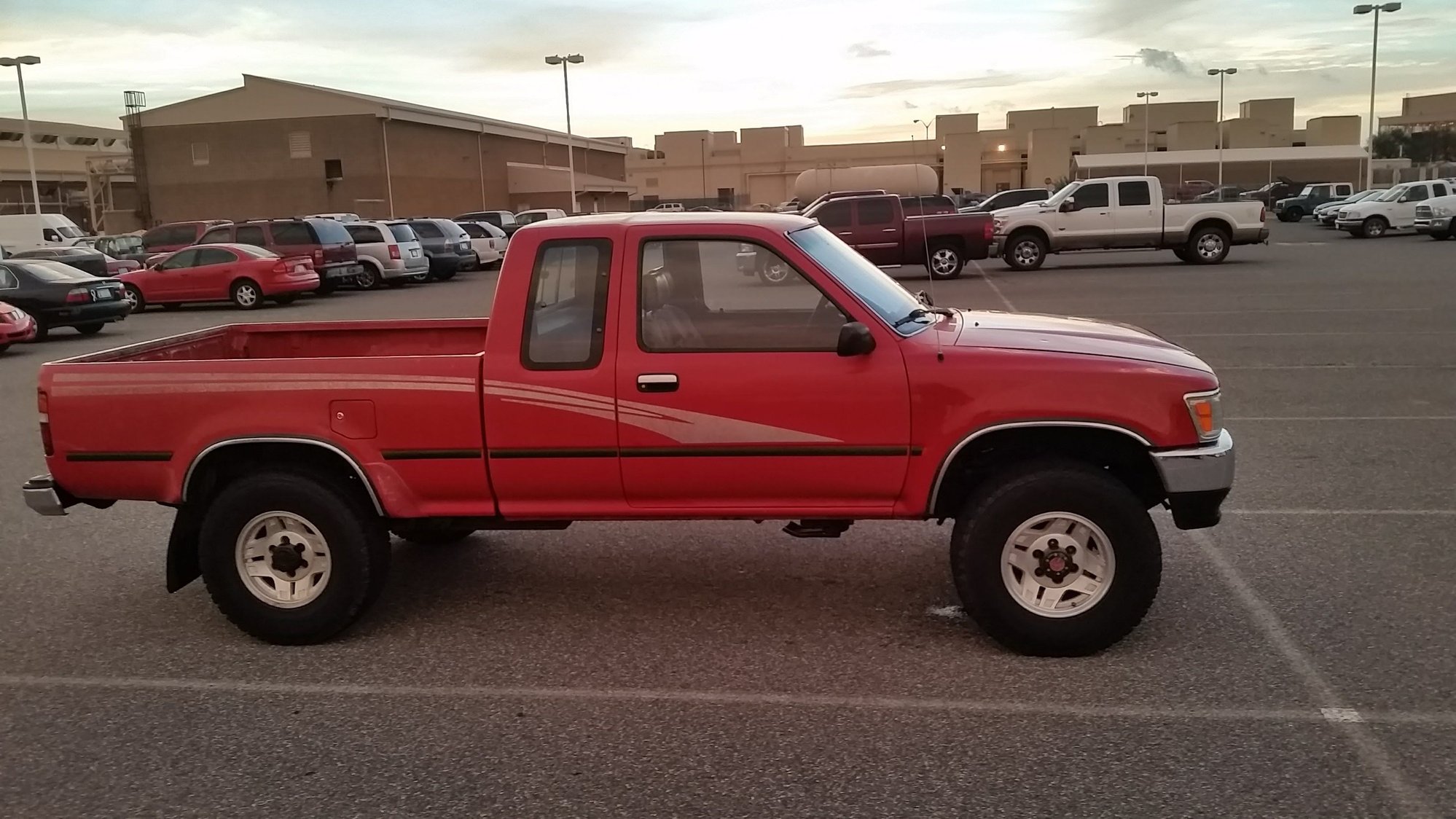

This is my journey. A manual transmission 1993 4WD extended cab DLX pickup build up AND motor swap. Slow and steady. Lots of calls to ORS, my bro, and my buddy to make it right. Born and raised in Redding CA, nabbed the truck in 2015 on base at the resale lot called the "Lemon Lot" on Tinker AFB in Oklahoma City
As it sat. Ready for a new home
. Lots of beers later here is the progress...

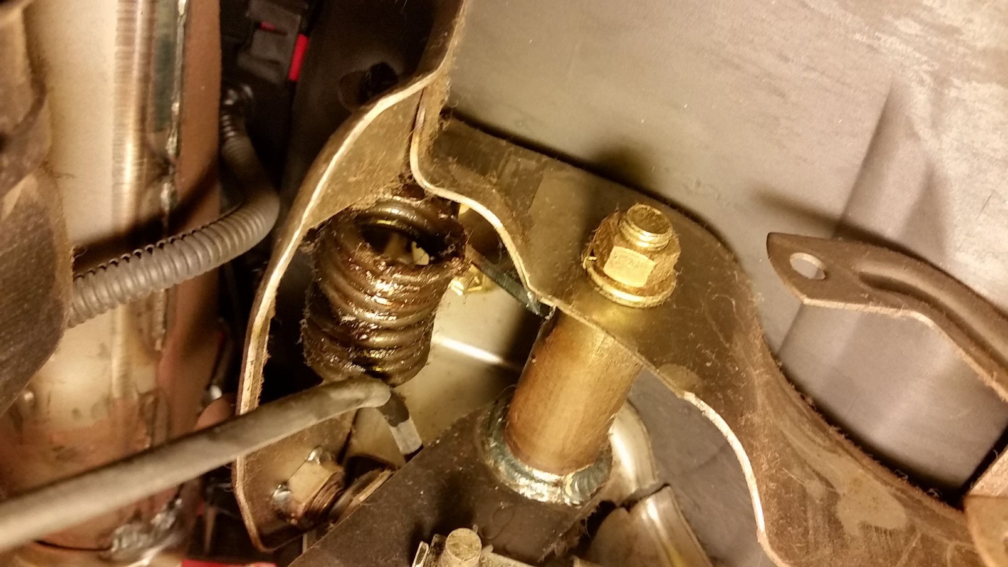

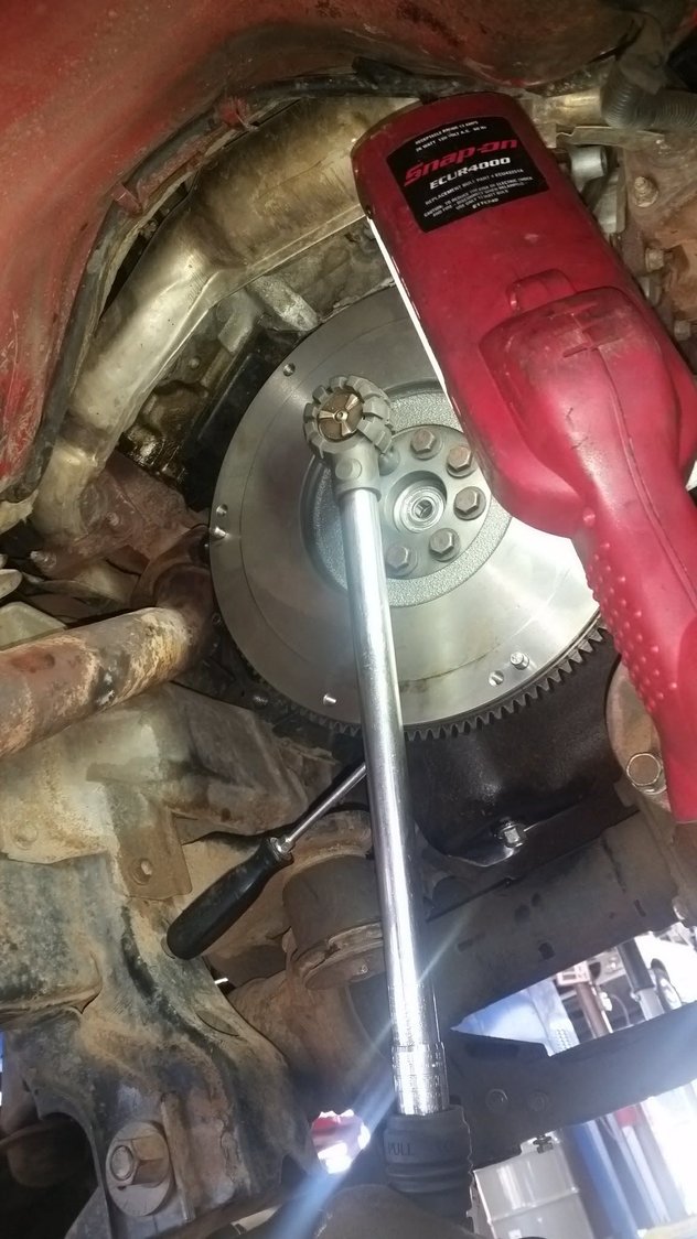

Realized the previous owner had used some type of head gasket seal stuff to mask a head gasket problem. I discovered the 3.4 swap option while I was researching a 3.0 head gasket swap. Swapped the clutch because it was worn out, swapped the timing belt and all the other associated bits, swapped the calipers, welded the clutch pedal assy after it cracked.
Torque
Clean
remanned front calipers
Cracked Clutch assy

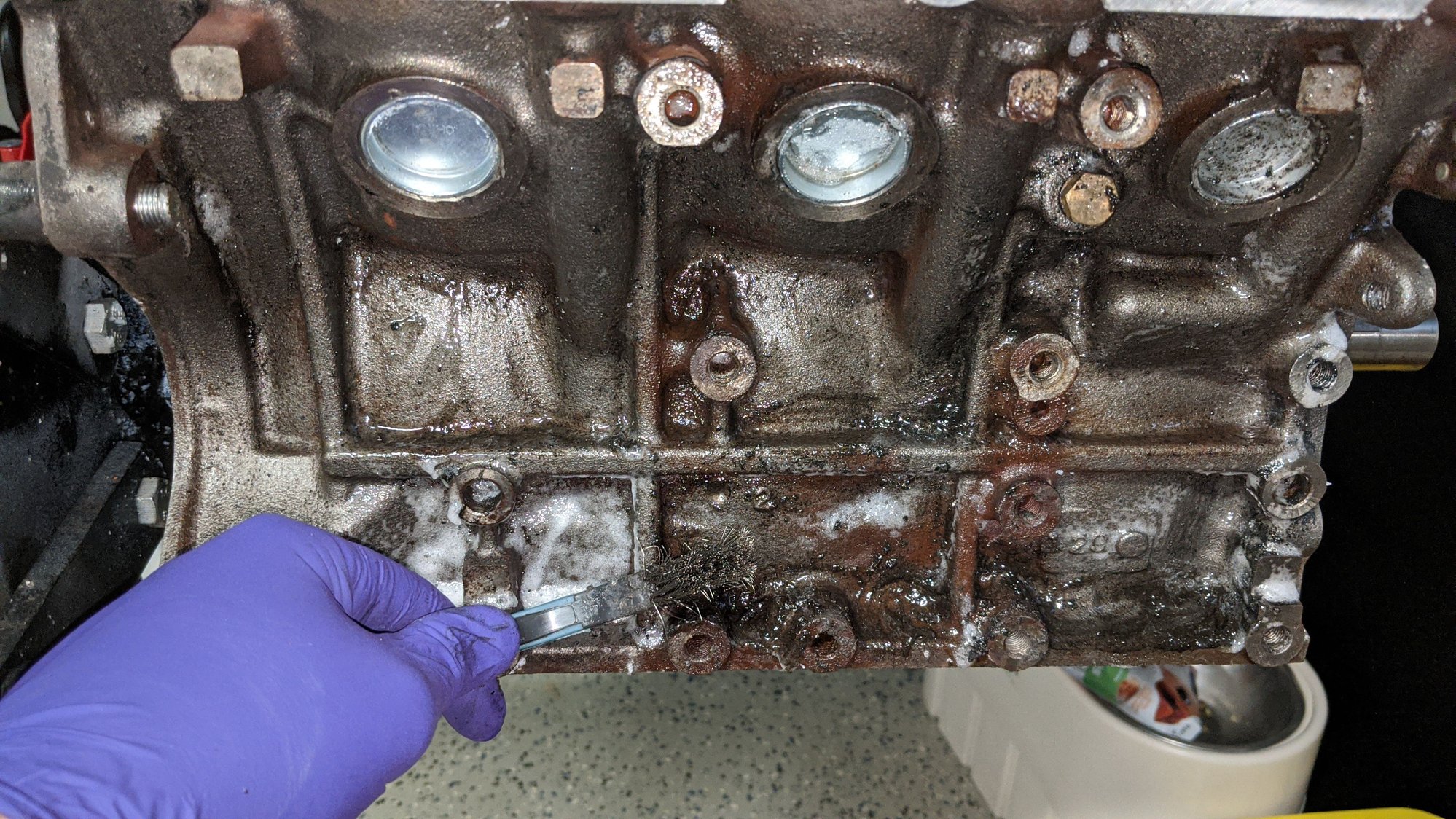

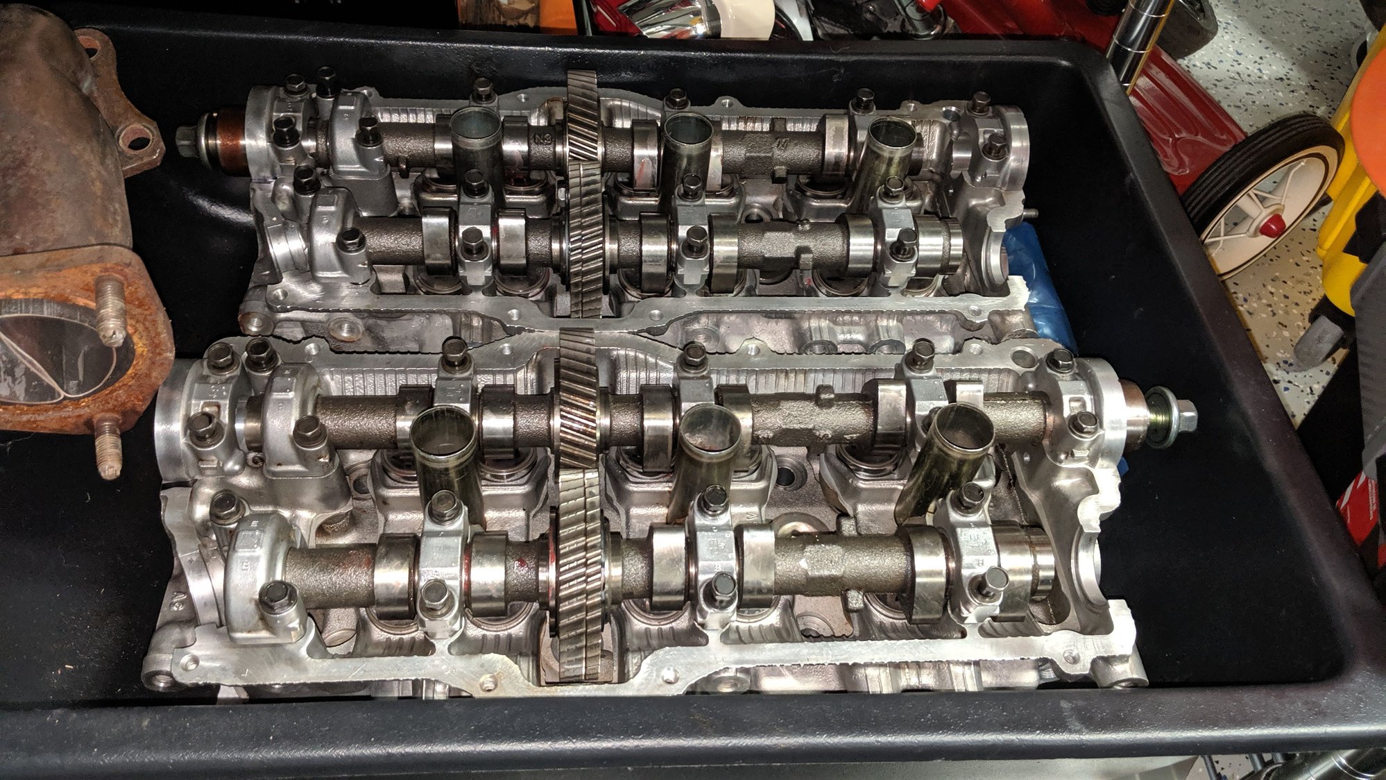

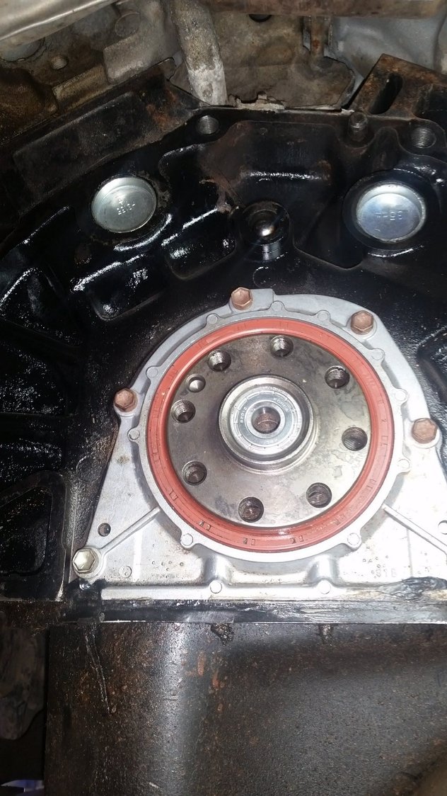

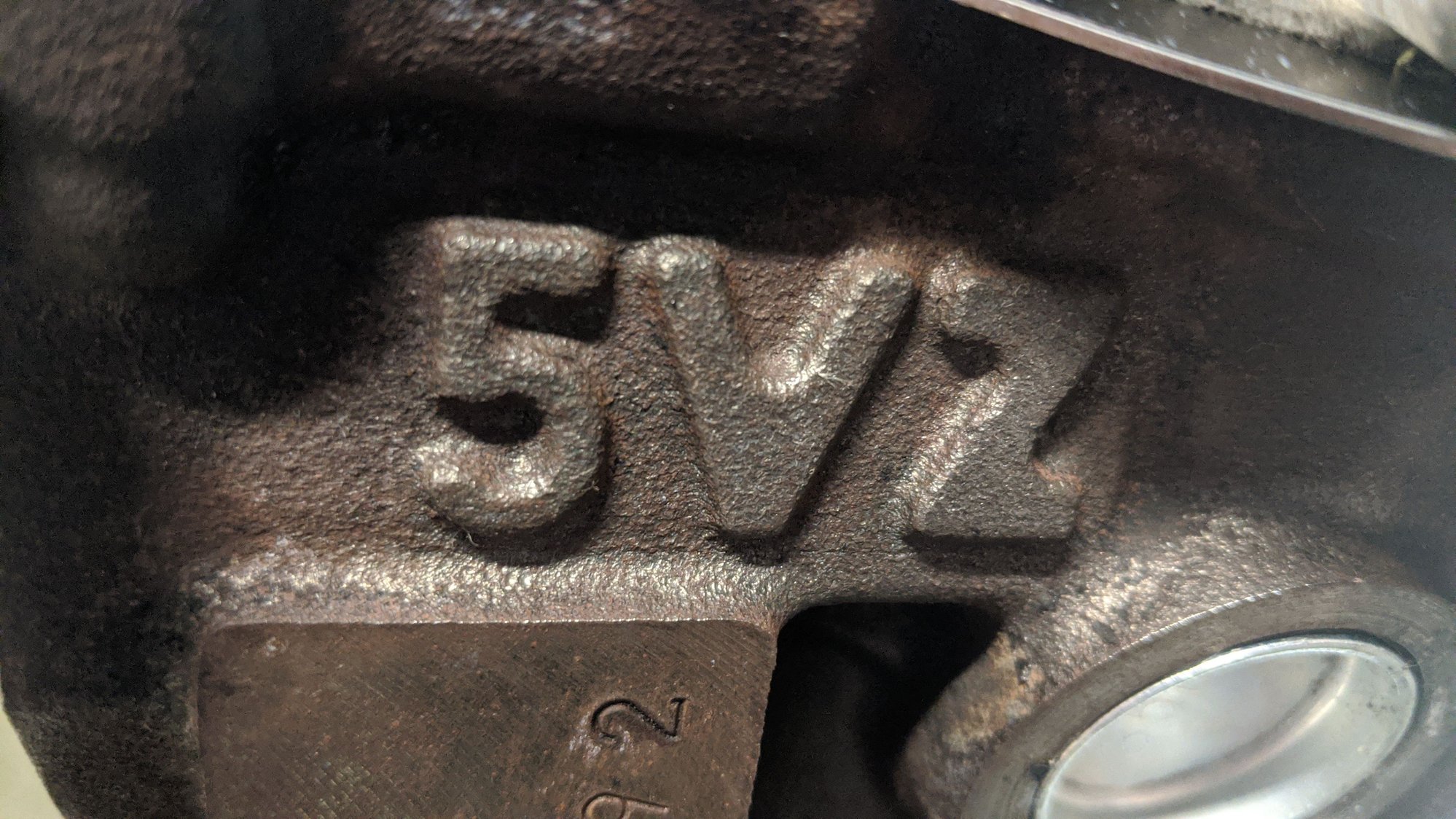

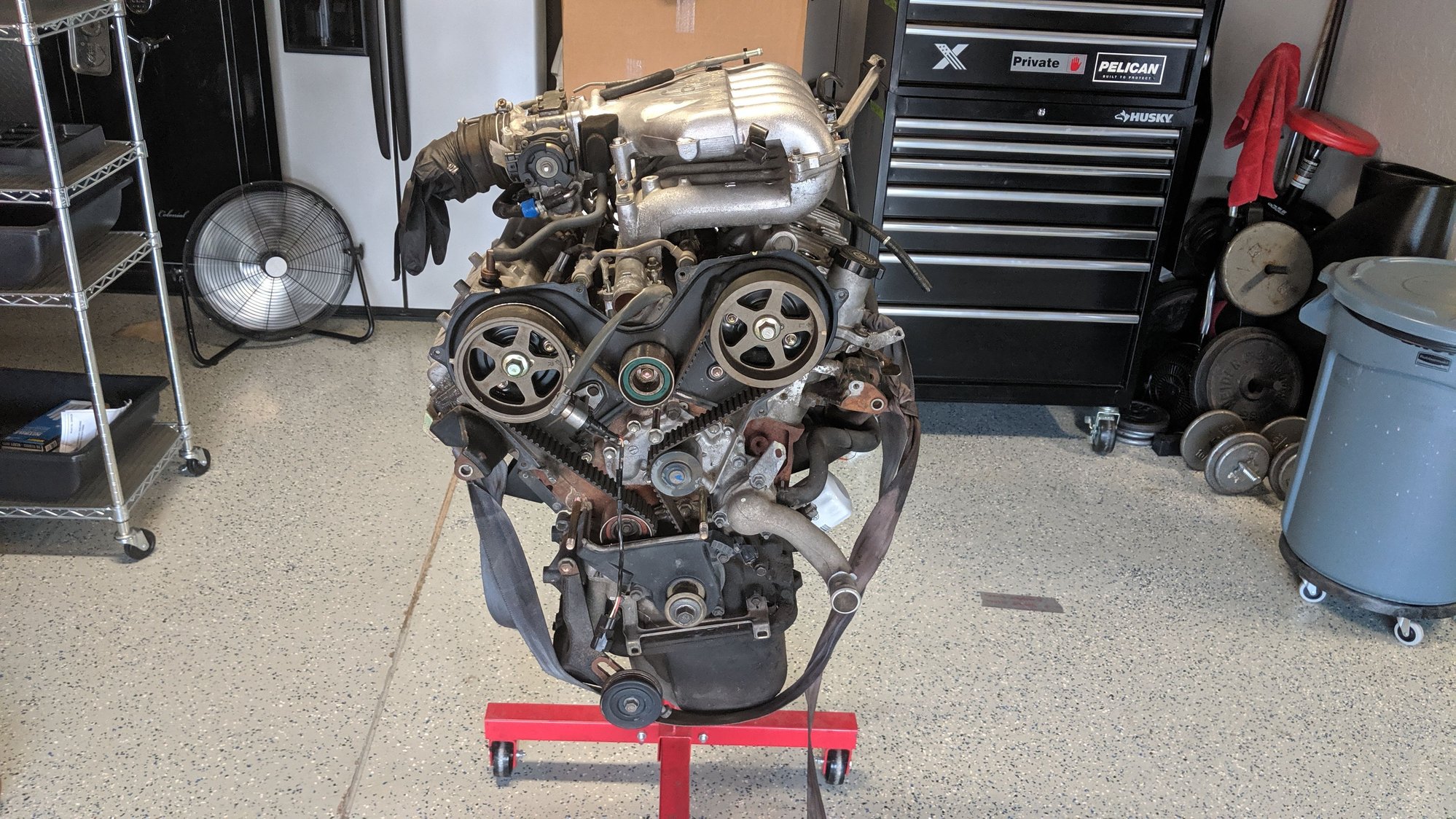

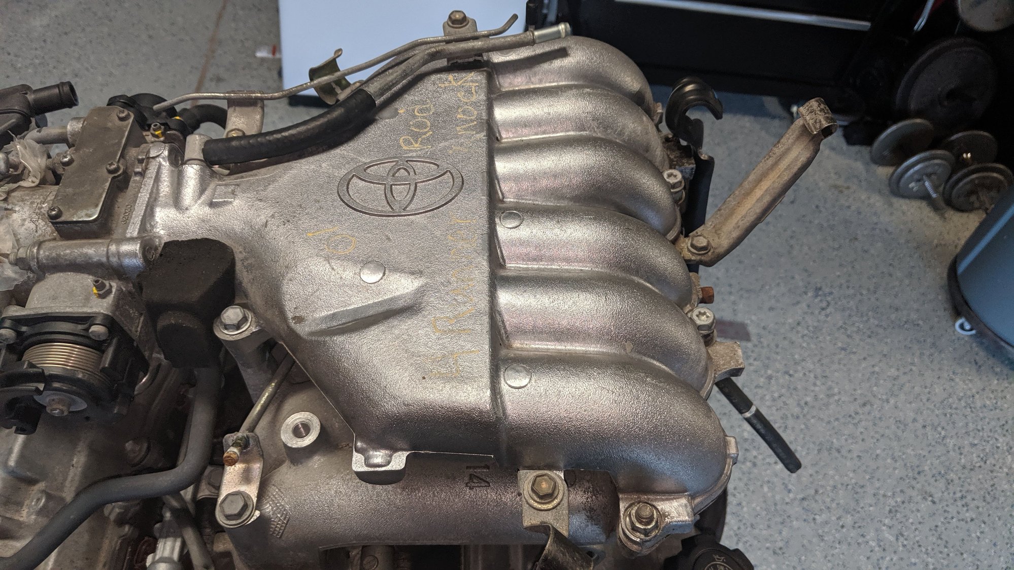

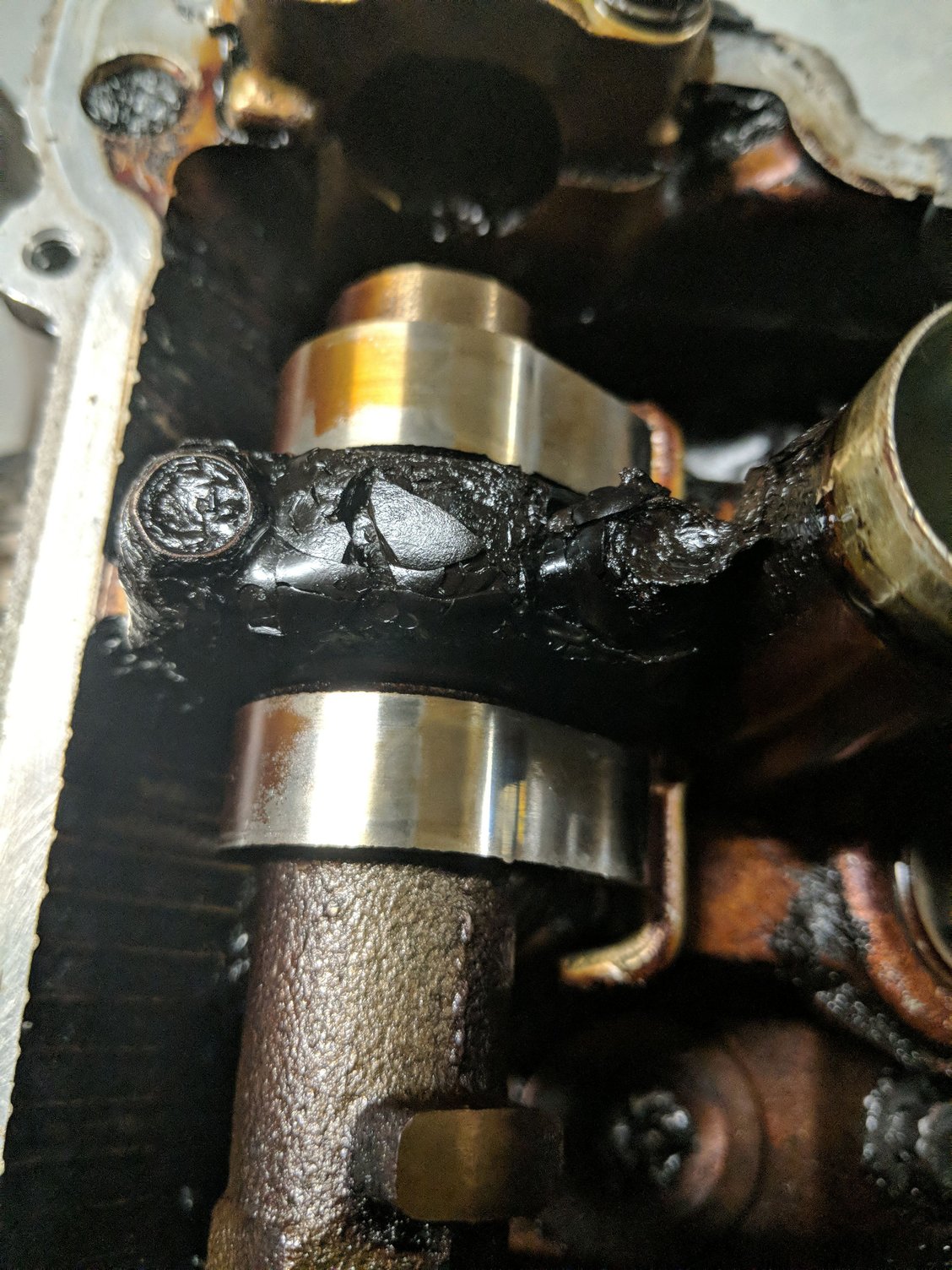

We got a motor! Original 2001 4runner had a rod knock (as the intake states), sourced a 1997 4runner motor and stole it's bottom end because I didn't trust the discoloration on the crank of the 2001 motor. The 2001 top end was really gross, there is no wonder this motor gave it up.
A 2001 4runner motor sourced from my bro!
"rod knock"...you're darn right there was
Dirtiest top end I'd ever seen. Cleaning out the hollow cams was not fun
Caked and angry
That's the #2 main bearing you see there all paper thin

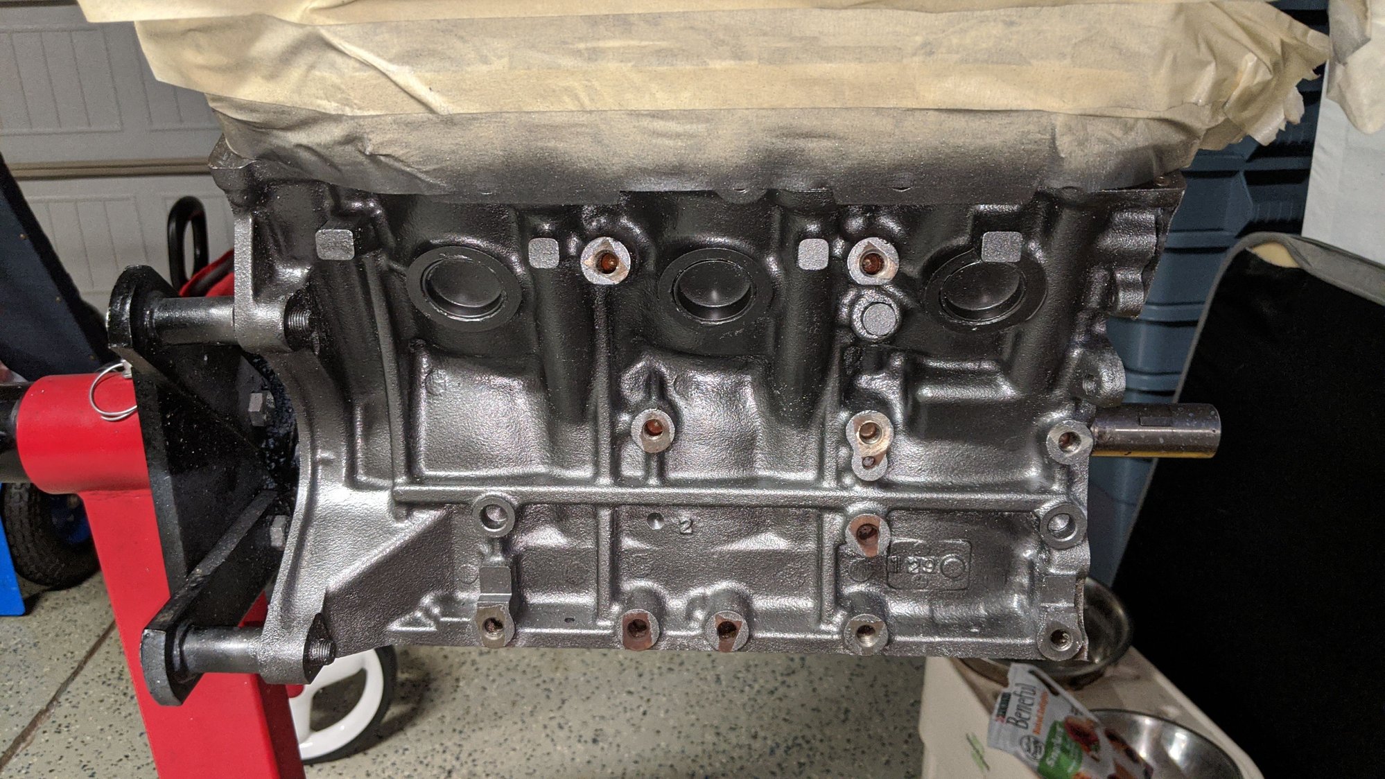

Cleaned up and back from the machinist, ready for torque

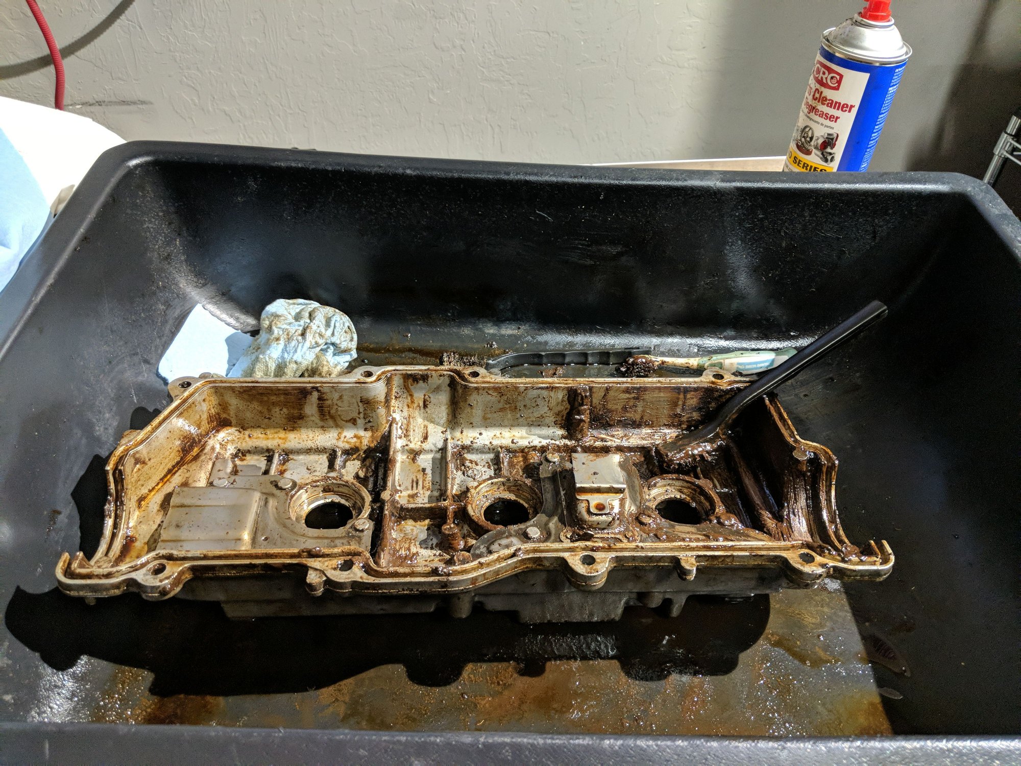

It took me a week to clean these valve covers. The full length baffle held 56.2million metric gallons of hardened oil
Wire in baffle

Block work...
