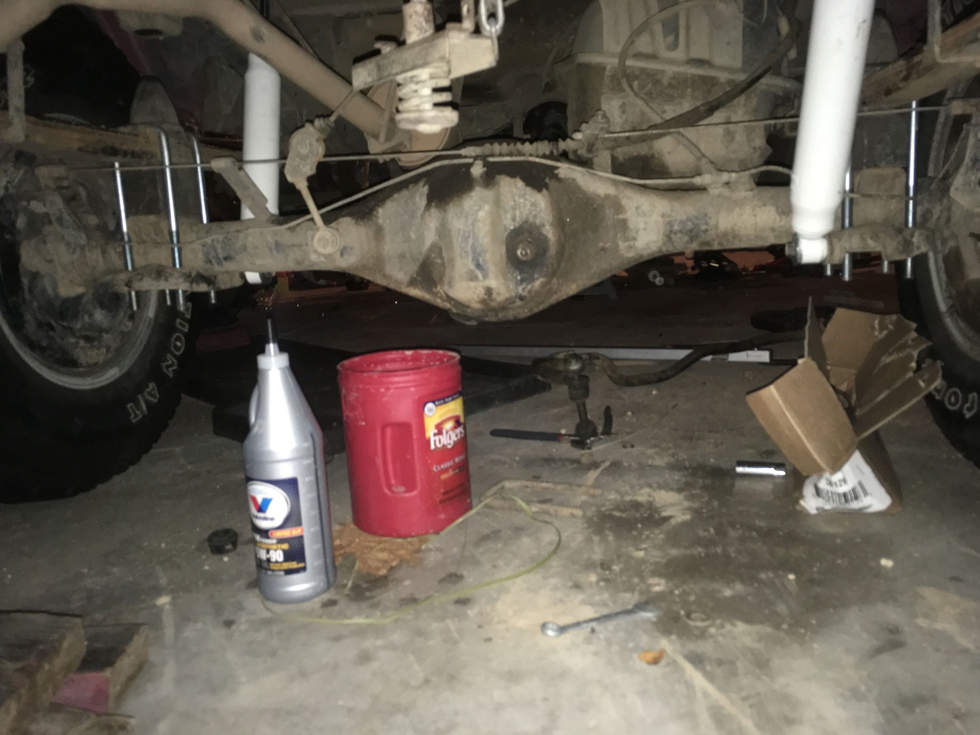

So I got a trailmaster lift for 200 bucks with shocks so I figured that the truck is mostly a highway rig so it'll keep stock geometry and what not. It's got blocks in the rear so I figure I'll find a pair of chevy 63s for more travel and no axle wrap. I had to cut the original crossmember mount but I didn't want to chop the whole thing off

I have the bracket for the brake line drop since it's a bracket lift, but I don't have the additional brake line so I'm thinking of just threading another set of stock brake lines to the existing ones and just having super long brake lines, if anyone else has any other good ideas I'd love to hear them

Son, the U bolts are upside down & set up the other side-

the ubolts are correct for factory. its would be a good idea to do a ubolt flip tho. itll make you remount the shocks on seperate tabs, but it keeps you from snagging those ubolts on rocks.

It's not a u bolt flip kit like most lifted rear ends with bigger spring packs but this is a block so ya know it's still stock and the shock mount is on the bottom, these bolts are just pretty long and a sawzall will make it look better.
