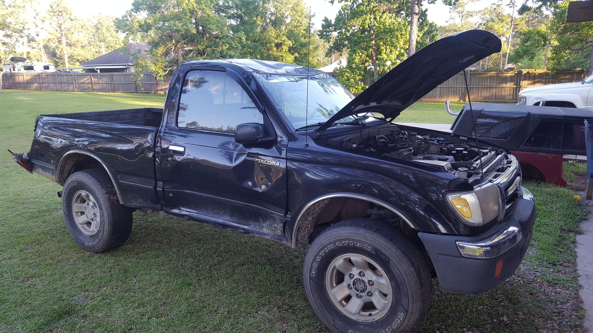

3rz swap
Been a few years but the 4runner is getting a 3rz. Just picked up a rolled tacoma that had a reman engine installed about 2k miles ago. Still has a warranty even and I have all the paperwork!
the 22re still runs great but I want more power.

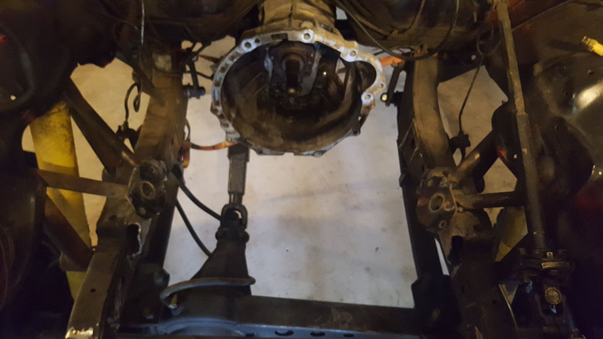

Got both motors pulled. My goal is to get the motor mounts fabbed up and have the 3rz bolted in this weekend.
Old May 28, 2017 | 02:57 PM
  #37
meswoleshane's Avatar
Joined: Jun 2006
Posts: 262
From: Ocean Springs, MS
Got the motor mounts modified and welded in. Still have a lot to do but at least the engine is mounted now!
