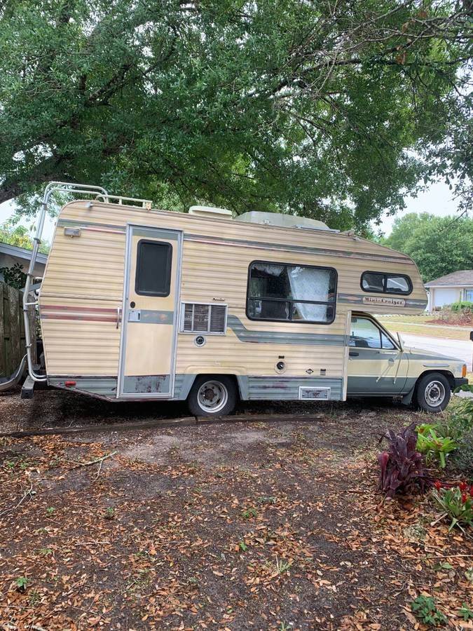

I used to live in Oregon and work at a strange little mom and pops tire and service center. We repaired RVs, and all sorts of other odd vehicles nobody else wanted to work on. I was fascinated with the "house" layouts inside the RVs and always enjoyed taking a peek inside them. But I hated moving the big rigs around, so actually owning an RV never really crossed my mind. Until I met my first Toyota Dolphin! It was a hard vehicle to forget. It was a SUPER weird story, and it was pristine. And it had the most evil "wheel" on it I ever encountered over the years, other than some widow makers and a Humvee H1 with the self inflating setup. The Toyota wheel probably gets first spot too in that list. It was a single wheel, with two tires on it. Turns out it is what's called a "foolie" and is actually what almost did the Toyota RV makers in. If you find yourself with an older pre 1986 Toyota RV and you have a 5 lug "dually" wheel on the back, look up Toyota RV Axle recall and get that crap off of there ASAP! But that's not the story here.
The owner had just bought this thing from some tweekers on a bender. Kinda sounds like they had either been inspired by, or were the inspiration for, Breaking Bad. Stuff was about to be done to this poor thing, bad stuff. He saw it and decided he wanted to rescue it. Asked how much they wanted. $3,000 they said. He pulls out his wallet and makes a show of counting money. And said something to the line of "I have that in cash right now, minus a zero." They said "Deal!" and snatched the money. I think there was a brief time where he was concerned he had lost the $300, but they produced a title and signed it over.
He drove it away not even waiting to go get temp plates. He was a bit worried they would figure it all out. I think he actually stopped at the shop on his way taking it home. The tires were SCARY bad lol! Anyway,s as I loved to do, I asked him if I could look inside. He obliged, and I did. And fell in love! The layout on these Toyotas RVs is amazing for as small of a footprint as they take up! It was the first chance I had gotten to look into a Toyota. I was smitten. I most likely got to drive it too (at least around the lot) as it stuck in my mind how comfortable it was to drive and maneuver. I kept an eye out for more and saw a few around I got to look at closer. Another 1-2 might have made it to the shop to be worked on.
But as I discovered, they were not very common. For years after that, I combed want ads looking for any Dolphins for sale. When I found any, they were too far away or too expensive. Too expensive was a pretty low number too, as I had no real "need" for an RV. I could live out of one, but I am not exactly a minimalist either. I moved to Florida, life went on.
At some point I figured out that the Dolphin, was not the only Toyota based RV made. Probably by accident and not finding "Toyota Dolphin" hits, but coming up with "Toyota RV" ones. I eventually stumbled across a local ad for a Toyota Mini Cruiser. The timing was right too. I had just sold my long term project car, and a storm had damaged another car. There was money for it. We bought it!
And my schooling in all things RV, and some things Toyota, was about to get real... I have been wrenching for 25+ years now. But this was new territory for sure. Starting with it dying right after we paid for it and the title was signed over. In the normal "mechanic buys perfect car, and has to get it towed home" scenario.

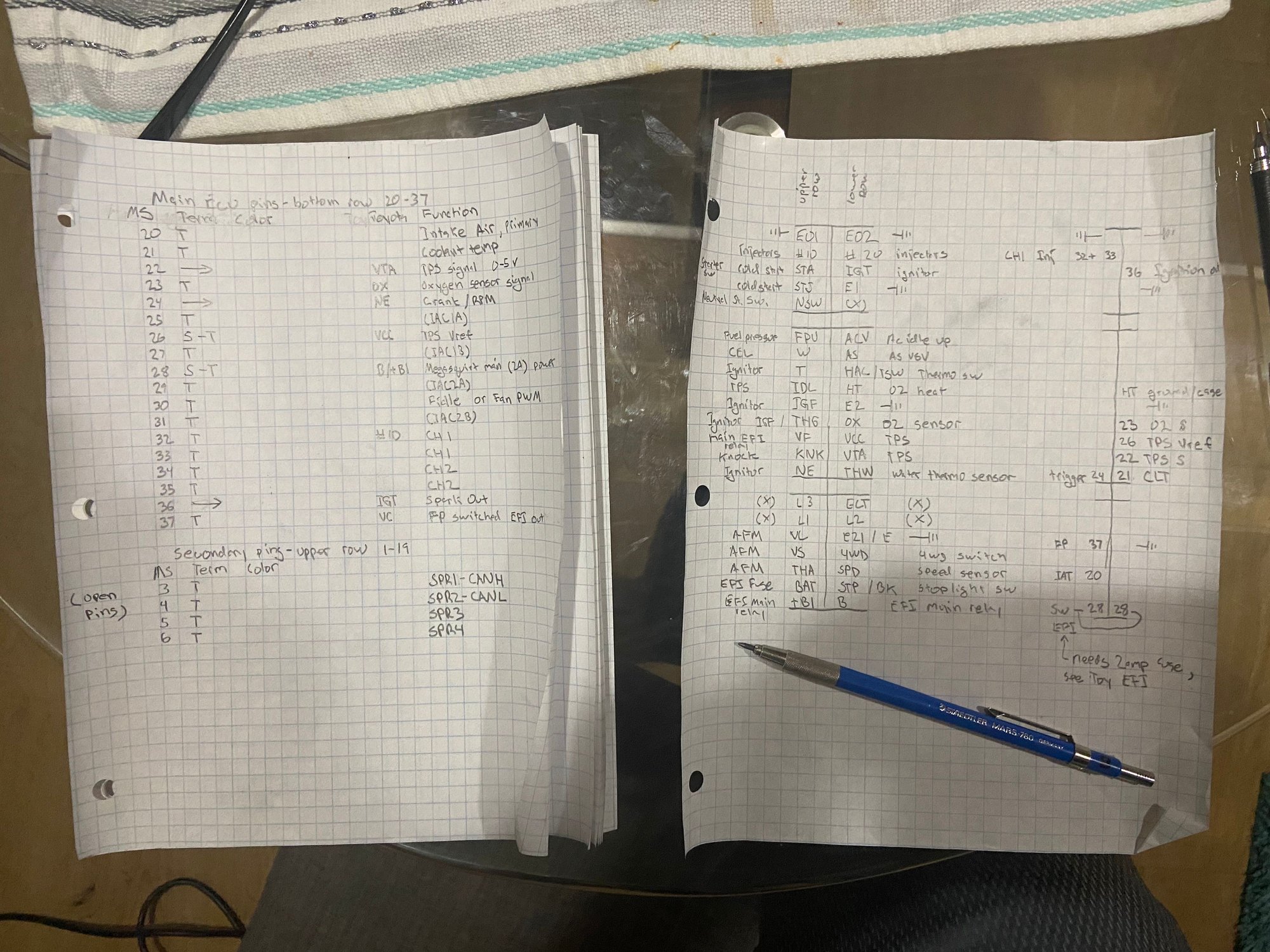

Sorting out new wiring diagrams is always fun! Good preparation here is the biggest trick to making the install go smoothly later on. There were some good resources for this one at least. DIYAutotune: How to MegaSquirt Your Toyota 22RE But their diagrams were a little sparse and confusing. So had to actually dig out paper and pencils for this one.
A couple things I learned over the years of doing this is to maintain consistency, and DOCUMENT EVERYTHING. I use the same templates, especially for the wiring pinouts. A drawn out wiring diagram would be nice, but a detailed plug, pin, wiring colors, and explanation is actually much more useful. Once sorted out on paper, I put it back into my digital template on the laptop.

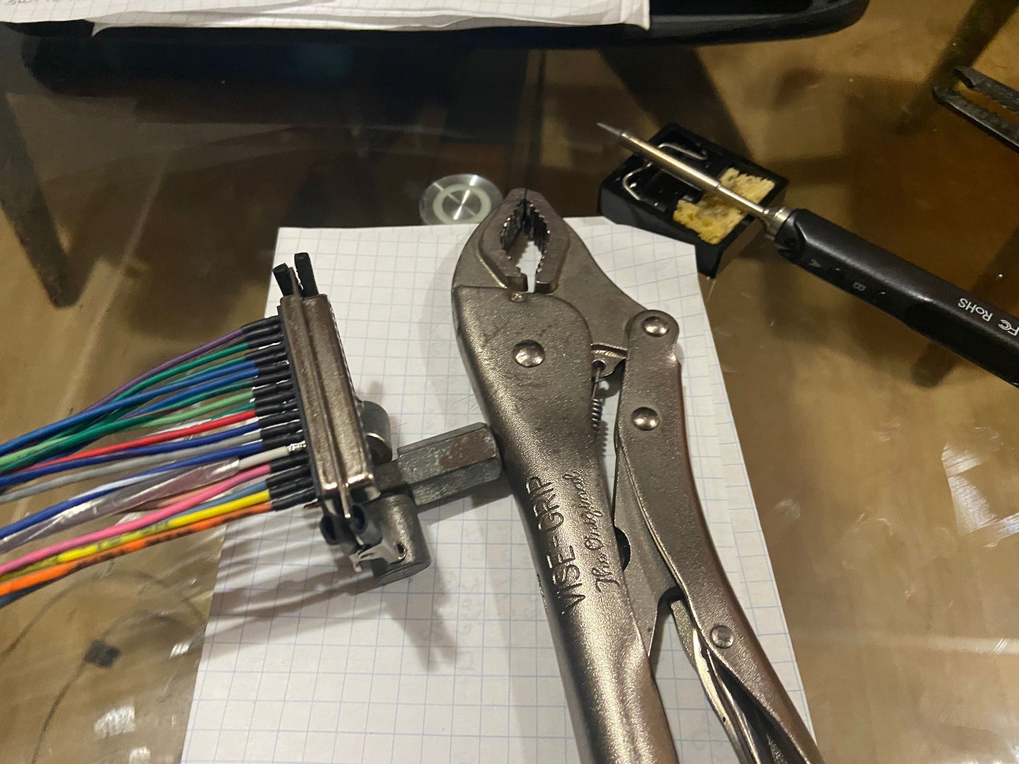

Soldering up the DB37 plugs is probably the most tedious part. And super easy to do badly. Quality wire is critical too. For many years, I have exclusively used GXL wire from KayJayCo But the materials needed to build a good harness are pretty steep. With plugs and heat shrink, the average harness could easily climb past $400. Just for materials. This time I used wire bundles from DIYAutotune. The quality of the wire insulation seems just a little bit lower, but the printed labels is very nice. And the price is defiantly right. Most likely I will have to order another pack or two if I actually go and build the whole engine harness from scratch. For now, this is just an adapter/extension cable. I am leaving the factory harness in play.
All that is left to do is to put the ground wires in and then decide how many lines got through, or utilize the terminal blocks. Leaning towards all of them passing through the blocks, then I can have quick and easy test points.

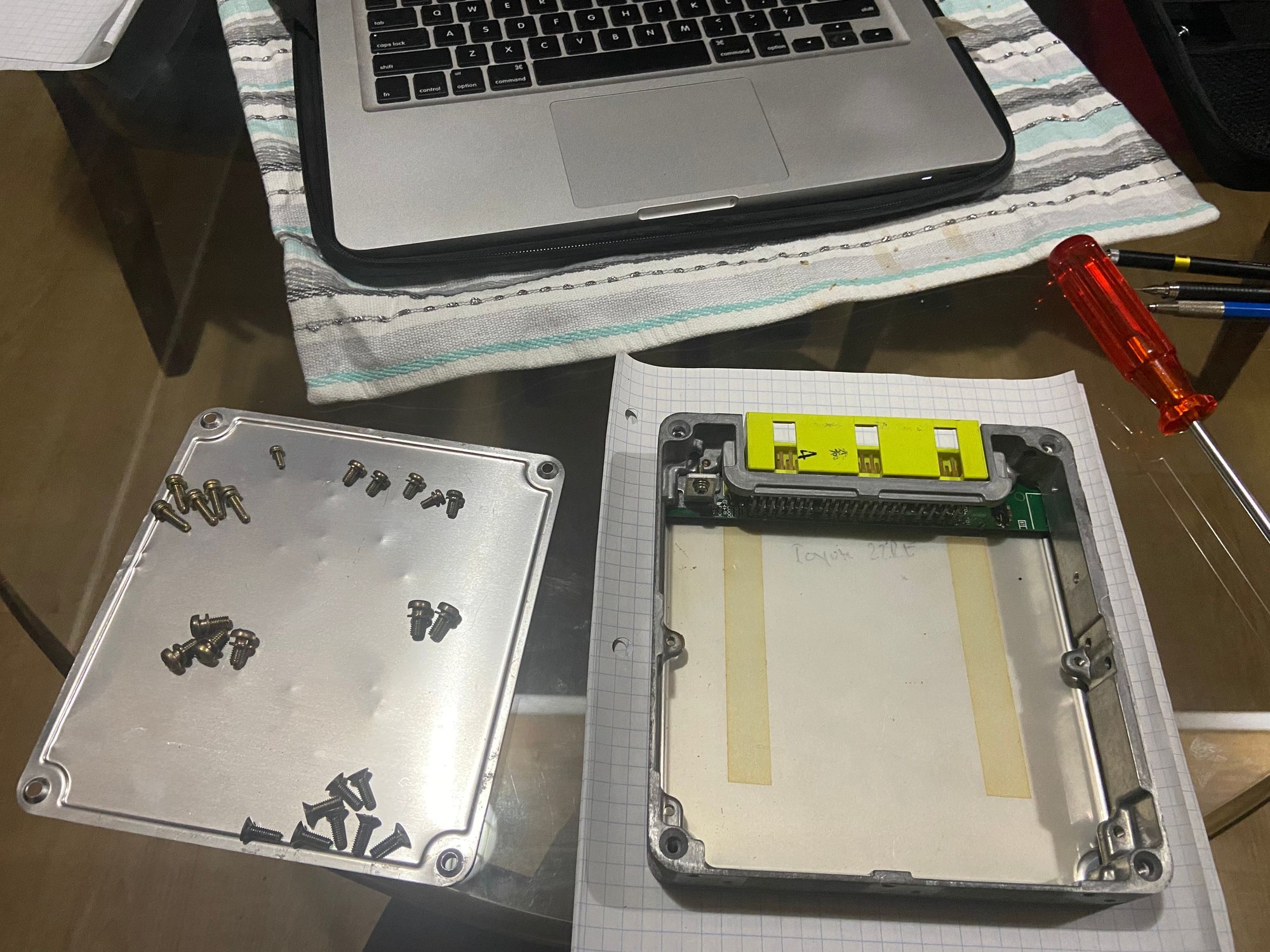

After a lot of thought, I decided on this for the location of the MegaSquirt. I was going to put it where the factory ECU was, but it would require surgery to the body sheetmetal to fit it in there. And I would have had no place to hook in additional stuff or customize. This is a pretty decent compromise.
The next part , soldering to the ecu plug and installing the blocks, should go a lot quicker. I have to verify a couple details of the factory wiring first though. I am optimistic that it might even power up today for the initial tests.
