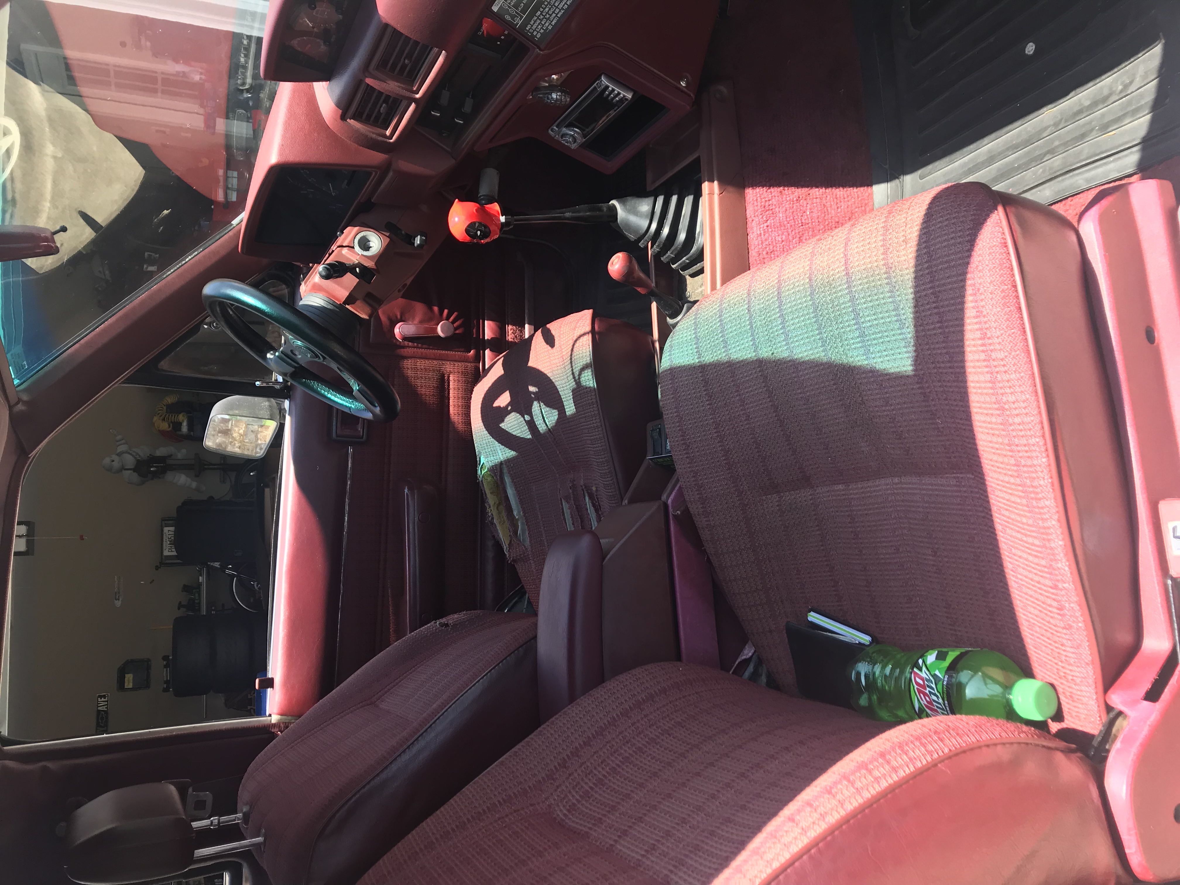

On Friday, I picked up my first Toyota! I’ve been on this site for quite some time but I finally got my hands on one. Got it for $4900, and it’s probably one of the cleanest I’ve seen around here. It has a 2 inch lift and brand new 33” BFG’s. Took it out today on the trails to stress test it and see what I need to fix and what needs to be modified. It scrubbed a little so a larger lift is definitely coming and that 22RE is probably not going to be able to power this thing for long. This build may be very slow, one income with two young children so y’all bear with me. Today I fixed the tailgate latch that was giving me issues and I will update this as often as I can. I hope you all enjoy!!

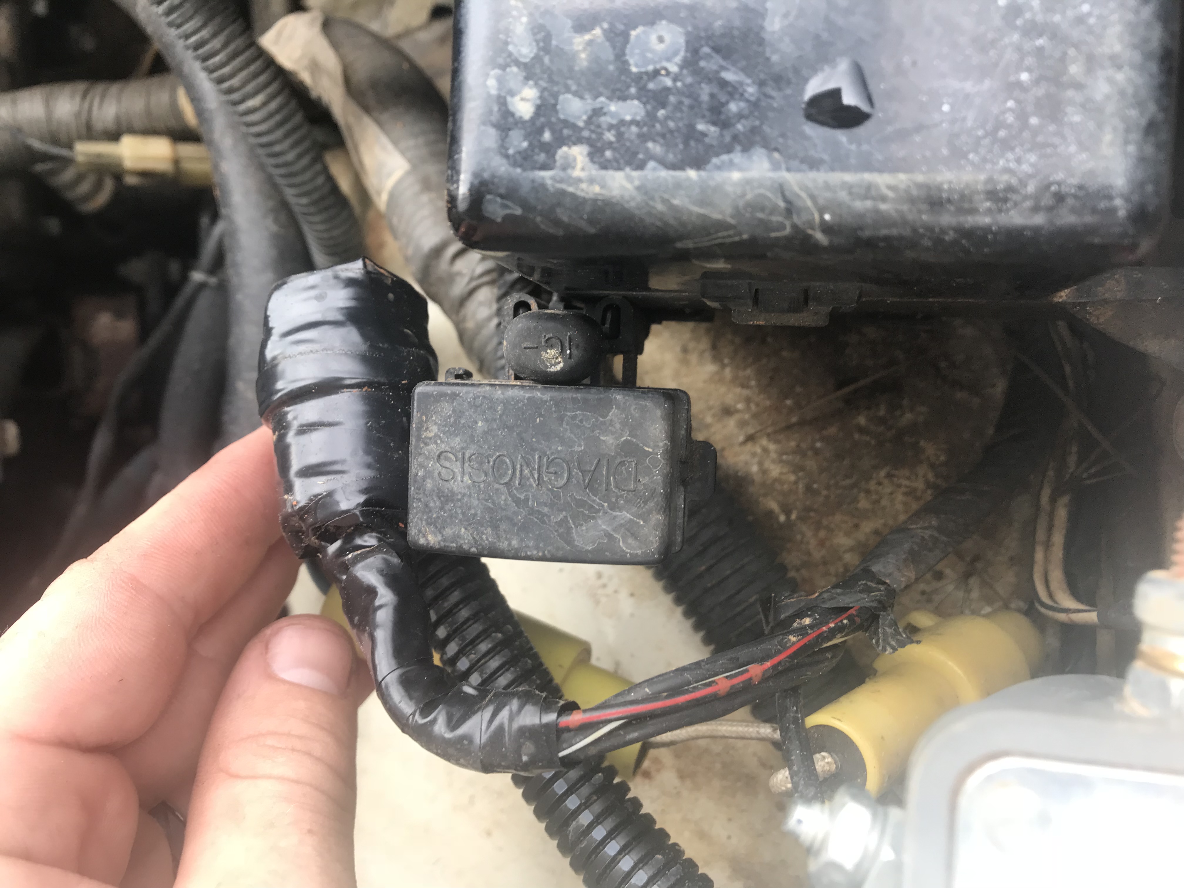

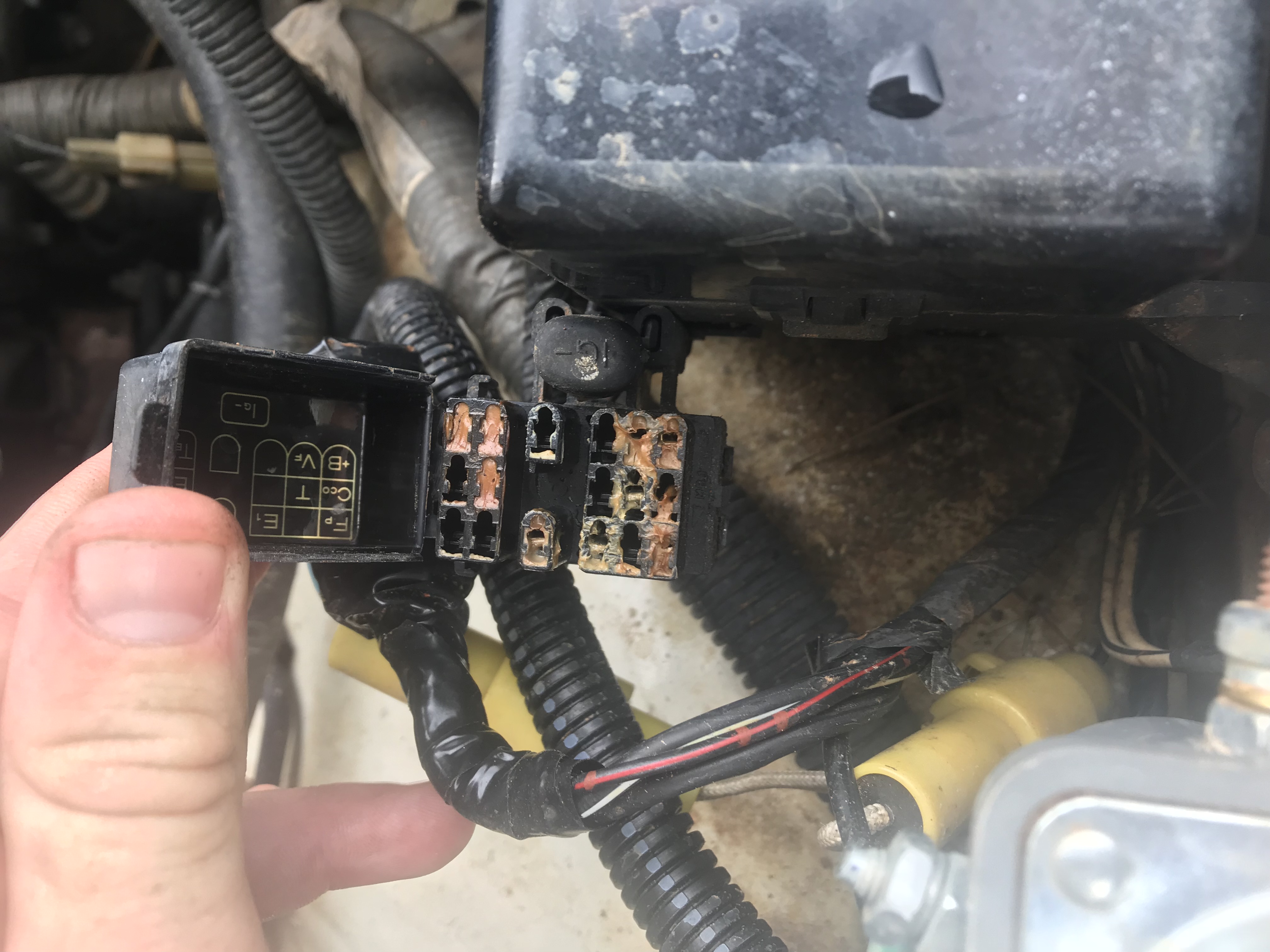

Well ran in to more gremlins today, dash display went out, only thing that works is the speedometer and the odometer. Headlights work thank god but wipers and blinkers don’t. Shut it off to go into a store and came back and it wouldn’t start. No crank, nothing. Ended up having to jump off the starter relay, I’ll add that to the list of things to replace. Found a hose that’s ripped, The positive and negative cables need to be replaced, I have got to find out what’s causing all the electrical issues, they’re killing me. I’m going to upload a picture of a little fuse box that says diagnostics on it. Someone please tell me if what I see is normal or not. It looks like hell and filled with dielectric grease.
