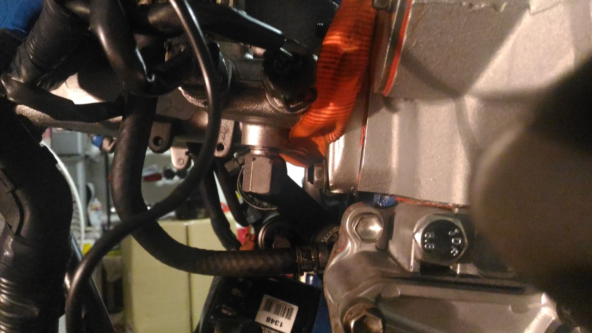

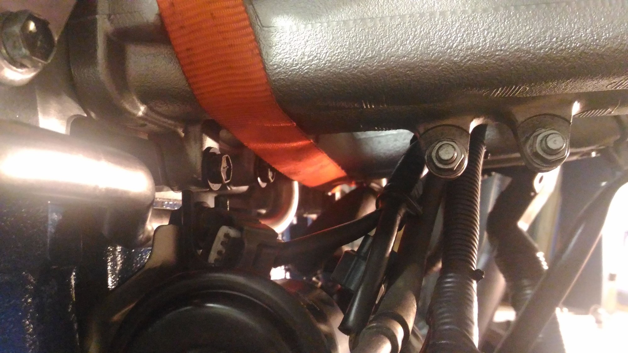

I personally wouldn't want to lift 4-5 hundred pounds by the manifolds, but to each their own. Besides, the upper intake at least has to come off for wiring.
The wire harness is already on and connected. But I have no other option really. I dont have the hooks and there are no 22RE in any junkyards around here.
I have a long strap I will wrap under both the intake and exhaust manifolds. Everything is torqued down so I don't believe there will be any damage but I wanted to be sure.

Just bolt a chain link to the factory location or something. Can't be that difficult to find something that will work

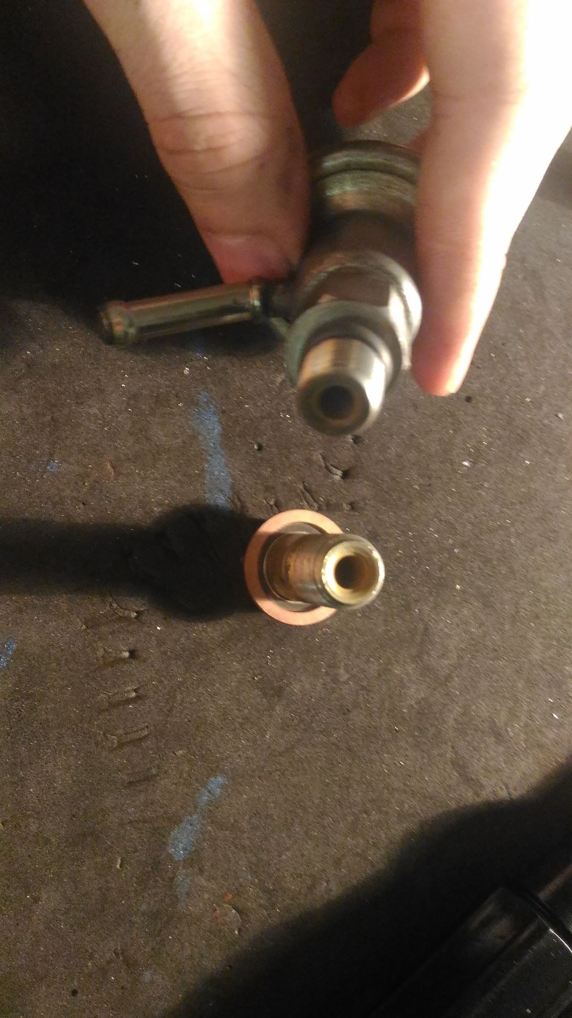

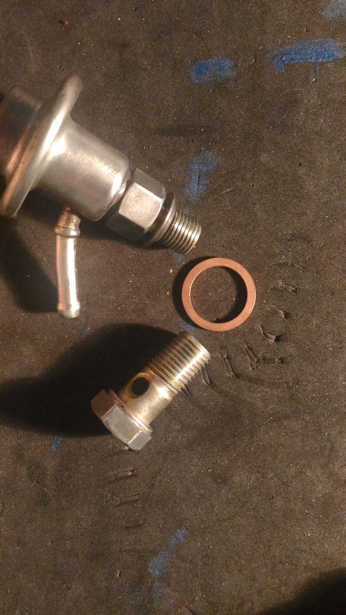

So I thought this washer was to the fuel regulator, but it is to big. I can't figure out where it goes.

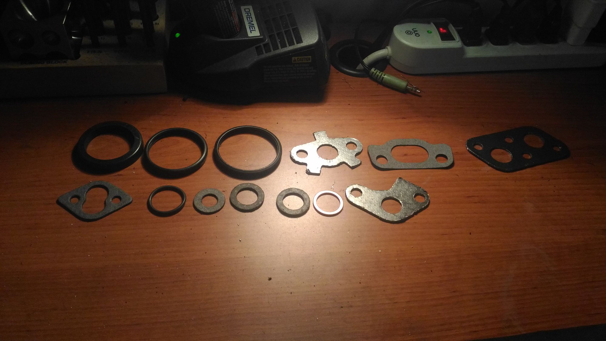

At the gaskets I have left. Felt circular ones?
Where I am planning to lift. Like like it should be OK.
