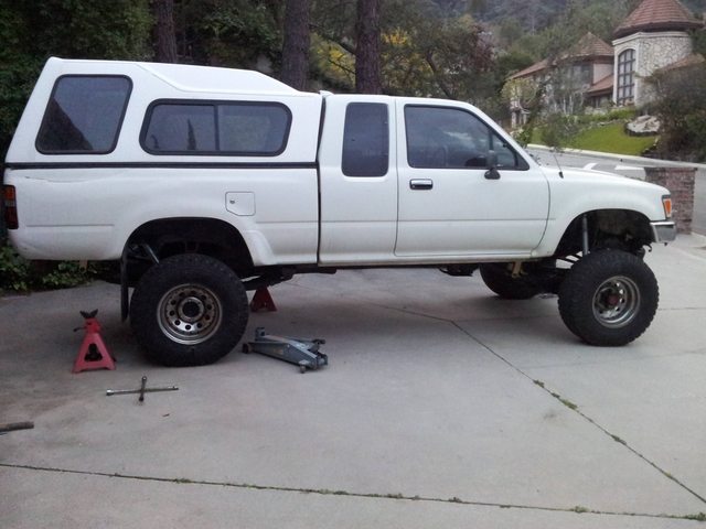

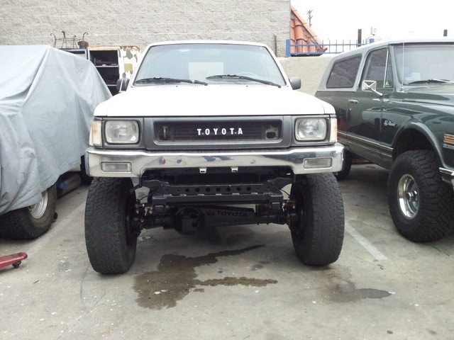

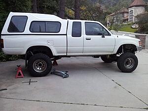

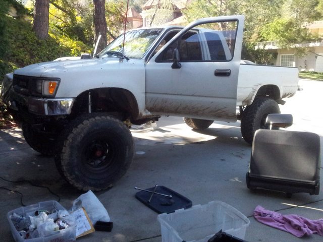

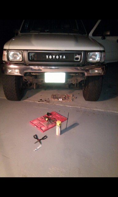

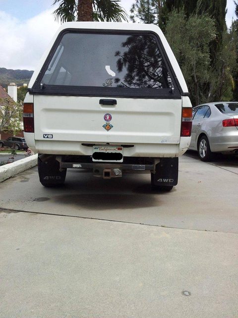

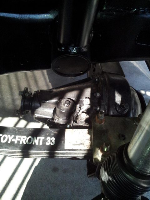

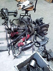

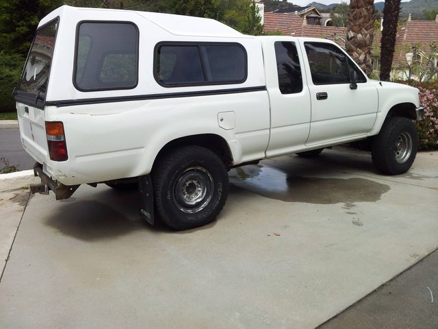

it's been quite some time since i started gathering parts and now that stageOne is done and she handles quite well...pics
the before shots:
the pile

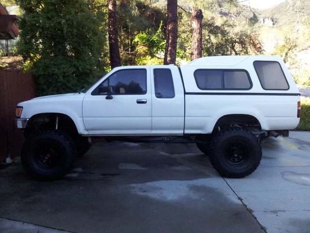

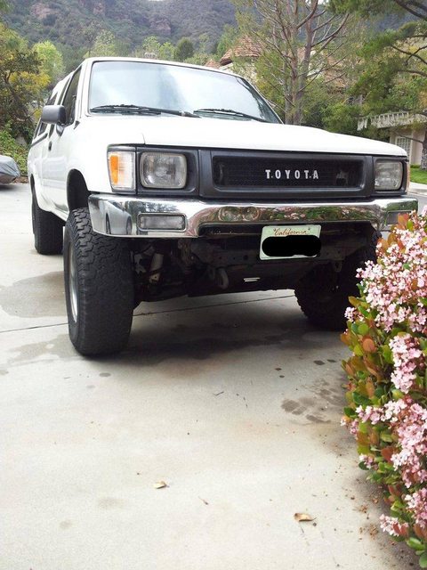

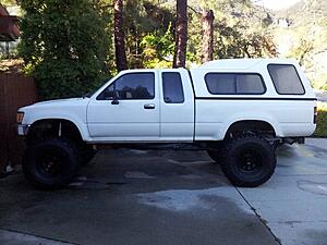

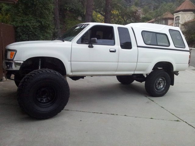

the aftershots:
shoe comparo:
shoes on
after a day run to lwv.

Some build threads take days or weeks or even months!! Yours on the other hand..
Awesome build, man! Looks really clean and orderly. And I like the grill, looks like an FJ!

thank you!! was worth it....learned a ton, met some great people, and she handles quite well.
What kit you go with?? You have any ifs lift stuff for sale?? I also like the grill. different dont see that often. Als nice k5 parked next to her in the one pic! Nice build!
i went with allpro, 4" kit.
i still have ifs parts can sell, yes. in westLa.
that K5 is the smaller one to haahahaa!!
Originally Posted by A2theK
Lookin' good man! I need to start gathering parts for mine too, did you regear as well with those 35's?
thanks, i did regear. 5.29 in '98 elocker and '04 elocker, and nitro gears installed by just differentials (great folks!)
with the 31s, and 5.29 was hitting 65-70 3500-3700rpm and with the 35s back to ~70mpg@2900-3100. holds the power better too, no more shifting to 3 then 4 then 3 then 4. she holds 5 VERY well and if i keep momentum up some grades....but likely, traffic requires a downshift to 4th. yea mpgs suck skunkballs.

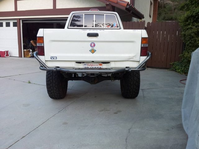

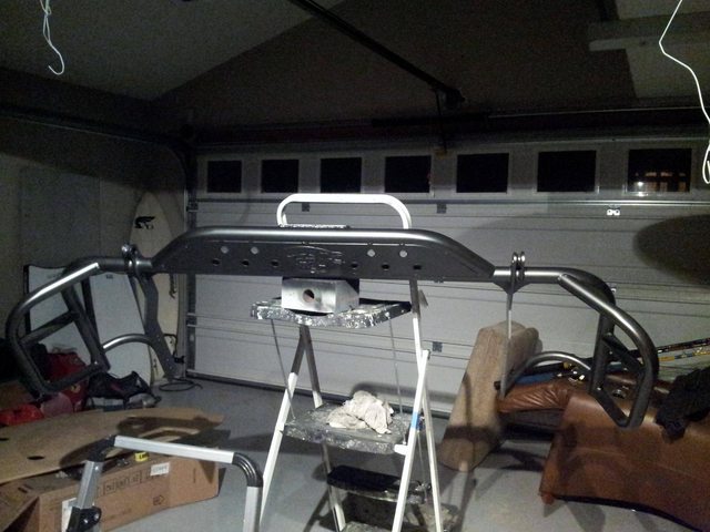

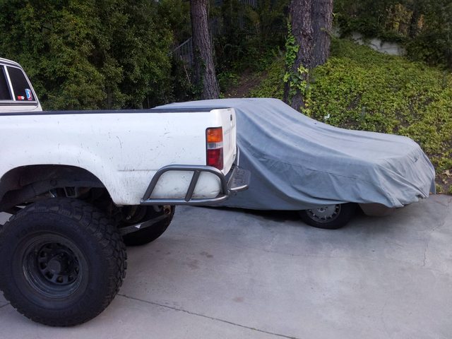

small update:
a little update:

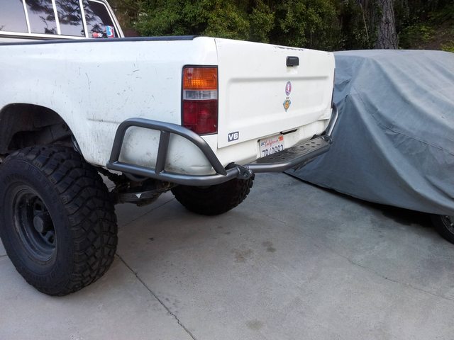

got a MC rear bumper. painted it tue night and got it on the truck yesterday. not the easiest thing to do solo.

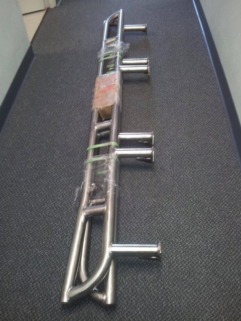

sliders arrived~!
now just to get em put on.

Bumper looks great...tight fit

Very nice truck. Love how tight the bumper hugs the bed of the truck.

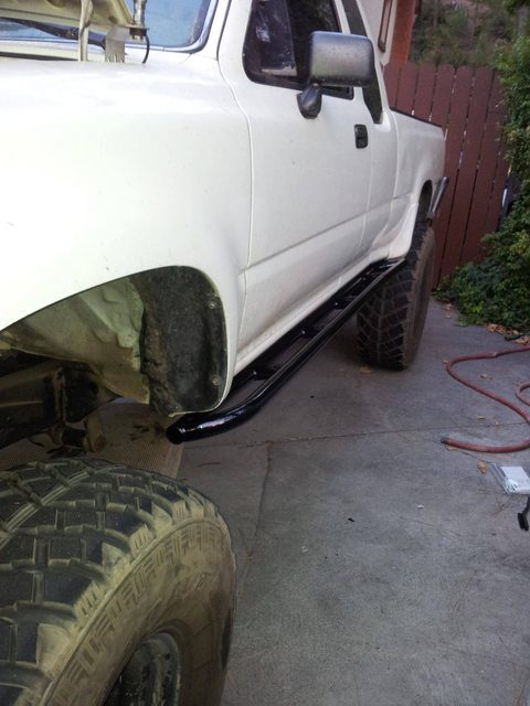

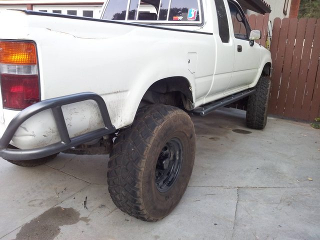

sliders are on, and i have a nice burn to prove.
gonna go paint em.
they did quite well on the maiden run out with them.

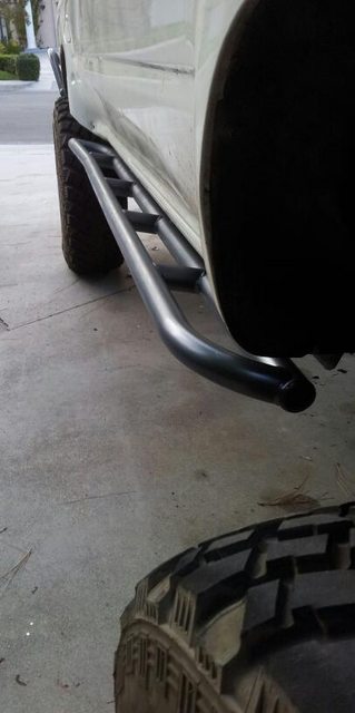

sliders painted.

one more slider pic
