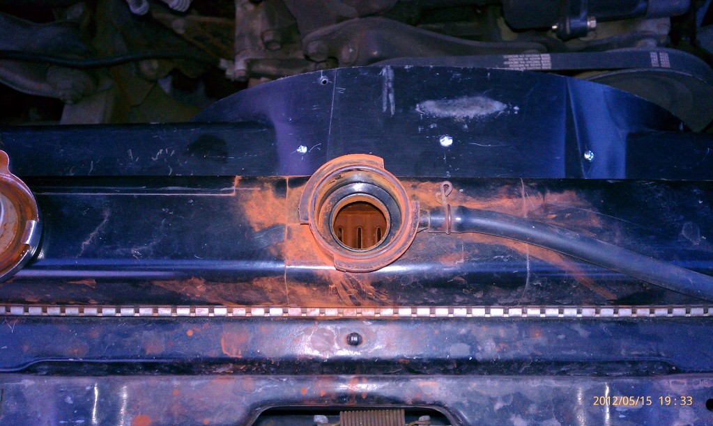

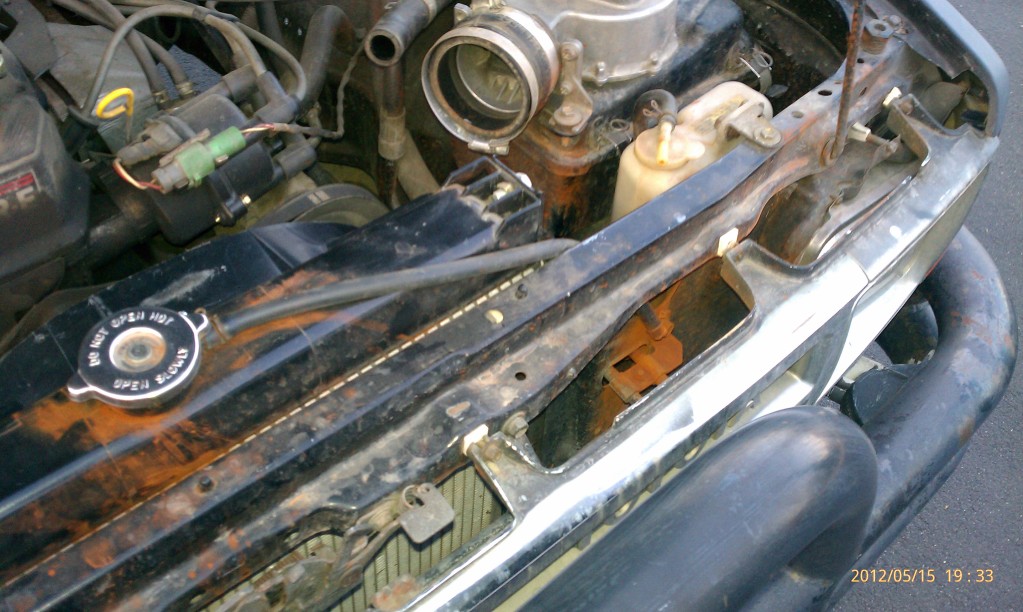

This what I opened up on Saturday morning....
Rust all over the front...

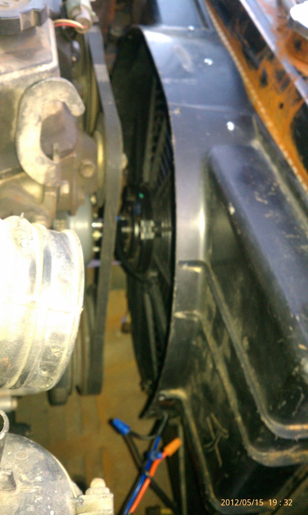

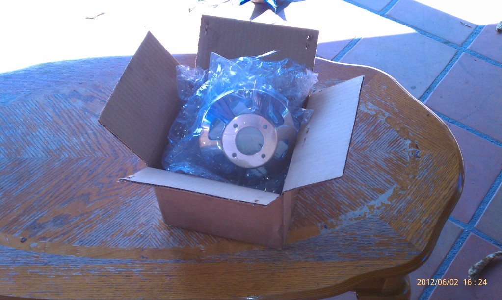

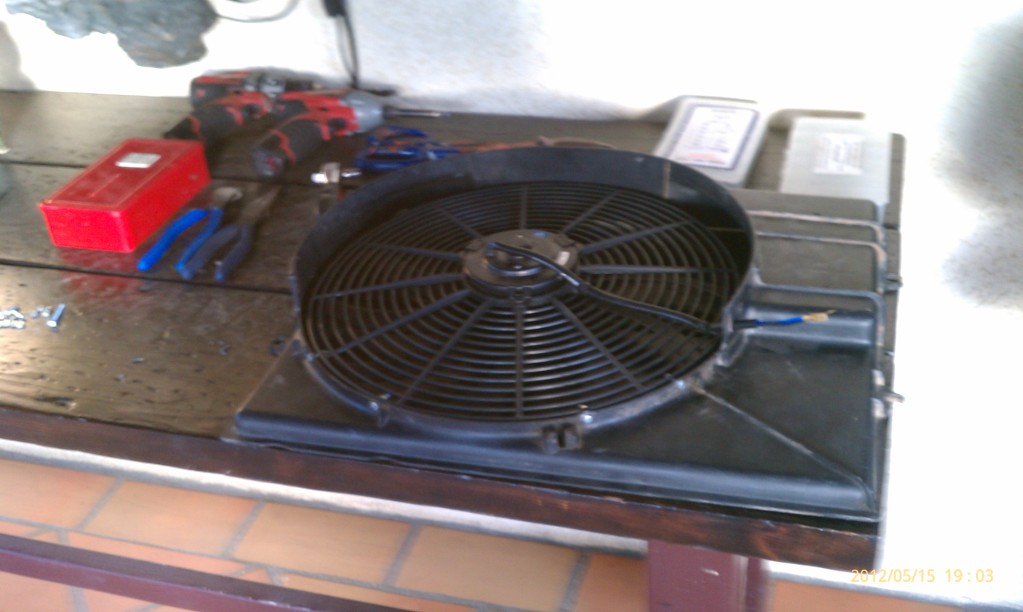

He's a preview of the fan in our shroud...
My cuzen was with me when we started taking things apart, We found that 3 blades were broken off the plastic fan im assuming thats why it over heated...
then he had the crazy idea to put an electric fan with automatic control on it...
he had one he had just ordered for his 89' 5.0 Mustang that was smashed by a littel old ladie, he let me have it for free...

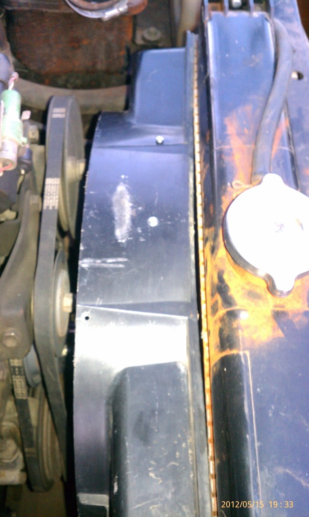

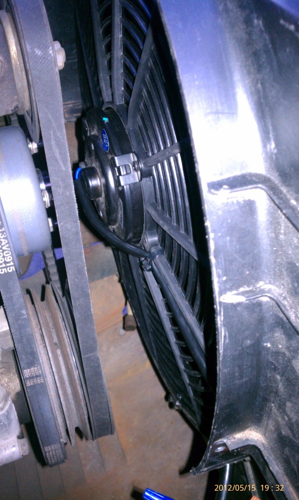

I attached the fan to the shroud with 6 10-32 screws w/ springs so there would be tention on them...

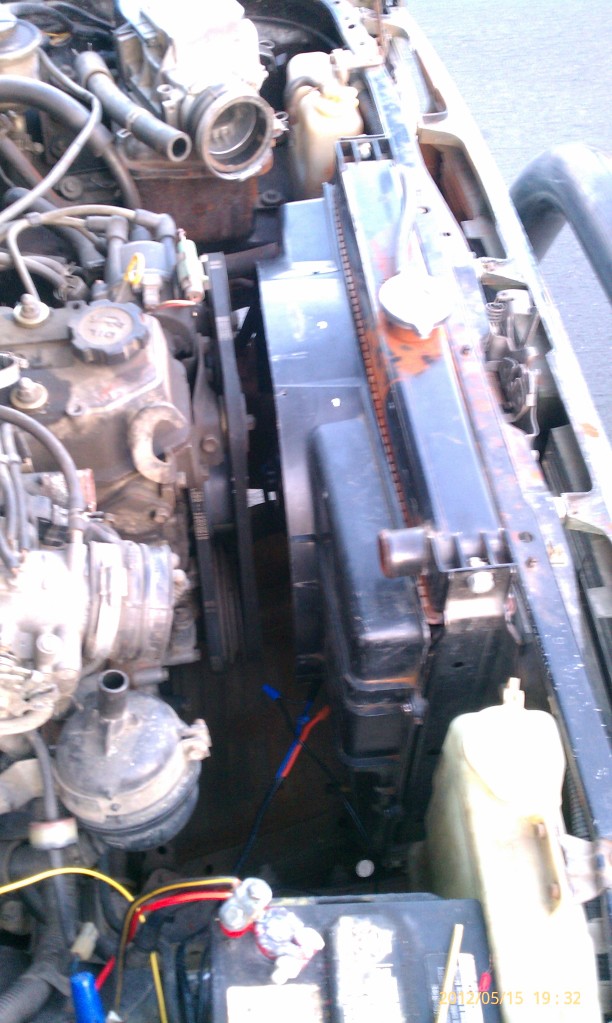

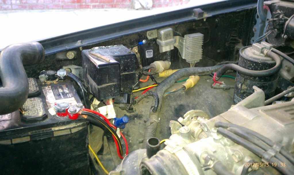

I installed the rellay next to the the stock fuse box...

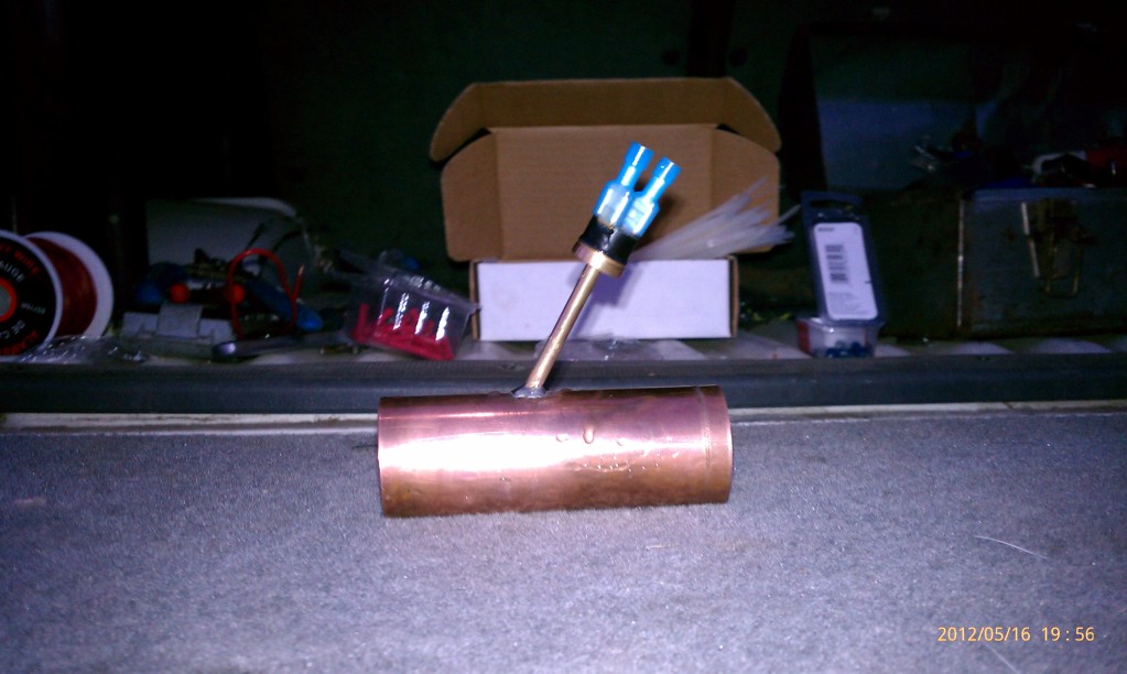

and made this up for the term. switch...

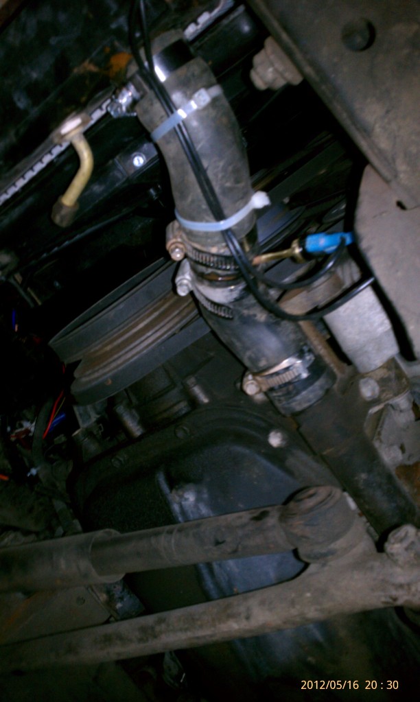

first i installed it at the lower radiator hose but i didnt think, that is the out put of the radiator. Coolent would be cooler there and it did make my truck run a little over half...

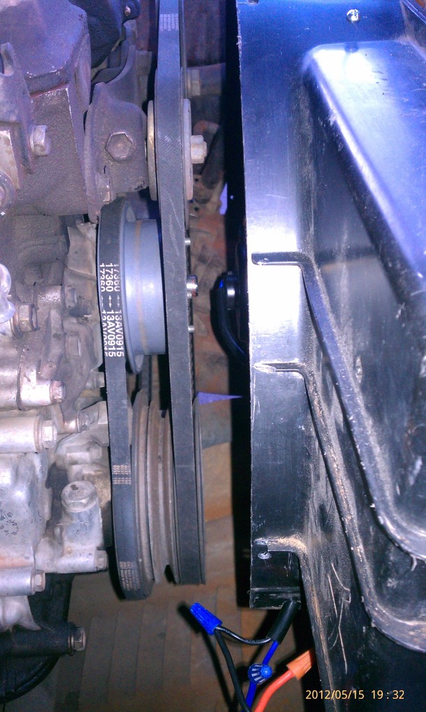

then i did a test fit and everything seemed okay nothing touched nothing rubbed and i would not be braking any fan on the trail again...
So Then i order a new radiator form autozone, and this little thing from LCe
figured i try it.....
works great no pics of install sorry...
on;y thing know it never goes above half and fan dosent come on unless Im stuck in traffic, kinda sucks in winter cab heater dosent get hot...
