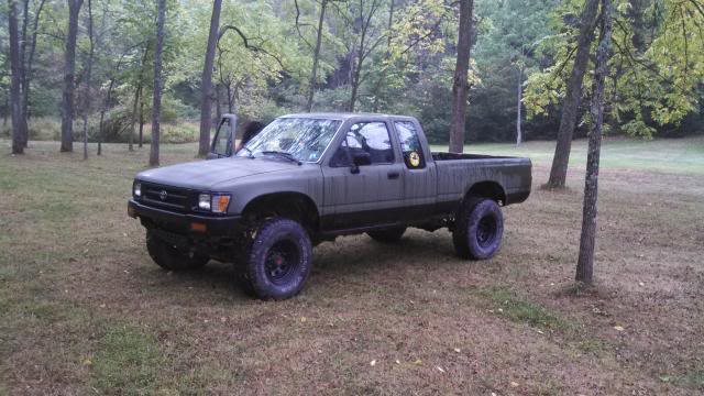

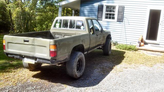

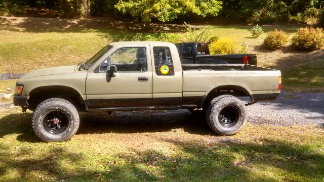

A couple days ago I traded my 87 4runner to my buddy for his pickup. Its a 93 extra-cab 22re with a 5speed. He recently put in a new clutch and timing chain with metal guides, it just rolled over to 300,000 but runs awesome and drives like a dream......... well at least it will soon. Hopefully. It has a lot of play in the steering so i just ordered a pitman arm, idler arm, ball joints, and tie rod ends from rock auto. It also needs new shocks but they will come a little later down the road as I already just dropped a dime on it. It needs a little love here and there but nothing major. I will be upgrading here and there as the wallet allows haha. My buddy had 33's on it but we took those off and put my 31's on pro comp steelies on it. Well heres a couple pictures of it anyways.

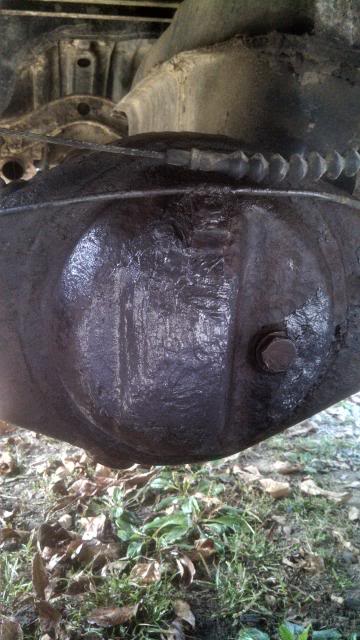

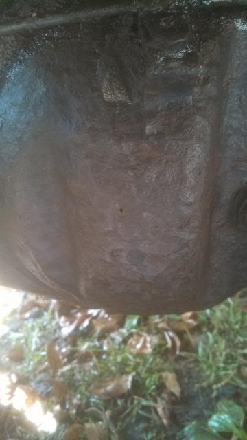

Little bit of an update. I have noticed for a while now that my rear axle was leaking gear oil from the back of the diff cover but I just kept filling it up every so often. Well I finally got in there and started poking around and saw a couple pin hole rust through spots. So today I bought some degreaser and JB Weld and patched up the worst of it for now. Going to try to make and weld a cover over the whole rear diff, if I cant acomplish that just going to buy a new axle housing.
And after the temporary fix

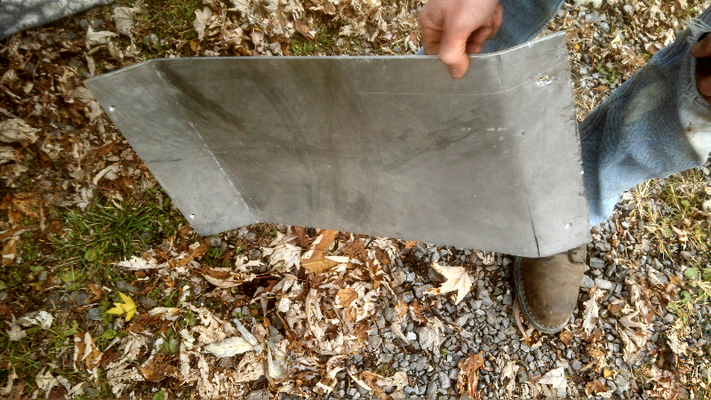

A while back I got a sheet of aluminum 3/16" thick and 13"x4' long that I planned to build a front skid plate out of since I torqued all the bolts off of my stock one. Finally got the chance to cut it up and get it bolted to truck with the help of a friend. We cut straight edges on it, took some measurements, heated with a torch and bent it, then painted it up. Pretty happy with how it turned out, its not the best protection but it'll definitely take a beating and its better than not having anything( or the flimsy stock shield)

Nice job on that skid plate!

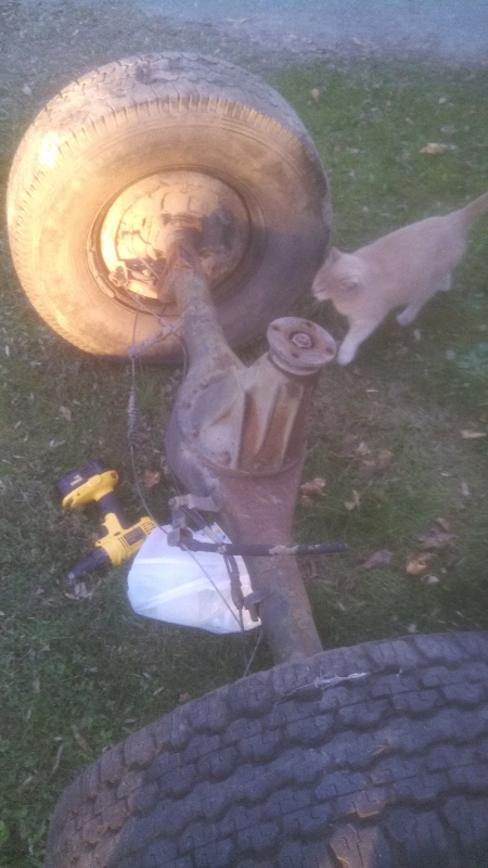

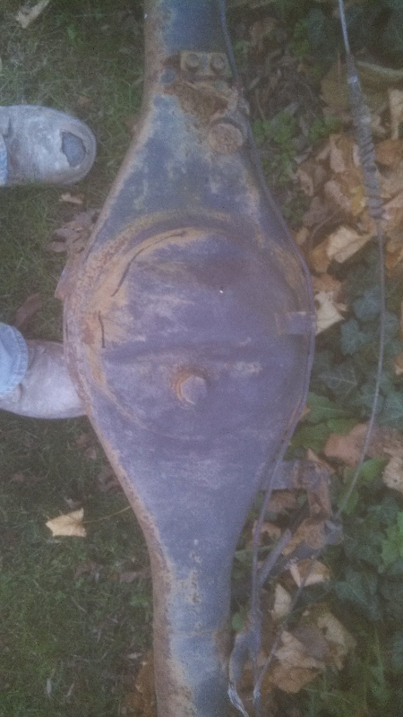

Bought a new rear axle tonight to replace my rusted out and leaking one. Its all but in perfect condition and out of a turbo 4runner so it has 4.30 gears or whatever they are but im gonna give the 3rd back to my buddy I got it off of and swap my 3rd in. Gonna get some stuff after work tomorrow and spray it with rust inhibitor and spray on bed liner.

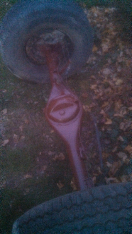

Got a little work done to the axle, just cleaning it up and prepping it for install. Started off by wire wheeling all the cruddy old paint off of it then got a nice thick coat of rust reformer primer on it. Going to finish painting it tomorrow after work. I still am amazed by him clean it is and still has the original paint on it! Anyways here's a couple pictures of it so far.

I had to junk out an axle one time as it was rusted up to bad. As thick of a metal that they use on them, it is surprising at how bad they can rust.

I know its crazy how eaten away mine is and just how thin the metal is in some places.

Thanks man it only cost me $8 to make and that aluminum is actually some pretty heavy duty stuff, took alot of heat and a big sledge to put the bends in it. Im located in south central PA about an hour north of harrisburg.
