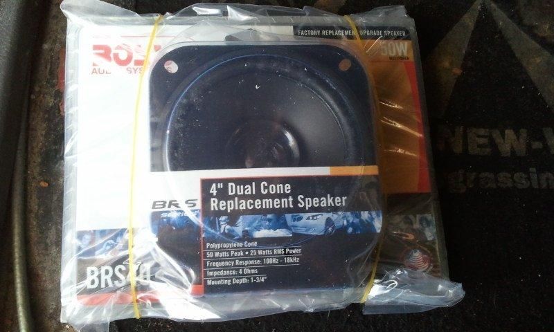

Got some alone time in the garage this morning. A few weeks ago, I ordered these 4" dash speakers of Amazon, they were super cheap and got some decent reviews, so I bought em. Also, they come 2 per box, I accidentally ordered 2 boxes, so I've got 2 extra speakers if anybody wants em.
They fit pretty well into the dash spots, kindof have to bend or trim the metal tabs a little to get both screw holes to line up right.
Unfortunately the PO cut holes in the doors for the front speakers, I removed the speakers from the doors and put them in the cargo area and wired up the new dash speakers. I'm going to have to figure out something to cover the holes in the doors. SR5 map pockets might work, I was also thinking of making some kind of cupholder.
Also finally got my new CV axle in. Since I had already pressed the studs out of the stub axles back when I swapped the diffs, changing the CV was not really too bad. The old one had no ball bearings in the outer joint and it was completely separated.
