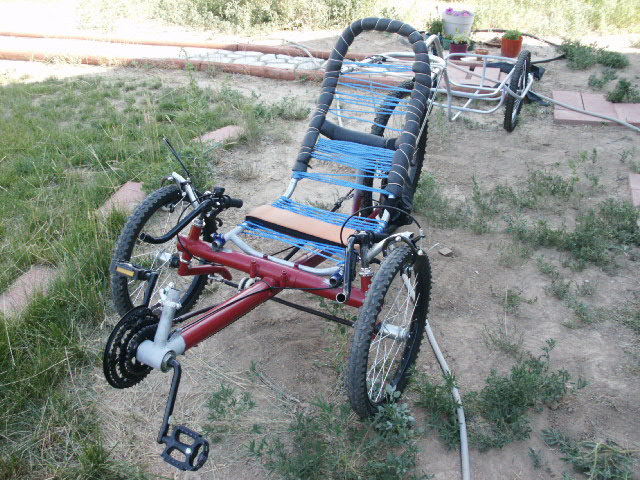

And for some original filler content.
My custom trike and trailer, before I got the canvas seat cover installed. It is a recumbent delta trike with removable cross member, my design and build on my back porch.
