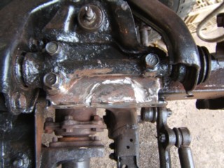

V6 motor mounts cut off
cut the old mounts off, new ones going on tonight..
Attached Thumbnails chopitrakeit's 1995 Pickup Build-Up Thread-motor-mounts-removed.jpg   chopitrakeit's 1995 Pickup Build-Up Thread-mount-removed.jpg
