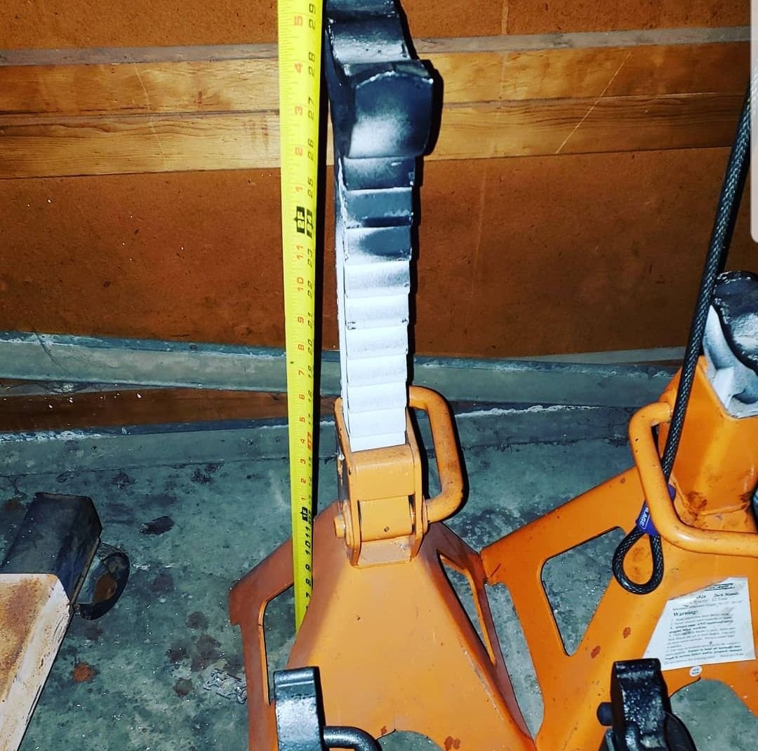

Originally Posted by CreeperSleeper
Those would have to be some damn tall jackstands! LOL
I have 2 sets of 12 ton that go up to 28"
came in handy when doing the suspension on the trekker and again when I stripped that truck
I do like the engine hoist idea though!

I have a couple of those too. Even with the tires off, I didn't have enough droop of the axle to pull the leaf springs. The first time I used a 60" Hi-Lift and scared the pee out of myself. The hoist worked great! LOL

I cut a couple 4X4s to build up a platform for jackstands nothing like blocking and bracing to get a job done. I don't like to go much higher than level and use cross legs of sliders hold rig. I'll never use a hi-lift again to fully droop suspension. Almost dropped rig last time, I use cargo straps to limit suspension droop to change tires.
