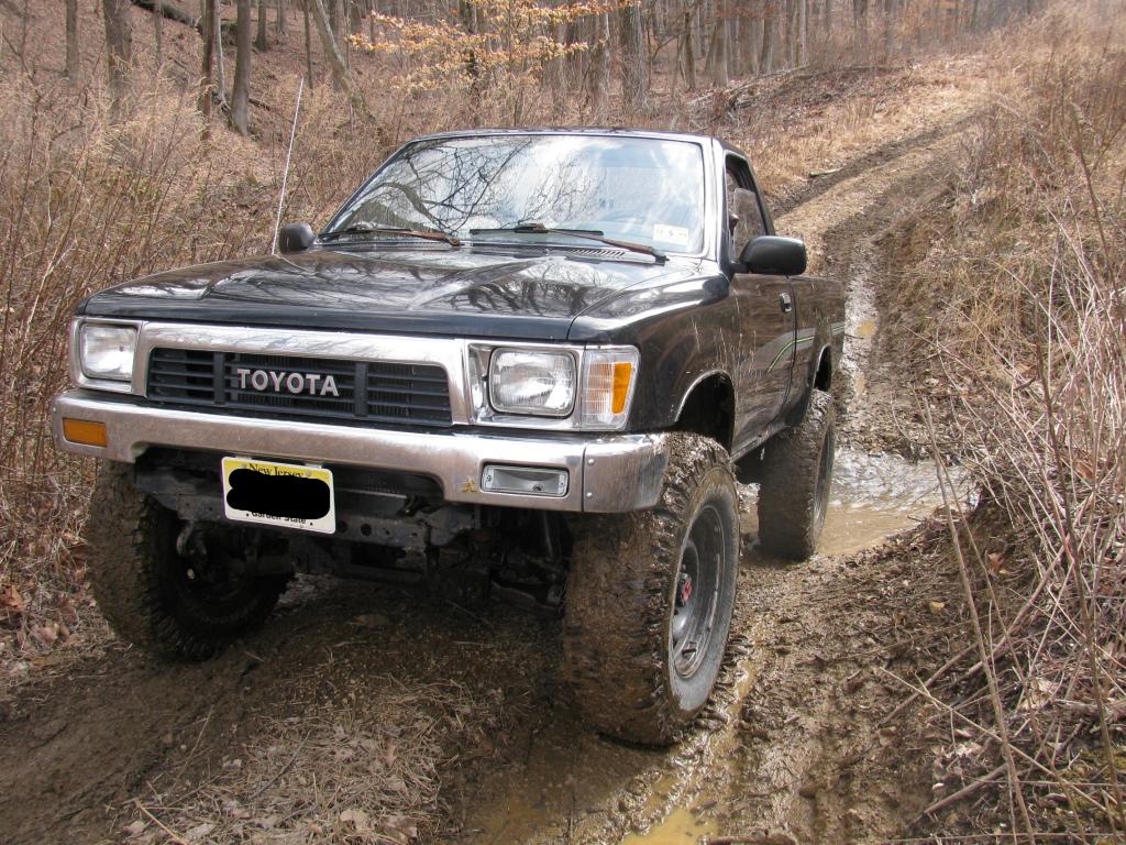

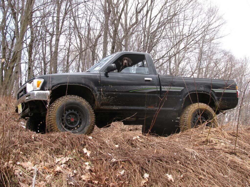

Fittingly I "resurrected" my Yota over Easter weekend in between mass, food, visits with the grandparents, etc... As soon as I finished installing the new exhaust I was so psyched to get back in it and drive it I forgot to take pictures before I got it dirty-it looks better with mud on it anyway
I started around 8:00 a.m. Saturday morning with the front wheel spacers and then got the new tires put on. I love the way the 265/75/16s look mounted on the Tundra steelies-the fit on the truck is awesome too. They're also on the narrow side (10.5"), which at least for me was a plus because I'm running 3.75" backspacing (4.75" on the Tundra wheels and 1" spacers) and an 11.5" or 12.5" tire would have required fender flares. Too much $$$ and I don't really like the way they look anyway. The tires still stick out a bit, but not enough to attract the attention of the police I don't think:
After I got the tires on it was time to get the rear shocks straightened out. They were kind of a PITA but worth it in the end I think. The Chevy shocks have a steel insert inside the rubber bushing whereas the Toyota shocks just use a plain rubber bushing. I caught a thread where someone used a 3-jaw puller to press the steel insert out but when I tried it the rubber bushings tore. I ended up taking the bushings out completely and replacing them with these:
http://www.energysuspensionparts.com...e-Bushings.asp
I used part number 9.9105-the ID is perfect at .75" for the Toyota mount, but the OD is a hair too large for the Chevy eyes so it took some work with the Dremel and some lube to get them in there. After the shocks were done it was time to finally put an exhaust on the thing. I was dreading that part because I was afraid of breaking a manifold flange stud, but it turned out fine. I had soaked them in PB Blaster a few times earlier in the week which seemed to pay off. They came out with minimal effort and a long extension/deep socket. The Bosal exhaust really fit up nice and didn't require any tweaking, beating, or cursing
The hardest part was salvaging the old O2 sensor since I had to grind the old studs off and pop them out with a punch. The old exhaust was so bad when I got the truck I had never heard it WITHOUT a leak-at one point when I was stopped at a light I blipped the throttle just to make sure it was still running
I headed out to drive it around town to see how it handled with new tires, springs, shocks, and no sway bar (honestly didn't even notice it was gone) and to burn the grease/shipping labels off of the exhaust. The 32s are definitely noticeable in terms of gearing. Starting with a heavy load is probably going to burn out my clutch soon, so a new Marlin clutch is on the list. Other than that I don't see a huge difference in performance which is another reason I'm happy I didn't go any larger. I'll get new gears one of these days, but with 4.10s and an empty bed I was able to to accelerate in 3rd and hold 45 MPH in 4th up a 6% grade which is fine with me. This truck won't see much highway driving so 5th is really irrelevant. The ride is definitely rougher than it used to be, but not to the point of being annoying, but then my DD used to be an F-350 which I'm sure colors my perception of it. It will be interesting to see how it rides with a heavy load in the bed. Now for the fun part-the TIRES!!!
I am thoroughly impressed with the Guard Dogs, but you also have to realize that before them the only wheeling I did with the truck was on P225/75/15s. When I took the truck out to my wheeling/cutting/hunting spot, stuff that used to require wheelspin and a prayer now just requires 4HI and light throttle
The Guard Dog tread only has a slight hum to it on the highway, but they dig in like mad in the dirt. I went farther down the trail than I ever have before with no problem whatsoever. I'm sure any good mud tire would have yielded the same results, but the fact that these were brand new $110 mud tires is what's remarkable. Even in spots where I got nervous because I was out there alone with no winch (I have a few buddies in town who could have come to pull me out that were a cell phone call away but still...), the Guard Dogs just dug in and powered through. I haven't locked my rearend yet either-still wheeling with open diffs front and rear. I honestly can't imagine the traction getting any better, so once my Lincoln Locker is done this thing is really going to be a beast.
All in all I'm really happy with the way it all turned out. Between the tires, wheels, spacers, shocks, springs, exhaust, and little miscellaneous stuff (not counting the major tune-up/brake job I did about six months ago) I put a little less than $1300 into the truck. Not a bad start-it'll haul this winter's wood with ease, get me to work on nasty days, access my favorite hunting spots, and do a little weekend wheeling now and then. There's a long list of mods still to go though, but I need to find the $$$ and the time for them. Until then I'll just be using the truck as it is. I hope that this thread helps some others who want a sturdier more capable truck but have a tight budget to stick to.
