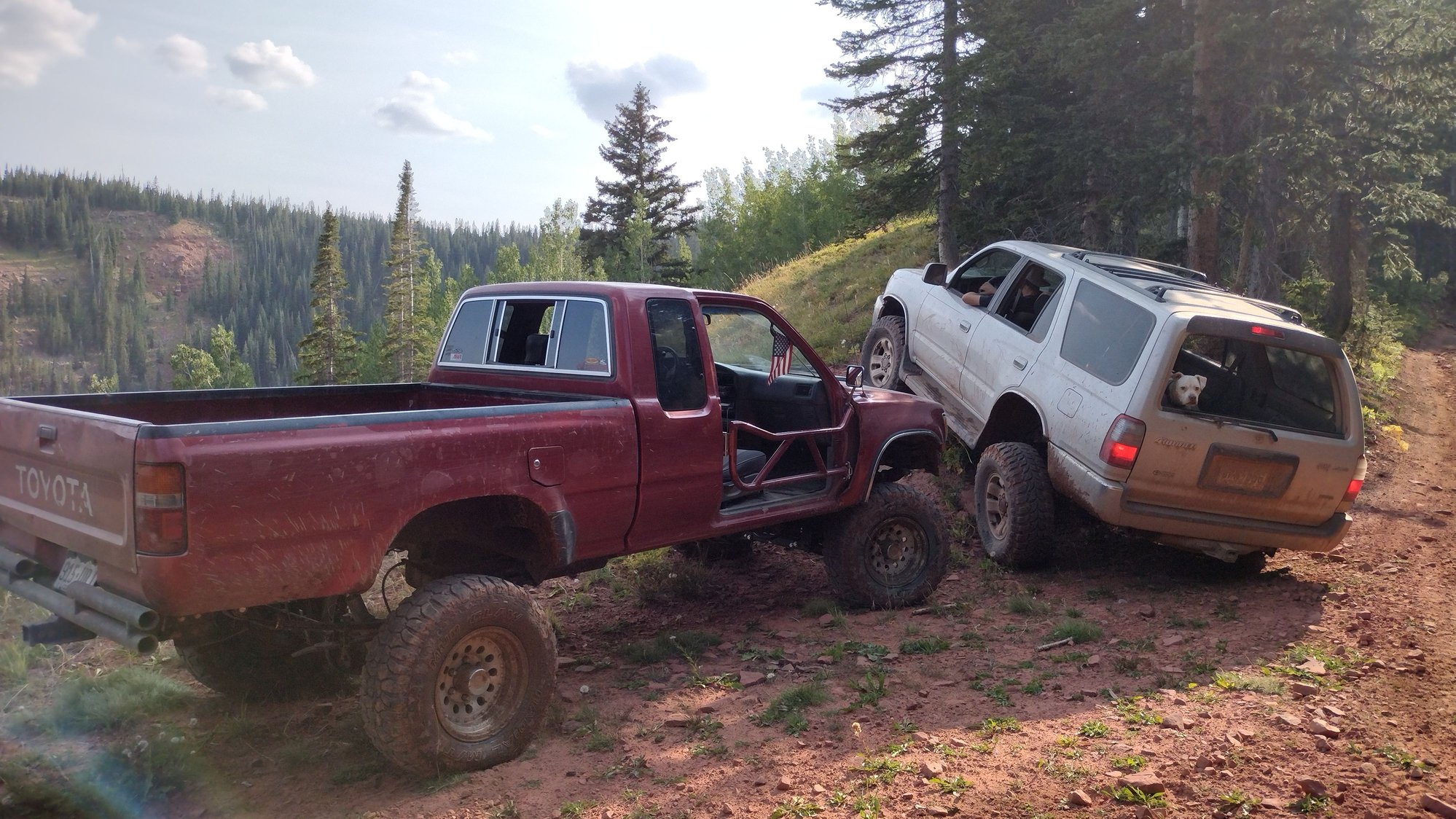

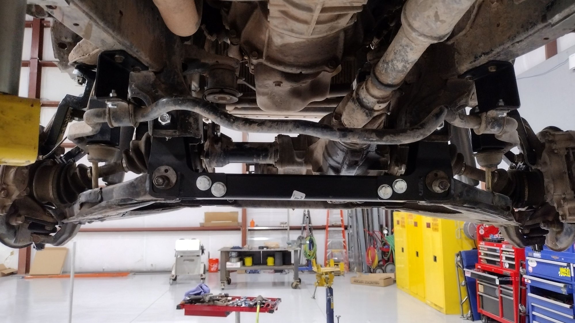

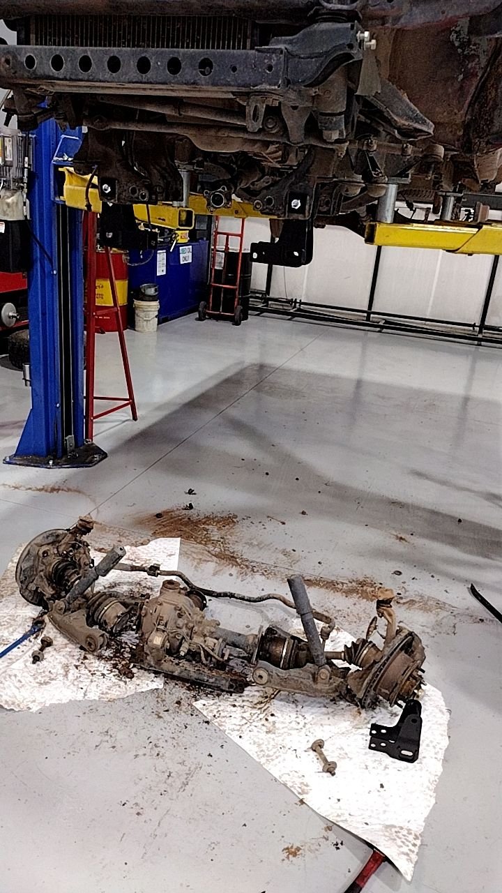

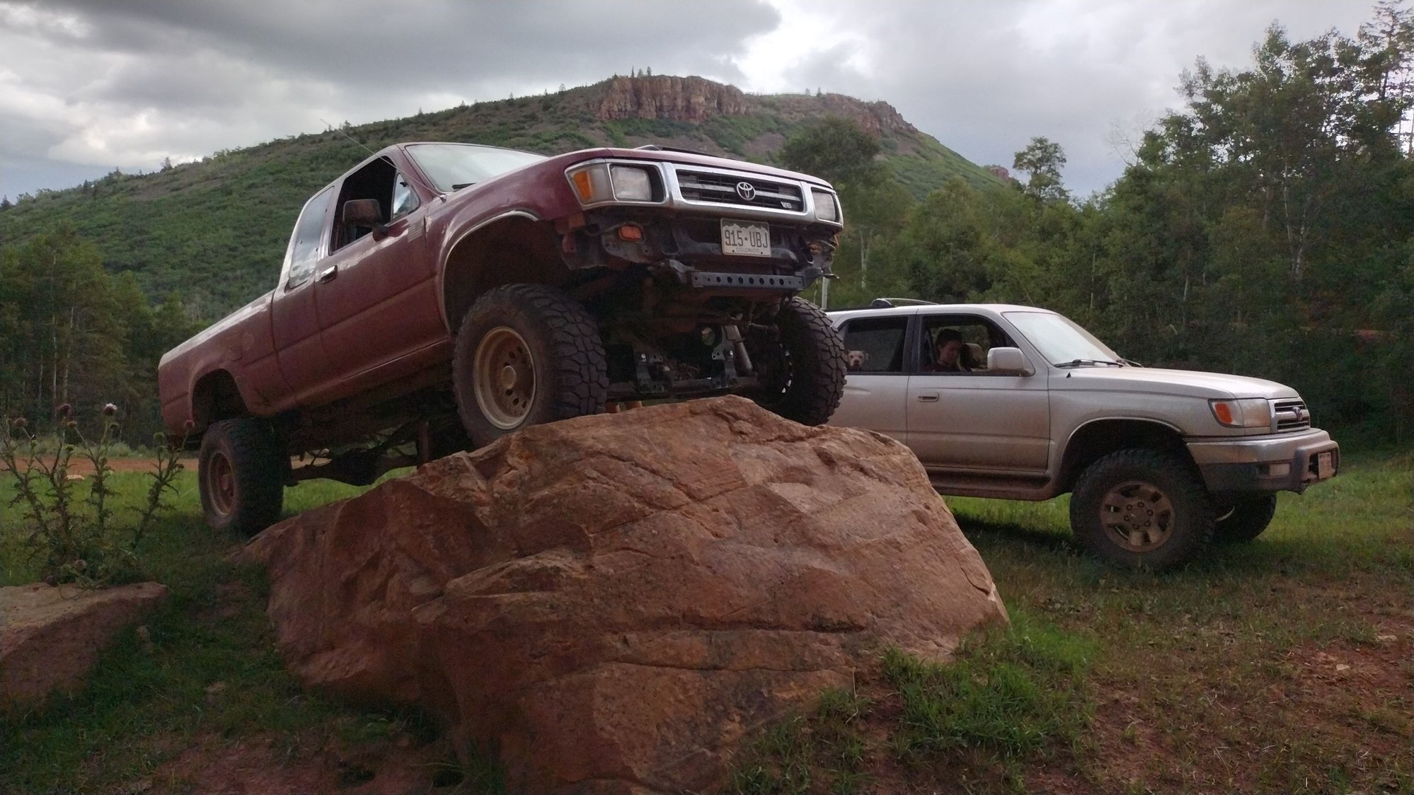

I've been doing so much work without documenting, I thought I'd start a build up on my ol girl Ruby. Swapped in a 3.4 at 365,000 miles, and installed a rear ARB airlocker, then immediately took it to Moab and ran Fins n Things, Hells Revenge, and a trip to Chicken Corner. She performed beautifully, except for 1 issue... the poor trans cross member took an absolute beating. Every obstacle, SMACK. So the next upgrade HAD to be a lift. Wound up going with the Rough Country 4" IFS lift, since a SAS just isn't in the cards right now.
I'll post a few pics here, currently still on my 31's, but have a set of 33x12.5s in the shed, just waiting on the local tire shop to get me in.
Had 1" BJ spacers and 2" rear lift springs with 2 broken leaf springs on the left and 1 broken on the right.
Never could find a new set of shackles, wound up cutting out the old studs and refurbishing the originals.
New rear springs.

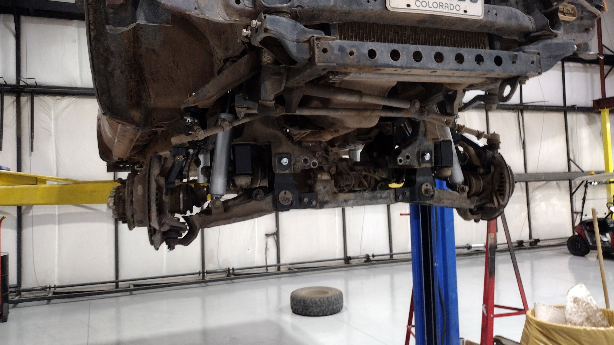

So far, pretty happy with the lift. Though it did drop my LCA angle a bit, I have new torsion bars on order to correct the issue. Mine are original and I have no adjustment left in them. They're as worn out as they can get without breaking.
Need to get my 33's installed!

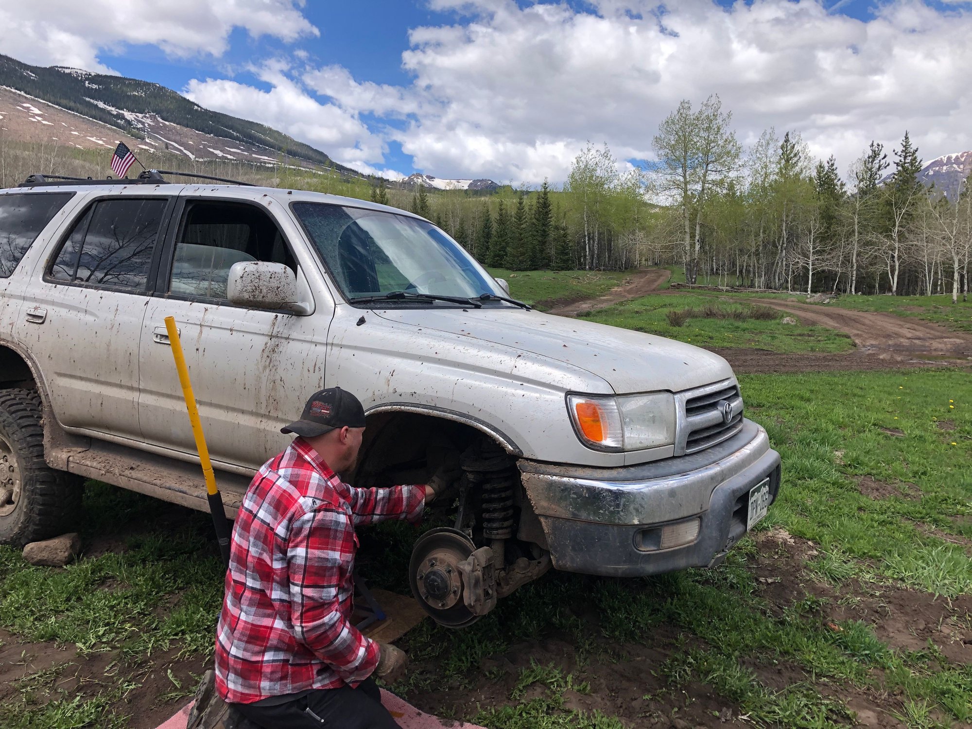

On that ball joint note, I installed a 3" Rough Country lift on the girlfriends 99 Runner, and the first trip out we snapped the right lower. Fortunately we had another rig with us that day, and after about a 4 hour round trip to town and back I had the pleasure of changing a LBJ on the trail.

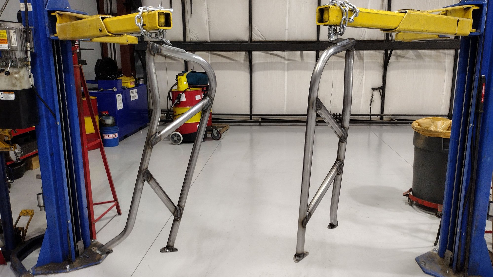

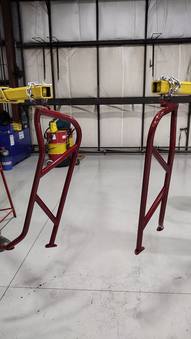

As a thank you for doing all the work installing the lift on her Runner, my gf bought me a set of tube doors for Ruby.
I ordered some color match spray paint from ERA Paints on ebay (highly recommended seller, very good customer service!), and painted them last week. Finally got them installed a couple days ago and we took her out wheeling yesterday. I am in love, they really elevate the experience!

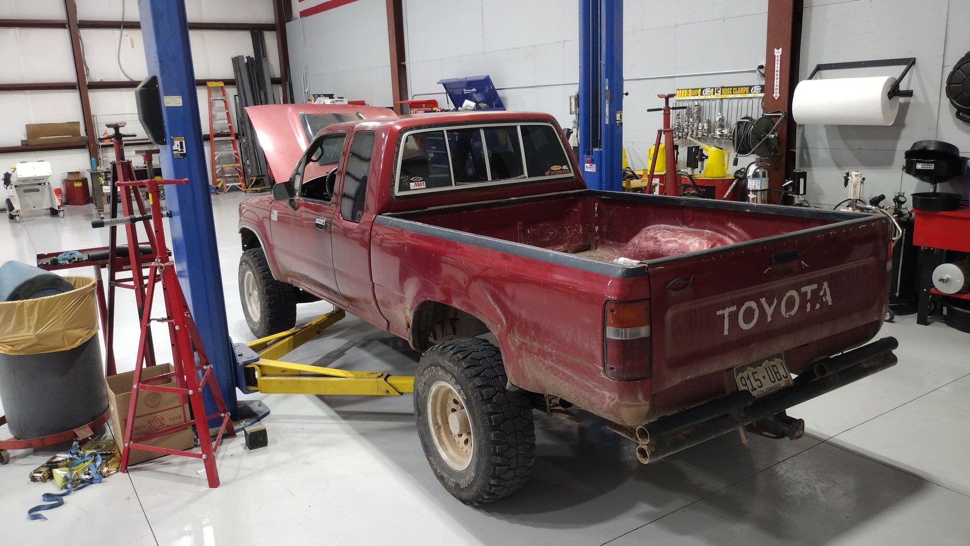

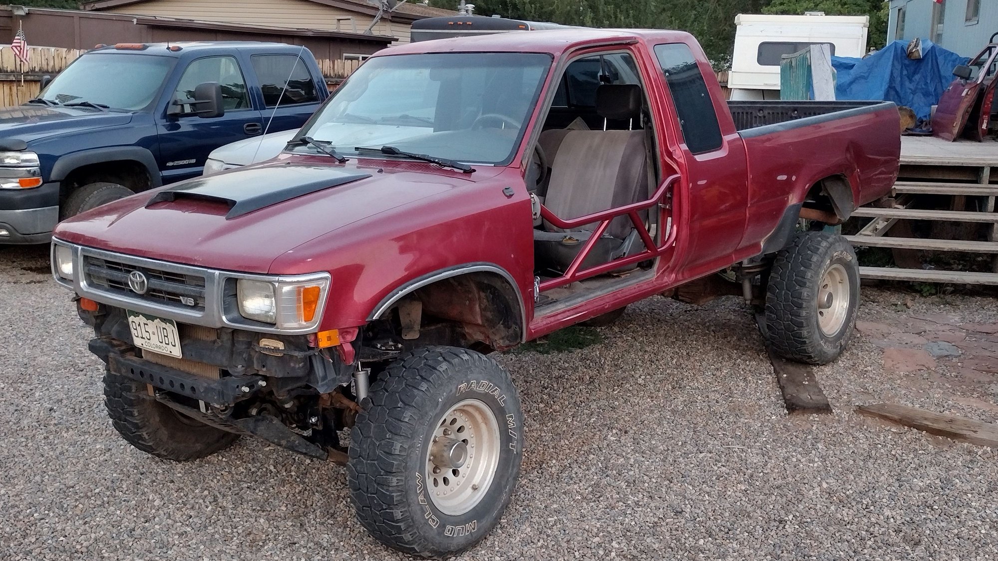

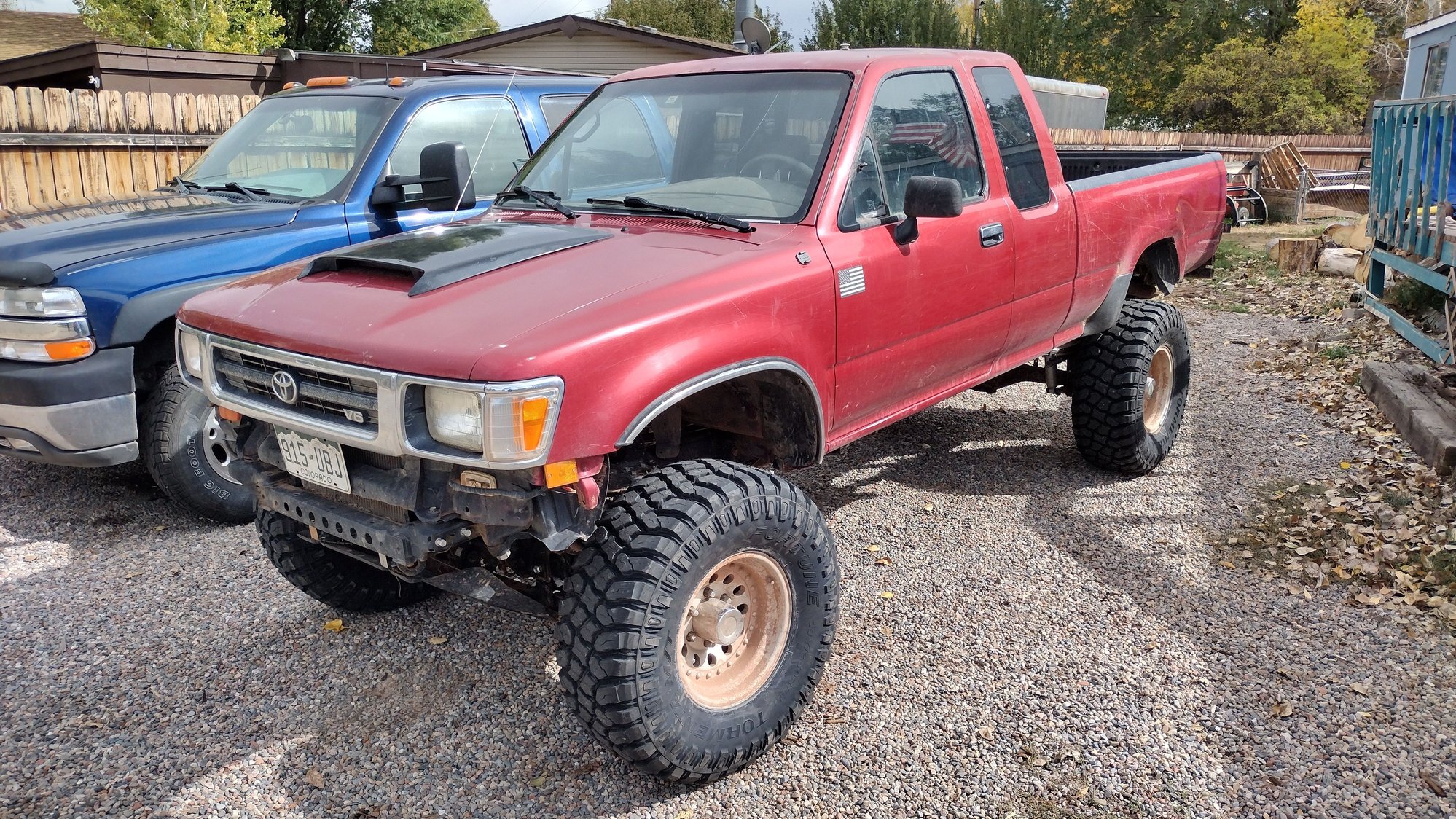

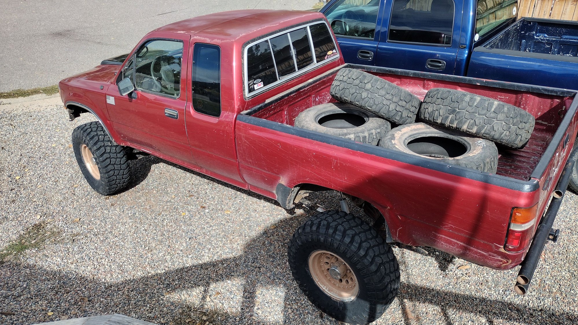

The tire shop FINALLY got me in to get my new 33's installed! Just got it home and had to give an update.
So much better than the 31's.

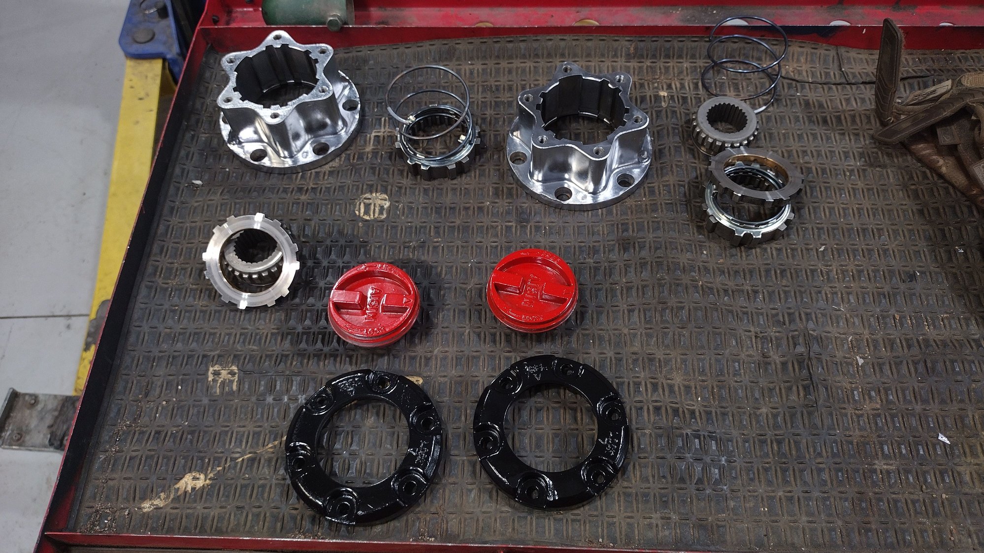

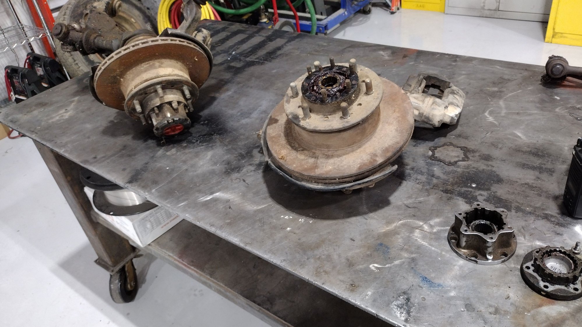

Quick update. I was browsing around Marketplace and I found a lady with a pile of older parts in her shed. I barely noticed in one of the pictures a manual locking hub sticking out of the rubble. After a quick back and forth she told me she wanted to sell the whole pile and not piece by piece, so I resigned and went on my way. About a month later she messaged me and asked if I was still interested. I finally have manual hubs! They were nasty, full of rat scat and covered with grease and who knows what else. There are still rat turds in the bed of my Chevy that I need to clean out.
Anyways, pulled them apart, cleaned up, repainted and installed.
