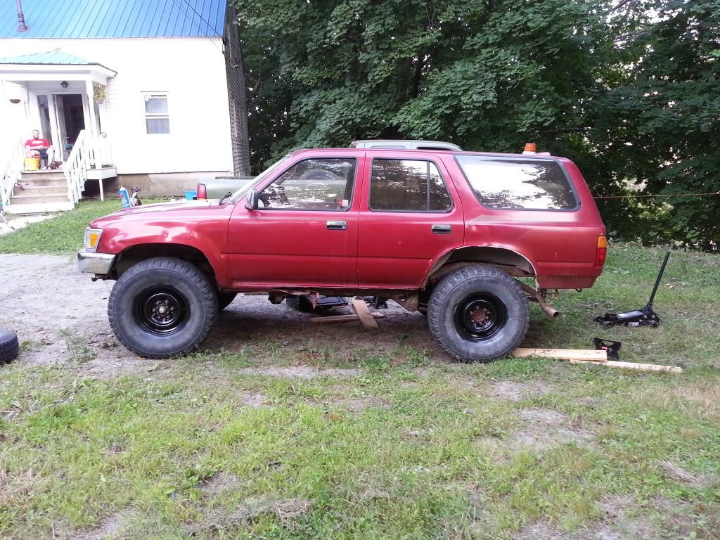

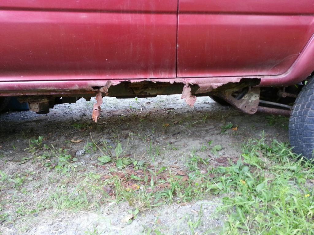

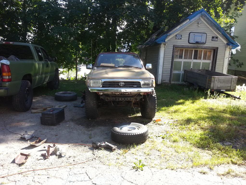

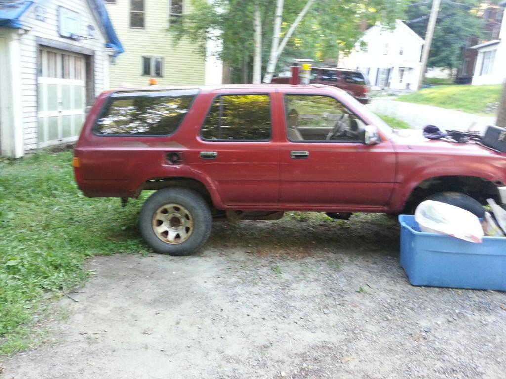

So far I have chopped one rocker down and made the initial cuts to chop out rear fenders. Also removed lower bumper valance and took off plow mount and half the wiring for it. Took off rear bumper and rusty side steps.

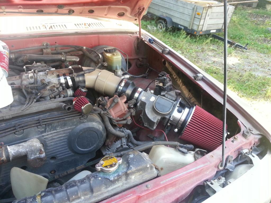

intake out since im replacing it

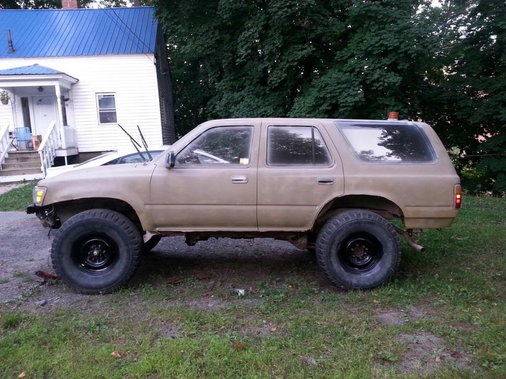

Heres she sits on extremely worn 35s that measure out to 32s. A buddy of mine has some 36s. There fairly worn but way more usable then these ones.

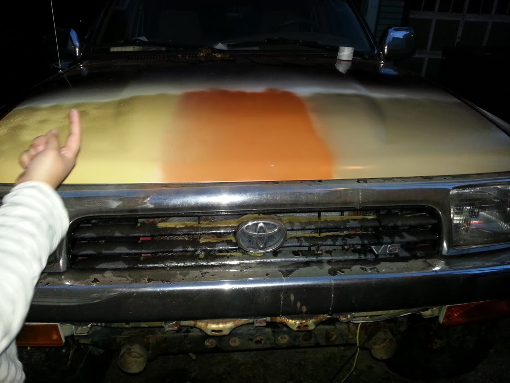

These are color choices and I am leaning towards the sandish one on right. I was going to do a two tone color with olive drab n bottom and sand on top but my Silverado is olive drab so I am thinking sand with black trim and bumpers and wheels and itll look sharp.
Old Aug 26, 2013 | 10:20 AM
julsruls's Avatar
Joined: Jun 2013
Posts: 451
From: Maine
little more trimming done
both sides are trimmed in the front now.

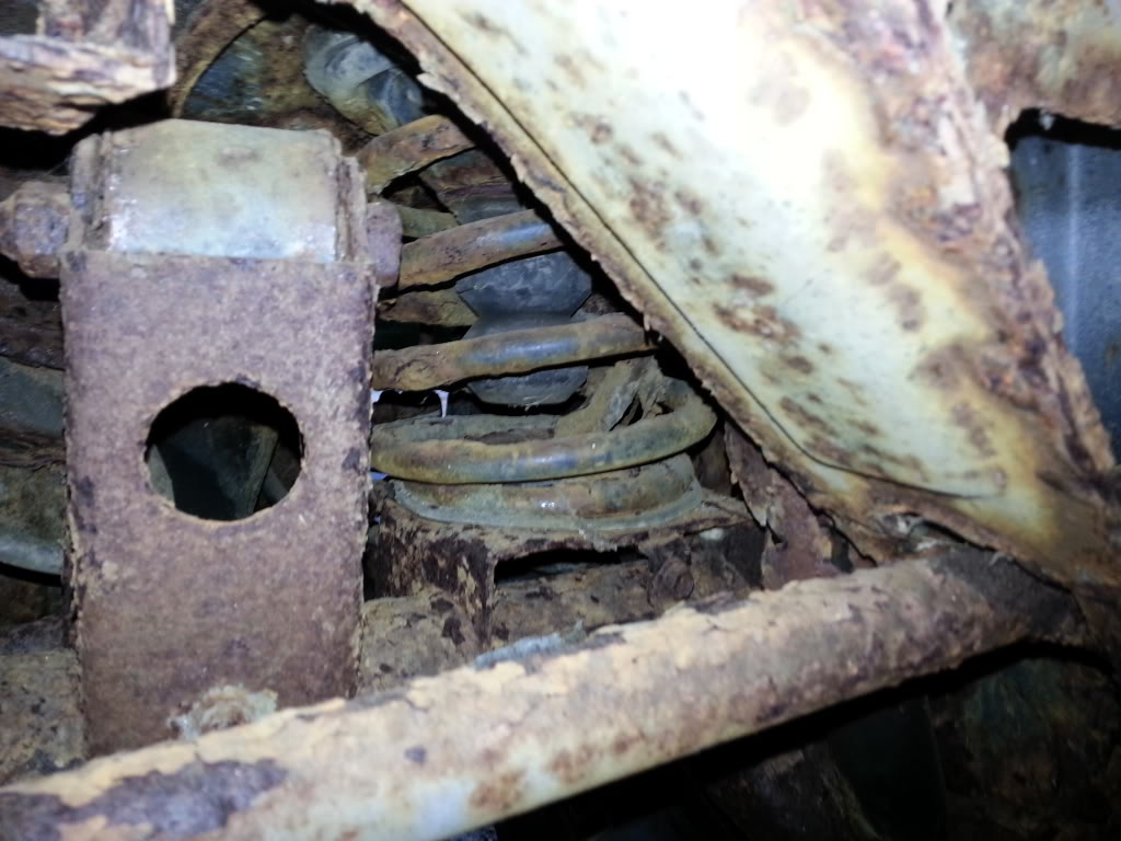

only done the rear so far but heres stock
and after with 80 series springs

I wish i had kept track but im not even sure what color bands they were. Ill look and see if i can find what they were. I diconnected shocks since there garbage and diconnected panhard bar and took off sway bar.
I couldnt get them in on my own that way. But i had my brother push the axle down and i used spring compressors to get them in. Probably gave me 4 or 5". Was not overly hard if you have helping hands and compressors. Or you could probably diconnect more stuff and it will droop more.
