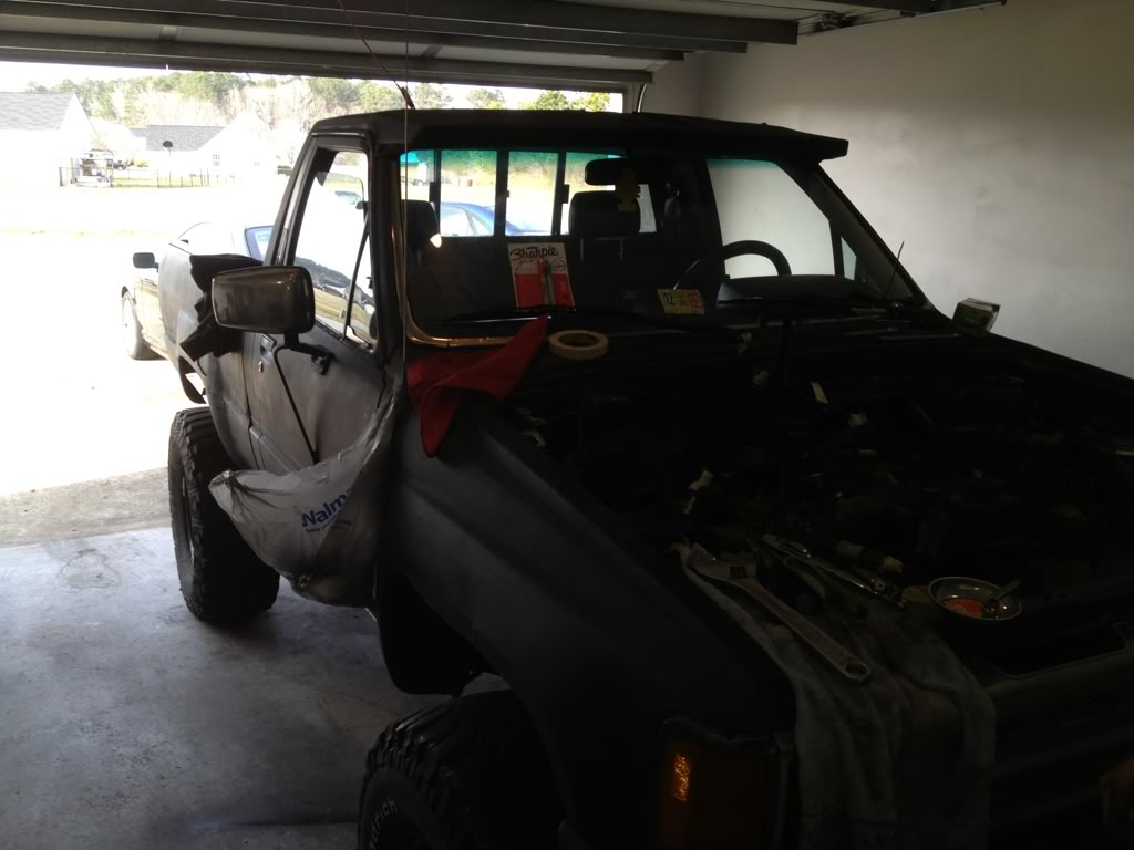

Cleaned the ole garage out so by this weekend the truck should be moved in there and the real fun begins

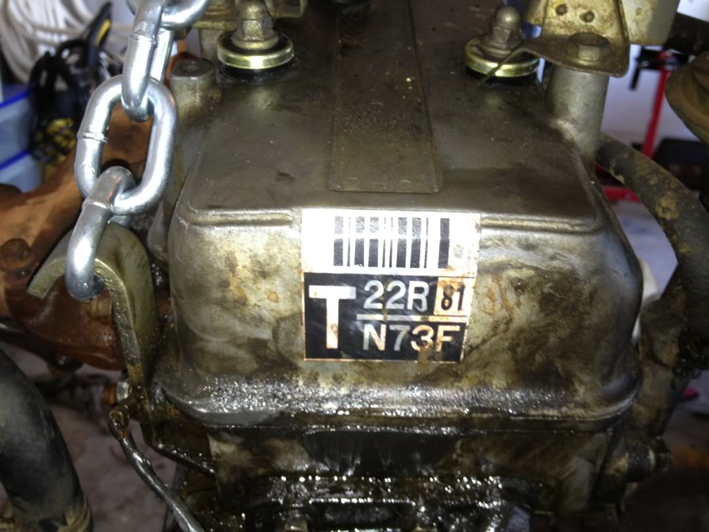

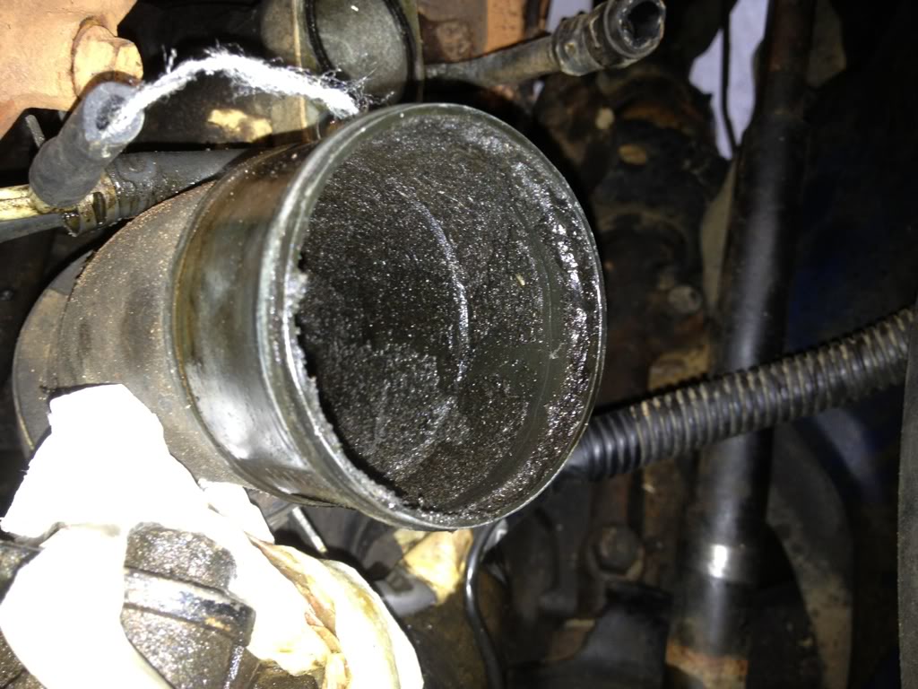

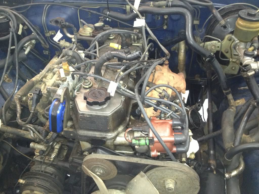

Well today was productive, got a few things done
Did a compression test:
Cyl 1- 137psi
Cyl 2- 135psi
Cyl 3- 138psi
Cyl 4- 150psi
When I pulled the plugs they all had gray deposits on them, and cyl 4 had oil on it. Guessing that there's oil in that cylinder and its bumping up compression.
Checked the high idle problem, I was thinking it was timing or a vac leak... Nope, just the dash pot..
Ummm, ran some seafoam through a vac line, and watched the smoke show.. This is where I realized I had a significant exhaust leak... Lol, turns out there were NO exhaust bolts on the front, it was missing all 4....
Noticed that there was ALOT of dirt, and sludge in the intake(from where the pcv hose joined into the intake preturbo. I'm sure the turbo is gonna need to be replaced soon. Even though it performs how it should for now.

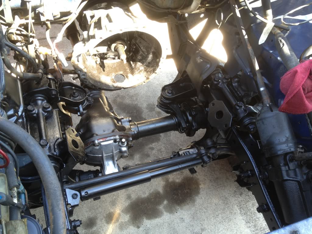

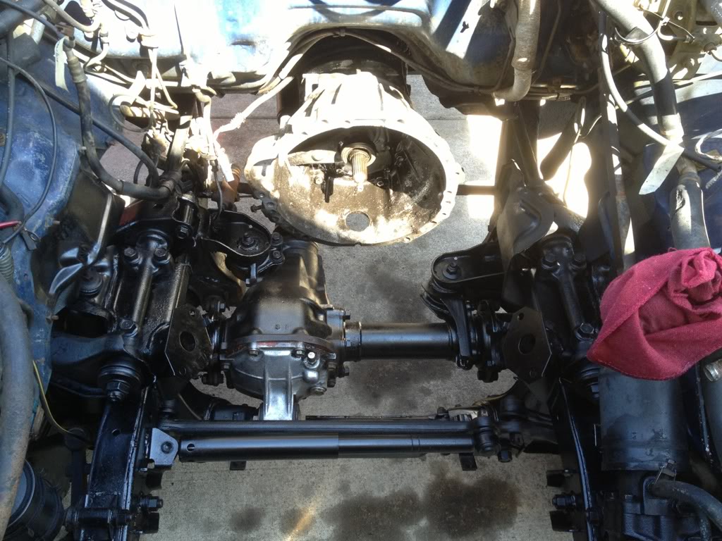

Got all the bolts holding the engine in, out. So I Need to get a short chain tomorrow, and then I'll have the engine on the stand. I can't wait to deep clean this thing.
I'm bad for taking pics after I do all the work lol. It's something I just don't think about while I'm "in the zone". Lol but I took a few about halfway through
And man that top drivers side bell housing bolt is a pita..

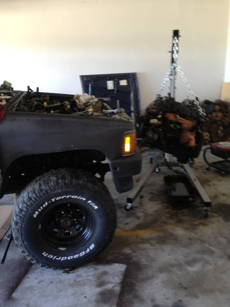

For alot done today! Can't believe how unlucky I am tho.
Got the engine out and started disassembly.

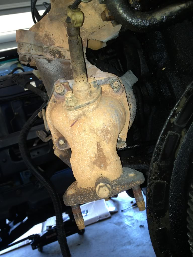

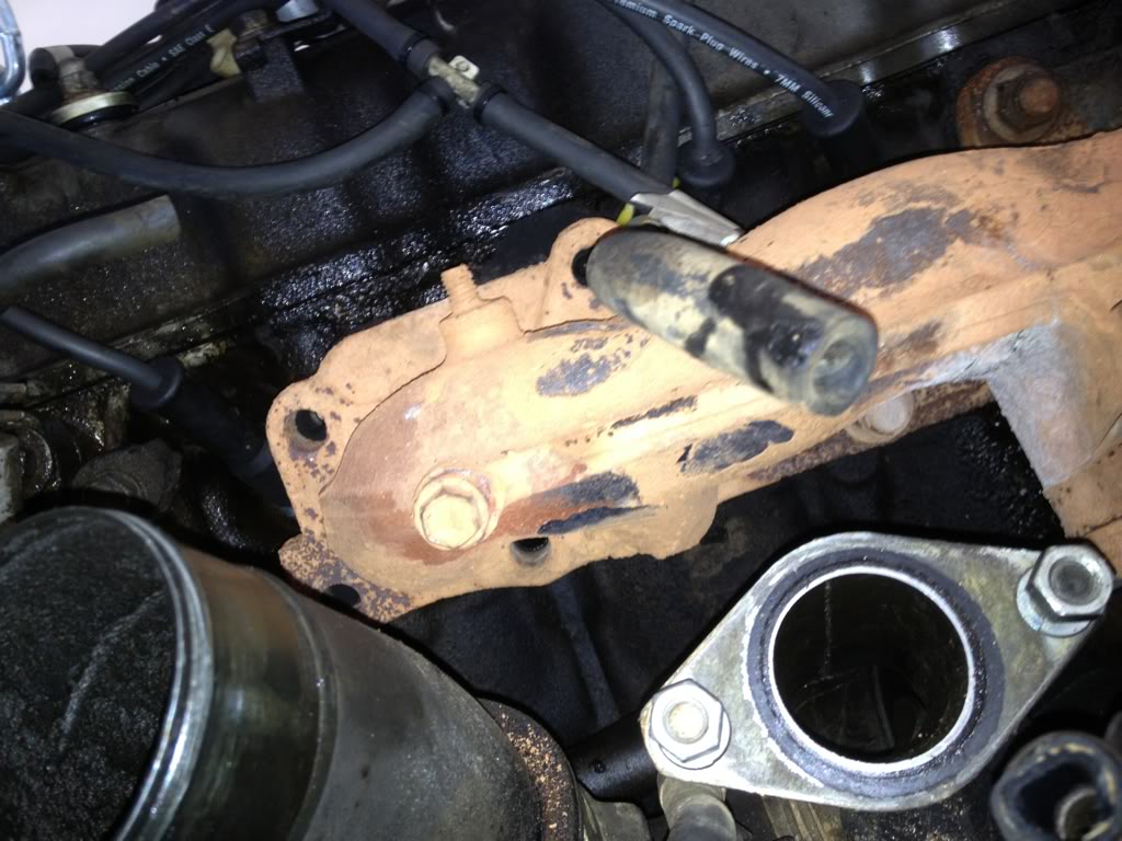

Found ALOT of bad with the exhaust.... There had been dirt and oil getting into the intake and thus into the turbo. And did some damage to the compressor wheel. As well as shaft play... Oh and the exhaust side of the turbo has a big crack in it. No pics of those yet, but here's some of the rest of the exhaust problems.
Missing all front exhaust studs...
Down pipe woes
Oh and the actual exhaust manifold is cracked in the middle. I can't believe that it was a) building boost and b) making no abnormal noise or anything under the hood or driving it (no typical exhaust leak noises or anything!

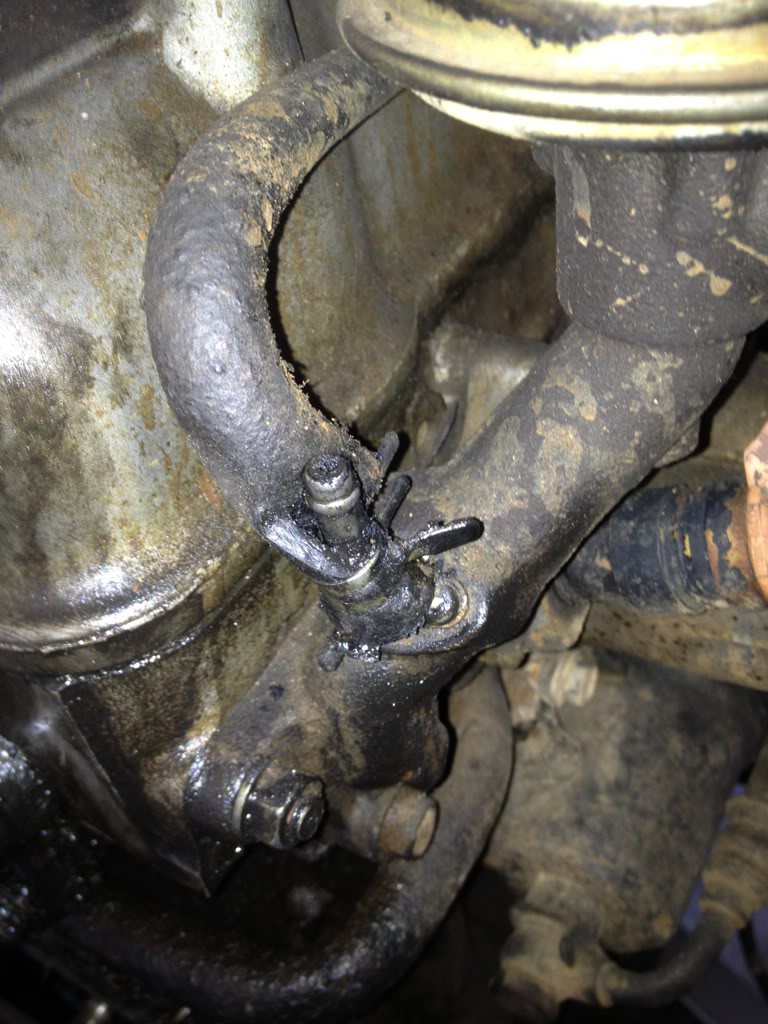

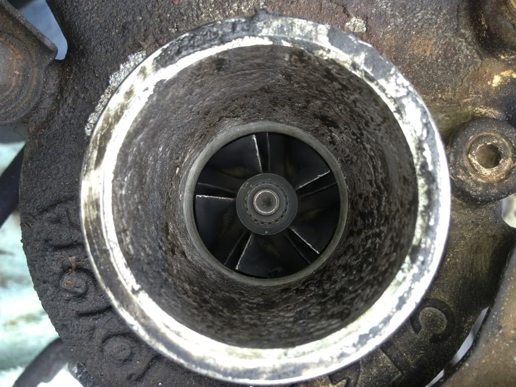

Egr problems
The egr is totally gunked up.
Not sure what all this means.. If anything
Down pipe woes
Egr problems

Cracked manifold:
Yeah, i can't believe that it was running so well! The only problem that I knew of was the high idle problem and 14mpg highway. I actually thought it was in really good shape because it drove so well. I really can't imagine how well this thing is gonna run when I'm done

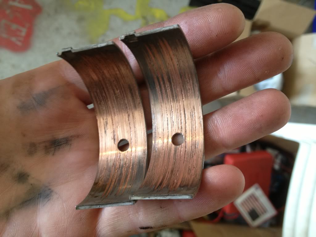

Been a few days, not really anything big going on, this thing is starting to become a money pit. I've just been meticulously cleaning and painting, cleaning and even more cleaning. And I have to apologize for the lack of pictures, but I figure nobody wants to see before and after dirty bolts and nuts. Lol, I did clean and paint the engine bay, just the frame and such, not the fender wells. Looks alot better tho!

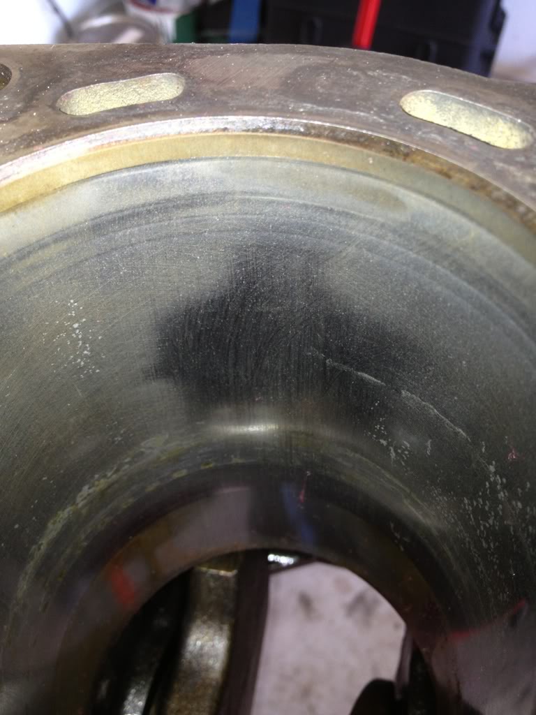

Just one random cylinder... I think is kind o elliptical cuz I can feel the ring lip on the sides but not front and back, also the piston skirts showed a little wear/scuffing. Is this normal? And is it bad?
#1 cylinder connecting rod bearing. I don't think it would've lasted much longer, no damage to crank tho.

It's the normal wear pattern, but that doesn't mean it's in spec.
Cylinder inspection is on Eg1-56 (PDF page 11). Pin inspection is on the next page and I'd imagine they're shot.
I'd be more worried about the pitting, or atleast what looks like pitting in the photo. Can see it in the thrust wear which means it's deep.
#31
I thought the cyl's looked decent(no gouges/serious damage, and some crosshatch visible, they FEEL smooth, and I know that's not the scientific term lol. I was hoping I'd get away with honing and new rings. I'll take a closer look and start lookin for some bore quotes at some local shops.

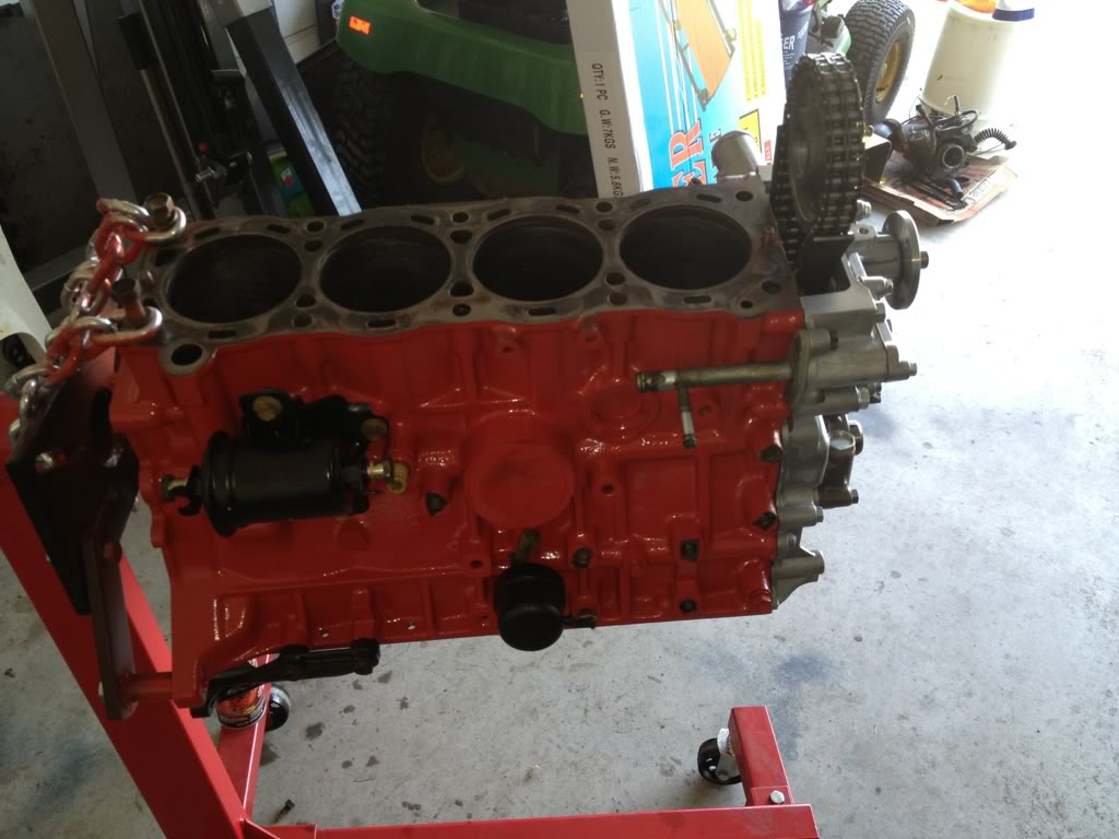

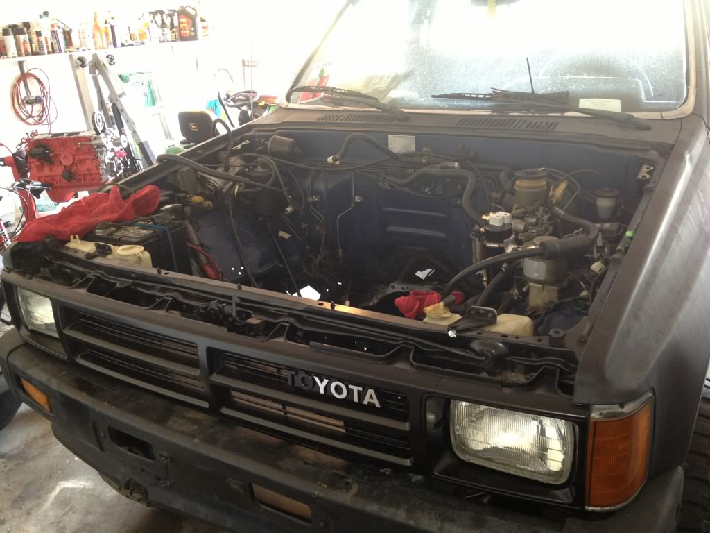

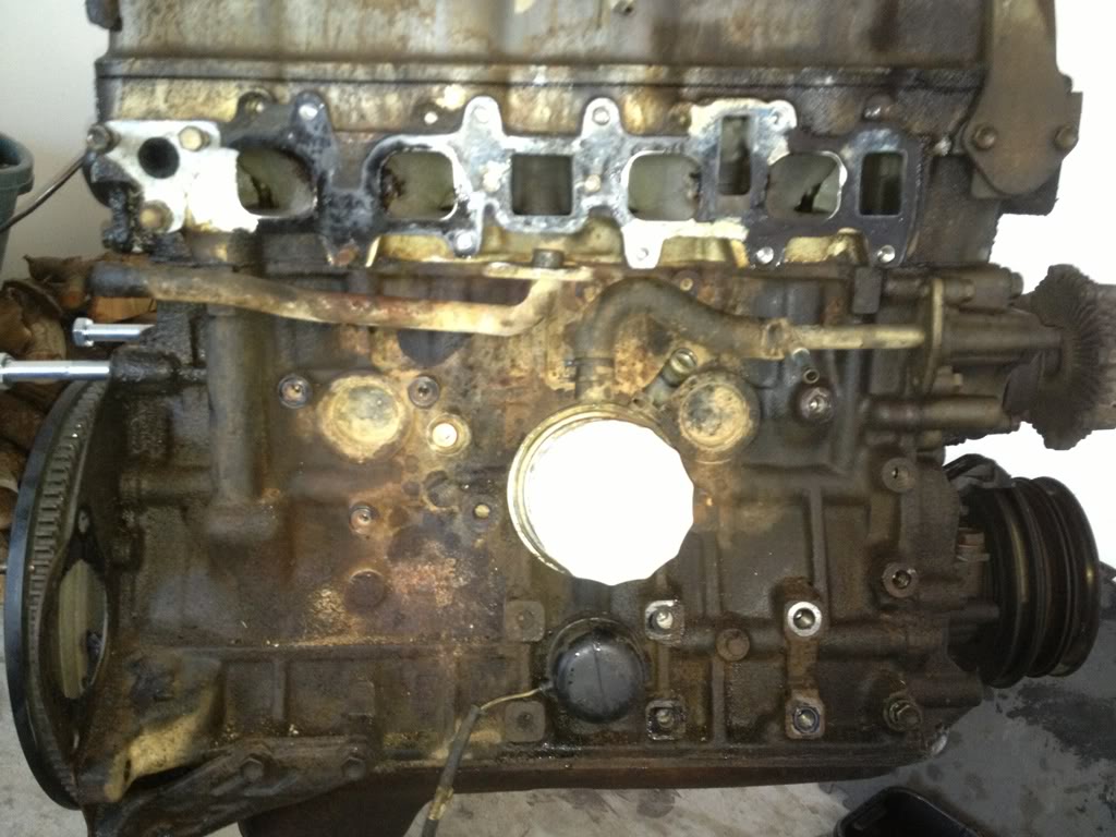

Cleaned and painted the engine bay.

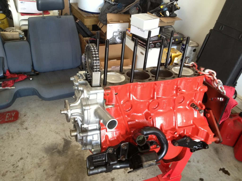

Got the block completely torn down, cleaned, honed the cylinders, and replace the main bearings. Installed crank, haven't torqued it yet. But things are going pretty good with it.

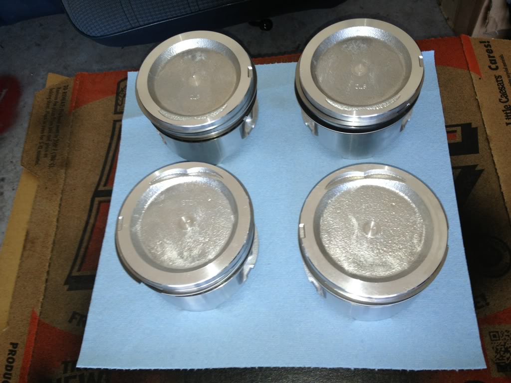

Ok so I haven't updated in a while, but I've been workin on it just about everyday.
So far I've got the engine about 1/2 back together( just need the head and cam) got new pistons for it, and installed those, torqued everything down. Got the oil pump pick up on, and the oil pan is on. Letting he rtv dry over night and I'll torque it down in the morning.
Mostly been cleaning parts and such.

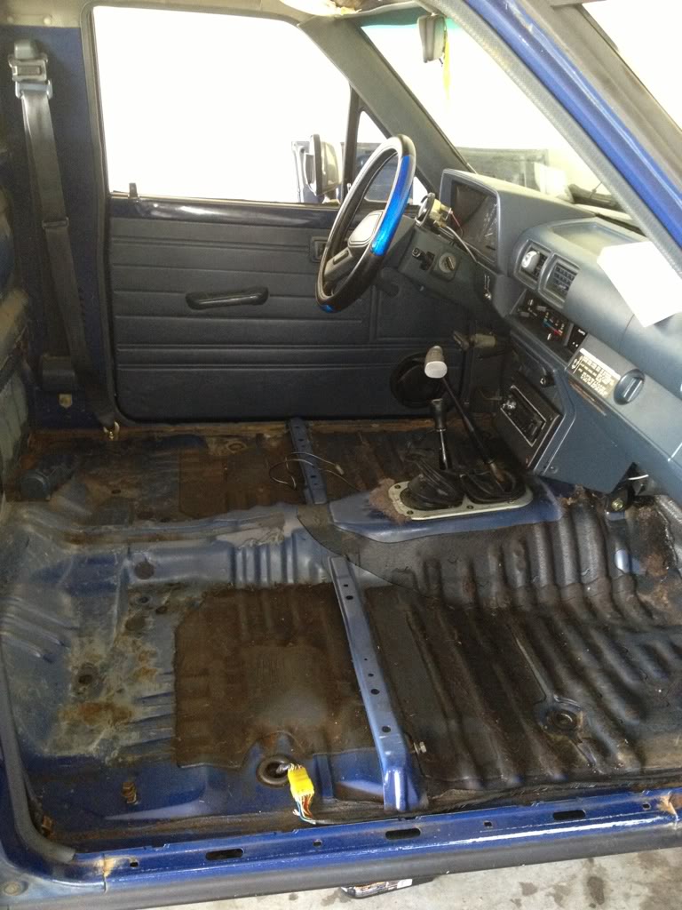

Non engine related, I installed a clock in the truck, I love how toyota already had the harness in there. Took out the bench seat to have it reupholstered. Took the vinyl floor out. Cleaned underneath. And I'm thinking I'm going to get gray or black carpet.

Nice work man! Love that color on the VC and block. What color is that.
Engine bay is looking really good also. I wish I had the patience to do that.

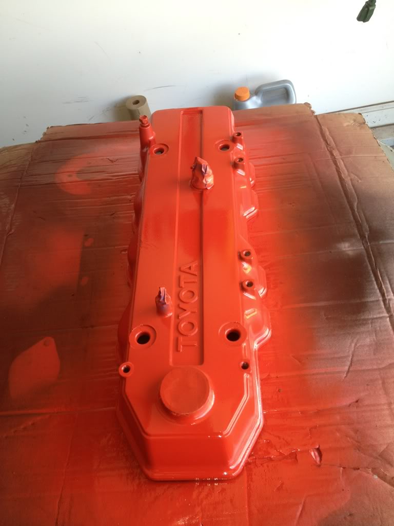

the color is just rustoleum engine enamel red($2 a can at Ollie's)
And believe me, this is the most detailing I've ever done during an engine build mostly because parts are trickling in and I can't put it all together anyways so I have more time to really clean and paint everything. Also having a little pressure washer made it alot easier, I'd just spray everything down with degreaser let it soak and then take the pressure washer to it.

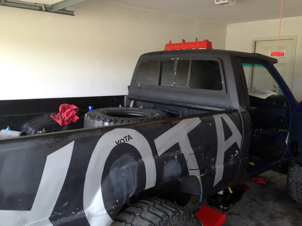

Went and did some work on it today, just minor stuff.
Started out tinting the back glass
Before:
After tint.... And got a wild idea that just didn't turn out like I had it in my mind lol
This is how the inside is gonna be for a while.

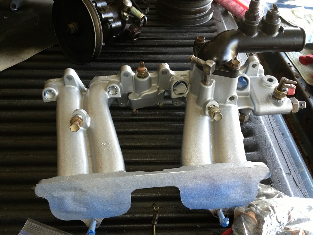

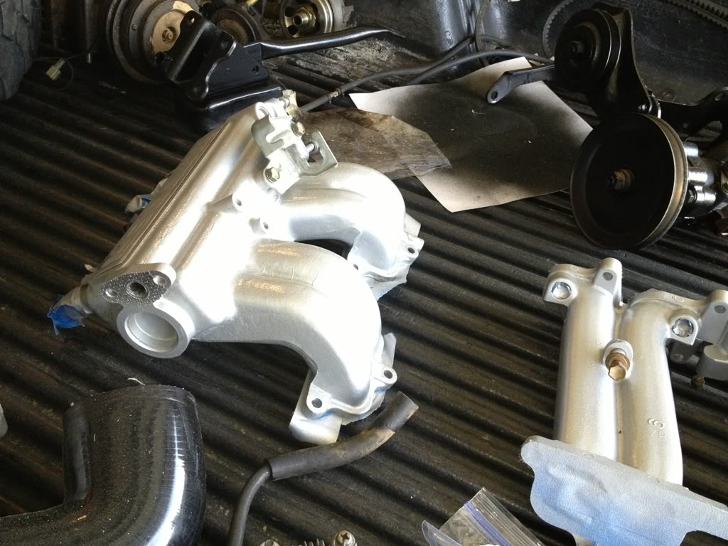

Intakes all cleaned and painted

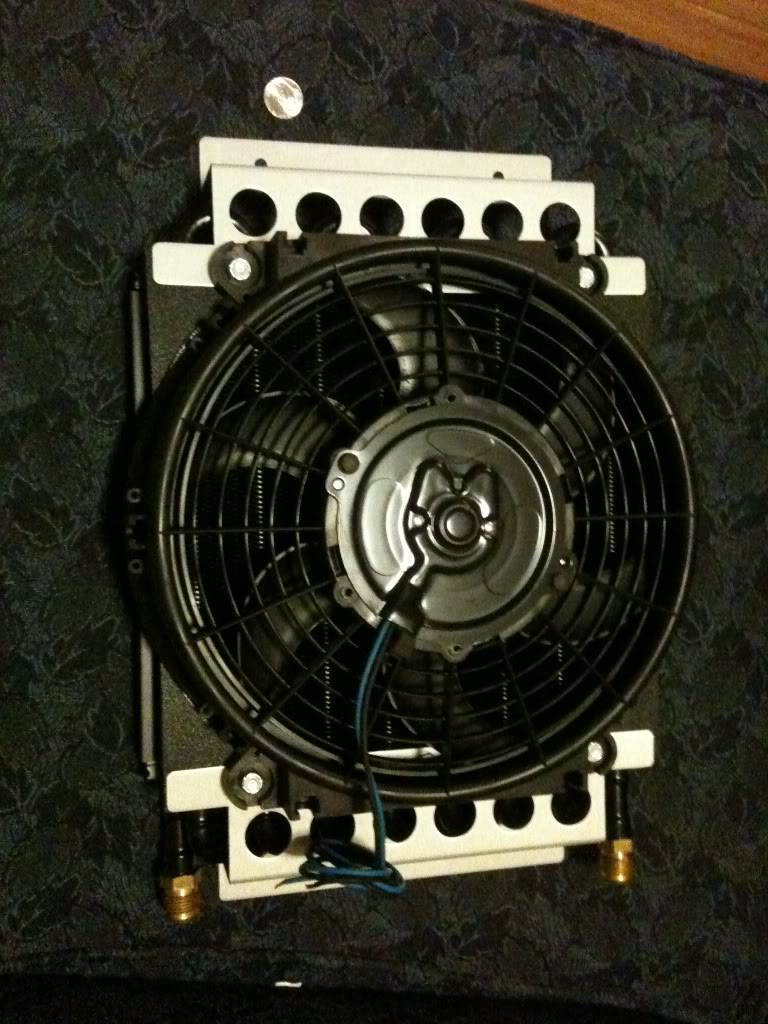

The mailman brought me some presents today. I got some fittings for my oil cooler
Plan for this right now is to get a front skid plate and mount it to it.
i WAS thinking of mounting it on the bottom of the hood, but it's a pretty big cooler.
And when It's in there it's going to have a thermostat switch to turn the fan on when oil temp reaches 200 and off at 185. It's gonna be wired up to my turbo timer also, so when I turn the ignition off, it'll stay on to cool the oil down before the engine turns itself off (just maximizing the usefulness of the t-timer) plus it should add another quart of oil to the engine.
As far as exhaust it's going to have the turbo mani and then a 3" downpipe all the way back with a flow through slp loudmouth 2, to keep it free flow yet quiet...ish.

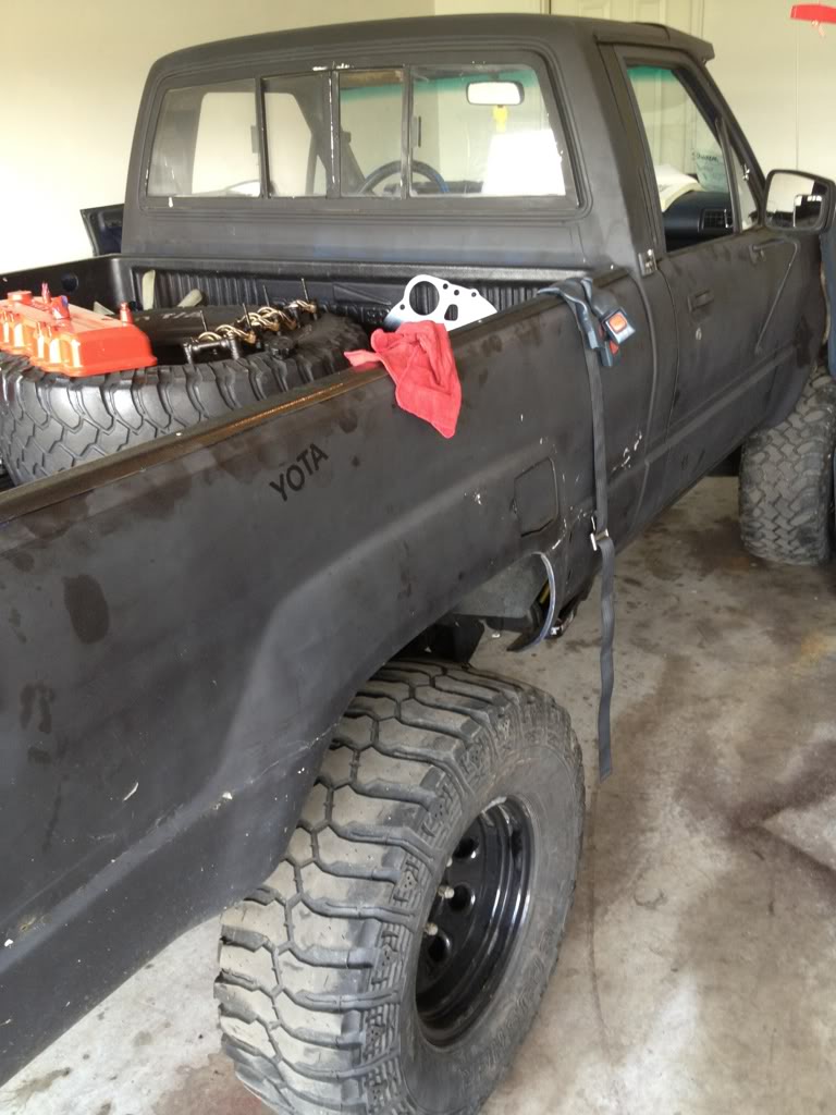

Went over and changed the front diff fluid. And tinted my passenger window, it turned out really well. Didn't snap a pic, will do tomorrow or whenever I see it next. I was also trying to clean an egr component that came off the back of the head. It was completely blocked with carbon, and I was using a little metal hook tool and it was just solid carbon, so it's sitting in some solvent to loosen it up. Didn't take pics cuz I've seen alot of dirty egr parts and I'm sure everyone knows what they look like.

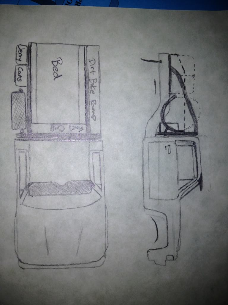

Did a quick jotting of what the present plans are for the rig.
I'm kinda thinking about doing an on board air system. We'll see, I thought it'd be cool and useful on a bunch of different levels. If i were to do it, it'd be a York ac compressor with a 2.5 gal res.
#40
Looks like a sweet plan you have there with making the bed more of a utility body. I love the onboard air setup. Having the capability to use air tools out in the middle of nowhere is always a plus.
The window tint came out looking great.
