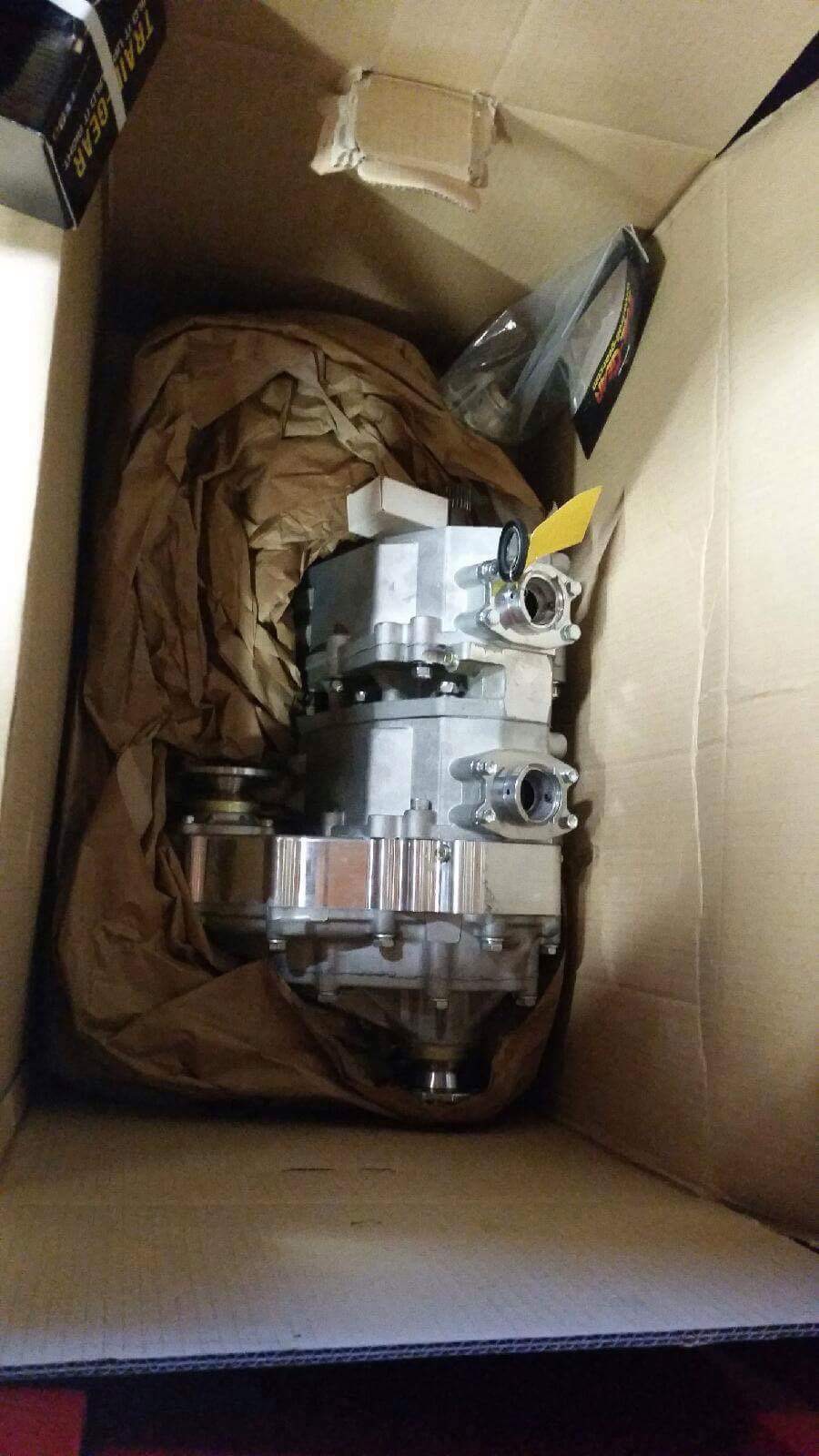

Twin stick Dual case
What front axle are you using? if 79-85 your driveshaft is gonna be on the wrong side for the d/s drop set of duals...
And that case is not set up for Twin Sticks...
Old Nov 6, 2016 | 03:44 PM
Motorvated's Avatar
Joined: Sep 2016
Posts: 18
I'm freaking out right now... How'd I mess that up !? It even said for 1980-1995 Toyota 4 cylinders.

So Trail Gear sent me the wrong TC but they have already shipped out the correct one.
