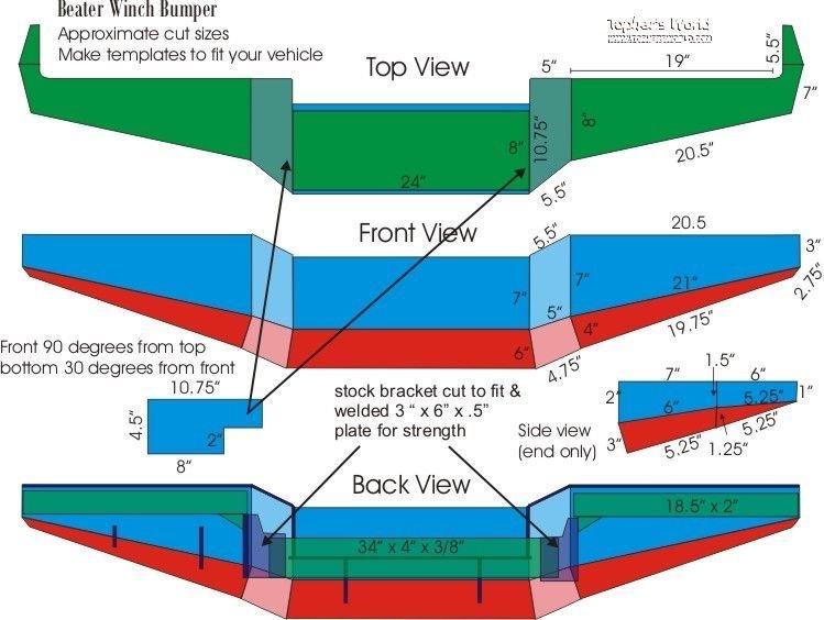

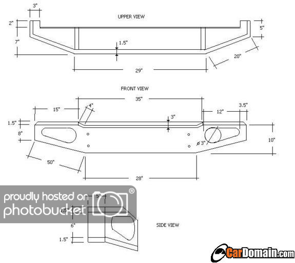

i need these type of plans if exist or someone take measures of the plates so i can create 3d model just like the pictures below.

Google site search is your friend..
site:www.yotatech.com diy bumper
And so is card board templates and mock up.
