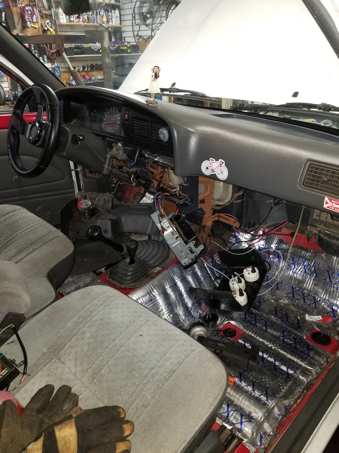

wiring troubles
I'm glad the dash is so easy to take apart on Toyotas.
So the past two days the truck had a wiring issue and finally was able to find a solution. First, my blower motor for my heater stopped working. Checked the fuses and one was blown. So i replaced it and it blew again. thought it was the heater turns out it was the transmission reverse switch going bad. Whenever I would switch into reverse it would blow the fuse which also stopped my blower motor, gauges( temp and gas), Electric fan, and reverse lights and made the truck run like garbage, After going through everything narrowing down I just unplugged it. Have a new one ordered Glad it was just that. But while the dash was sort of apart I wired in the tach and have to say its pretty sweet. This is where it's mounted. The only downside is it blocks the check engine light. The gas gauge is clearly visible just not from this angle.

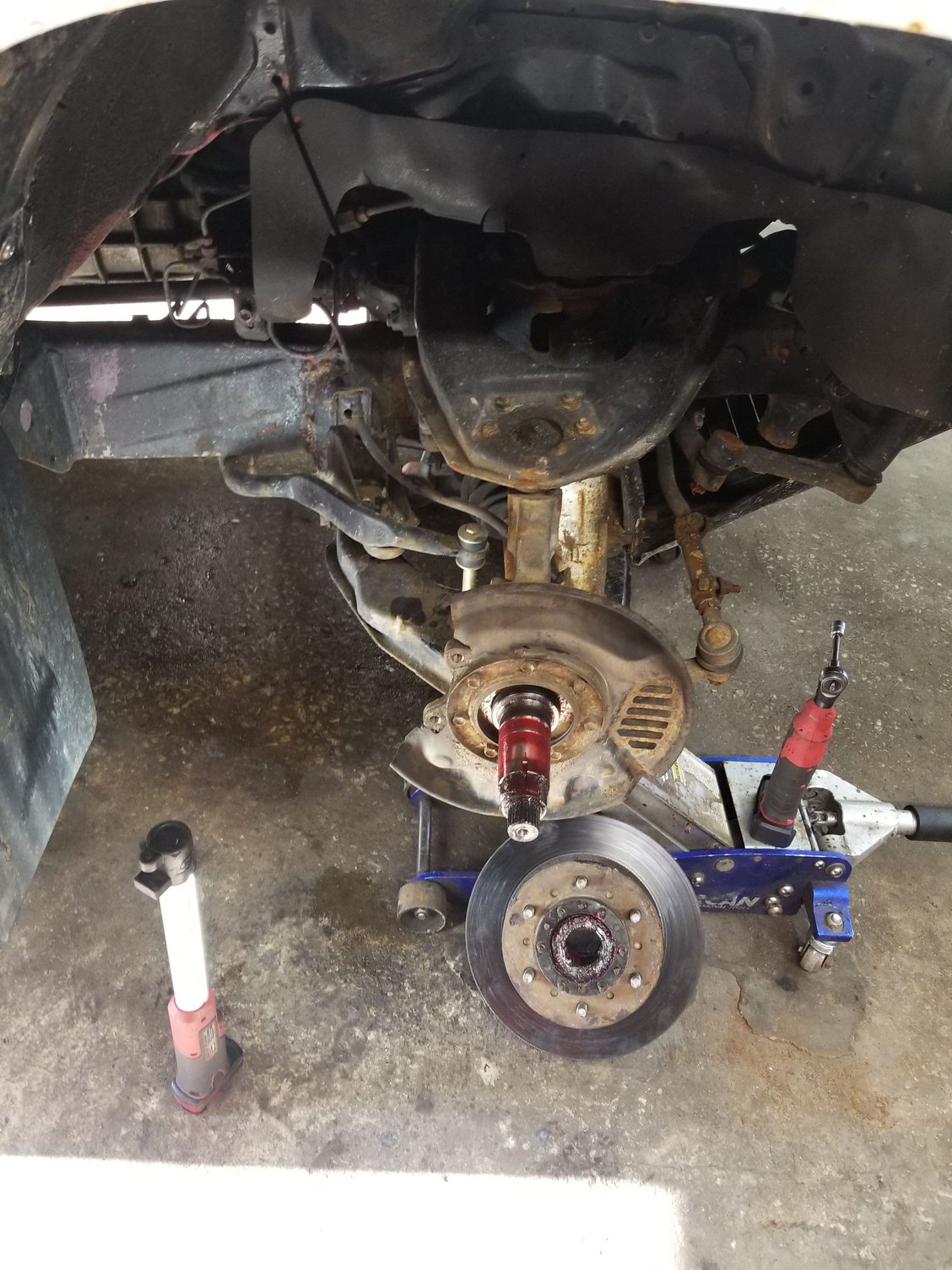

Haven't updated this in a while. Mostly been acquiring parts to install all at once. Have a new dif to replace my broken one. Getting a new clutch this week so i can do my leaking rear main seal. I ordered new shocks but ended up getting the wrong ones. Had to do front brakes cause the calipers froze up. Plus some good news. I manage to get a FREE ARB front bumper that I'm super stoked about. old shocks vs new... to bad they are the wrong ones
Checked the wheel bearings when doing the brakes. They seemed to be in decent condition.

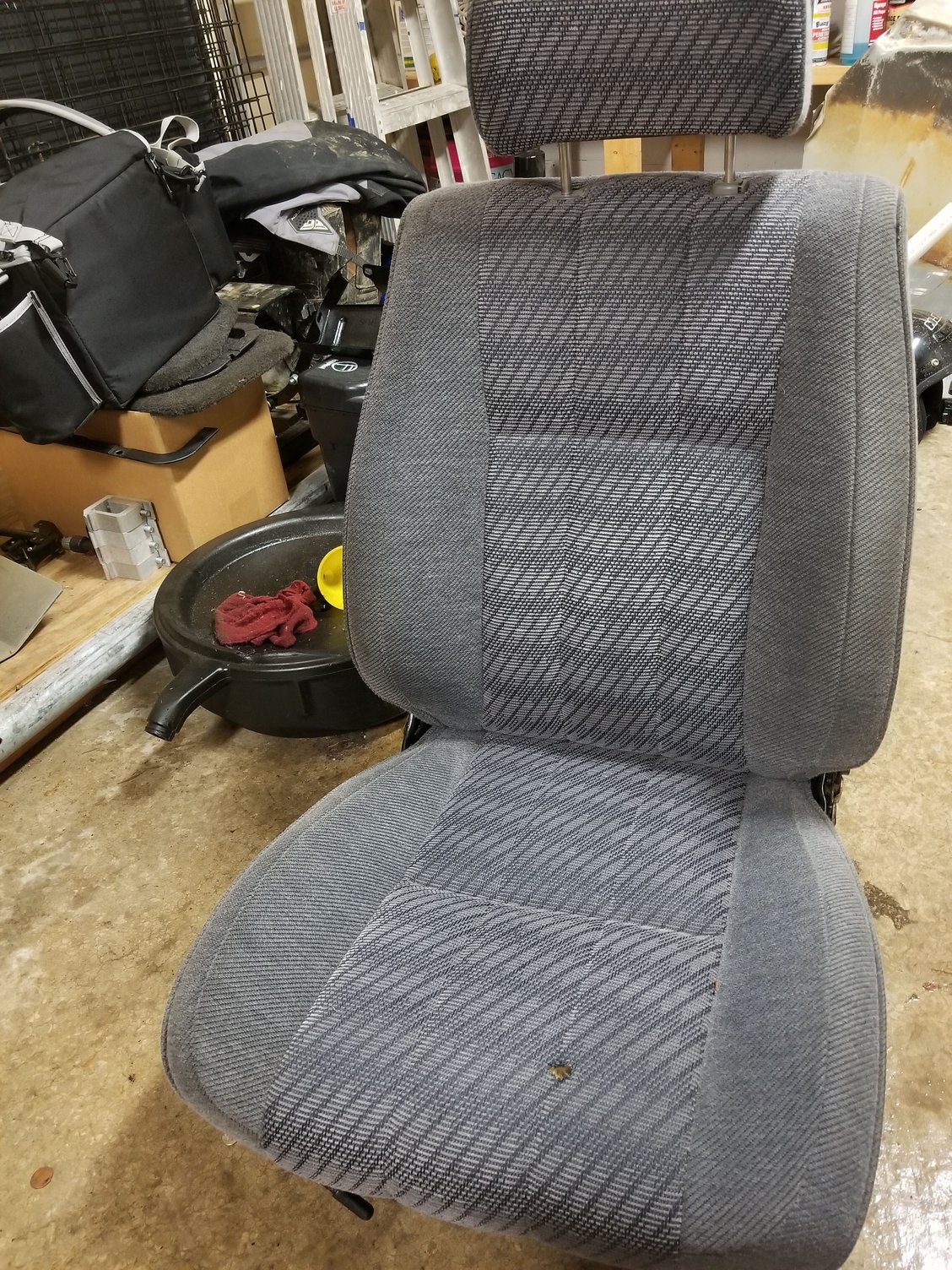

Second-Ended up finding some decent SR5 seats. After a thurow cleaning they turned out pretty good.
Before
After

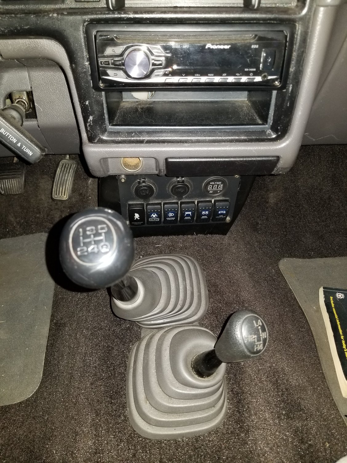

Added a gauge pod to the A pillar.
Wired in a switch panel that also has usb ports, a 12v outlet, and more switches than I know what to do with. Made an extra fuse block for safety. Also wired the electric fan to a manual switch. This allowed me to clean up a bunch of wiring and turned out really nice.

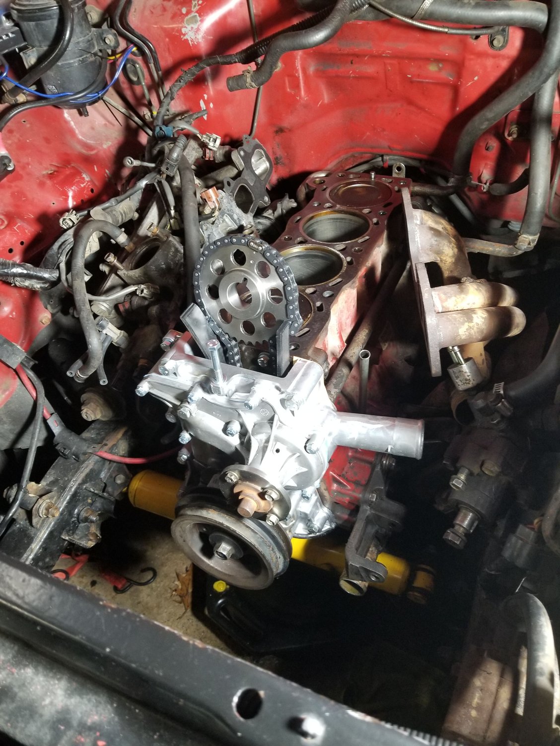

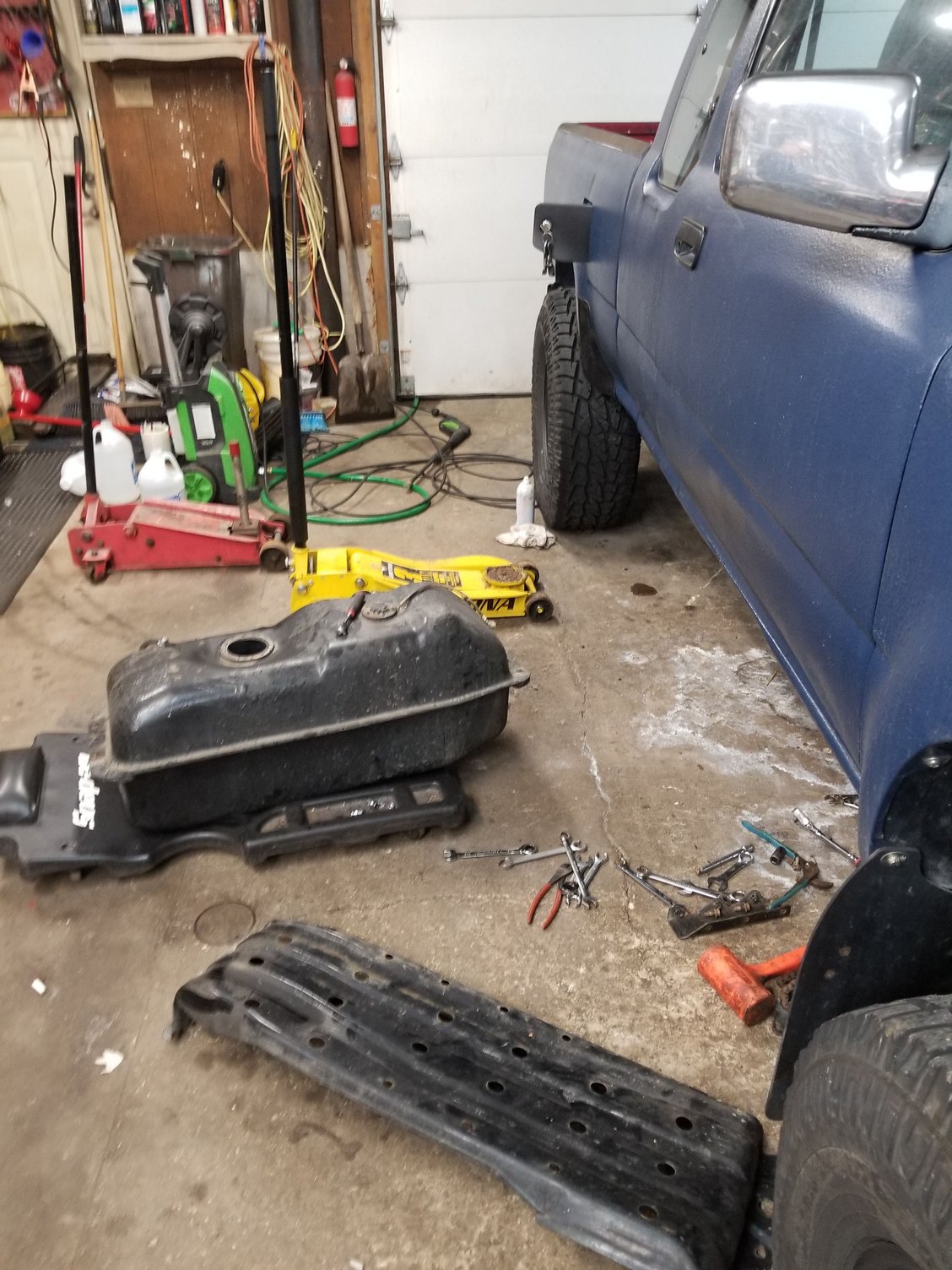

Major update: Have been rather lacking on the updates so here we go. After driving it a bunch and enjoying all the thrills that a 30 year old Toyota has to offer i ran into more issues. You'd think that I would have them mostly all figured out by now. Ill have to find photos off my old computer to update this fully.
After dropping the gas tank and getting a new fuel pump I ended up pinching a hard line on the old fuel pump hanger. Honestly, was kind of expecting this based on the condition it was in when removed. Got a genuine Toyota replacement and everything was good. Washed out the tank as best I could even gave it a nice coat of paint because why not. When installing it apparently the hard line going over the frame support was also a little corroded and developed a pin hole. After not noticing it for a bit I had a local shop replace it because safety. After that she ran great.
old pump and hanger and the new one.
Finally got around to installing the spare diff I had laying around one afternoon. A real pain in the butt to do by yourself but I managed. Gave it a nice coat of paint to slow eventual corrosion. Whilst installing it I decided to address an oil leak from the oil pan. So after removing it and painting it all was good, I did notice a little bit of grey metal shavings(sludge) in the bottom of the pan. Wasn't too concerned but maybe I should have been. Buttoned everything thing up put new oil in and called it a day.
old and busted
New Hotness
Never use a felt gasket for the pan only RVT
Drove it around a bunch more a few 500 mile trips with no issues until one day there was excessive banging. Turns out one of the lower ball joints had went out. No issue considering the age. Im sure they've been replaced before? Replaced both of them with genuine Toyota ball joints after reading that most aftermarket ones are rather garbage. Was disappointed at the dealer price but you pay for quality as they say.
old vs new
Really the only time I've used the factory bottle jack.
This winter has been rather mild. Thankfully... As we all know salt kills these trucks as with any vehicle but id rather not have it destroy this truck. It's probably a bad sign about the state of the environment but good for my Toyota. The past couple weeks have been the worst weather and thankfully my Toyota has been in a garage. Why? Well because it always needs fixing. If I start a GoFund Me will anyone donate? One afternoon I tried to take the truck on a highway and it wouldn't go above 55. After getting it home I checked the codes. Had thrown a code 14? A no fire for 6 consecutive times? Checked everything, cleared the codes, and it was okay? Thought it might be the old spark plug wires so replaced them and it seemed to run better.
Took it back out on a highway and same thing. Was even worse this time. Back firing and couldn't get out of its own way. Got it home and checked the timing and boy was it off. So much I assumed the chain jumped a teeth or two?
When the cam was at TDC the Crank was past 0 degrees. When I tore into the motor the first time I never replaced the timing chain. It looked good and had metal guides from the previous owner. Didn't think much of it and I should have. After tearing into the motor I didnt really notice any major damage to anything. However, I did notice a ton of metal in the oil. A flashlight shined on any bit of oil and it would glisten. Maybe a little wear on the guides? Ended up buying a new timing chain kit (OSK), new bolts, and a new timing chain cover as my old one had a small crack on the top of the casting all from LCE.
I really love new parts.
Reused the oil pump and water pump because they are practically new.
Yea! shinny new parts. After removing and inspecting the cam I was rather disappointed. It is was destroyed along with the rocker arms... Figures.
Didnt expect the lobes to be this bad.
How many of you run ZDP in your oil? I have, but haven't recently. Surely this amount of wear can't be from not using it all the time? Don't believe the valves hit the pistons as there wasn't any abnormal marks on the pistons and all of the valves seemed fine. However will be removing the valves to see. Fingers crossed.
Motor torn down to the block
Trying to stay somewhat organized
Pistons dont look that bad. There is a little bit of excess oil in the head bolt holes but I think thats normal? Will be thoroughly cleaning them out before reassembly.
New timing chain, guides, tensioner, and cover on.
I've since ordered a new cam 268 torker fromRedline cam and crank in Oregon the recommended company by Engine Builder along with a new set of rocker arms. Hoping that the valves are fine, but will have to wait a few days till i can tear into the head and find out. Till then my Yota will sit in the garage out of the elements.

It's been a long time since I've updated this. Still have the truck. It's at 256k? Happy where the truck is at currently. The modifications list is slowly getting smaller for now. Here's some recent pictures.
I finally needed upper ball joints. Figured when I installed them I'd also install a ball joint spacer lift. It's the 1.5 inch from 4crawler offroad. Great quality and would definitely recommend. Allowed me to crank down my torsion bars for a more comfortable ride. That along with the new ball joints really improved the handling of this.
Recently I ran into some issues. I've been putting the truck through its paces as a work truck and daily driver. Unfortunately the fuel pump I replaced a year ago went out on me after a recent road trip. Luckily it was in my hometown.
I also have been meaning to address my disintegrating exhaust. Figured I'd address most of the exhaust. New header gaskets and new exhaust studs.. Used the same old header that's always been on the truck. Haven't a clue as to the make. Then a complete new system from the header back. Ended up purchasing the LCE cat back system. It sounds great and the kit is top notch.
Still chasing down a nice bed cap. More pictures of that to come. Still need an alignment. Also am considering a snorkel. Opinions?
