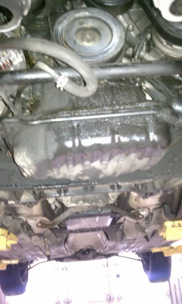

suuccess i figured it out thanks 85 toyman. so this is what i started out with.

it sure did sound sweet with no exhaust.

i think it may need a timing belt. i figured i would jsut take the hole body harness just in case. i really like the lexus cluster but would like to try and use the stock cluster. we will see how it goes.... k well here is some of the pictures but i am having troubles getting the rest off my phone so hopefully i can get them off tonight or it will be tomarrow.

i did have to cut the sway bar out to drop the engine and trans out the bottom.
thats only half of the parts i took out.
so i cut the core pupport out to make removeing the engine easier but ended up not pulling it like that and i also kinda cut one of the harnesses oops.
well this is how i ended up taking the engine and trans out.
http://i1228.photobucket.com/albums/...removel2-1.jpg
and here is the engine and motor out of the car. on thursday i am scrapping the car out and will get some extra runner harnesses to make the harness for the swap ahead of time so its hopefully it will end up being a kind of plug and play for the swap to make it go faster. and when i do the harness i will take very good notes and pictures so untell then.
