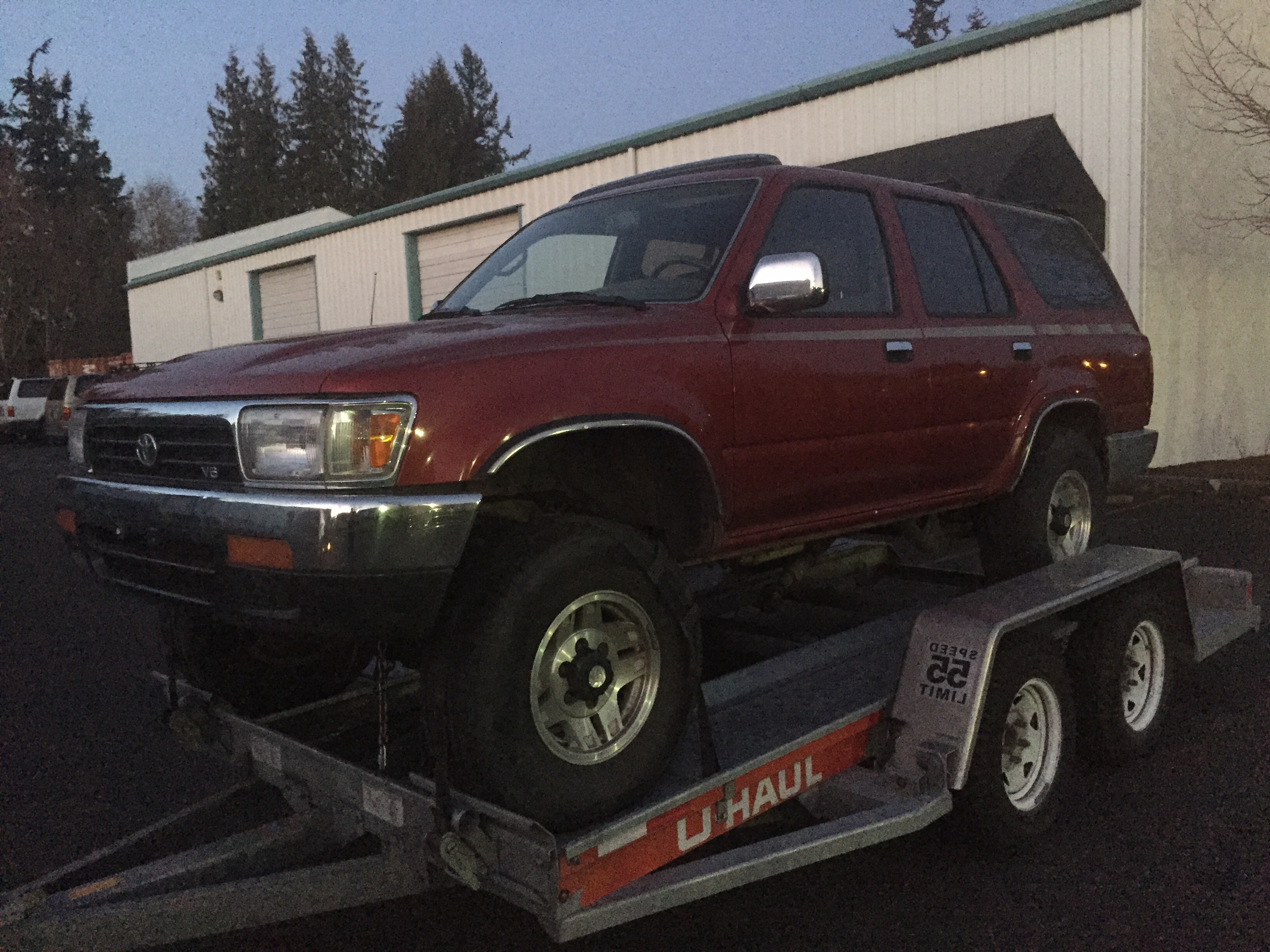

I was browsing craigslist the other day, not really looking for another 2nd gen... until this popped up. It was a standard listing... 3.0.. blown head gasket... but then it had "Come get it, I'm moving tomorrow. Asking $600, but open to offers."
Now, I'm not normally one that turns down a good deal... so I grabbed the flatbed and headed out 80 miles to find this.
When I arrived, the guy started loading the runner... I was like "dude, I'm not sure I even want this... let alone want to pay you $600." He said "Make me an offer.. I need it gone, and you're here."
"$40..."
He said "make it $100, and I'll give you the engine stand as well..."
Well, needless to say... $100 later...

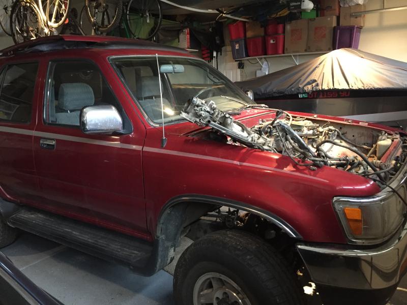

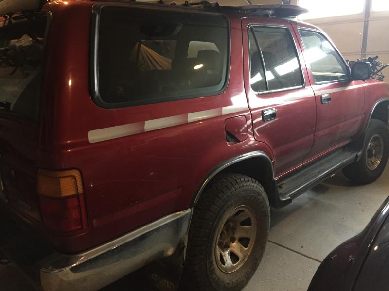

This Runner has every option available, which makes me a happy guy. My last one didn't have the sunroof, or the stock 5 speed.. or the rear heater. 3 options I really wanted.
I'm in a different place now than I was with the last runner, my boat has a permanent home on the river, so I don't have to tow it (except during the winter, you can see it in the garage) but I have the tahoe to tow that with. I'm back into camping a lot more, and I miss having a vehicle I can throw the bikes on and disappear into the woods for weeks on end.
I'm going to build this very similar to my last one. There will be a few minor changes, but I will be having another 3.0 built just like I did before. The 4.88's came stock on this, and they will stay most likely.
I am DEBATING a SAS, but I have to do some more research first... and, it's going to have to be a low lift SAS if I do it. I don't need a TON of flex... I need to have great handling on the highway to get me to where I want to camp.
There will be an onboard shower... just like my last one.
So here's to a new build! As before, I'm always looking for advice. I'll be doing most of the work on this one myself... so let the games begin!!

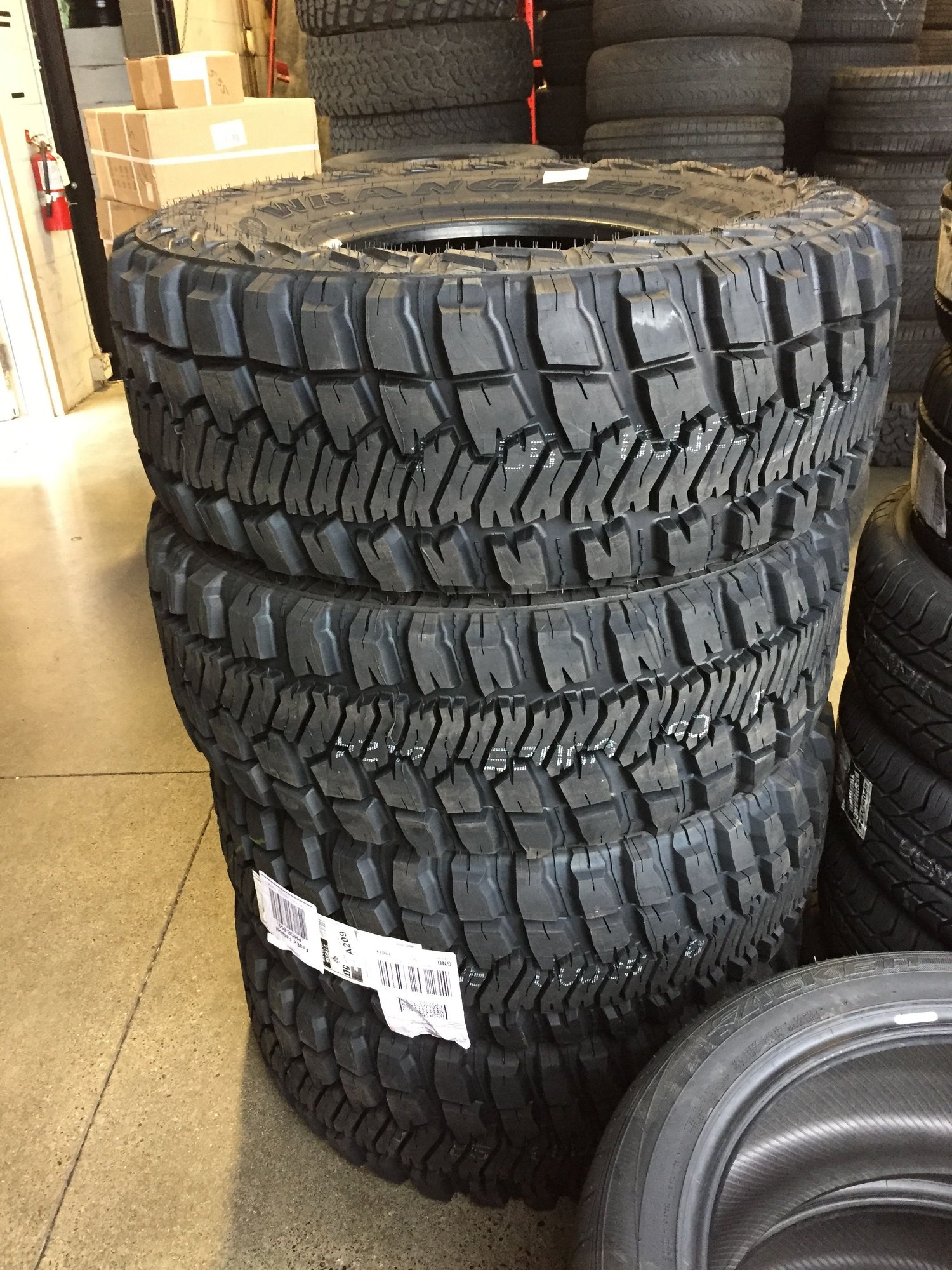

I'm in a debate on the tires... I love the Firestone Destination MT's. I've had them on a few different vehicles and they've been great. However, I'm starting to lean to the Hankook Dynapro MT's. I've got to to some more research here over the next few days.
My goal is to have all the parts for all the things I want to do ready to go when the truck comes back from the engine swap. Then it will literally be a day or 2 of throwing everything on, and it'll be ready to go.

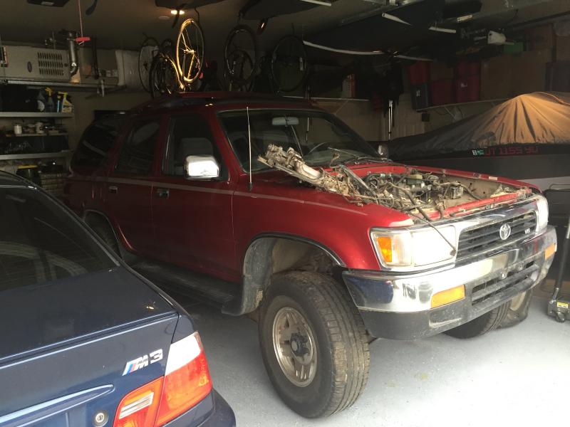

Boom!
Shop called today. I will be making the drive home with the 4Runner (282 miles) 1 week from today!
3.4 swapped!
Transmission rebuilt
Rear Detroit installed
Exhaust done with a Magnaflow and 2.5 throughout
A/C added
3/8" body lift is all it required
All set to install:
BJ spacer lift
2 new CV joints
Aisin Hubs
33x12.5x15 Goodyear Wrangler MT/R Kevlars on refurbished rims
Alpine 6.5's up front and rear
Double Din Kenwood DPX500BT (Gotta have handsfree calling)
Onboard Shower
Oh, and the entire interior except the driver seat... which is already in.
Until then, here are some photos

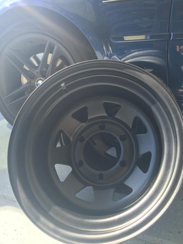

First, the new rims... a craigslist find that I sandblasted and painted.

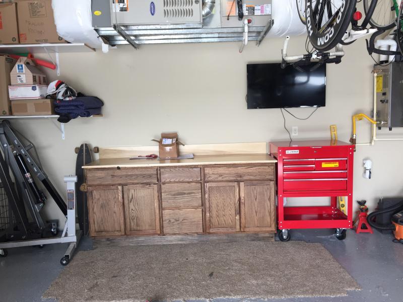

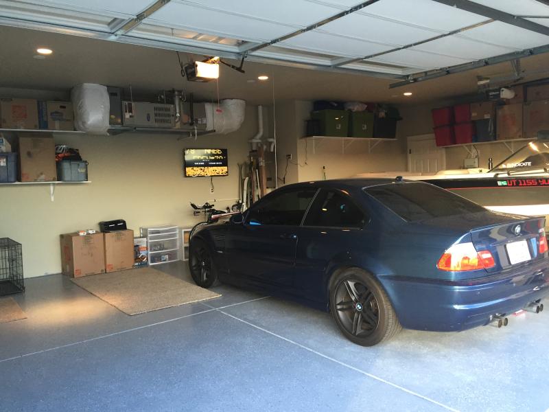

Had to get the garage cleaned up a bit
But then realized I didn't have enough storage for "car and boat stuff." So I built some storage and accidentally found a screaming deal on a tool cart at HF.
