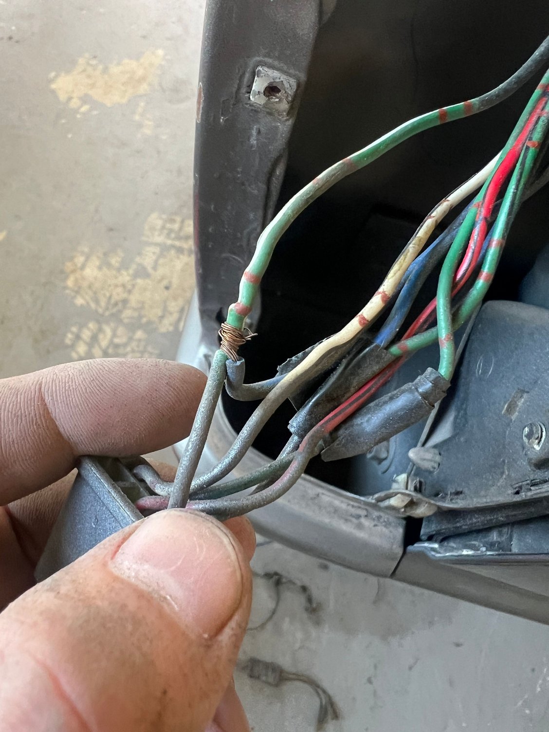

Well alternator died so my interior refresh is put on hold for a bit. Today I went to investigate a non-working brake light and ended up down a rabbit hole. Turns out it was for trailer lights but geez.

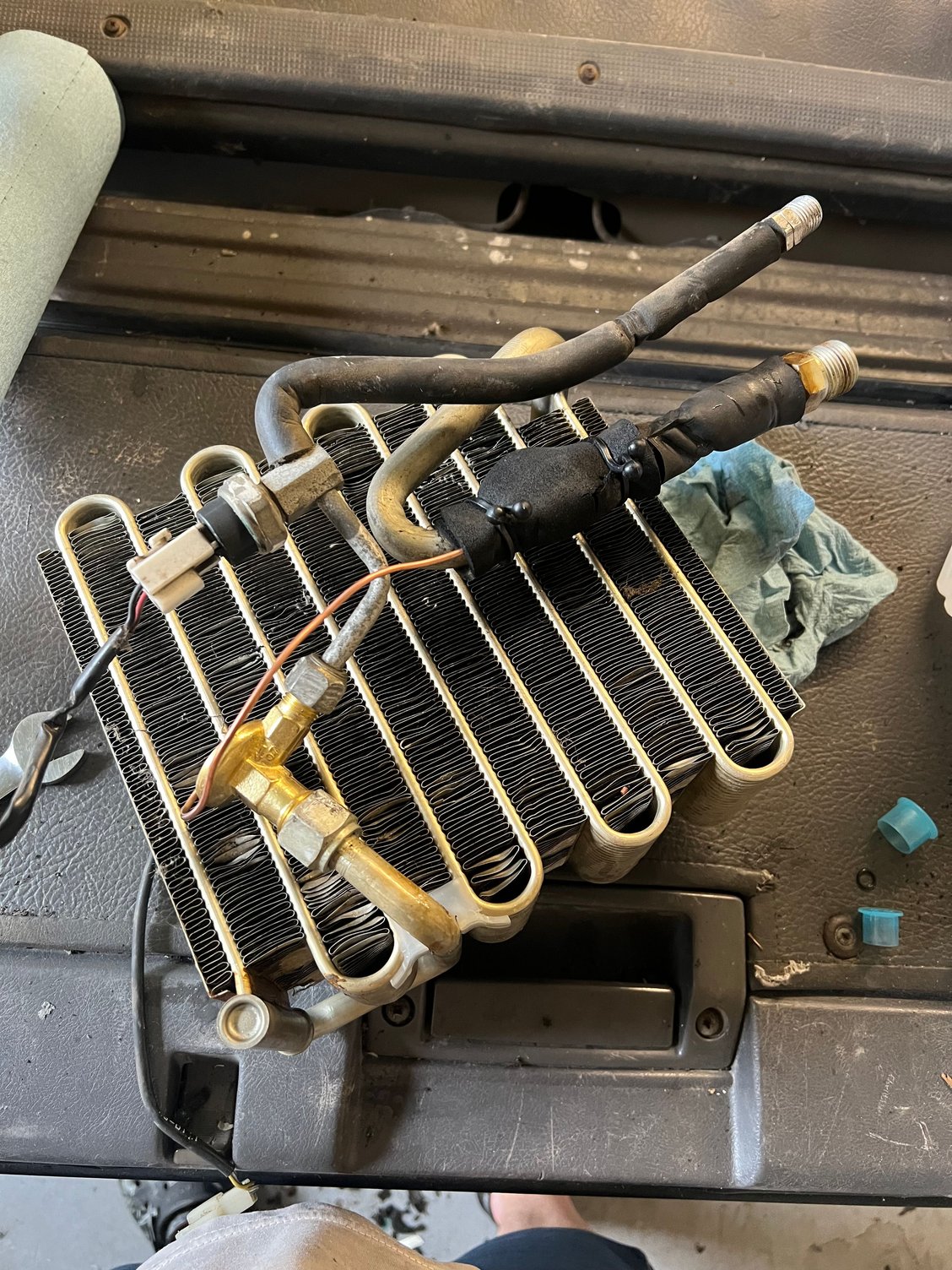

Finally got not scorching weather to work on the AC on this thing. The AC conversion valves I got didn’t fit. I’ve got a funky 3/16 and 1/4 and had trouble finding some. I think I’ve got some and we’ll find out Monday.
I went ahead and bought a new compressor thinking it may come with the valves and it didn’t. Of course I got the model specific to my VIN but my compressor has the older compressor on it. Mid year change strikes again (look at where the allen heads are).

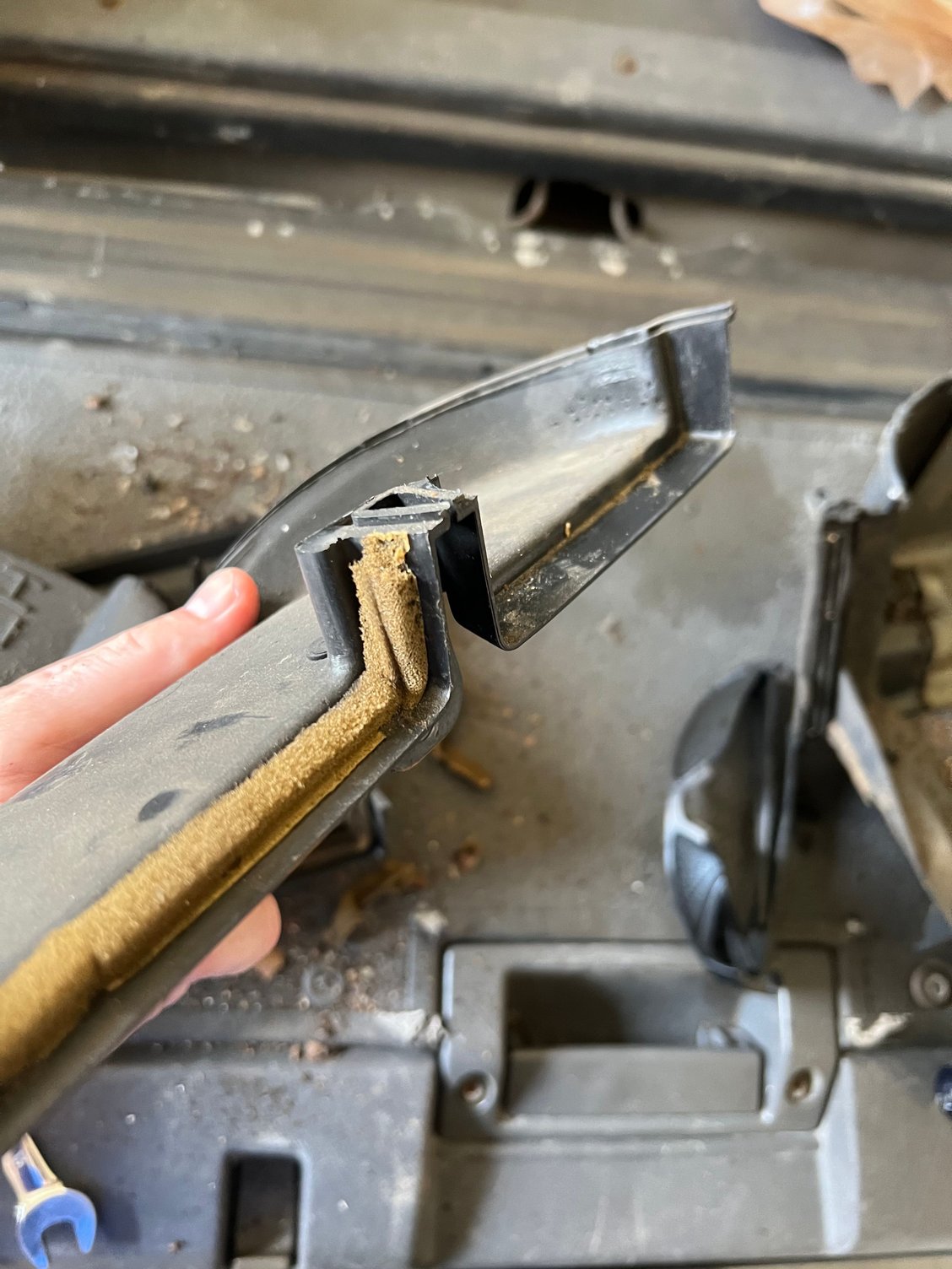

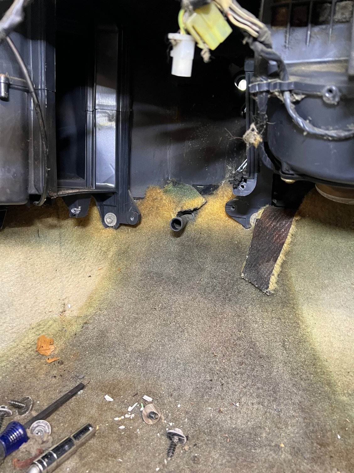

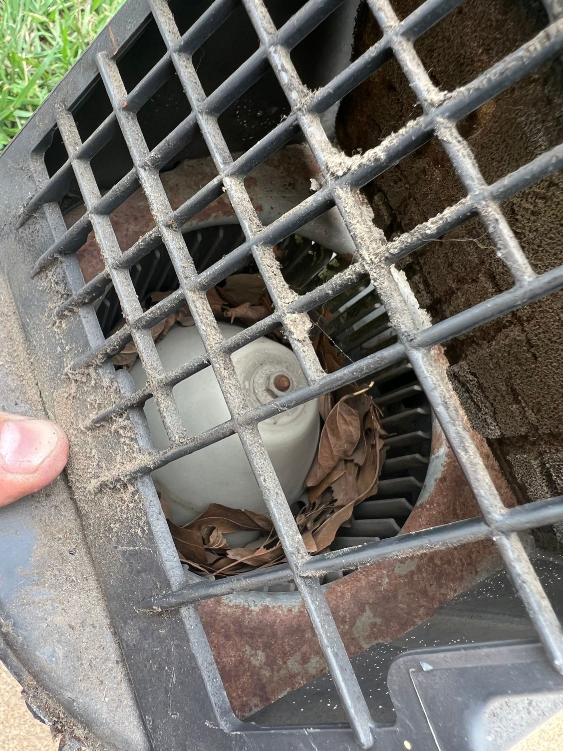

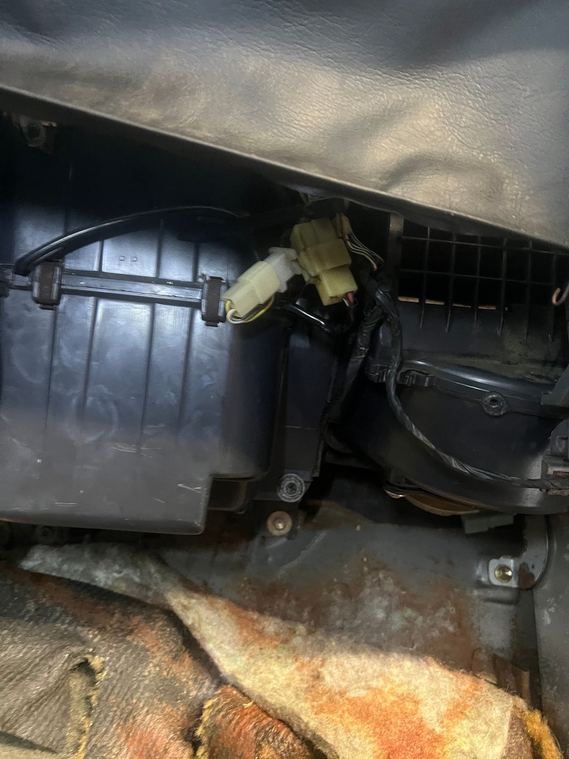

Went to pull the evaporator out to replace the expansion valve and found it packed full of crap along with the blower motor packed full of crap. So now I need to go get some cleaner and get the evaporator cleaned up.

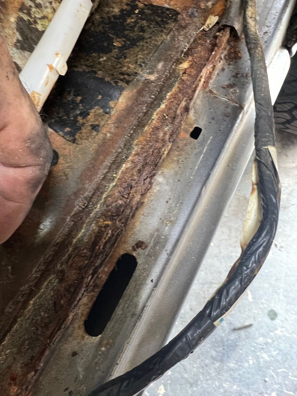

Also found rust on the passenger floorboard. It’s not all the way through but there’s a couple of spots I’m not thrilled with. Gonna have to wire wheel it and go from there. Guess I got my excuse to order new carpet and pad now.
All the foam in this system is rotten and falling apart so I need to source some new stuff to seal it back up.

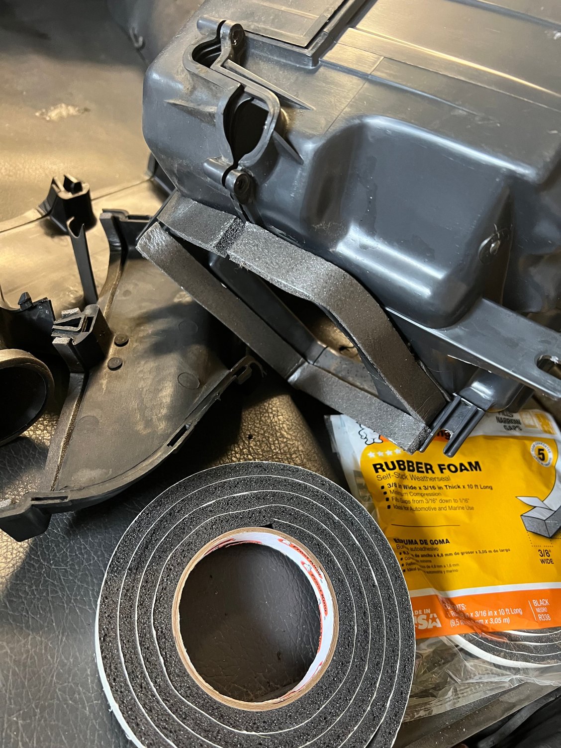

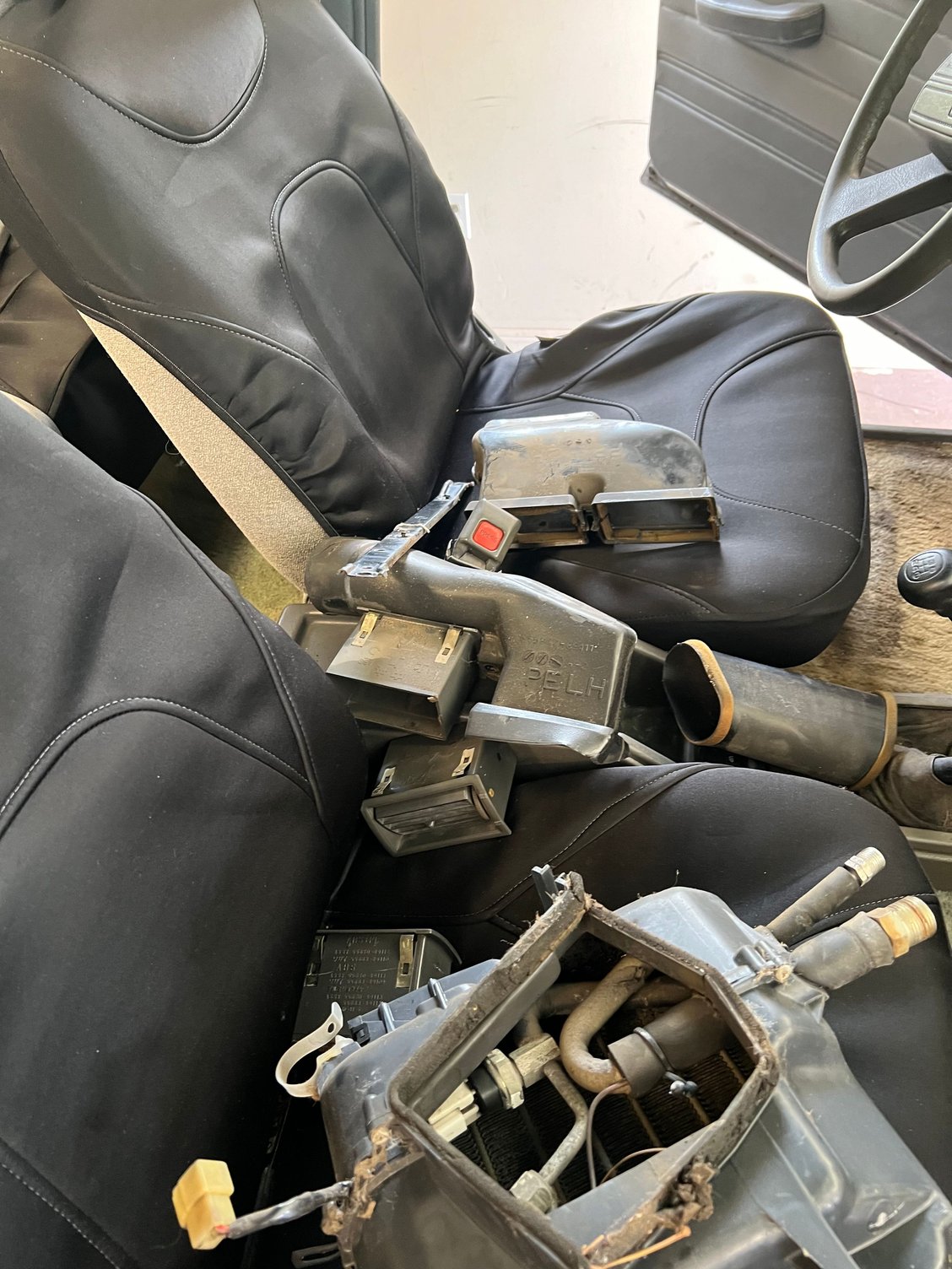

Started the hvac rehab. Replacing foam on the vents. Also got the evaporator coil cleaned out with some foaming cleaner and letting it dry. Tomorrow my plan is to remove the manifold on the compressor and let it drain out any oil there may be in it and then refill it and start reassembling.

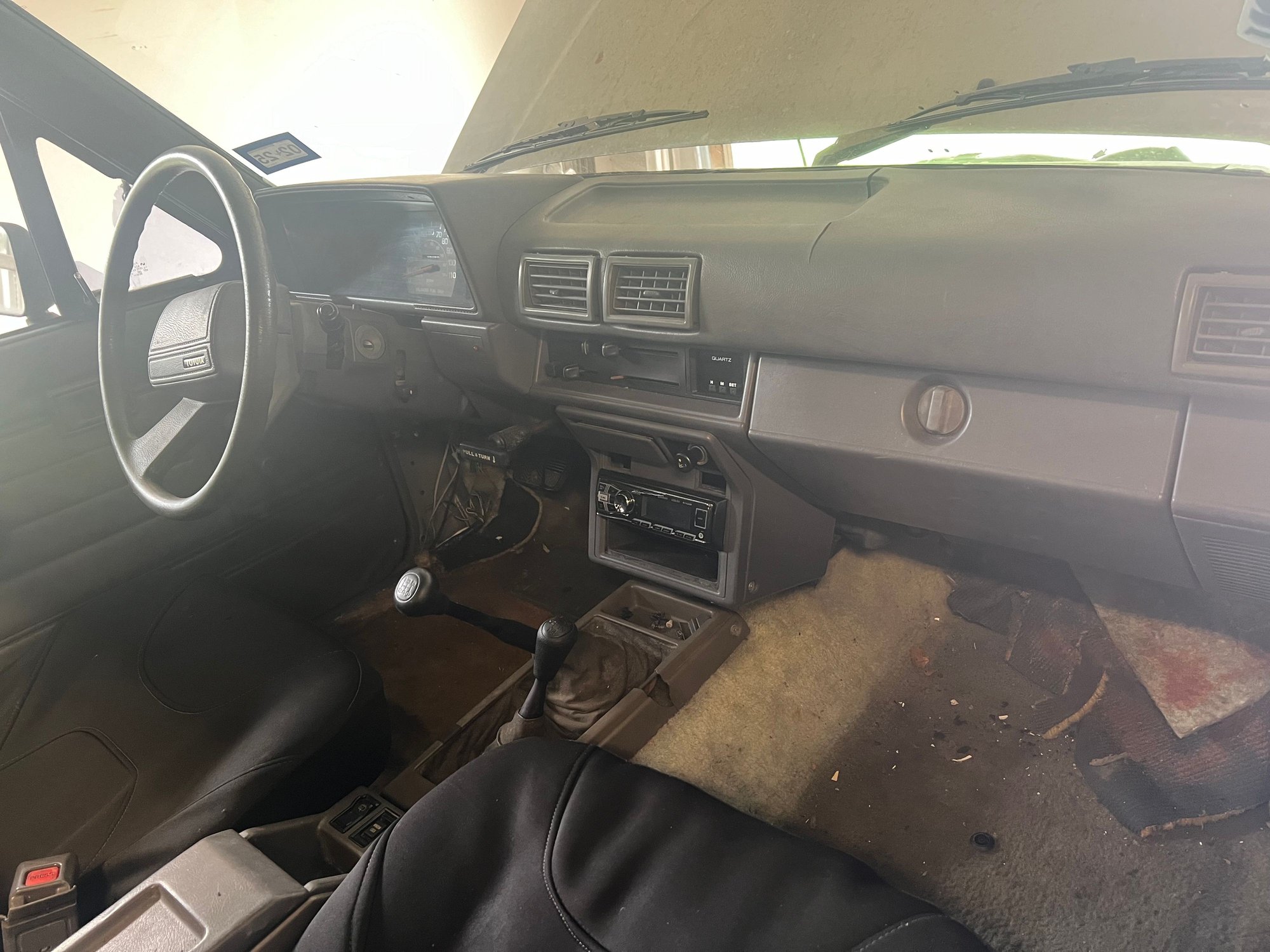

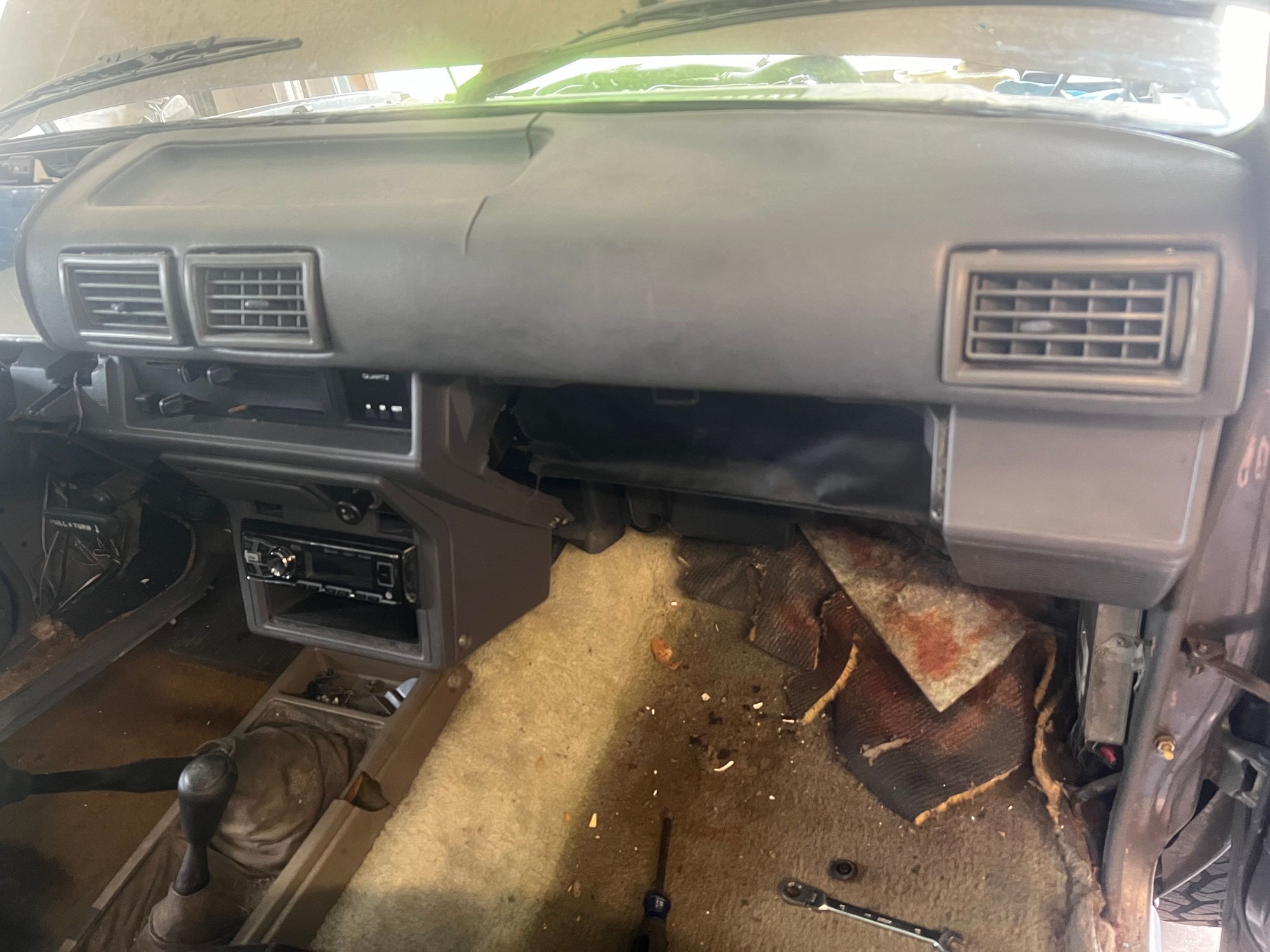

Interior is done. Tomorrow going to shoot for compressor o-rings, flush condenser, add oil, and then put a vac on it.
