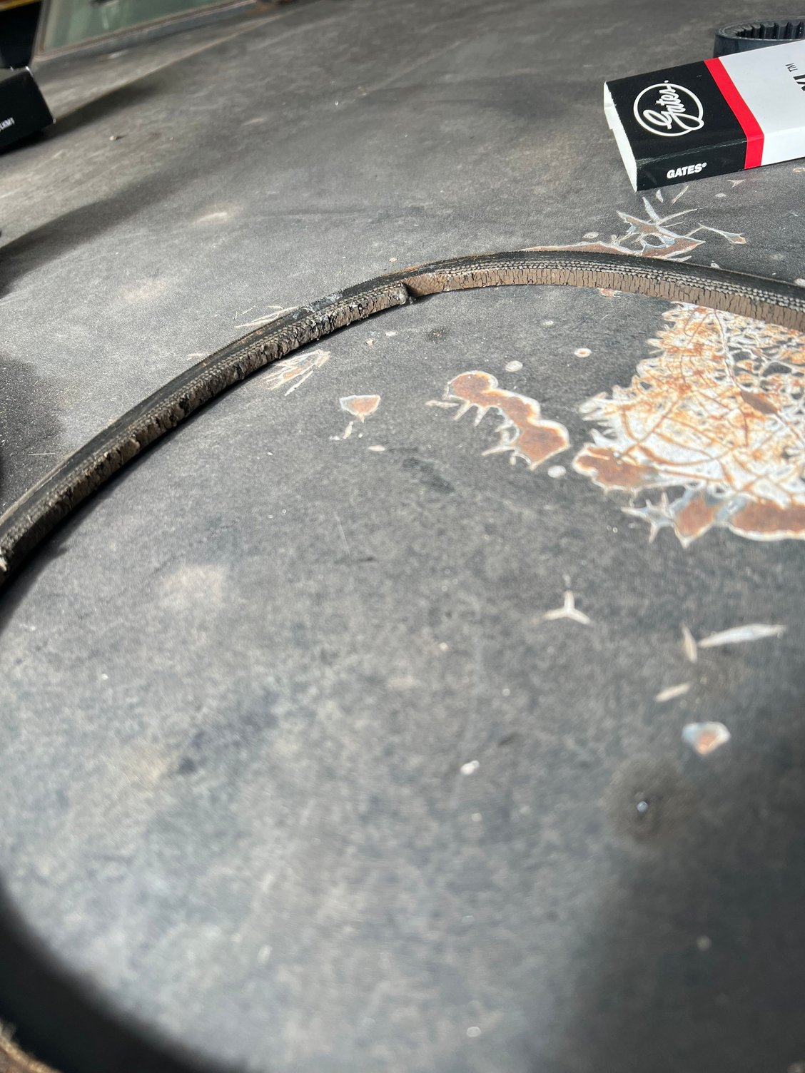

New belts and new oil and filter. Put about half a can of sea foam in the 5gals of gas in the tank. Let it sit there and idle for 15mins or so. Think the temp gauge isn’t working because it never moved. Whole thing stinks like crap burning off 17 years of gunk. It’s got a couple of oil leaks and was starting to smoke. Going to add some MMO and see if that helps.
Going to try and do the rear wheel cylinders tomorrow or Saturday.
