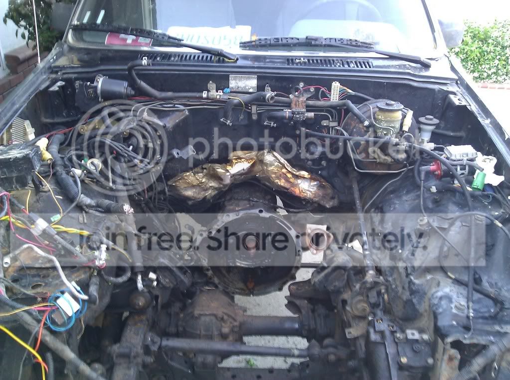

Introducing the 1988 4runner 4x4 V6 3.0...
Featuring no front bumper and not quite aligned fenders/hood since the previous owner had rear ended someone.
As a whole it's in ok condition, but the V6 has 90psi on cylinder 4 and is netting me 13 mpg. This will not do!

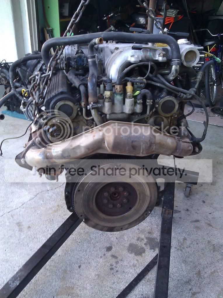

After quite a lot of parting out, this is what I'm officially starting with.
Running Engine:
Not so running truck:

And here's a picture of the flywheel I'm going to have to figure out how to drill.... I'm thinking to weld all the holes up and start from scratch.
