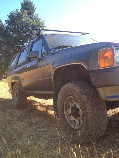

Back with an update. This summer I have been busy working, but I did some work on my 4runner too. I bought bilstein HD yellow bodied shocks front and rear. I started with the rear and also removed the 3rd leaf spring from the top of the ome pack. Man did that help with lowering the ride height and also the ride quality. I swapped out the front shocks too and overall I am way happier with the ride quality. I mean it's not a caddy, but better than before. Part of me wishes I just bought an 85 4runner because this 30 year old ifs technology isn't that much better than a solid axle, but at the same time I love my 4runner. Anyways, there is still a slight rake. Do you know if that is how the trucks were set up from the factory? I have a fsm and want to check the ground clearance specs.

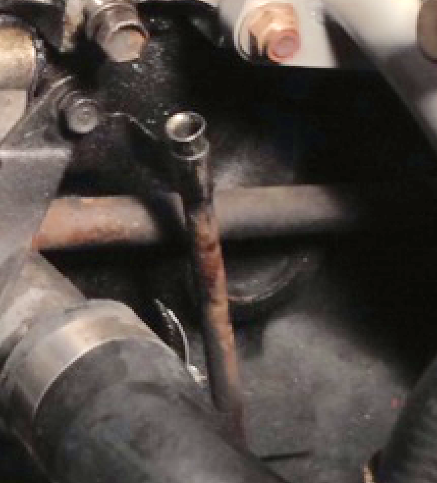

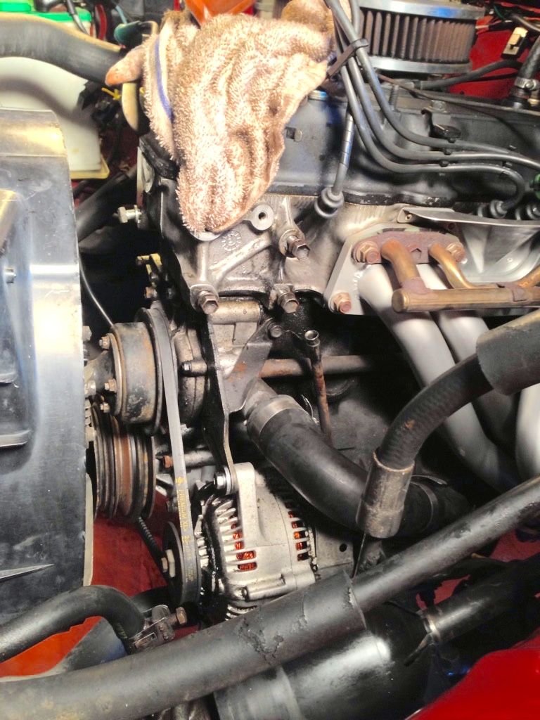

Another question I have for you guys is where do you think this oil leak is coming from? Looks like it's from the back of the timing cover if that is possible.
Leaking on block Seems to be around power steering pump bracket
One other thing I forgot to mention was that I upgraded my exhaust last winter. I had to smog my 4runner and someone stole my cat so I figured it was time for an upgrade. Magnaflow high flow 2in cat and 2.25in straight through barrel muffler. Not too ricey and loud but has a nice rumble to it.
Pics..
After removing 3rd leaf from top and installing bilsteins

I think your new stance is great. I don't know factory specs, but I would imagine you want a bit of rake unloaded so that if/when you put any kind of load in there you even out.
On your oil leak, first of all, you are missing a bolt there on what I think is a coolant tube going into the back of the timing cover. Its hard for me to tell in those pics where the leak might be coming from.

As far as that bolt, I originally thought the leak was from that coolant pipe. I got the missing bolt but the leak is still there. I'm sorry they aren't the best pics. I need to do some more looking, just thought someone might have experienced a similar leak.

In that area for oil leaks I'd suspect the distributor o-ring, which is a cheap and easy fix or valve cover gasket which is also cheap and easy. Since I can't really see the actual leak in the pics, it could also be power steering fluid, although usually that drips down onto the alternator and not so much on the block. If you really want to fix it, I'd clean the area really well and then monitor it and see where the oil shows up first.

Well I replaced the distributor o ring last year so I don't think that could be the problem. Maybe the valve cover gasket, I have to check. Definitely don't think it's power steering fluid either because it doesn't smell like it.
