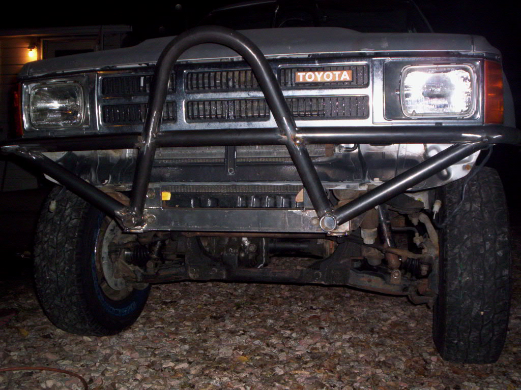

Old Nov 4, 2012 | 05:09 PM
  #27
oldgold3vze's Avatar
Joined: Jan 2008
Posts: 341
From: Loveland, CO

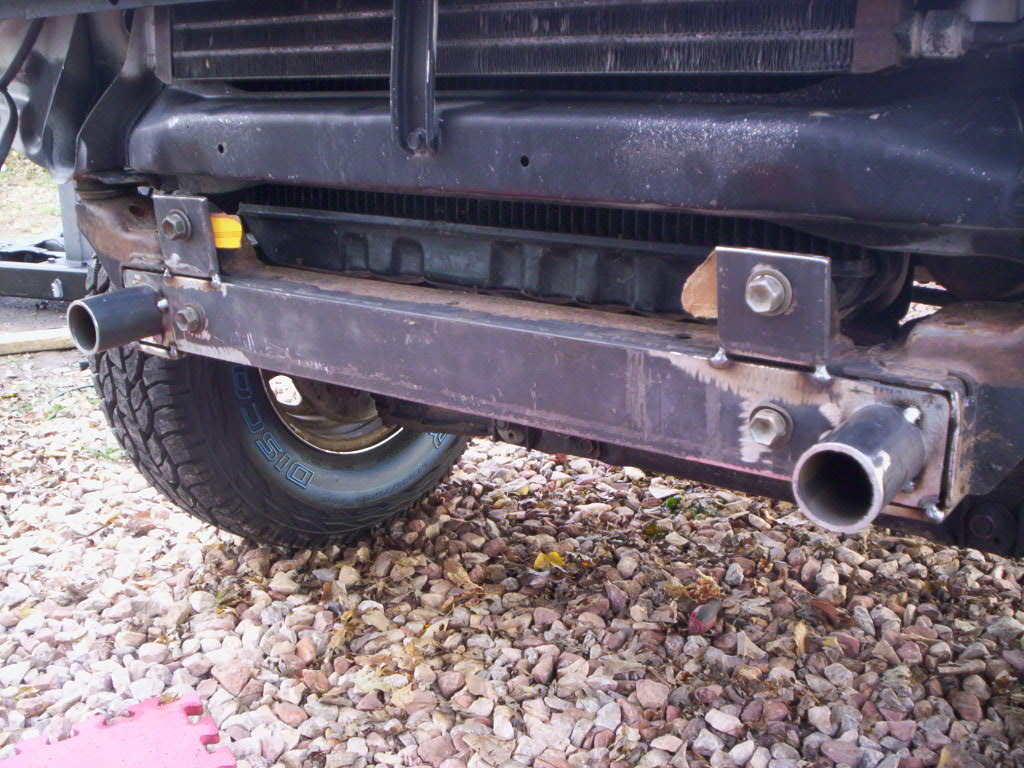

Started the front bumper.
Old Nov 4, 2012 | 06:17 PM
  #28
NickMiller's Avatar
Joined: Nov 2011
Posts: 566
From: Bellingham, WA
Bumper looks awesome! It does look like there should be something under the stinger though... Like something is missing? Any plans for a winch?
Old Nov 4, 2012 | 07:21 PM
  #29
Ytasteyellowsnow's Avatar
Joined: Aug 2012
Posts: 53
From: Phoenix az/ El paso,tx
On the previous page he mentions making it removable for future winch plans
Old Nov 5, 2012 | 01:16 AM
  #30
Joined: Jan 2008
Posts: 341
From: Loveland, CO
No winch for this one, it's tucked too close to the grill. I might add a plate in that middle space, but I've built other bumpers like this one and left the space open. This bumper is meant to be simple and offer some protection, nothing too crazy.

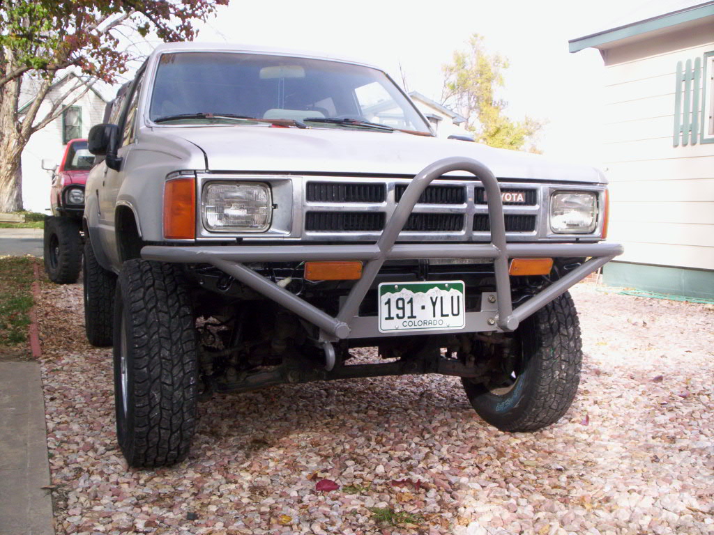

Old Nov 5, 2012 | 12:20 PM
  #31
Joined: Jan 2008
Posts: 341
From: Loveland, CO

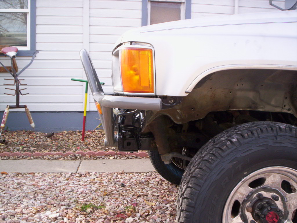

Got it mounted, but I have to pull it off to open up the 2 mounting holes on the underside. One bolt went in with my impact, the other wouldn't even start, and it holds my tow hook, so I definitely want that bolt in there. I think the license plate fills the middle in just fine.
Old Nov 5, 2012 | 12:48 PM
  #32
tinigunner11's Avatar
Joined: Sep 2011
Posts: 194
From: johnstown, Colorado
That bumper looks sick! Great job!!
Old Nov 5, 2012 | 06:51 PM
  #33
8_9_runner's Avatar
Joined: Jan 2012
Posts: 18
Nice job! I like the clean tight fit look. You ought to sell those.
Old Nov 6, 2012 | 12:48 AM
  #34
Joined: Jan 2008
Posts: 341
From: Loveland, CO
Thanks. I see way too many people with big, heavy, overhanging winch bumpers who don't ever put winches on and it bothers me. I like to keep things as simple as possible, and if there's not going to be a winch, why have the mount?
I anyone is interested in a bumper like this it's roughly 140 degrees for the stinger bend set at a 20 degree angle from the truck, and the 2 side wings are 66 degree bends. Really easy to make. Just line everything up with the grill bottom. Not much tape measure time even.

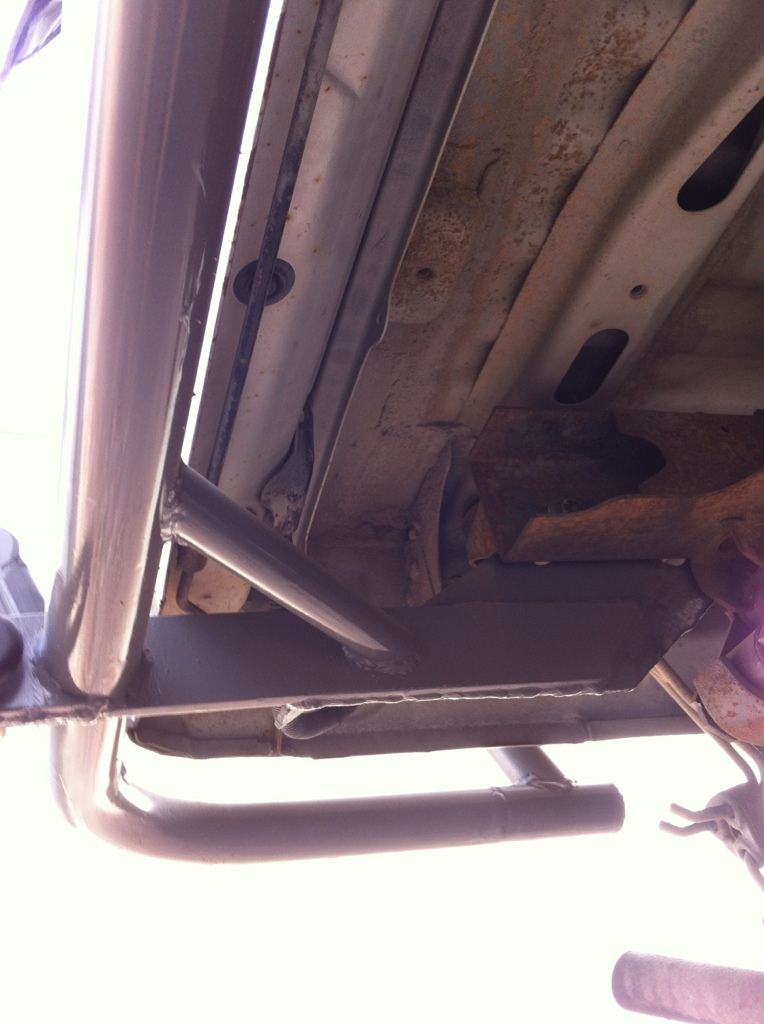

Old Nov 24, 2012 | 07:08 AM
  #35
Joined: Jan 2008
Posts: 341
From: Loveland, CO

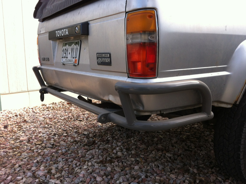

Rear bumper all done. Took my mom up to an easy trail for a Black Friday shakedown.

Old Nov 24, 2012 | 08:25 AM
  #36
Erik Hinch's Avatar
iTrader: (3)
Joined: Feb 2008
Posts: 314
From: Virginia
Never seen mirrors like those, what are they off of? Sweet ride BTW. I recently purchased my 8th toyota '86 Runner called TUCK! [IMG][/IMG]start and after the lift pics.[IMG][/IMG]
Old Nov 24, 2012 | 08:39 AM
  #37
westjohns yota's Avatar
Joined: May 2011
Posts: 1,751
From: pensacola FL
wish i could find a 4runner for 500 bucks, everything around here people think its gold, more pics of your 80?
Old Nov 24, 2012 | 04:03 PM
  #38
Joined: Jan 2008
Posts: 341
From: Loveland, CO
The mirrors were on there, and are garbage, but oh well. Tuck looks great. The 1980 can be seen here. It was a true junkyard build.

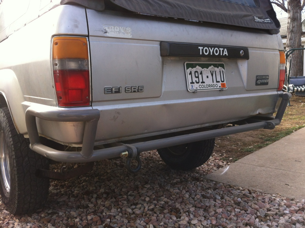

Old Nov 25, 2012 | 10:50 AM
  #40
Joined: Jan 2008
Posts: 341
From: Loveland, CO

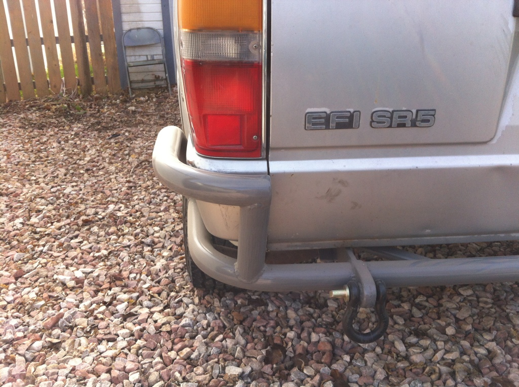

More of the rear bumper.
