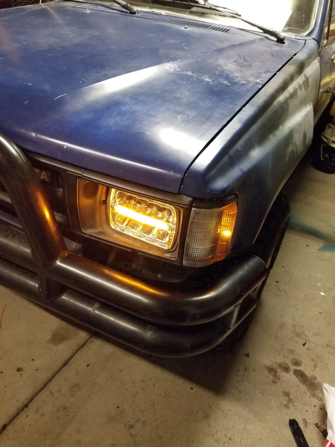

Power steering installed
Aluminum radiator
New tires
Smittybilt Front Bumper
Hilux combo running and signal lights
LED headlights with DRL and blinker
Exact fit Hexo floormats

I have the same combo corner lights, I have not yet hooked up the turn signal though. I still have the turn signals in my bumper. Did those corner lamps come with bulb sockets for the turn signals? I bought mine on eBay, they shipped from Thailand and of course came with no bulb sockets.
Those headlights are pretty neat, I've never seen that turn signal feature integrated into the headlight. What happens at night with the headlights on, can you even see the turn signal over the glare of the headlight beam?

My corner lights did not come with the bulbs or sockets, but I grabbed a set of 194/168 sockets at Autozone. As for the DRL/blinker in the headlight, the DRL most certainly is lost in the glare at night, but the amber blinker is still fairly visible. On the topic of glare, these have a pretty nice cutoff for low beams and the highs are not as focused as a projector, but less scattered than an HID in a halogen reflector bowl. I'll get the obligatory pics once I get it out on the road. Overall, I have plenty of light output (not excessive) for hi, low, and turn signals.
