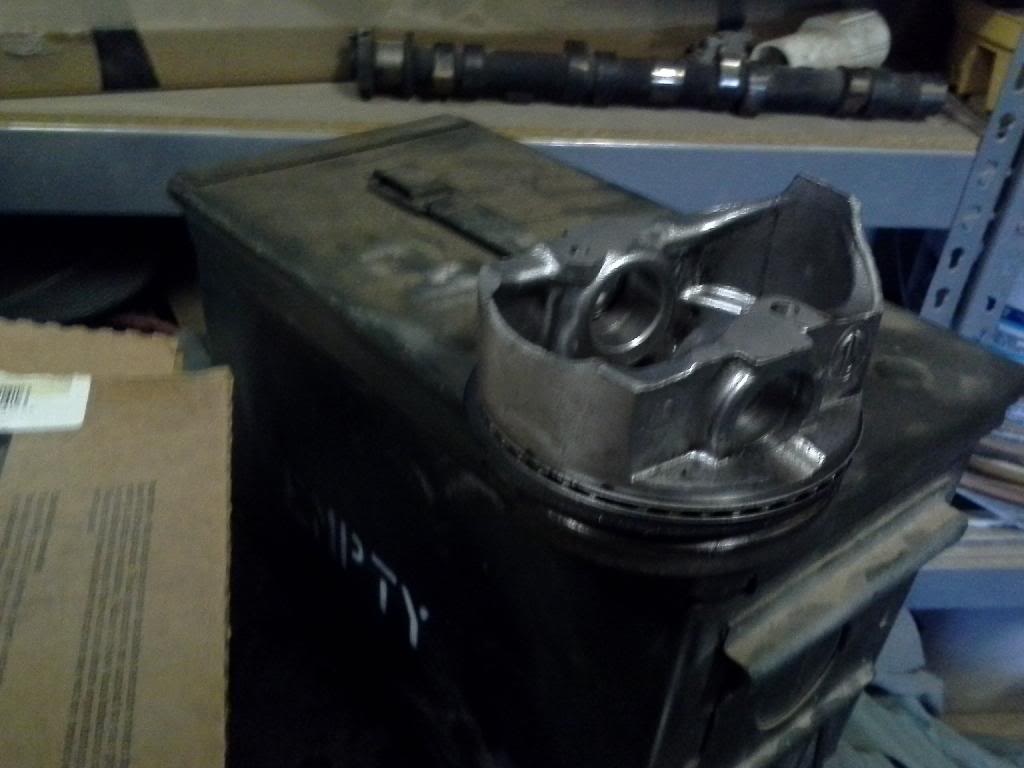

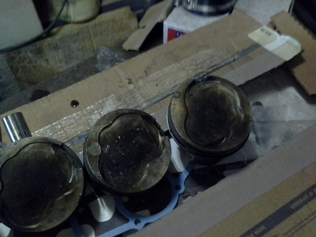

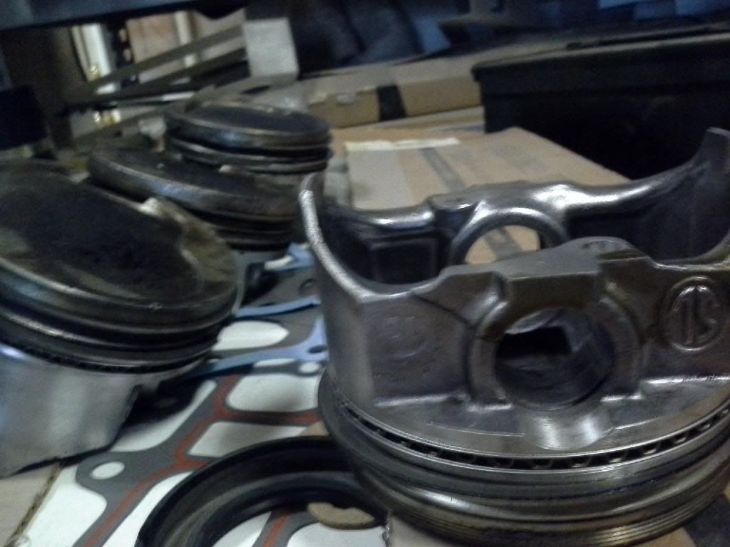

With that catastrophic failure, I pulled the head to inspect valves, and in finding the one piston blown, ordered a new one with matching weight, but only after buying and assembling a Megasquirt in order to (hopefully) prevent any of this from happening again.

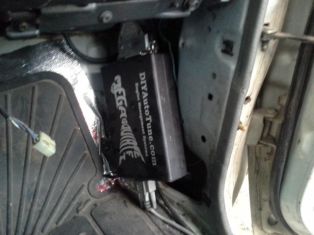

After re-assembling and running with Megasquirt (huge undertaking! I am still learning so much about Engine Management!), I learned the engine builder had done even more work than stated! Ported/gasket matched runners, (later model) intake mani, and throttle body, deburred/shot peened con rods, deburred/balanced crank, then ARP Crank Bearing studs, and ARP Con Rod Bearing studs! Even with all the additional time and energy I had to put in, just having all that was well worth it!
Then, a week later, SUPER CATASTROPHIC FAILURE!!!!!! Fuel line popped off mid-rev, underfueling/oversparking again, this time blowing the tops off the OTHER 3 pistons, breaking the skirts on two, one of which was the new #4, which then pushed its' pin out, cutting a tremendous groove in the cylinder wall! OH SO MUCH FUN! Crazily enough, it drove a couple miles home!

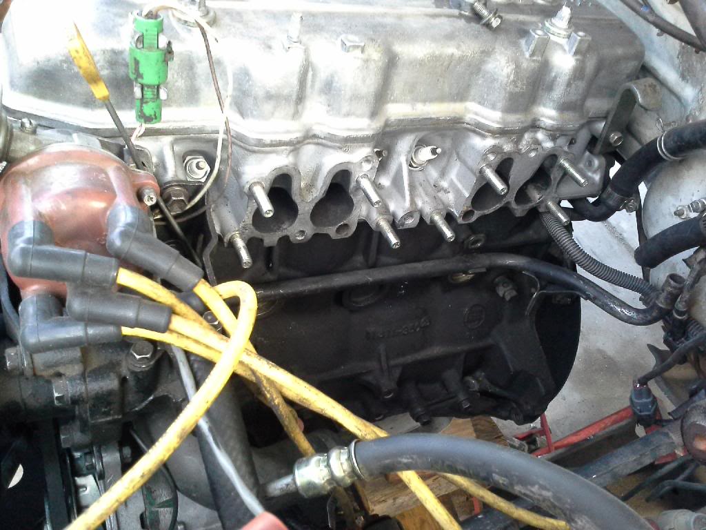

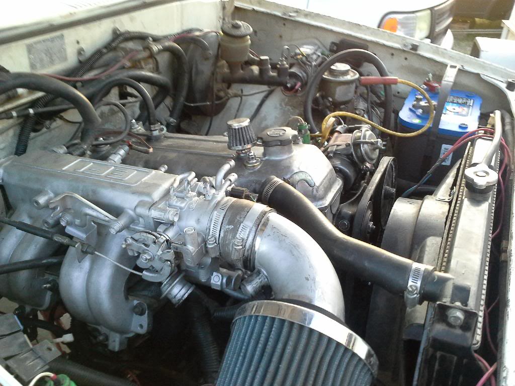

Lost two years worth of pictures when my tablet/laptop were stolen, but I got a few here real quick with my tablet, not the best quality, but it's mostly pics of broken things anyways, haha. I'll show ya'll the scored up block tomorrow. Also forgot to mention i effed a freeze plug or two, most importantly one of them was on the back of the engine, ha! luckily I had two sets for no reason, but I pulled the tranny to clean it and get at the rear one/replace any seals I needed on the trans. Found out it is a g54/58, so marginally better than the stock g52 it came with! It will need a rebuild before long, seems like the inner input shaft bearing is a little worn, but there is minimal play, so it should last until I can afford to tear into it again.
Obviously a bunch of things are disconnected, I need to finish making a battery swap mount and clean up some wiring, but it did run before I pulled the trans, so all is well!
