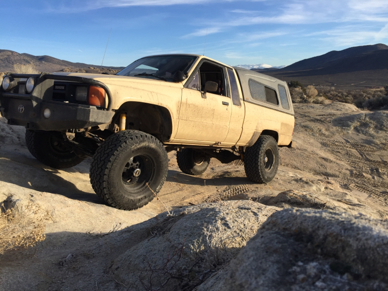

I just installed my OME 3" lift on my 85. Rides awesome and the install was pretty straight forward. I didn't use greasable bolts or sleeves. I heard that the polyurethane bushings are fine without sleeves but I am not 100% sure.
Attachment 103924
Attachment 103924
