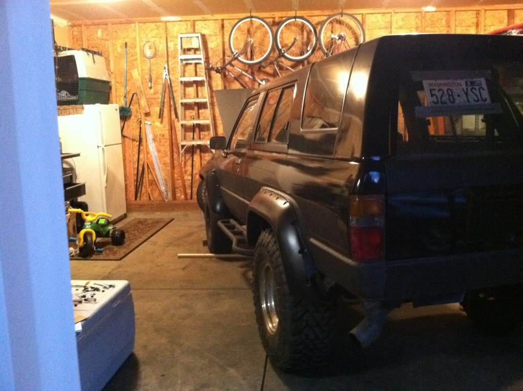

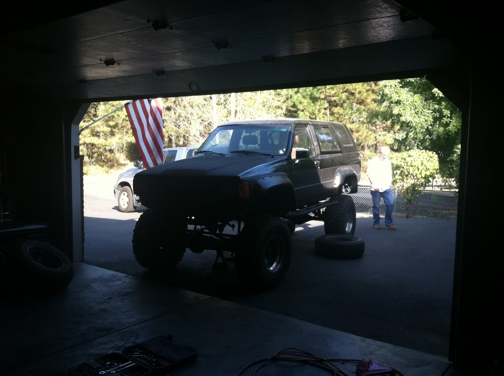

getting the 33's on now. stock suspension

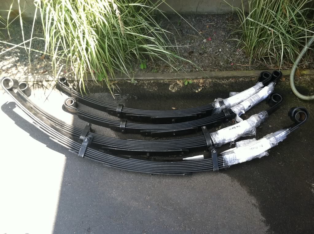

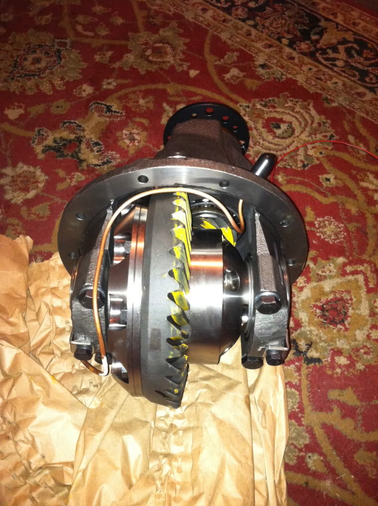

oh shoot. these arrived from wabfab!

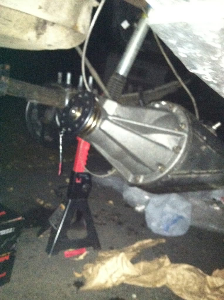

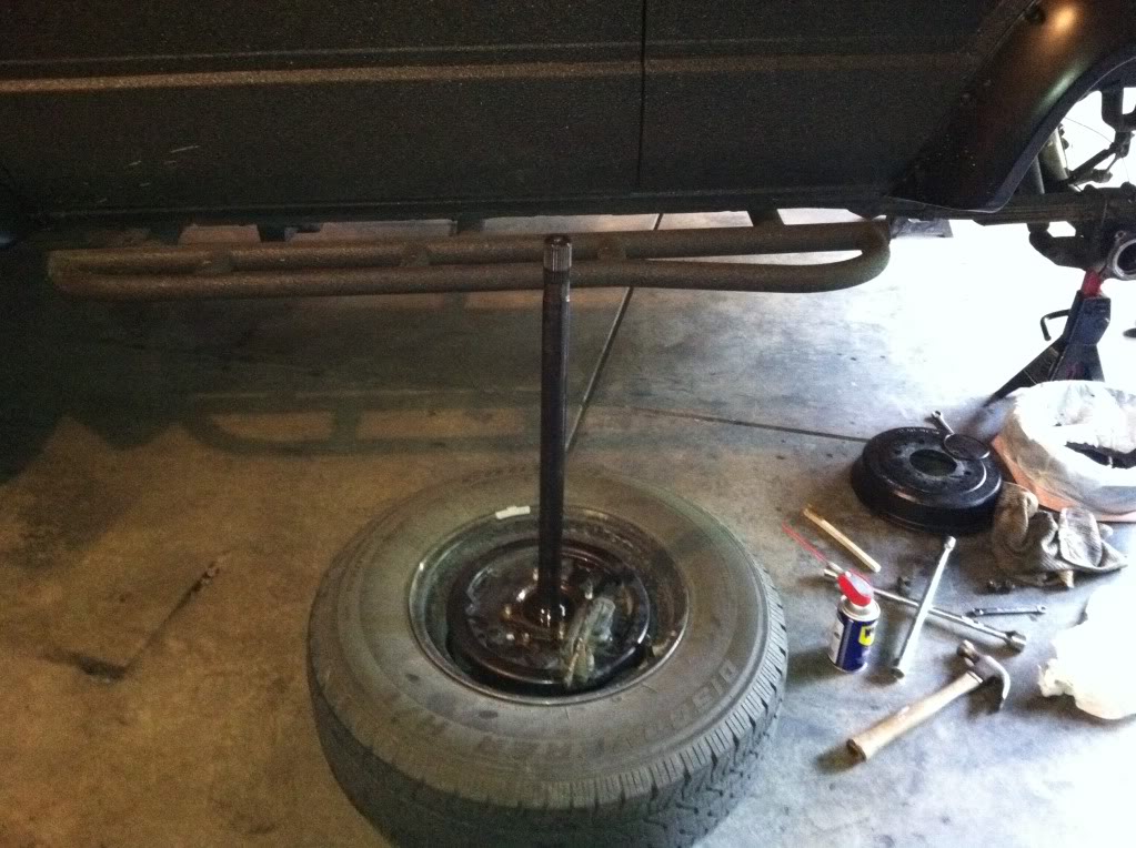

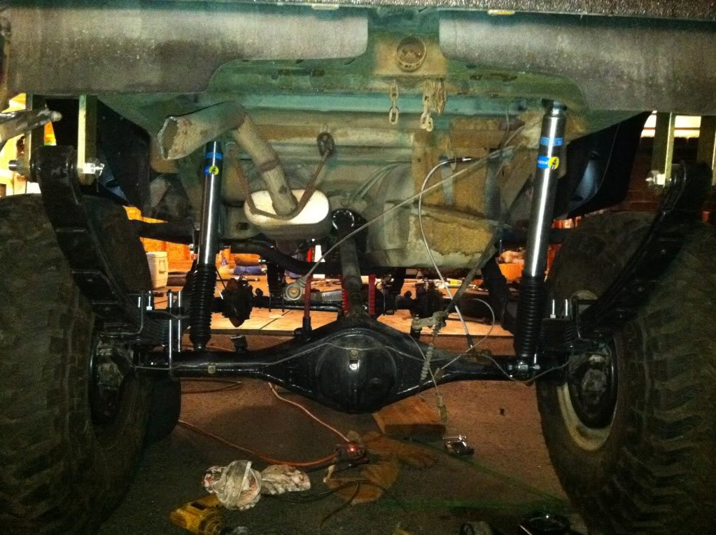

had to replace the rear bearings. not sure if they were making a lot of noise or what, can't remember. It was necessary though:

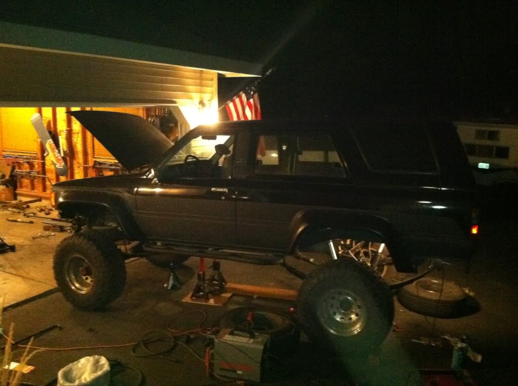

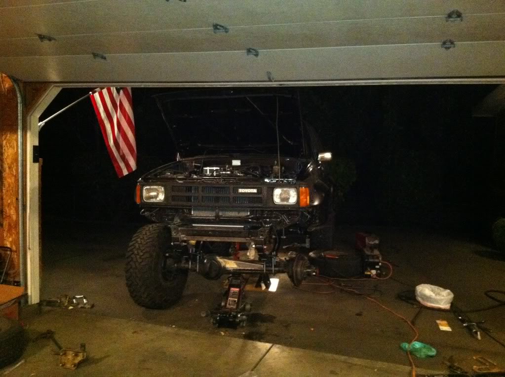

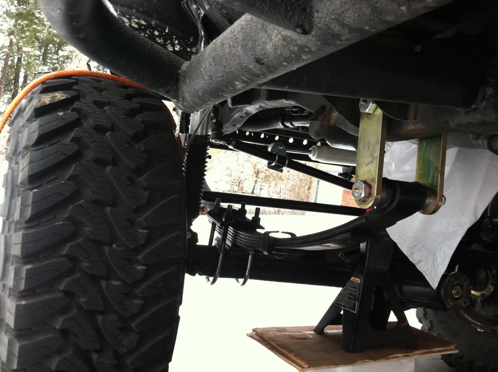

Finally!! on to the lift. I don't have a ton of photos because it was put up in a fury. Me and a friend put it on in a couple days, then it sat for a little until I finished the cross over high steer.
This image is deceiving, it isn't crooked:

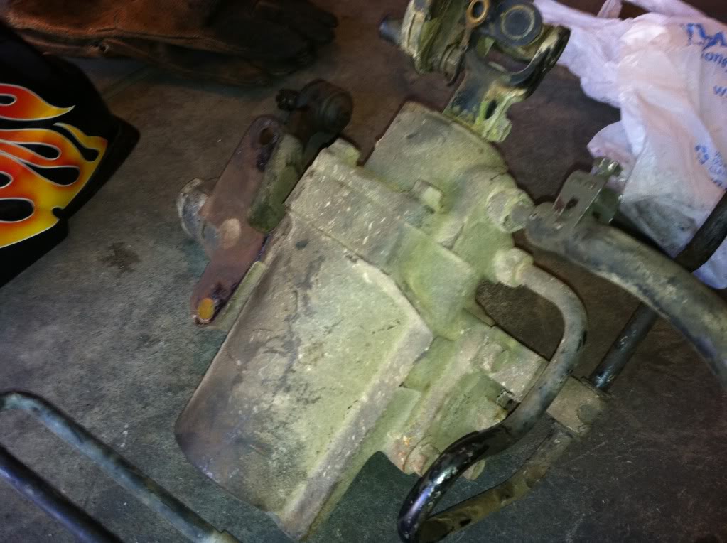

p/s gear box. earlier lower ratio IFS style.

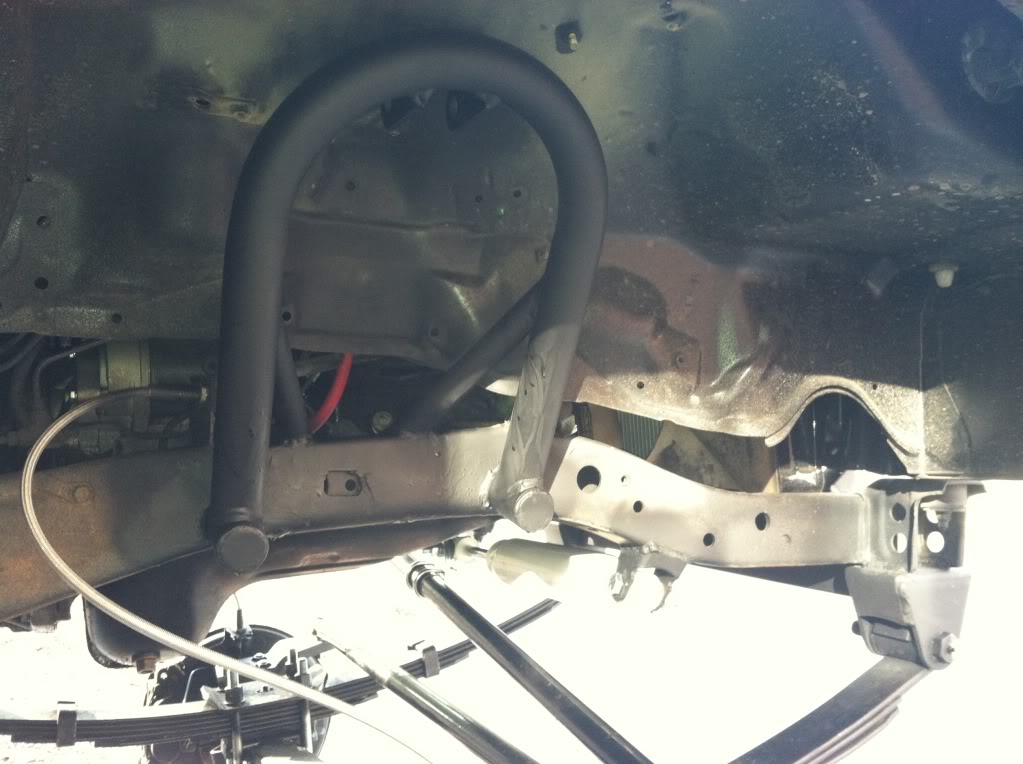

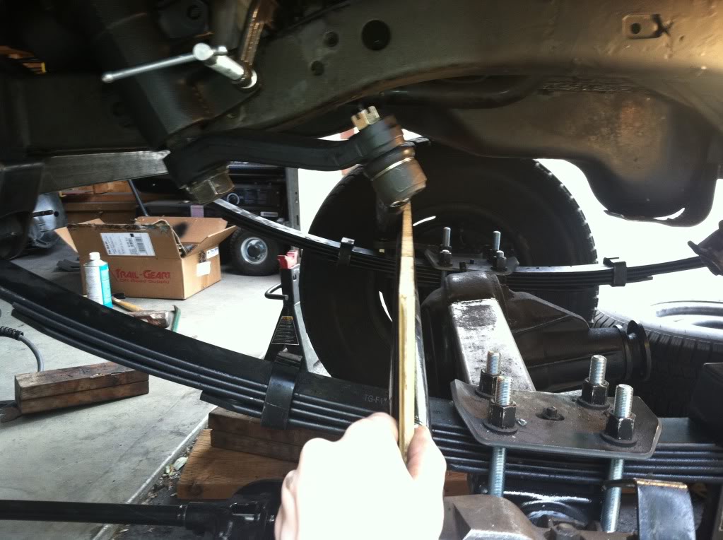

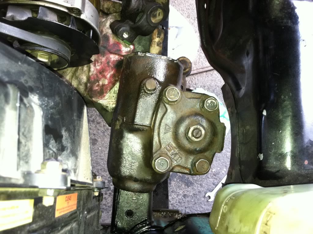

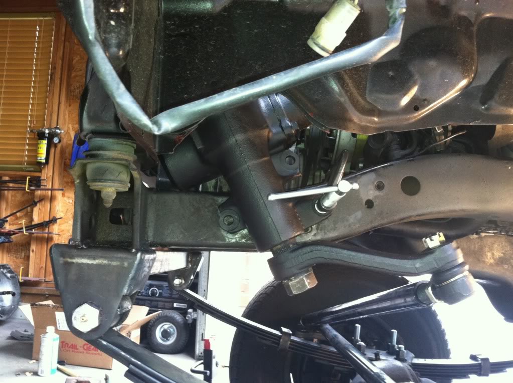

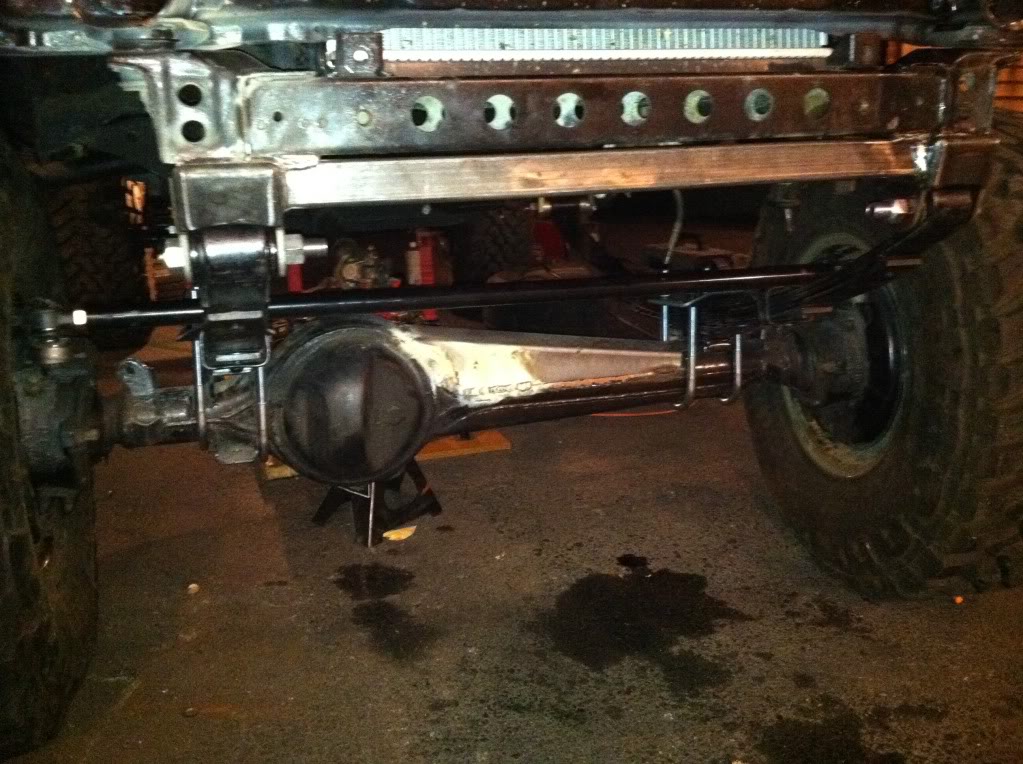

setting up the IFS steering box. need to make sure there is enough clearance under flex.
I ended up having to push it through the body/front support a little, next to the body mount. If I find a picture of the final position, I will post it up.

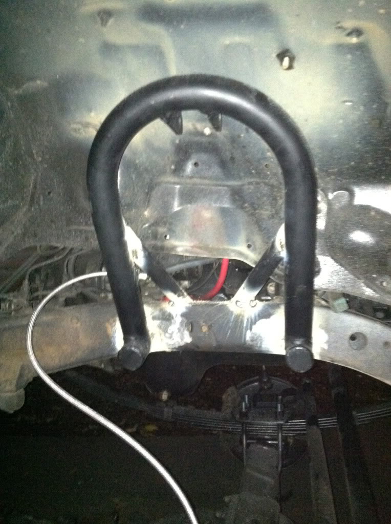

shock hoops getting welded up:
shocks all finished up:
steering stabilizer, what a huge difference it makes. I think it could actually use another one or more resistance.

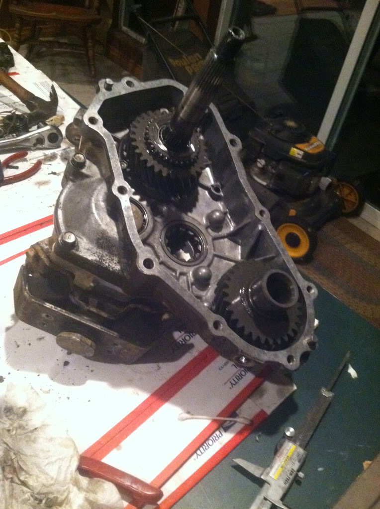

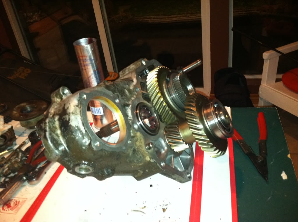

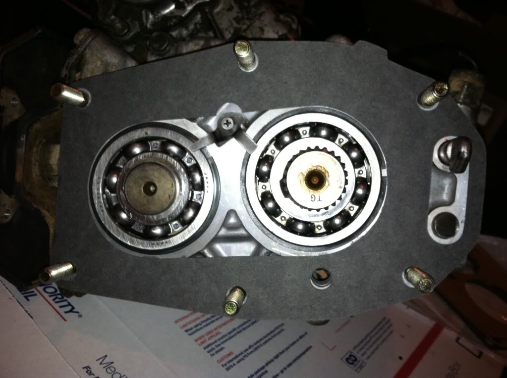

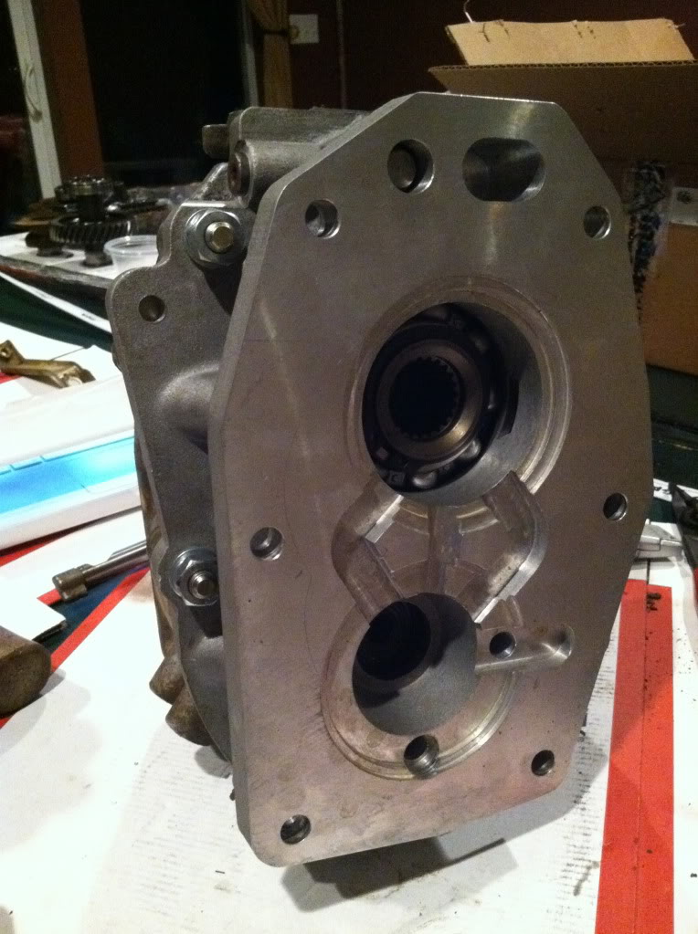

And the dual case build with 4.7 yada yada yada.

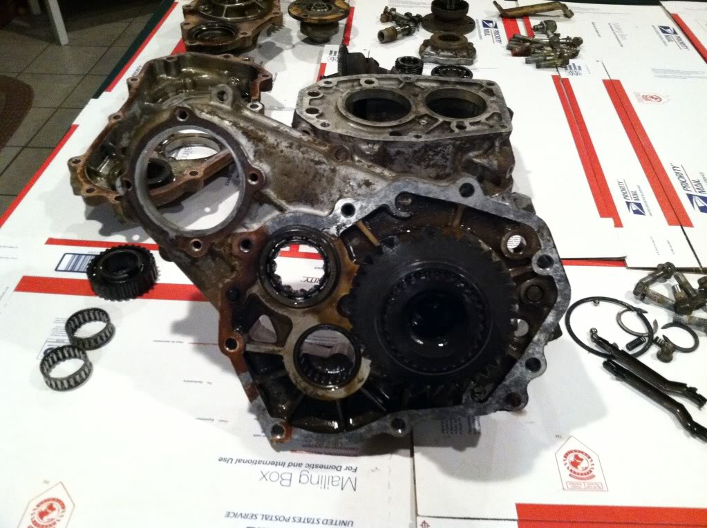

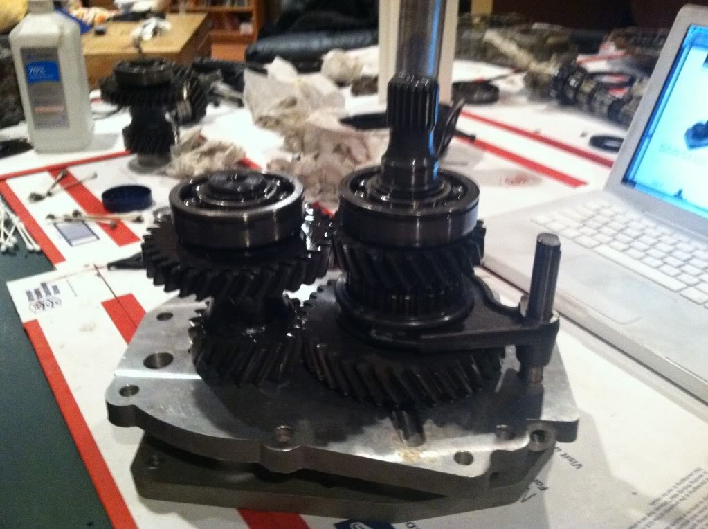

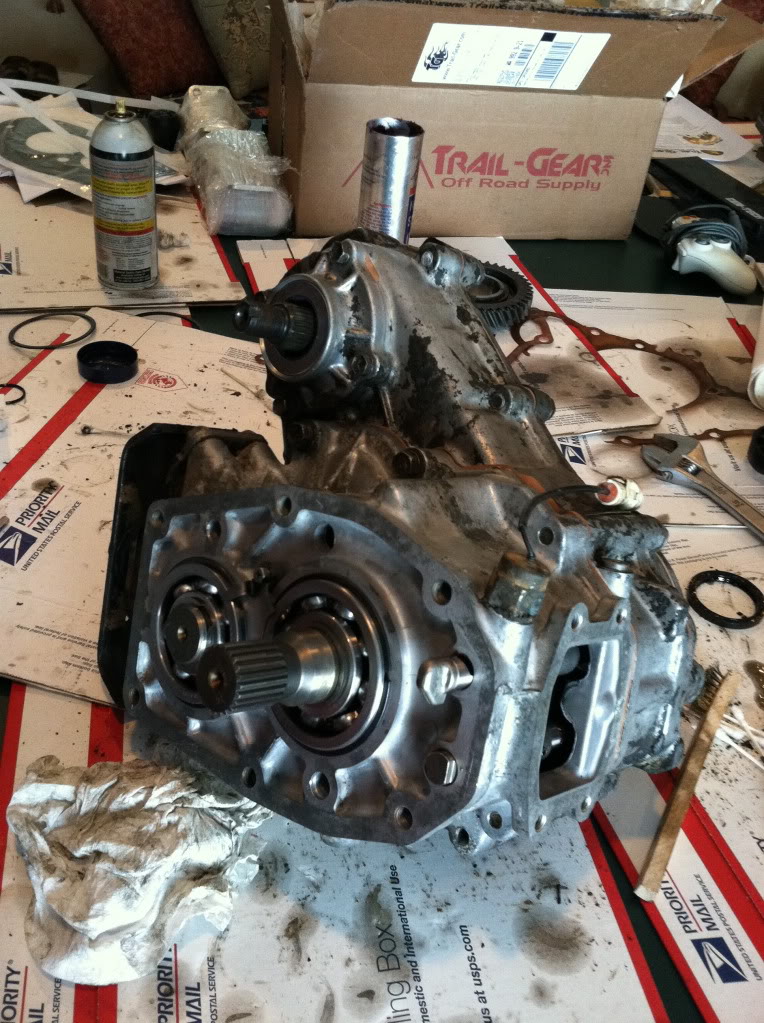

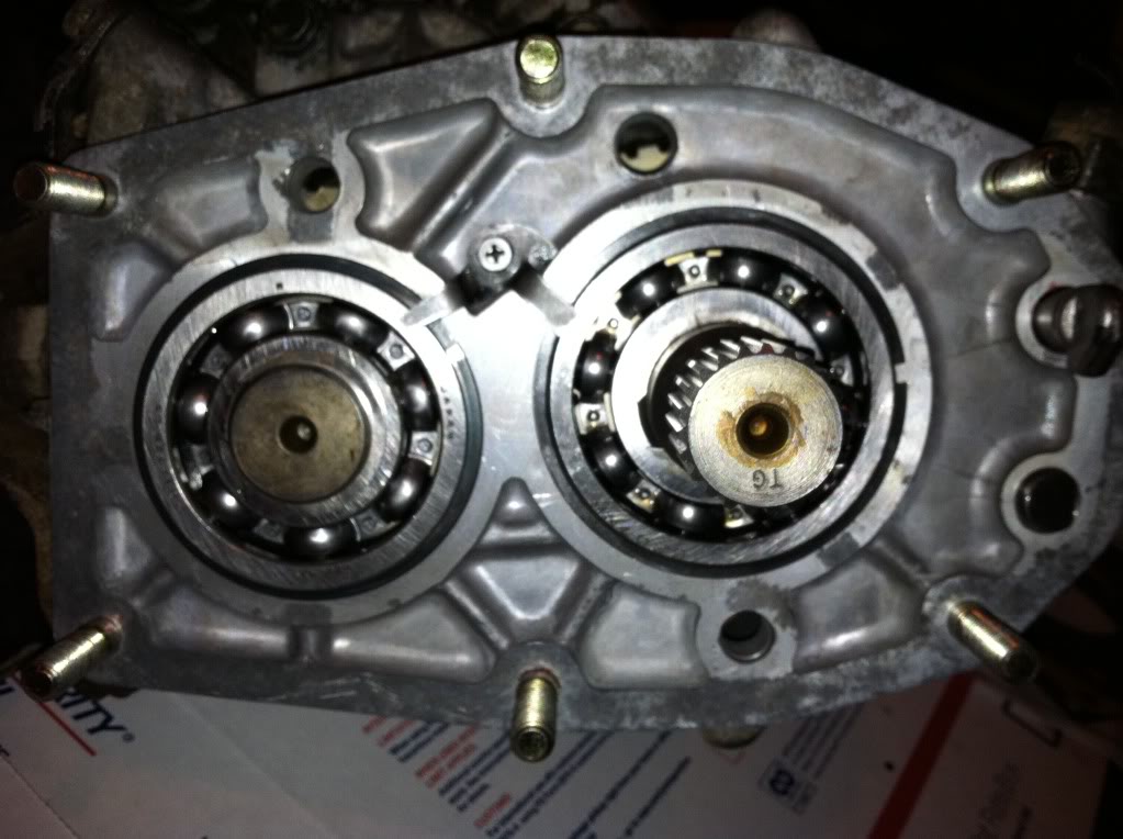

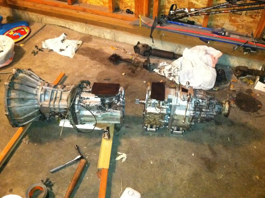

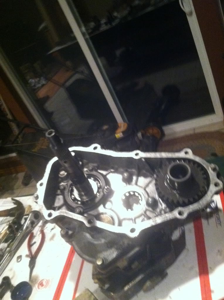

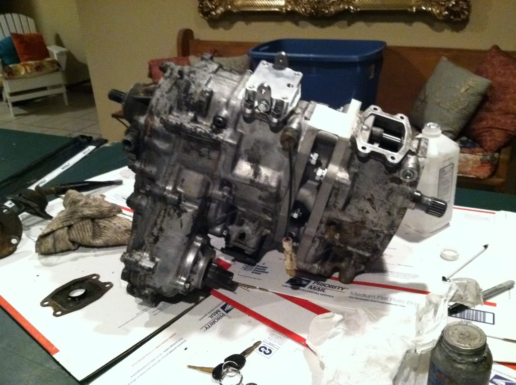

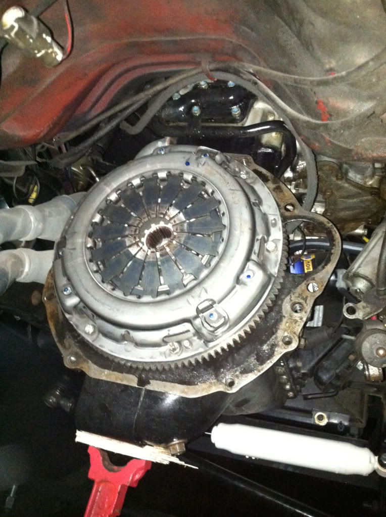

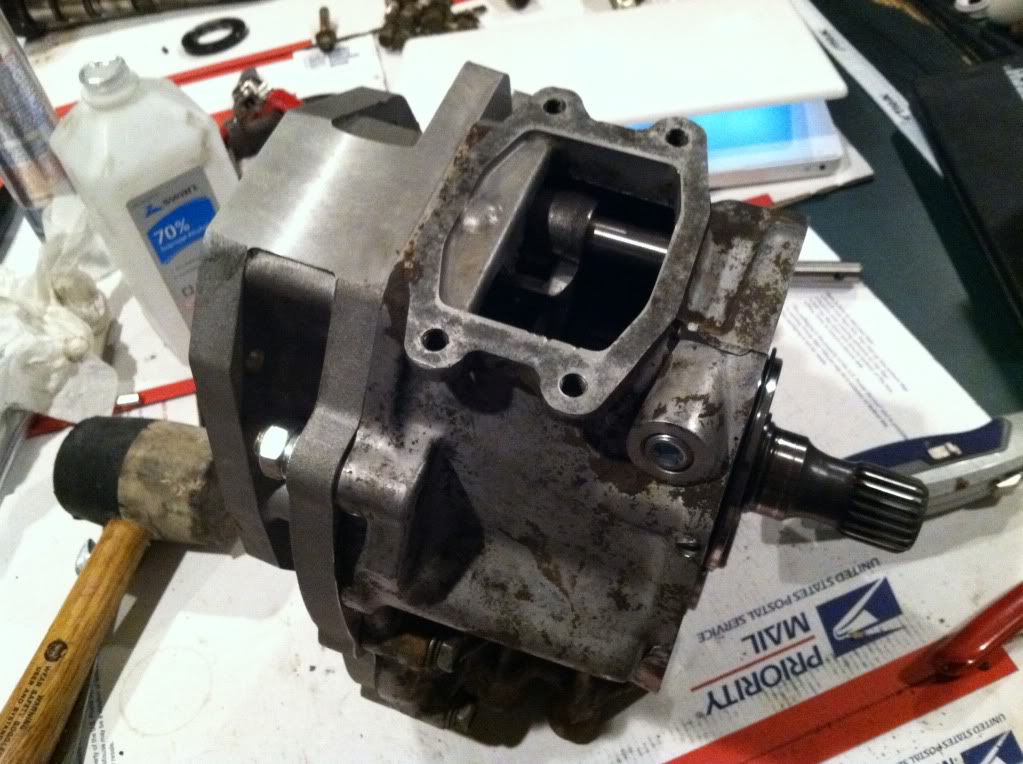

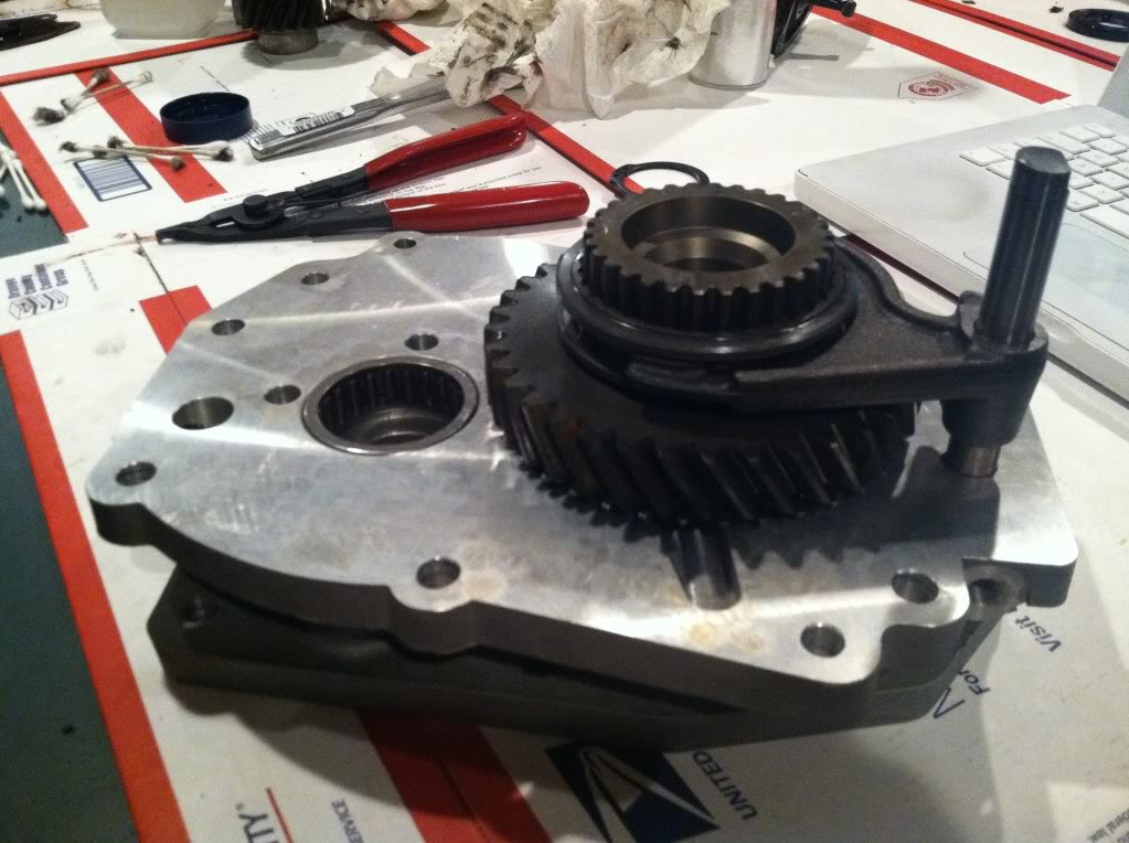

replacing tranny input seal, was leaking:
all shiny:
mating the two up:

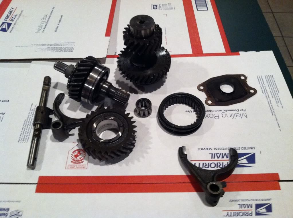

I lost the g series tranny and picked up a w56. Ended up being a PIA, had to rebuild it.
https://www.yotatech.com/forums/f116...ng-way-257925/
taking anti rust precautions. I pretty much recommend rustoleum auto paint for all of this kind of stuff. I had used POR15 and all that good stuff. The rustoleum is way less picky and is super fast and surprisingly durable for a spray paint.
and she's all ready to go.

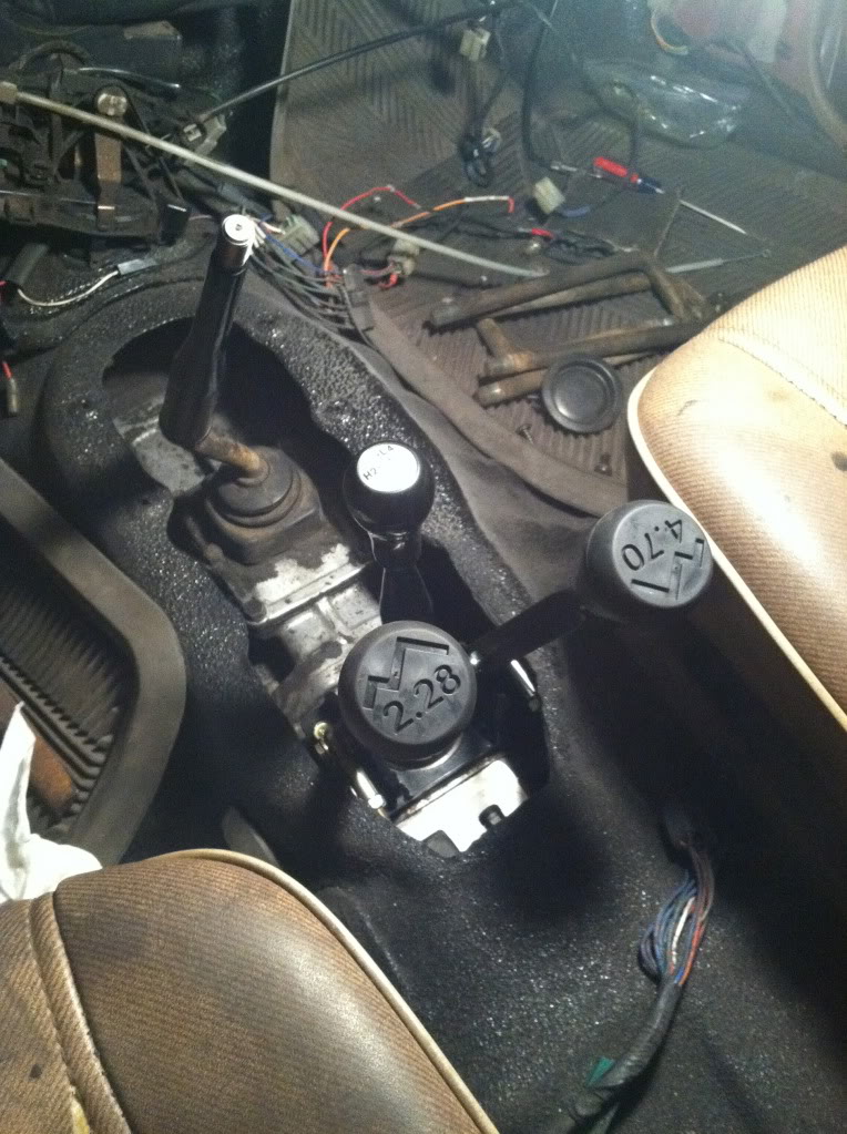

making room for the triplets:

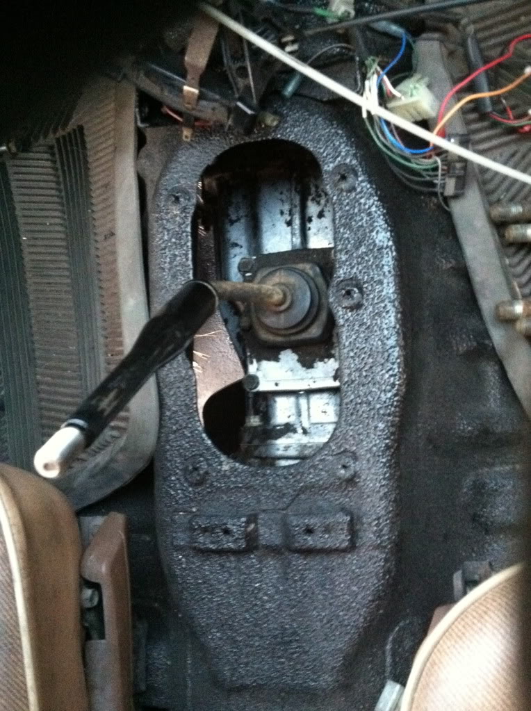

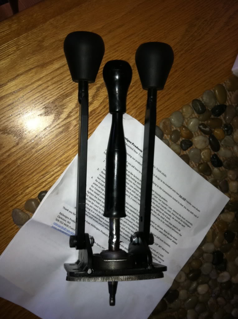

Can't recall which vendor I got the triple shifters from, but I have not had any real problems with them. I used the HD springs for the shifters on the transfer cases, so the shifts are pretty stiff and there has become a little "slop" in the shifter linkage (not in the transfer case). I haven't taken a look at it yet, but that part could have been designed a little more robust. I'm guessing I will have to remove them and weld them to make it a little stronger.
Cleaning or something:

I had to straighten the middle shifter on the top of the front case so they would all sit next to each other. Easily down with a grinder and welder. Just cut it 3/4 way through, bend it and then weld the space that needs filled. Not even a whiff of it wanting to bend/break.

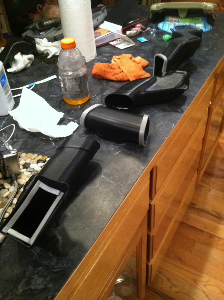

Re-doing the ducting seals because my dash hasn't been in the truck for over a year. I figure it was time to get the heat going again since it is coooold outside. I just picked up some closed cell foam with adhesive on the back from home depot. Worked pretty well. I would recommend getting a few different thicknesses. This will allow more heat to end up in coming out of the dash instead of leaking behind the dash with the old foam that is deteriorated.

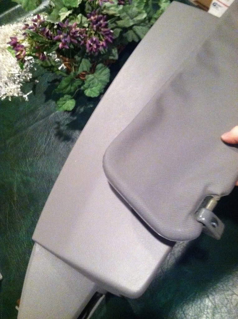

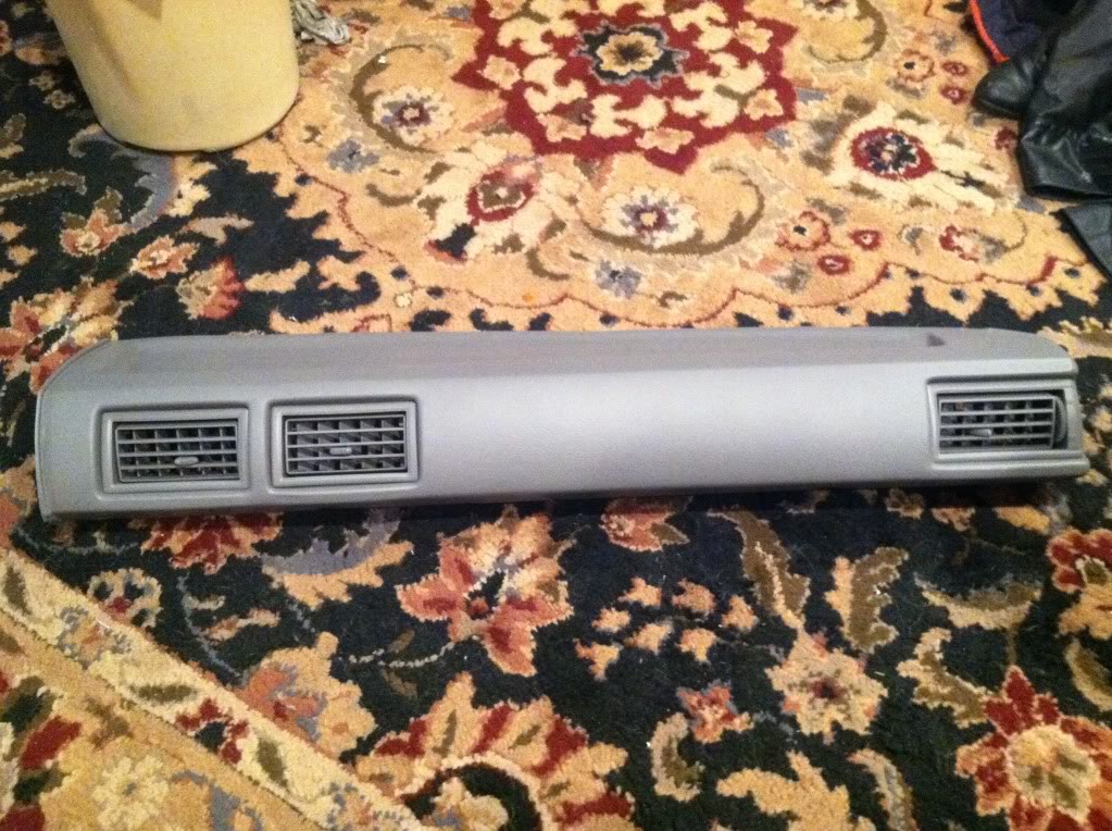

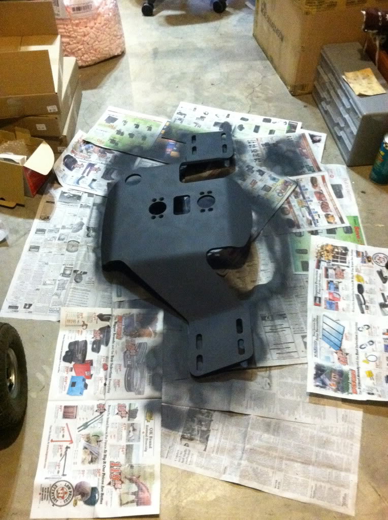

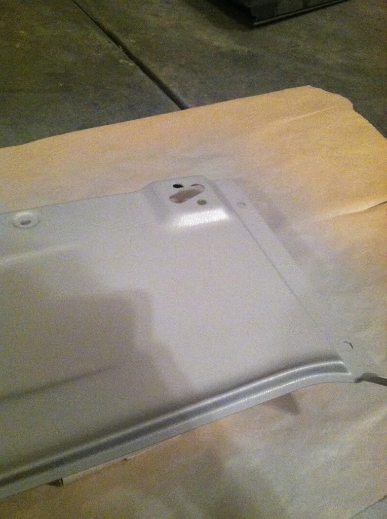

Now that the heating and dash is going back together, it only seems fitting to refresh it a bit as well.
repairs to some of the plastics:
Test run:
Gun setup and my custom holder, ha ha:
way lighter than the test piece at the store. very disappointing:
test fit:
choosing colors again.
final attempt, regardless of color. I'm not a huge fan of painting.
Much better, but still a lot lighter than what was shown on the swatch:
repaired and painted:
more to come later... I have to take off. Enjoy the photos/build and let me know if you have any questions.

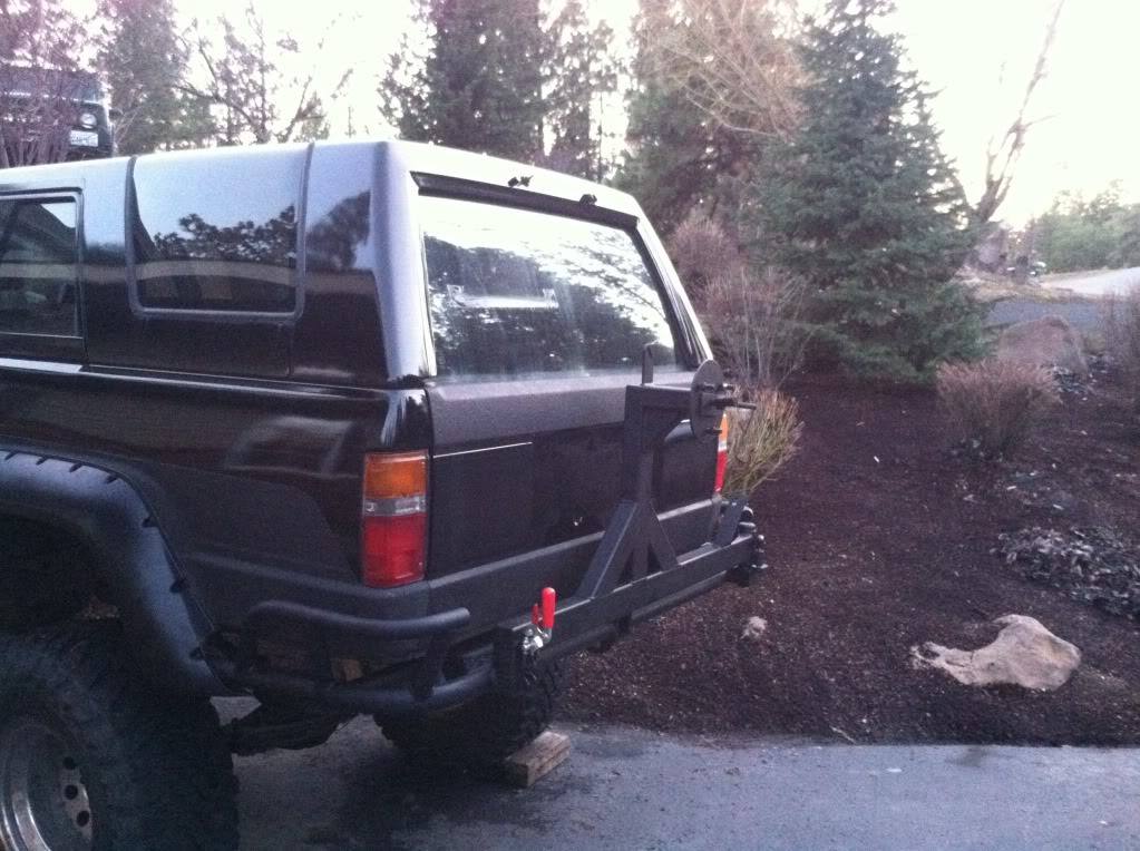

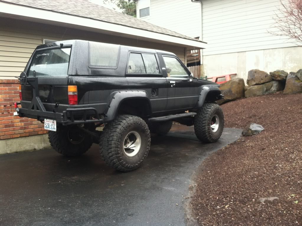

rear bumper with carrier and hi-lift holder:

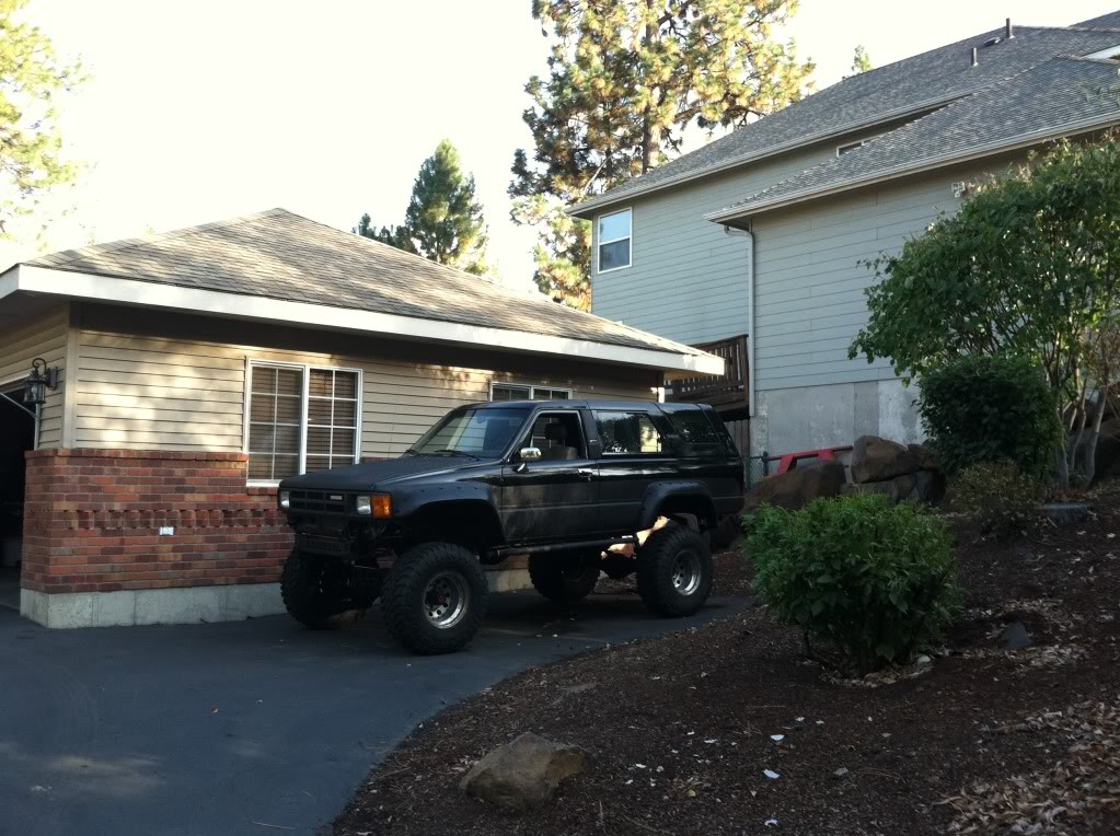

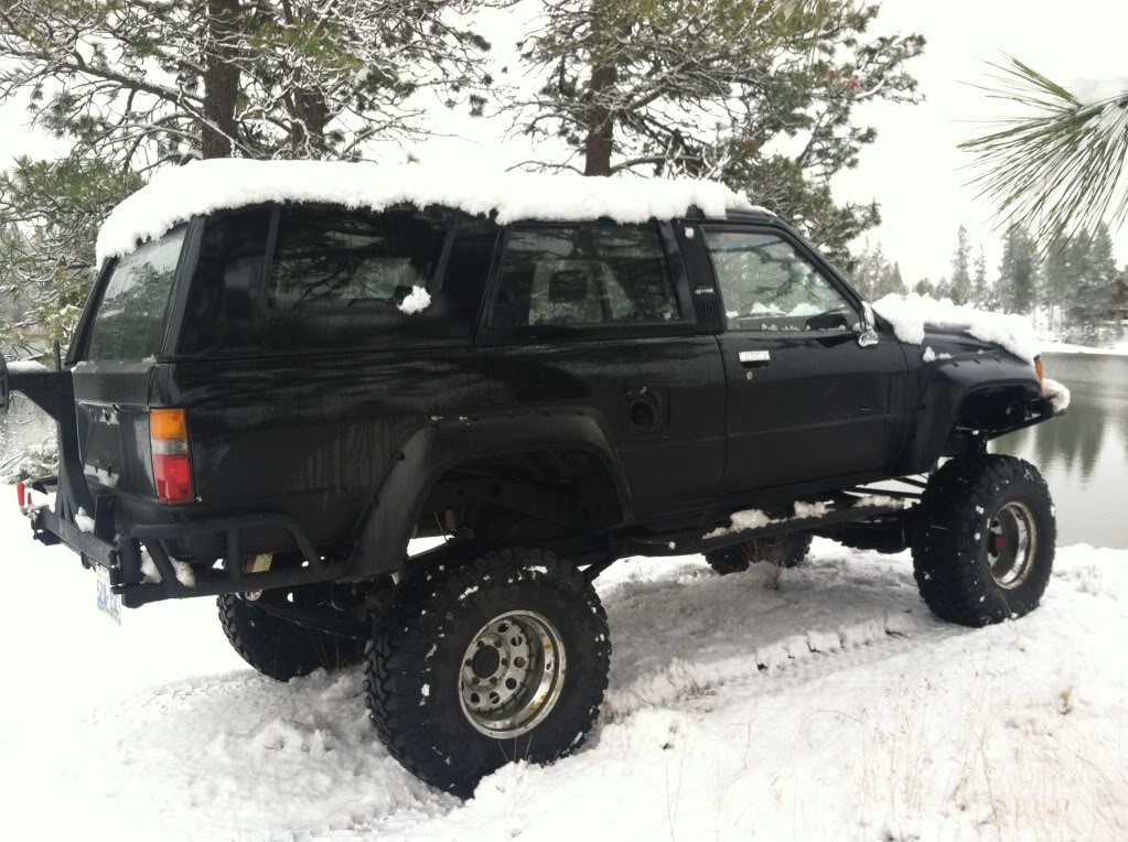

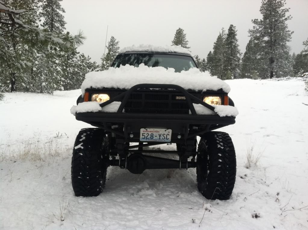

Playin around in the snow in the back country:

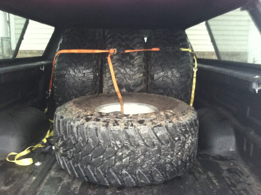

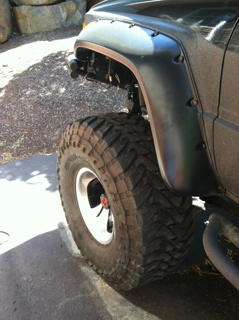

Now, why would I be taking such photos of my tires/wheels?
Because I traded them straight across for these (I had to drive an hour and a half). I would say 33's on steelies for 37x14.5x15's on aluminum wheels is a hell of a trade straight across. Worked out perfectly.

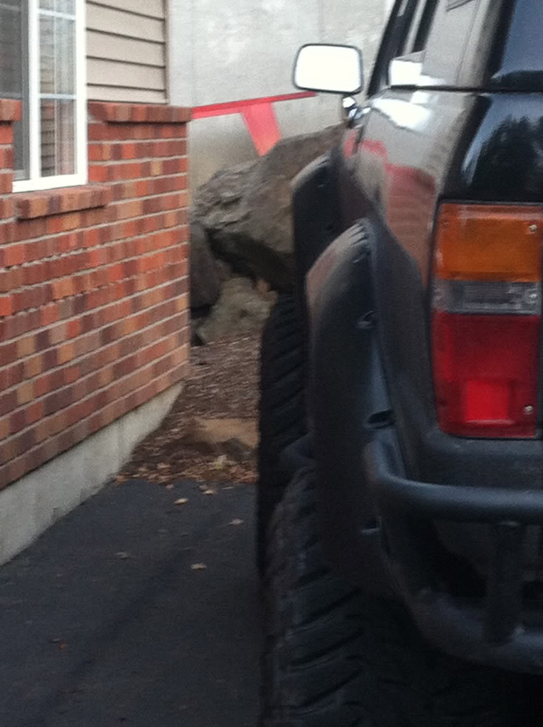

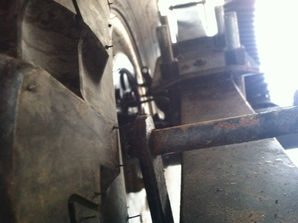

Now this is a problem. A little close for comfort. Time for some spacers:

taking time from my project to help my brother upgrade the turbo in his porsche 951:

some spacers to help with clearances:

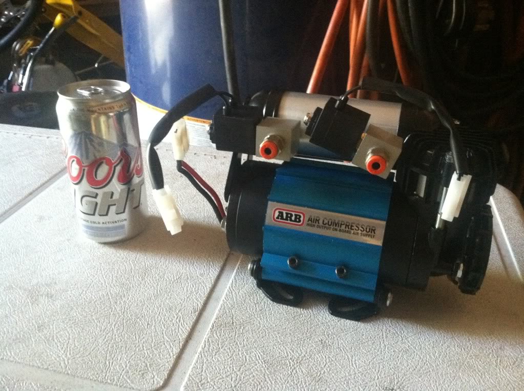

Finally, some more performance enhancing mods!!
Housing clearanced for what is to come. I have a thread that explains this well if anyone is interested. I have a 4cyl axle and am putting in a v6 third.
New 5.29's with arb's
Another pic:
Installed, fits like a glove. I would recommend getting longer studs. I did not and wish I would have. When I pull my axles again, I will likely get longer studs:

Now for some air so that they can work:
finally put the bumper to good use. No really, it makes a hell of a tool holder though:
Almost installed:
All finished:
