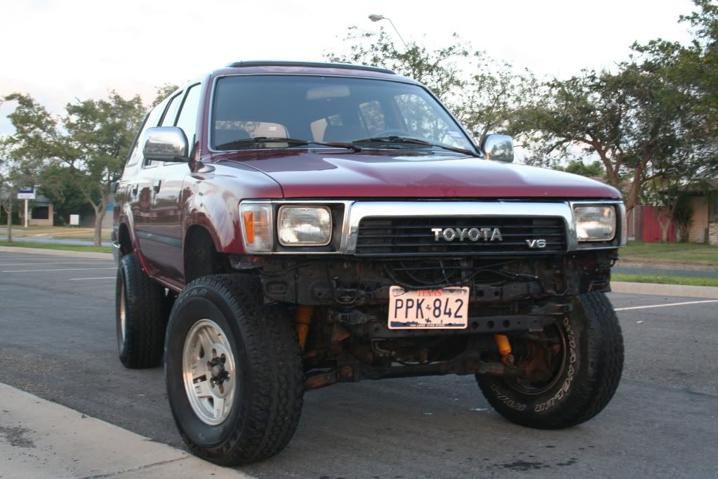

This was going to be a 1987 build but here is the story. I bought this truck off a local "Craigs List" ad.
Its a 1987 4Runner. I got it for $1800.
It also came with an 1985 4Runner for FREE! (It was running on 3cyl when i took it home!)

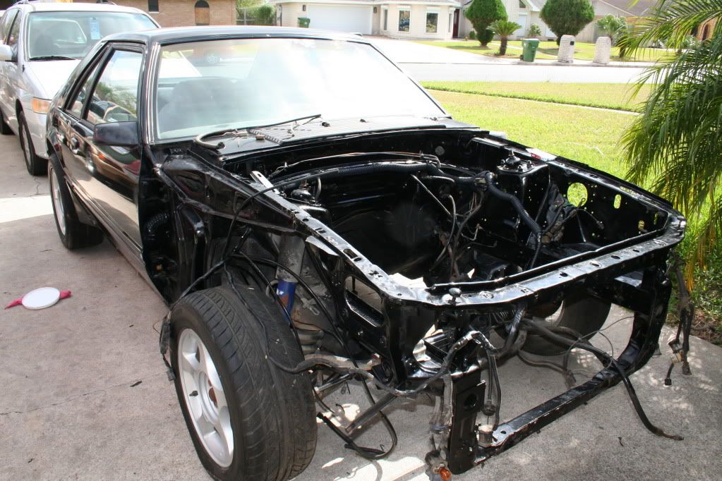

Me and my buddy drove the trucks home and he loved the 87. He wanted it. We made a deal he gave me his 1986 Mustang SVO as a trade. He bought the SVO for $1000 and he really wanted a 4x4.
This is what he gave me. I sold it a week later for $1800.
So now im sitting on a free 1985 4Runner..... What to do... Well I needed some money to start this project so I sold some stuff.
My 86 SVO gone! (I cant see myself driving a sports car anymore!)

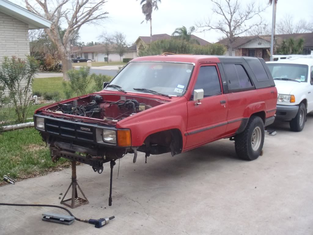

So first things first! Pulled the motor. Check out the timing chain guide!

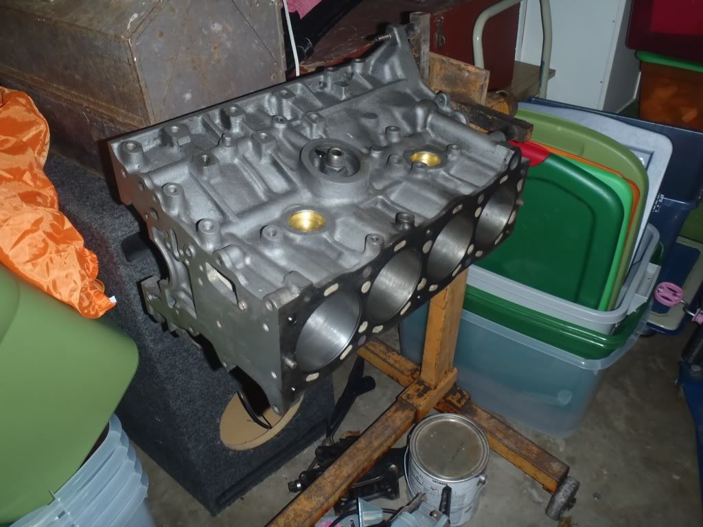

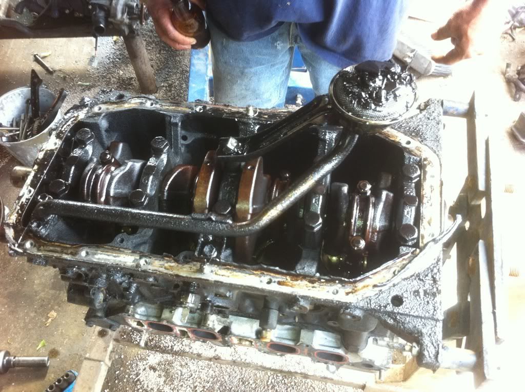

Got the motor worked on and it has been sitting in my garage for a month. Also picked up a master rebuild kit and an RV Cam from Engnbldr.
Heres the motor.
When I called Engnbldr about the kit we had some issues identifying what motor i had. Apparently I had the wrong head for the motor. I had no idea. The guy I spoke to was a book and knew all there is to know about the 22r. So it turned out that I had the 85 and up block with an older head I think he said from 82-84 I cant remember. So that explained the loss of compression and the broken timing chain guide.

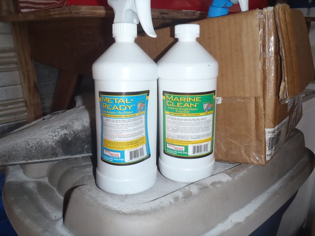

Originally Posted by Philbert
Nice bartering moves on the stang
Subscribed - looking good! Did you clean the parts with POR 15 or just paint over them with it after cleaning? What did you clean with?
1st: Gas and a brush
2nd: Media Blast
3rd: POR15 "Marine Clean"
4th: POR15 "Metal Ready" x2
5th: POR15 Paint x2

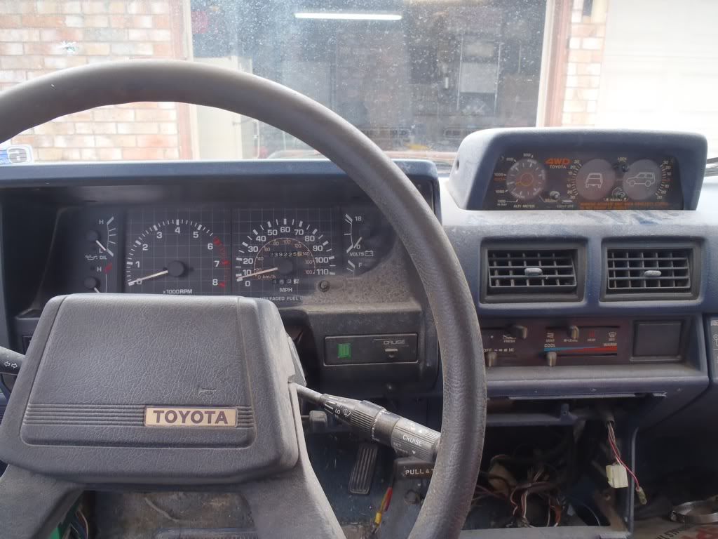

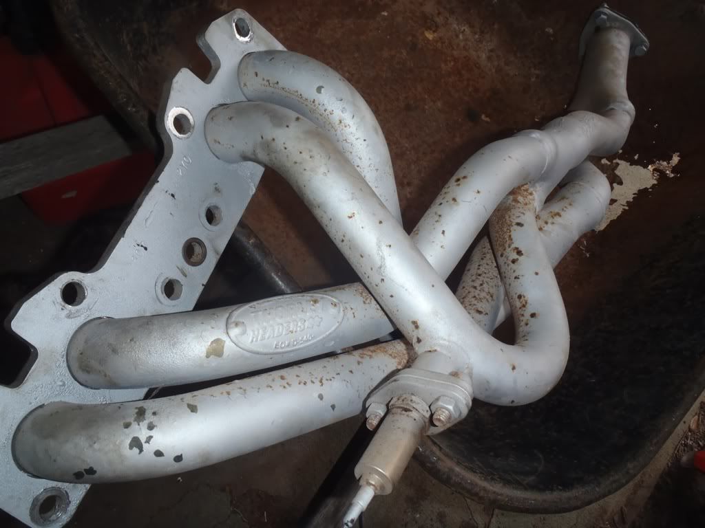

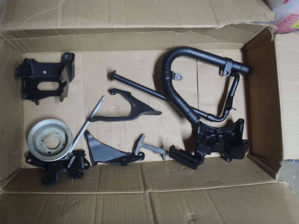

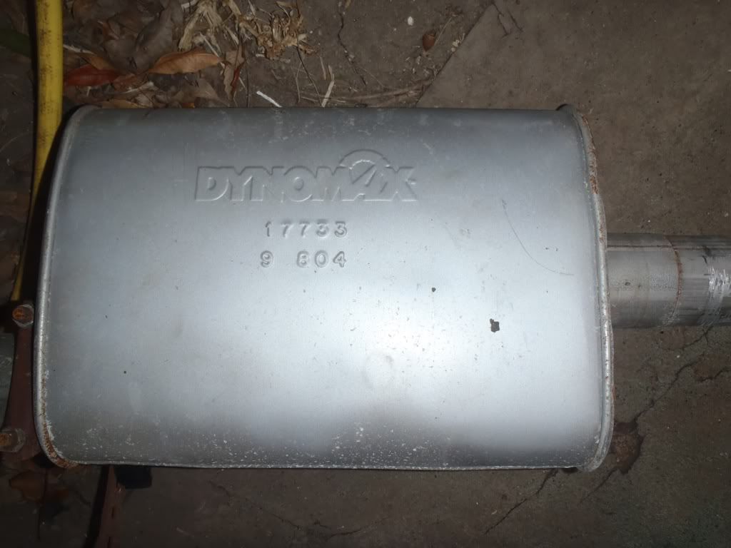

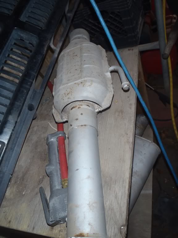

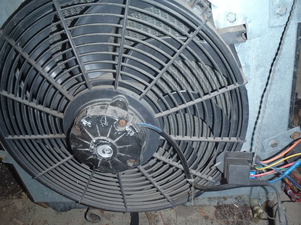

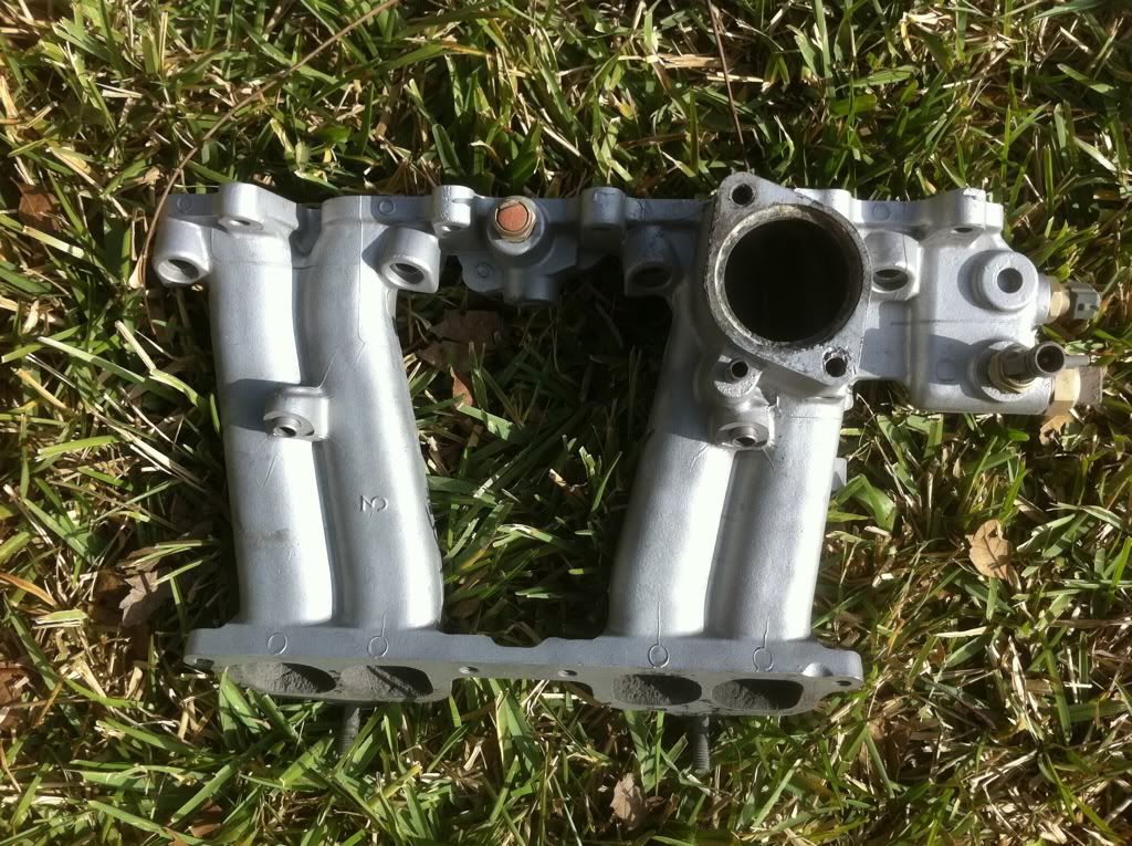

So lets see...
Standard transmission
SR5 Gauges

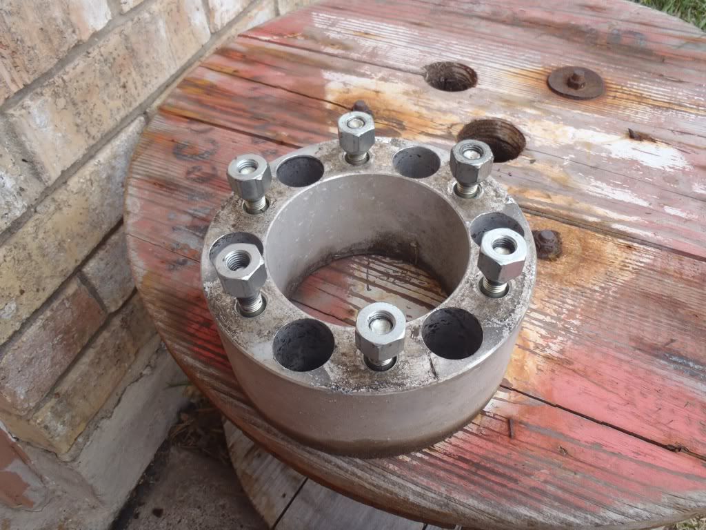

Wheel Spacers
Thorley Header
Catalytic Converter
DynoMax Muffler
Electric Fan with thermo relay

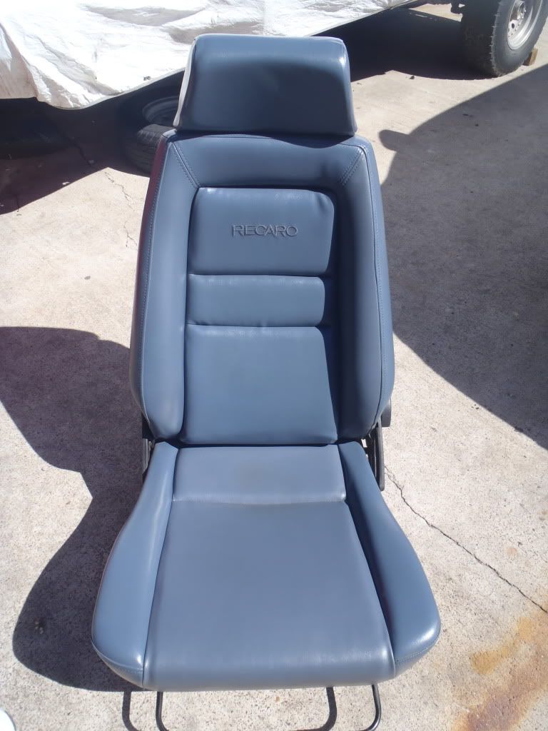

Oh and the body and interior. The interior is blue so it might match these cool seats I had laying around.

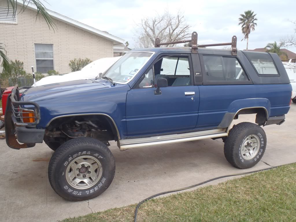

So what do you guys think about me putting this 87 body on my 85 frame?
Would it still be an 85? Is it just wrong? The 85 just has too much rust.
Your opinion is appreciated!

like the new avatar and I have seat Envy

No kidding, I wish I had some Recaros lying around.

Nice Recaros. I have some out of a 90's GTI in mine

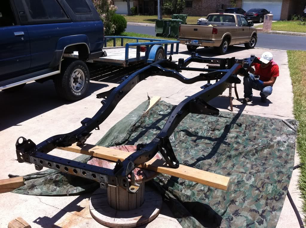

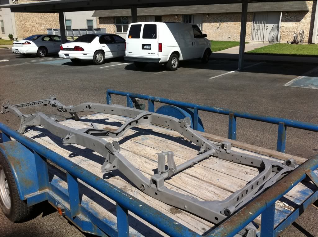

Its about time!

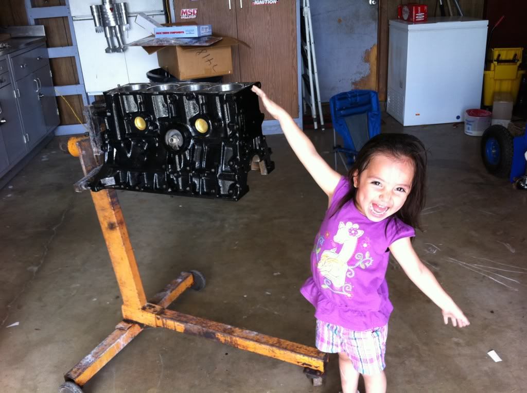

Ok Starting to get on the truck again. Here is some pics for you all to chew on.
Got her blasted for $150. Not bad.
Couple of coats of POR-15 and she looks great!
My little girl showing off the work we did on the motor.
