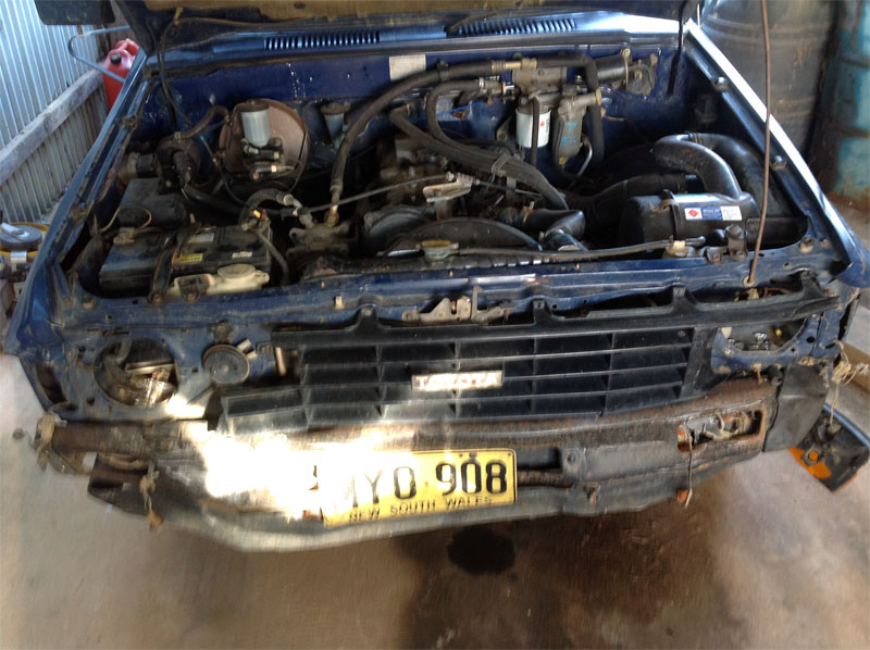

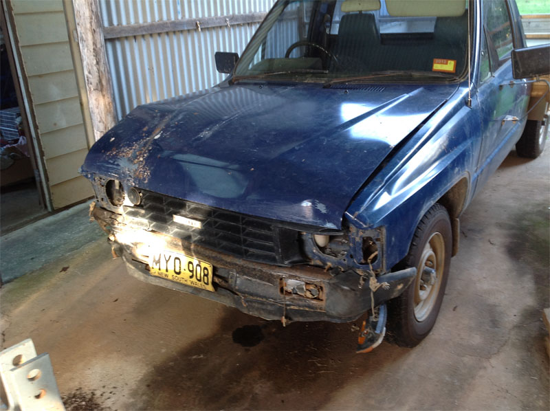

Pictures of my truck before I had it fixed..
