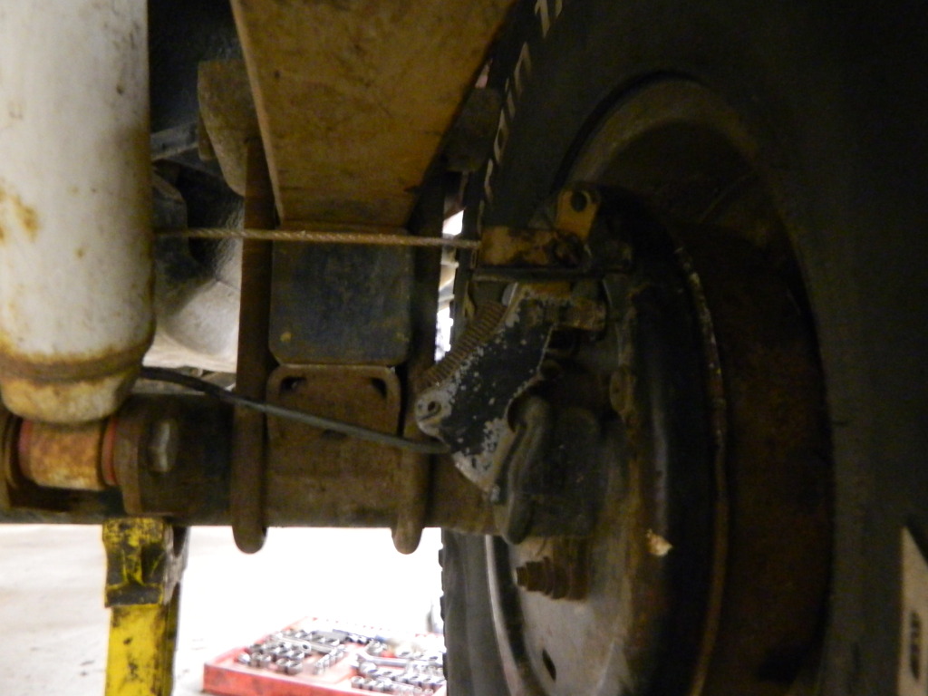

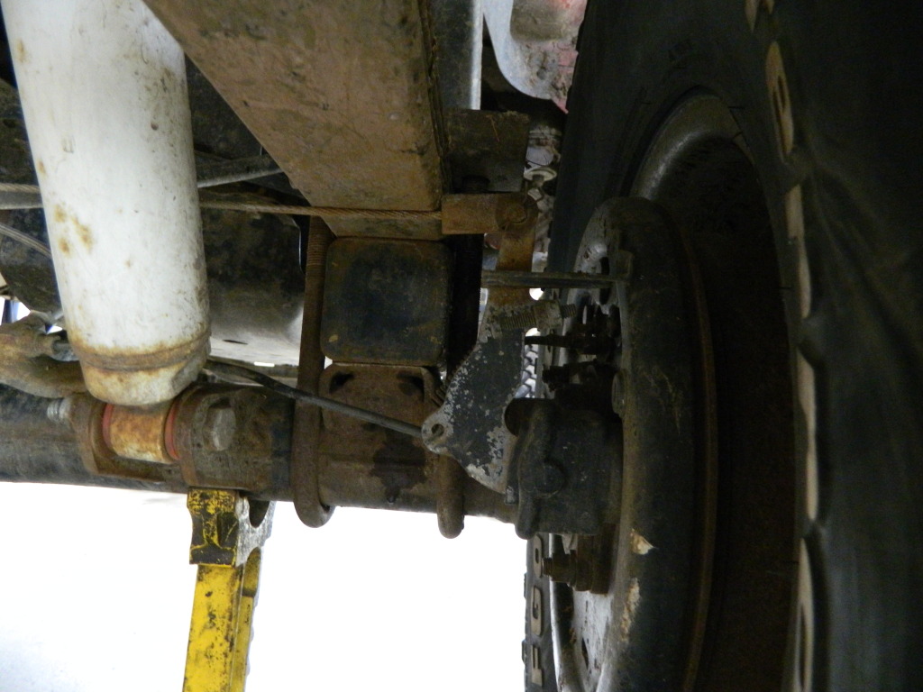

The third thing i worked on was the ebrake. It did not work at all, even though all the cables and springs appeared to function as they should. Upon closer inspection i found this stupid crapass lift blocks interfere with the ebrake mechanism.
i drilled new holes for the pins to mount that are lower and let the arm swing under the spring. Sucks because it decreases the amount of leverage you have on the brake. I am hoping to put some decent spring under it and dtich the blocks at some point, so then i can go back to the stock pivot hole. I adjusted the shoes and the brake actually works really well. Does need new brake shoes though, have to add that to my list.

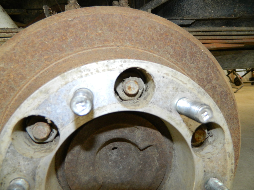

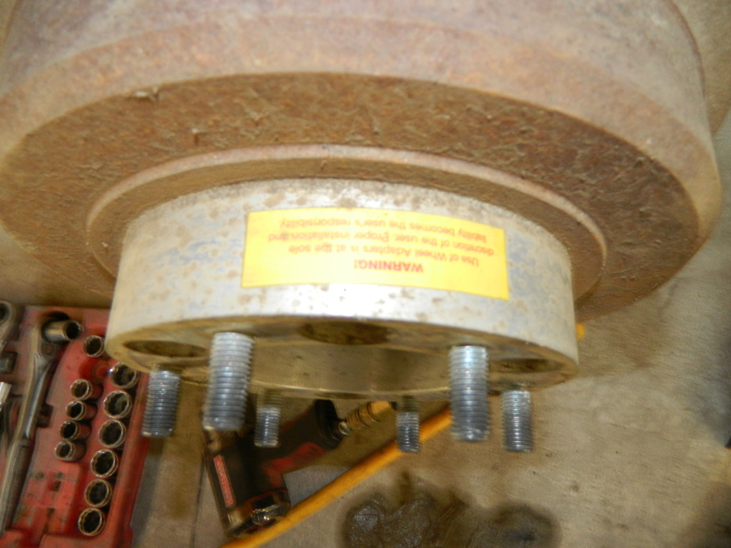

On a side note, these wheel spacers also sketch me out. The wheels have the wrong backspacing, so you need them, again hoping to ditch these fugly aluminum wheels at some point. For now I will leave the spacers and pretend the dont exist. I had to shave down a 21mm socket to fit in these tiny holes to get the spacers off.

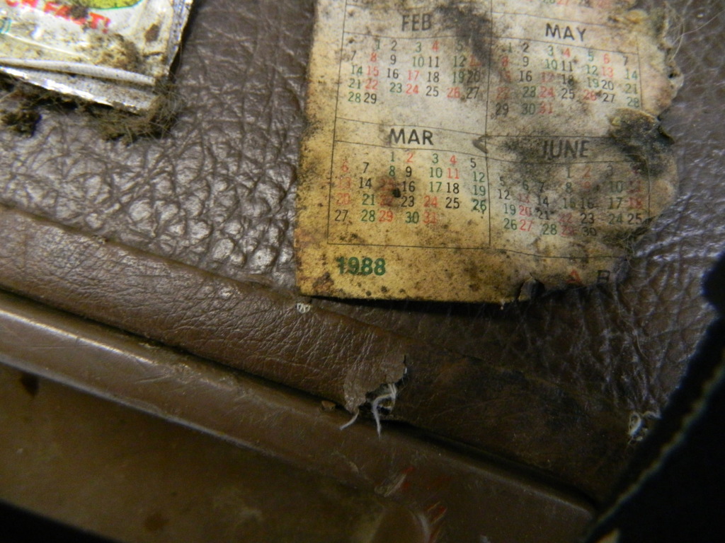

i dug around in the jack tool compartment and i found a chilton manual and the awesome 1000page toyota service manual. Score. The chilton sort of sucks, but the yota service manual is sweet. Nice thing to have around I suppose. I also found this Berkley California Volunteer firefighters 1988 pocket calender, and some weird 25year old ointment.

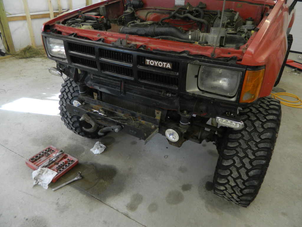

Posts: 49

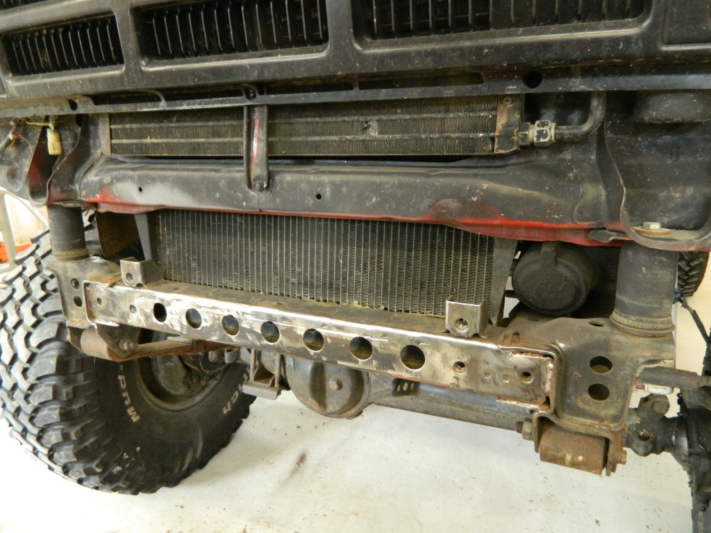

yea man, i am really excited to see it all decked out. It looks real goofy right now with a bunch of autozone fog lights and some very nasty looking winch mount. I started hacking the old winch mount off last night, what a pita, its welded onto the front crossmember all the way across and no way to get a grinder in there. Had to cut all the weld along the bottom and smash it with a BFH to get to the top welds. Out with the old, in with the new!

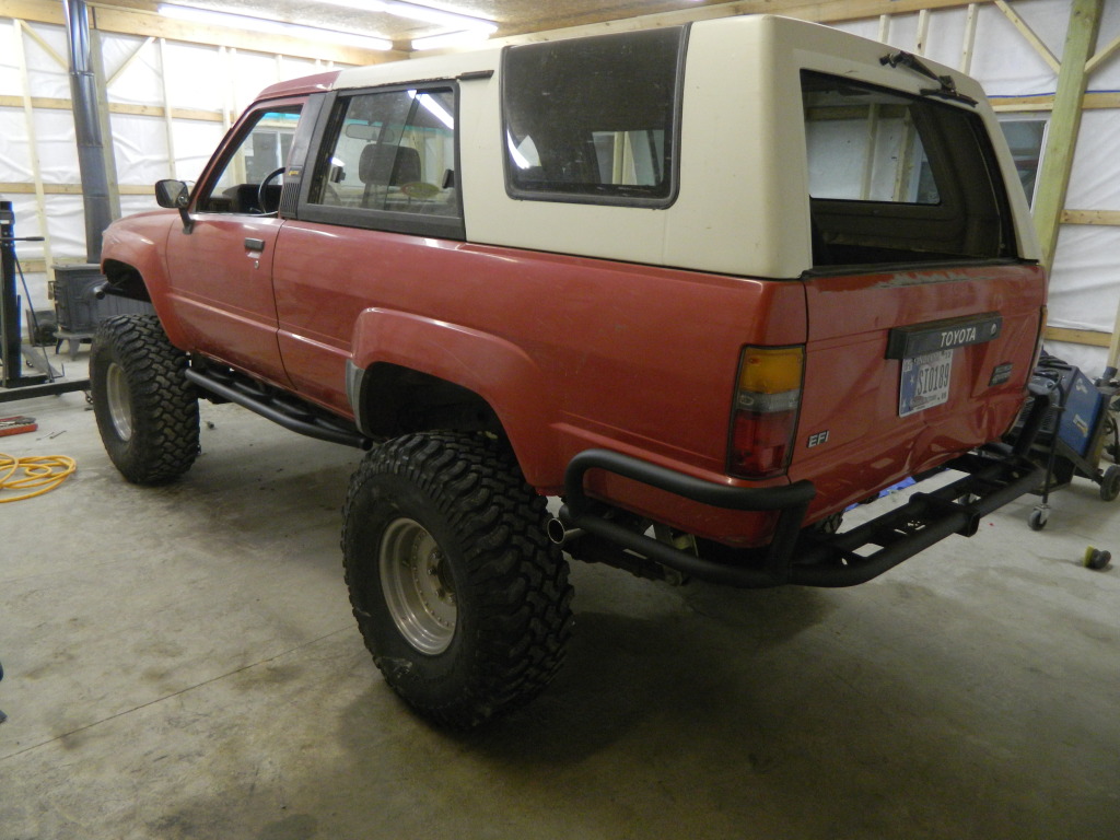

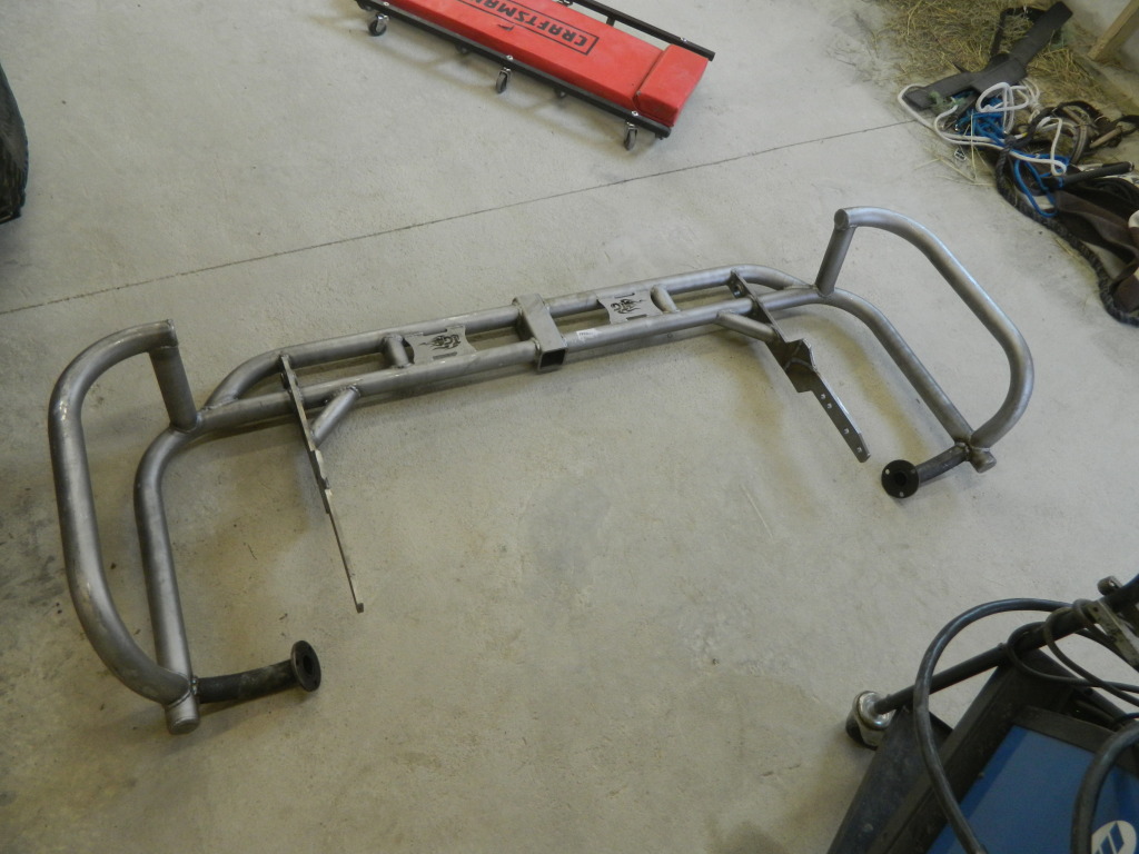

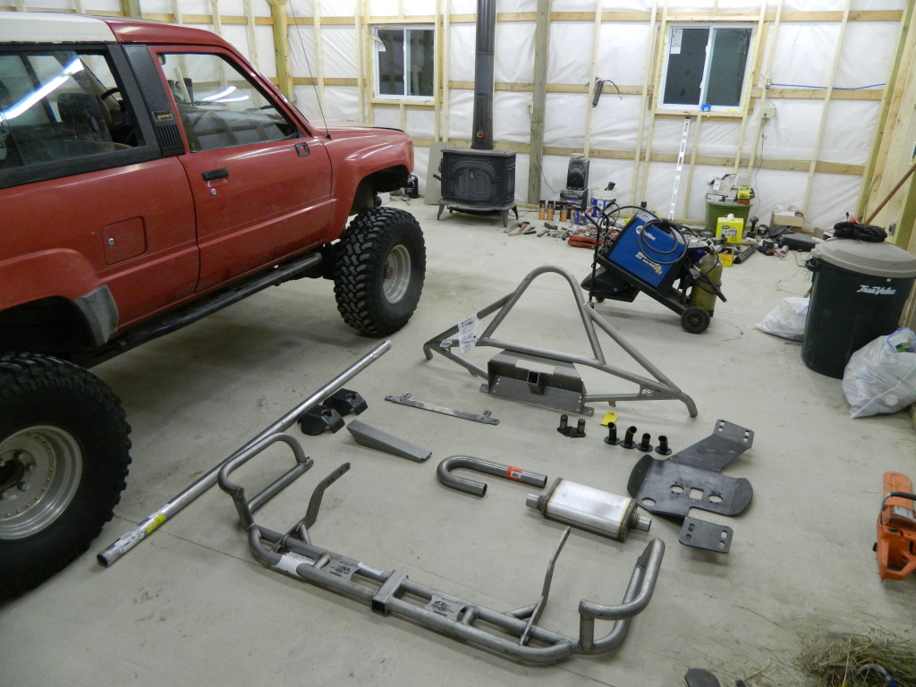

got some time to work on the runner.

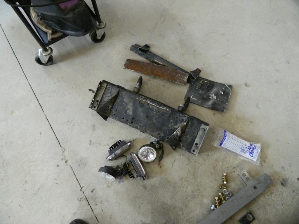

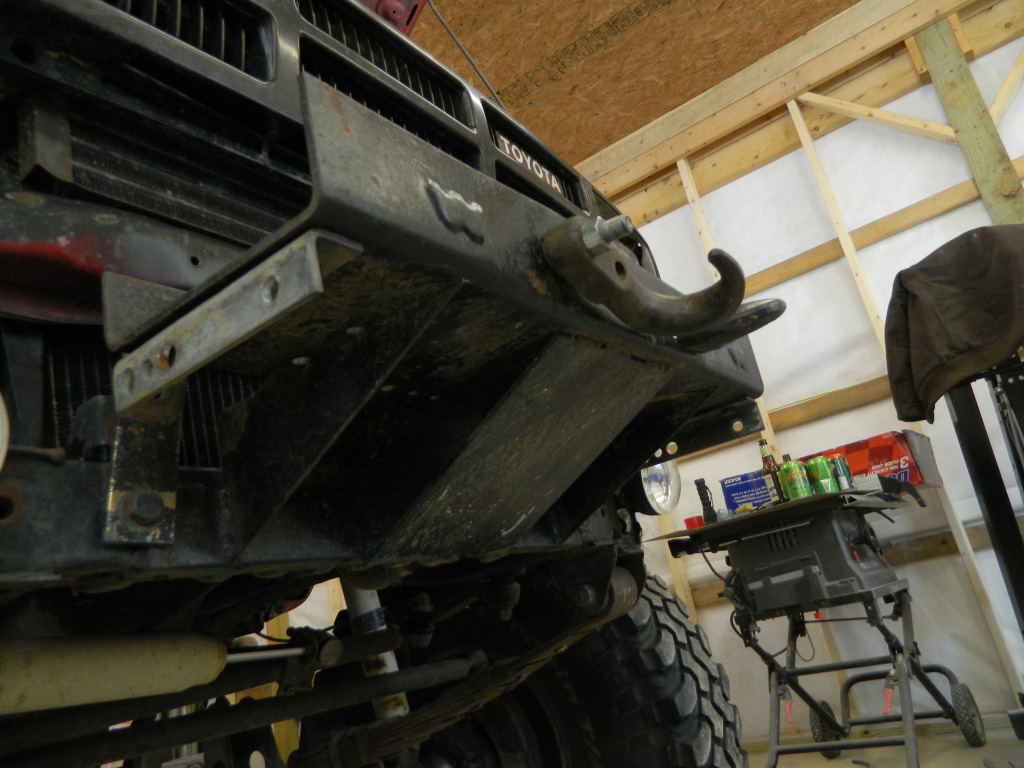

Started off removing this ugly shatty winch mount that came on the truck

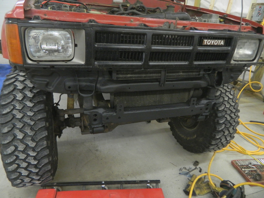

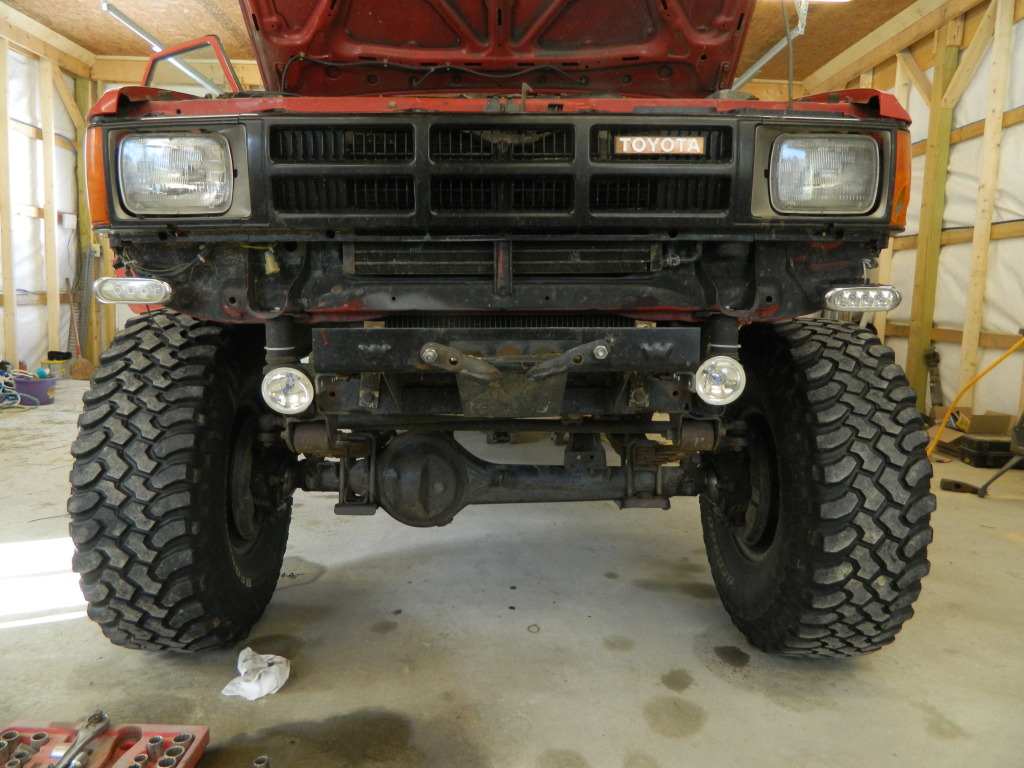

crap winch mount and autozone fog lights removed

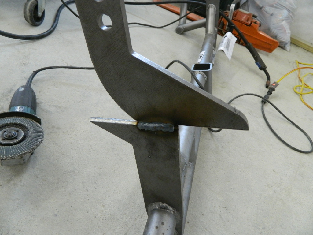

removed and old welds ground down

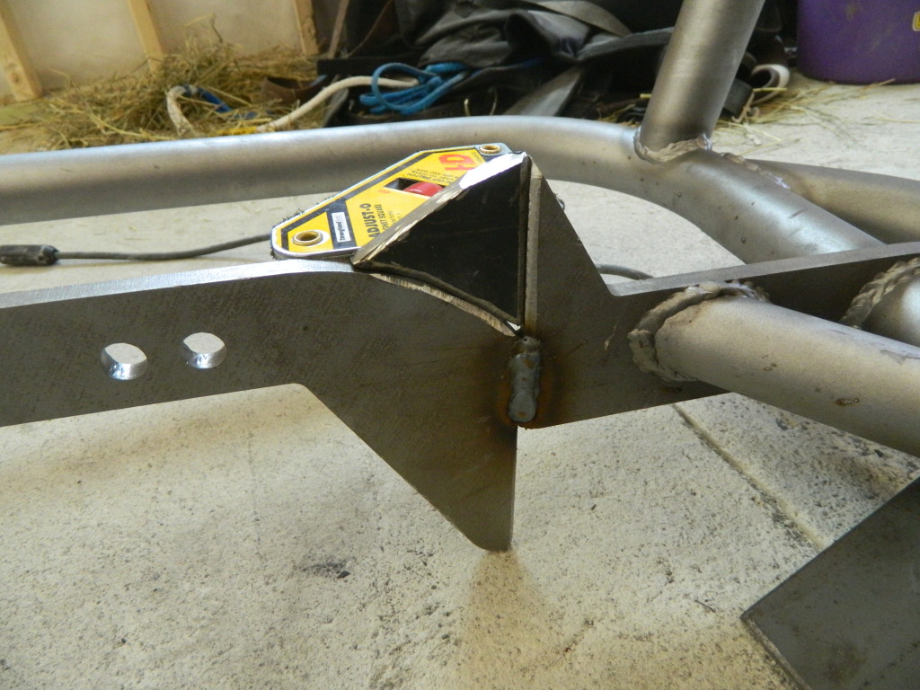

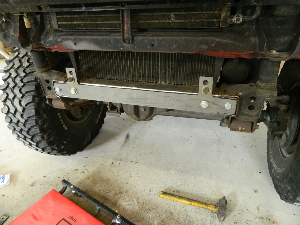

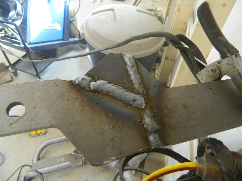

frame brace ready for welding
welded on and coated

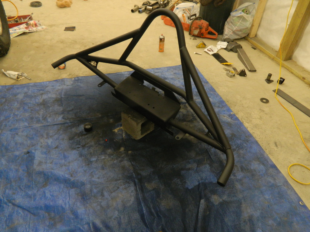

had to cut the brackets off the bumper and lowered them 3" so the bumper sits where it should with the crap body lift

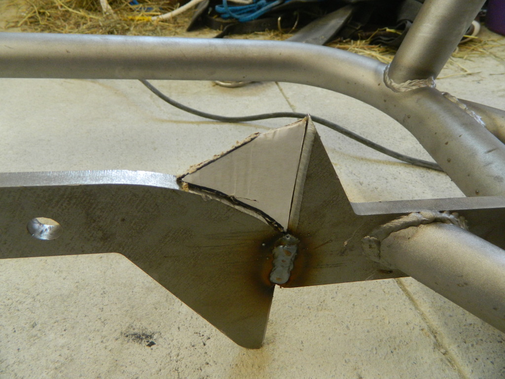

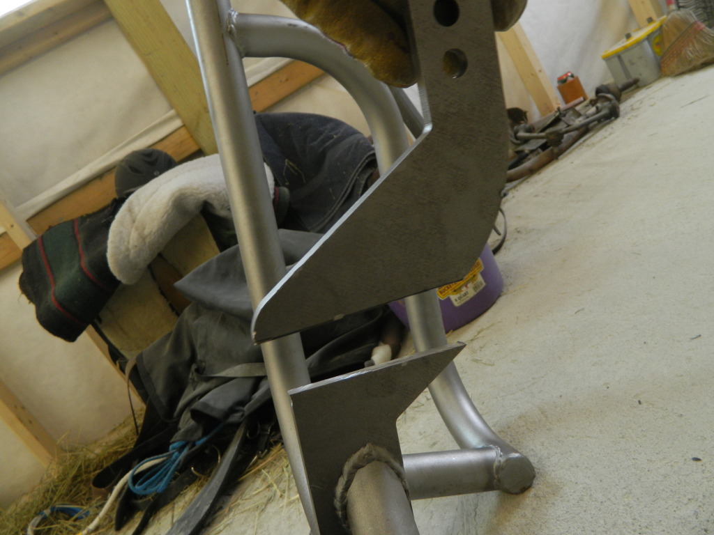

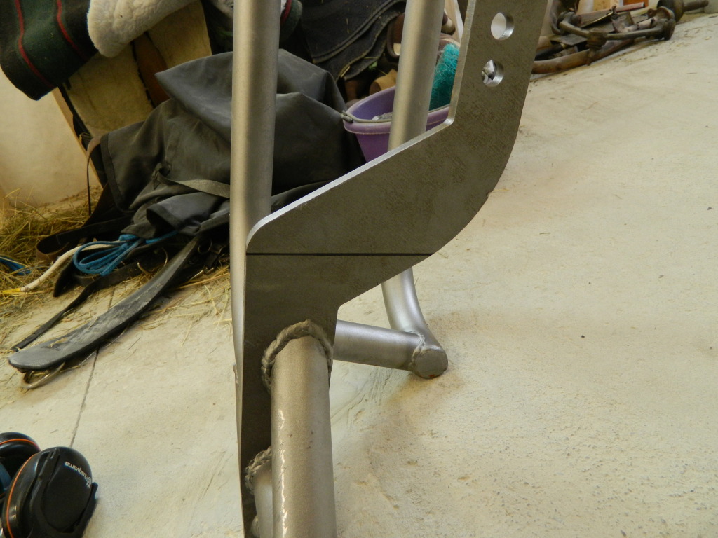

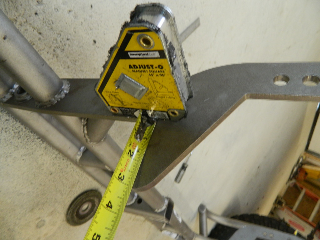

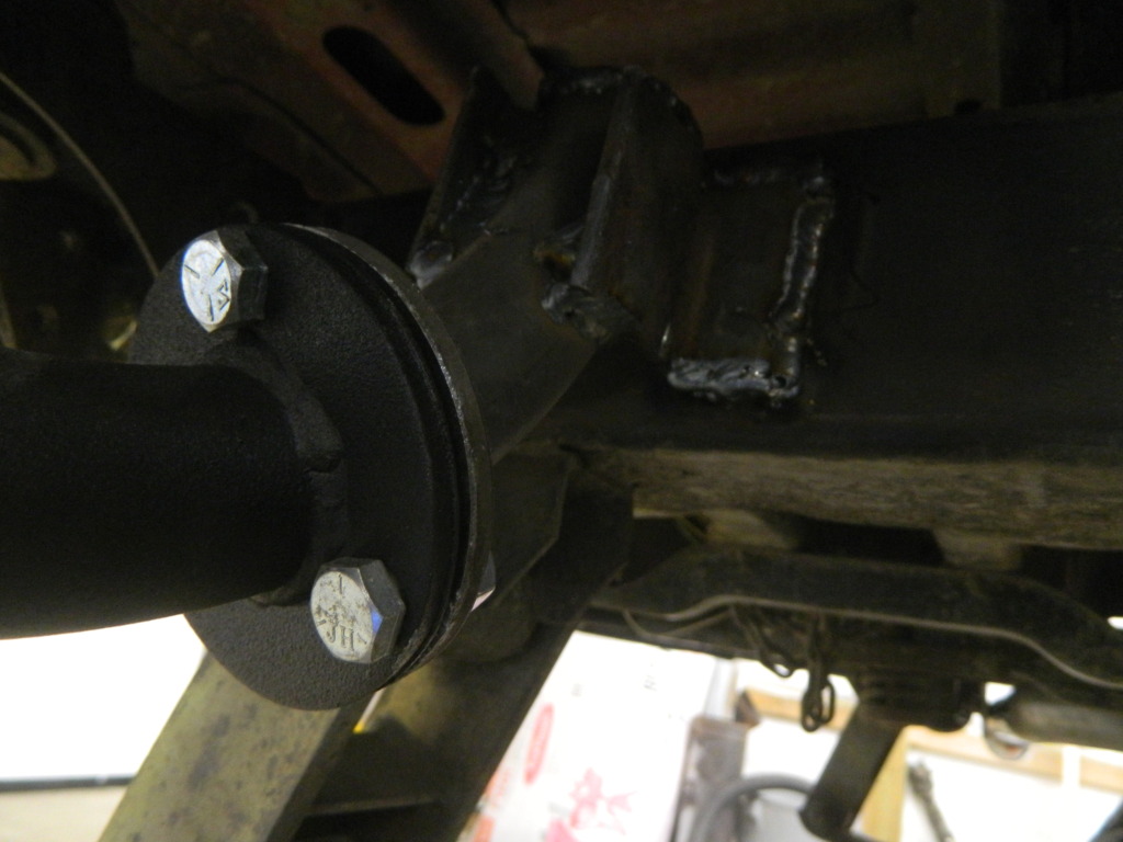

of course the frame braces dont fit as they should with the body lift, so here is my ugly solution

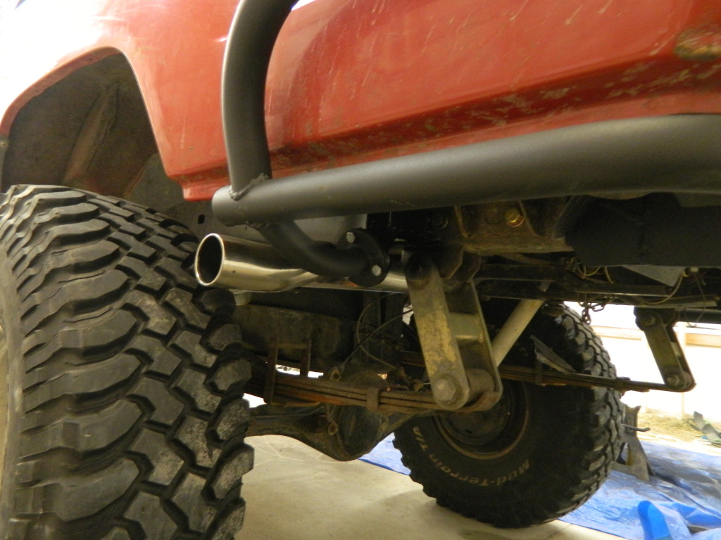

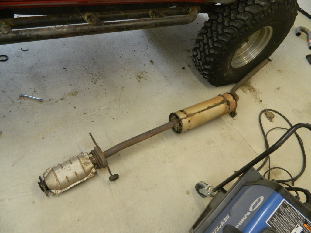

the exhaust had about 100 leaks in it

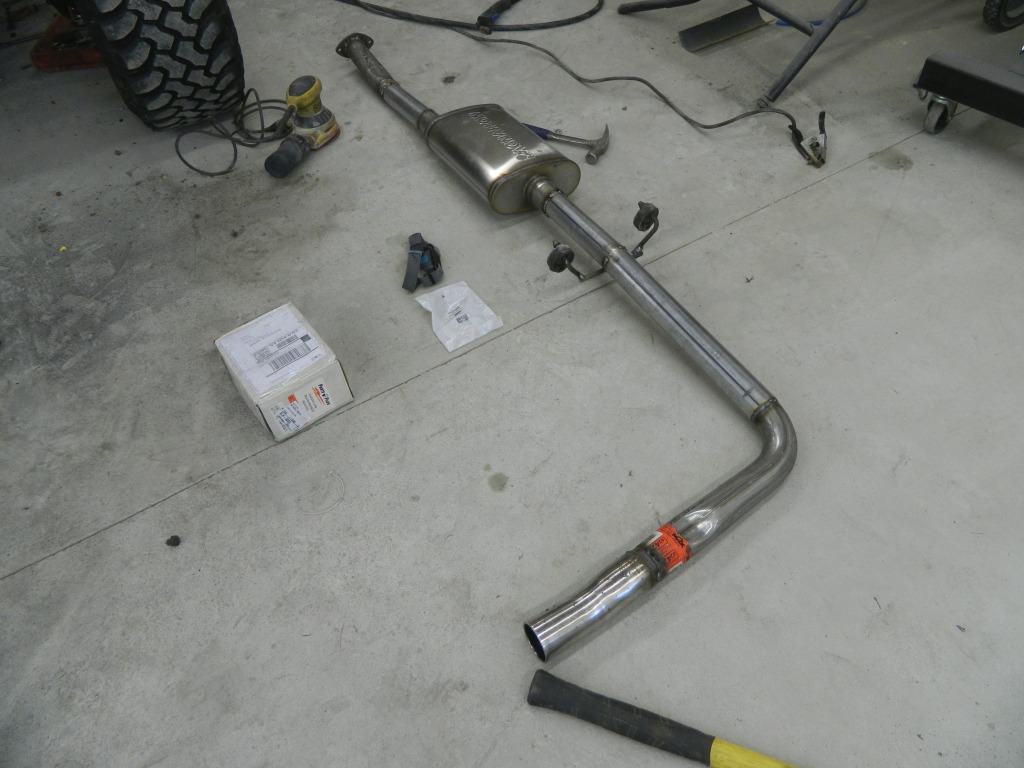

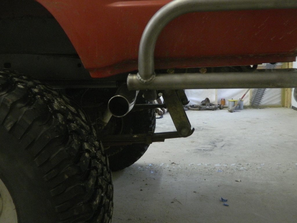

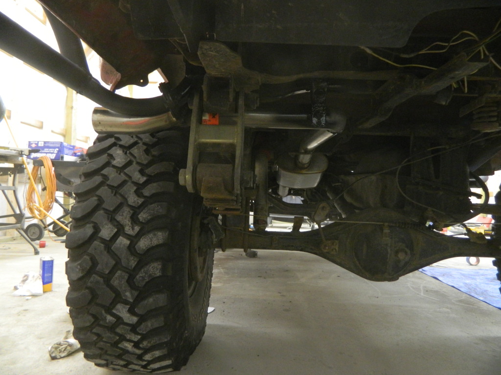

new exhaust
the tip is from a taurus SHO that I have had kicking around for the last 10 years

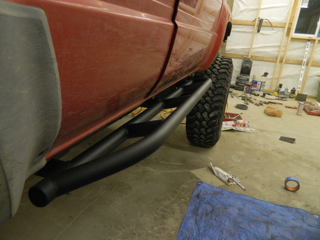

refinished sliders
coated front bumper

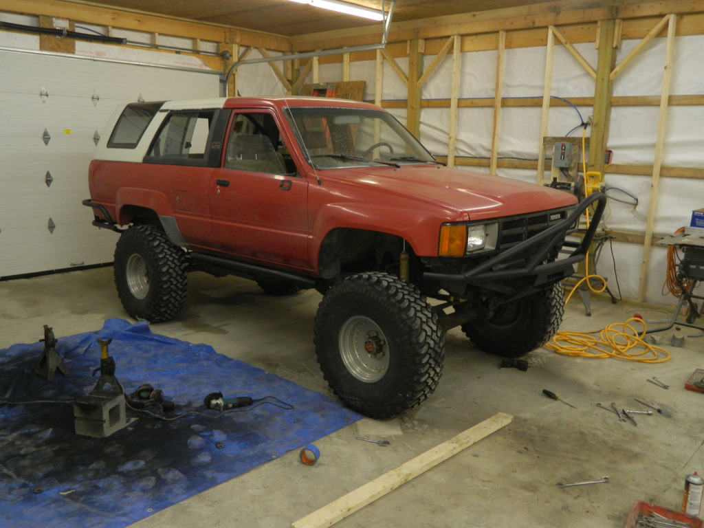

and thats as far as i got this weekend
