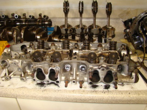

I have been trying to stab in the auto tranny but it was a total PITA so I decided to tear down the spare 22re. It spun a rod bearing on the #3 rod so I am doing a rebuild. I ordered Keith Black pistons and rings today from Summit Racing. I also ordered a new cam, seal kit and timing kit from engnbldr. I will drop the block, crank and head off at the machine shop sat morning. On monday I picked up the front bumper from Addicted Offroad. I have included some photos of the motor and tear down.

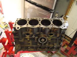

Rebuild Underway
Dropped off the block at the machine shop. Went down to G&S Machine shop in Littleton Co and they quoted me $425 to bore the block, hot dip, regrind the crank and polish, hang the new pistons (Keith Black 92.75mm) on the current rods as well as resize the rod ends because the #3 rod spun a bearing aswell as supply bottom end bearings to proper specs for the new machine work. I will need to bolt it all together and check for proper tolerance's. I was going to use plasta gauge. What would be best? Is that a good price? I hope so cause I pulled the trigger.

Today was a good day. I spent about 8 hours on reassembly of the rebuilt motor. Im a week and a half behind where I wanted to be. First Summit Racing sent me one piston that was .5mm over sized when the other 3 were .75mm over sized so I had to send all 4 back and wait for new ones. Then while I was compressing the rings on the piston I broke a freakin ring. So I had to get another ring. I have the motor all put together with the head on it, freshly painted oil pan. I am using a parts washer from Harbor freight to clean every bolt that goes back on this rig. I am so tired of the 25 year old grim and grit built up on everything. Anyway I realy hope that I dont screw things up. Not only am I rebuilding the motor Im swaping in an auto tranny as well as the wire harness and stuff to make it work. My entire 2 car garage is filled with toyota parts, every where I look I feel like Im seeing double cause I have 2 of almost every part. Here are the pics of my progress.
