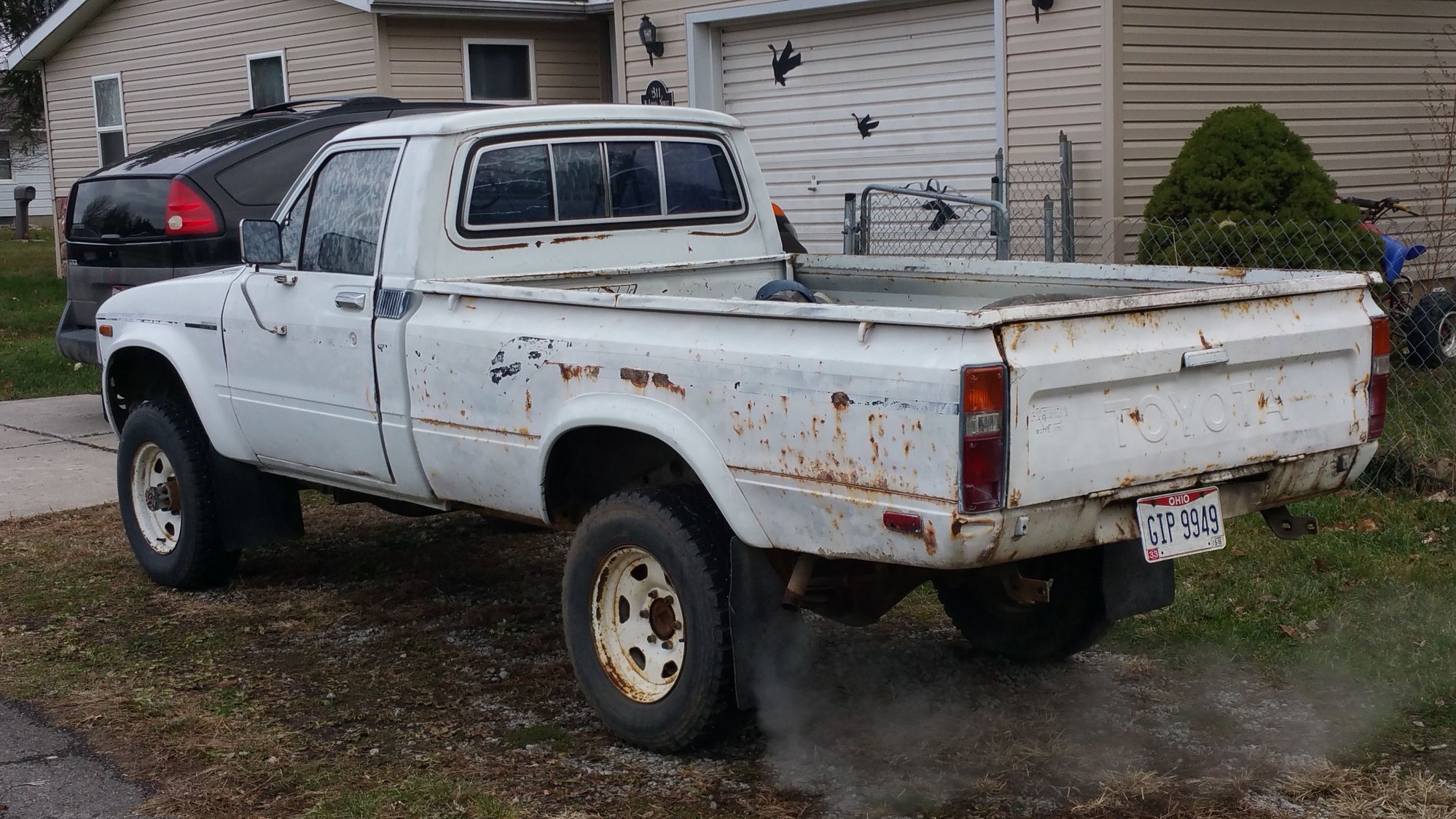

Not much has changed on my truck since I got it about a year ago. I've done some maintenance fixed a couple things, and not much else.
It still has a slight rod knock, but it's drivable as it is at least.

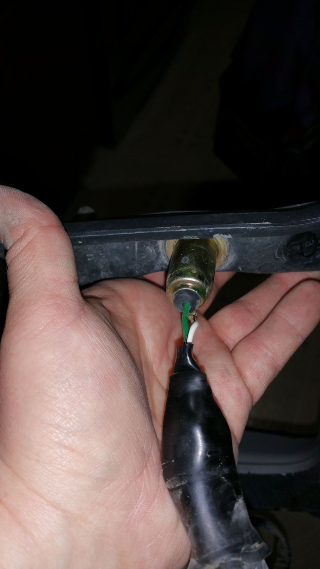

I relocated the turn signals to the marker lights today.

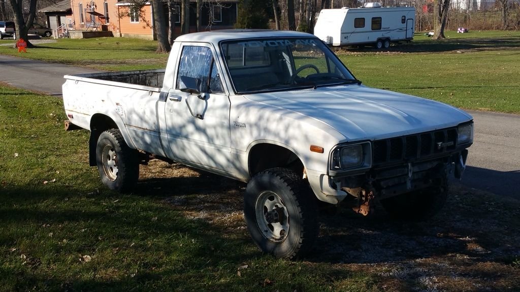

Took a current picture today, bumper installed without signals, and removed the rusted out broken rear bumper.

For anyone interested these are what I used for my signal relocations
http://www.napaonline.com/Catalog/Ca...576_0460685181
You just remove the guts of your marker light and install these in the stock marker bulb housing. You have to modify the 1157 bulbs with a file a little bit, because the nubs on the bulb that lock them into the socket are offset instead of equal like the marker bulbs.
