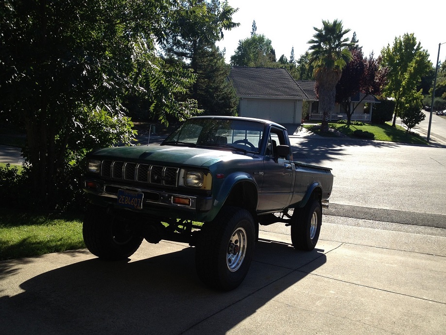

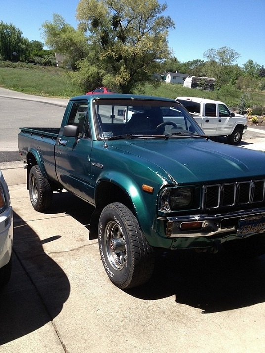

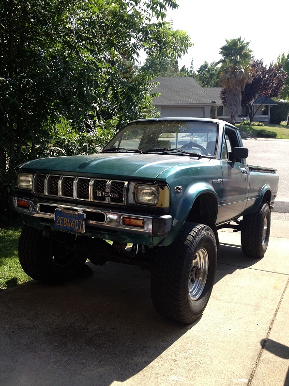

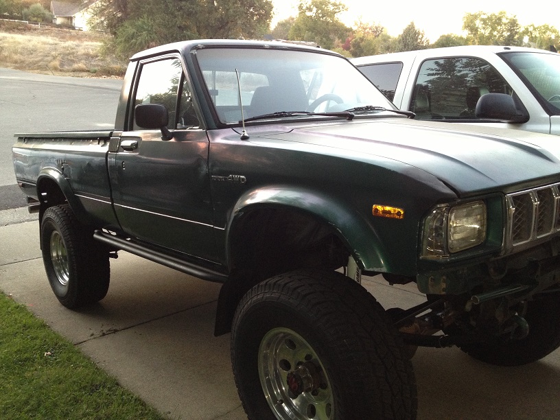

Last winter I was snow wheeling my FJ40 in some really crappy snow. I had been winching all night long just to get a couple miles or so up the road, every time I would break through the crust and get stuck these little Toyota trucks would just keep rolling by! At the end of the weekend I couldn't help but think, why don't I have one of these for these types of trips? Something I could just jump in and drive up to the trail, snow, whatever? And they seem to work really well.
I have always had a thing for the 1st generations, don't really care much for the rest. So I started looking for a decent stock long bed to start with. It had to be a long bed for the wheelbase and also for the cool looks of a long bed. So I found this stock ugly as hell POS! It ran, so I paid the guy $1500.

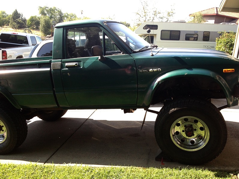

Next I put on a junky 4 inch Trail Master suspension, this I knew was temporarily, but since I had it for almost nothing I thought I would have the lift amount I wanted and could figure out tire size and cross over steering set up.

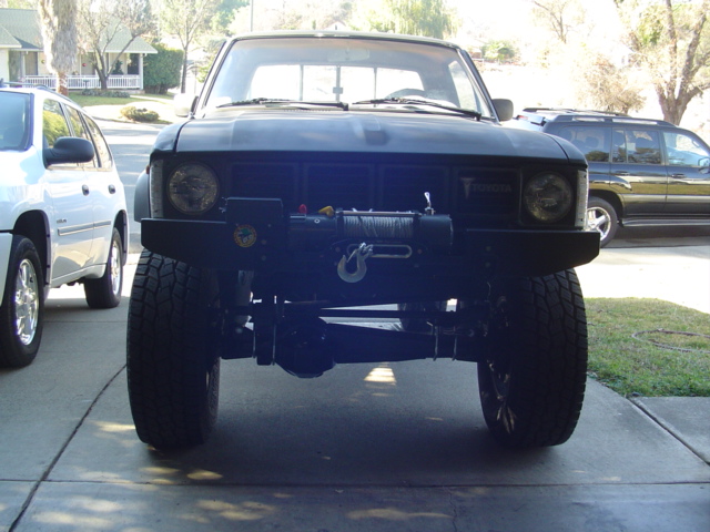

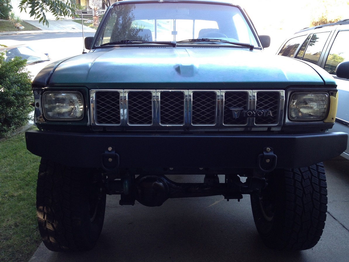

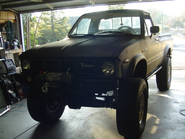

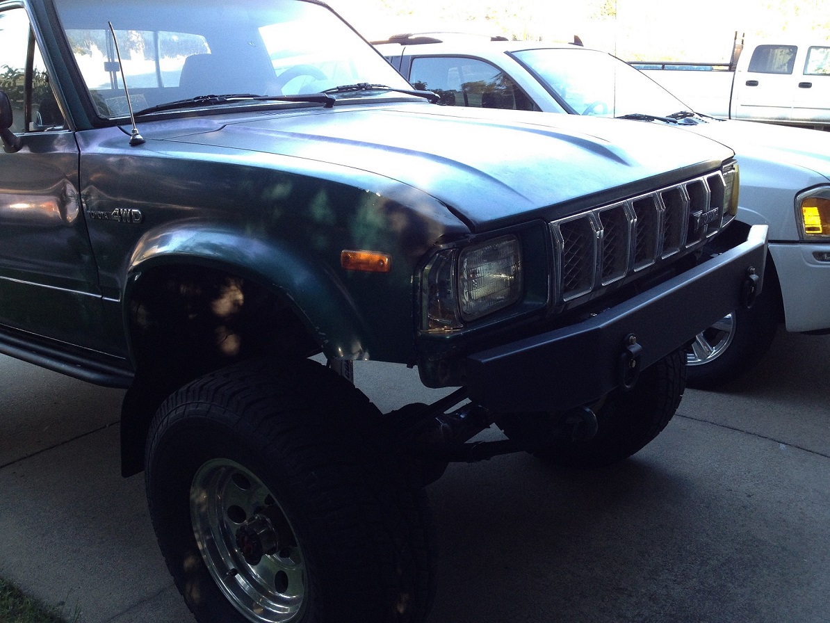

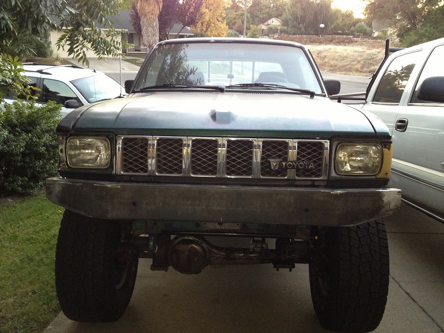

Front bumper.
Attached Thumbnails A simple To & Thru 83-img_0661.jpg   A simple To & Thru 83-img_0663.jpg   A simple To & Thru 83-img_0664.jpg
Old Feb 16, 2014 | 12:01 PM
Taco98's Avatar
Joined: May 2013
Posts: 175
Nice bumper. Plan and simple. What size did you use. Is it just one solid piece and you cut out the angle to bend the ends in.
Old Feb 16, 2014 | 03:40 PM
dog walker's Avatar
Joined: Apr 2013
Posts: 65
It's 2x6 x .188, yeah just cut and bent. I have allot more pictures, but it seems I'm at my quota of 10 mb? Does this mean that I cannot post anymore pictures to this thread?

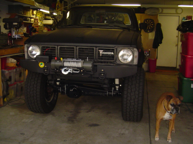

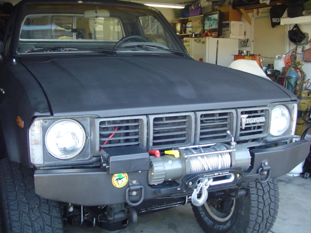

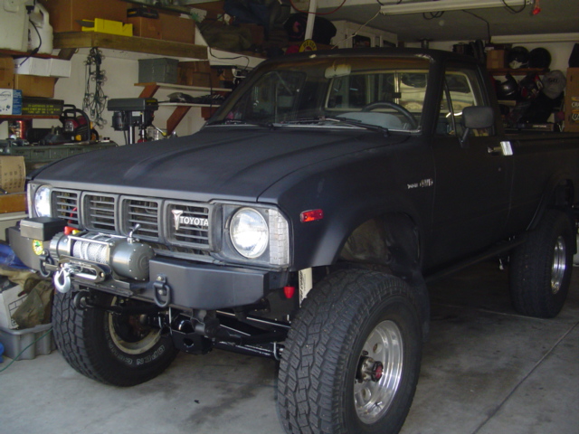

Here's how I ended up finishing the bumper. Also Did a cross over/ high steer set up, and a round headlight conversion.

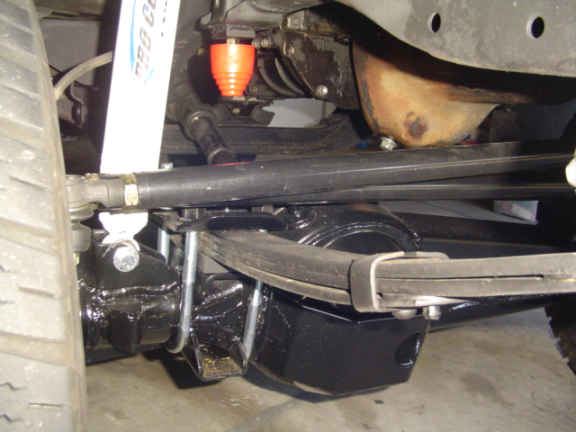

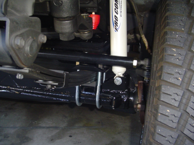

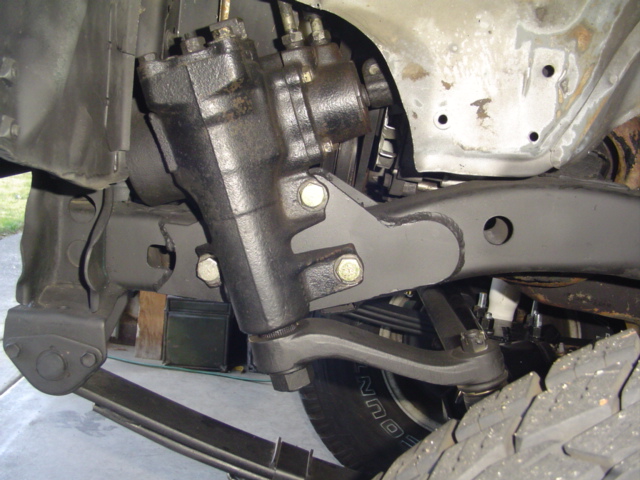

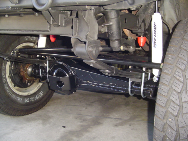

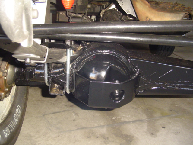

Hi steer, axle gussets, new shock mounts, cut & turned knuckles.

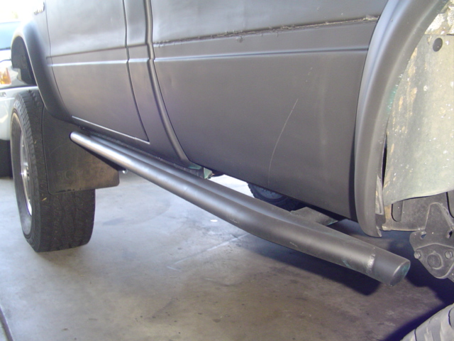

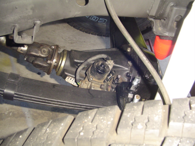

Sliders, E-locker.

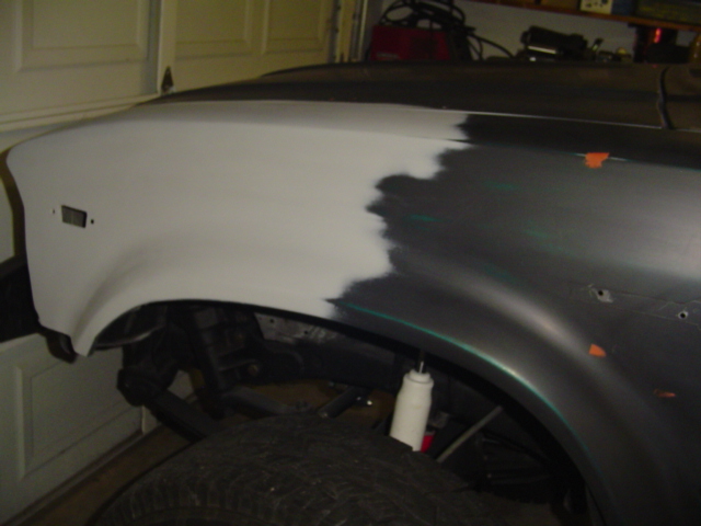

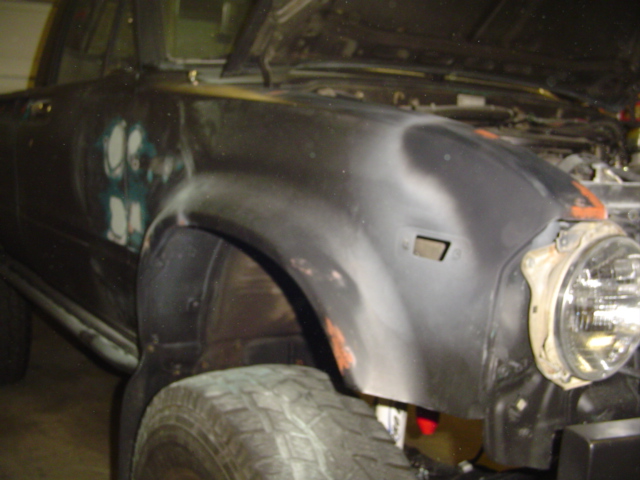

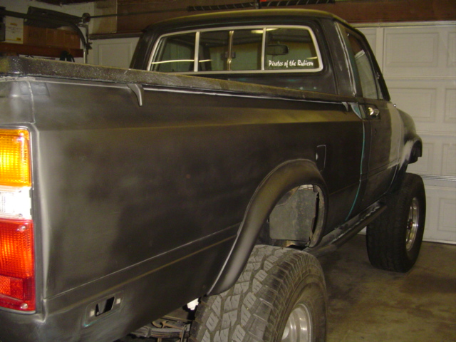

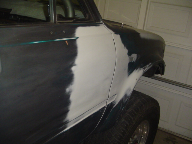

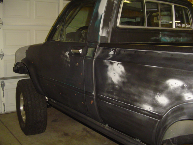

Now that I have most of the mechanicals under control its time to tackle the body & paint. At this point I've already wet sanded the entire truck and primered it black. Now I'm doing minimal body work and prepping for paint.
Remember, this is a To & Thru build. Meaning, It will be driven to the trail, and back, no trailer.
Attached Thumbnails A simple To & Thru 83-2-20-2014-008.jpg   A simple To & Thru 83-2-20-2014-007.jpg   A simple To & Thru 83-2-20-2014-005.jpg

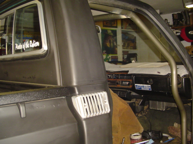

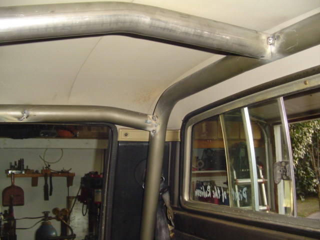

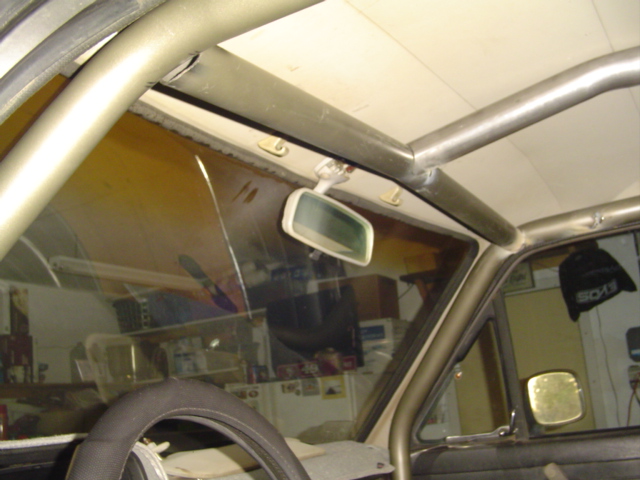

Next I installed a 4xInnovations interior cage.

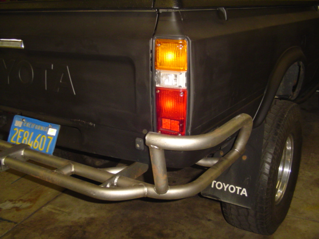

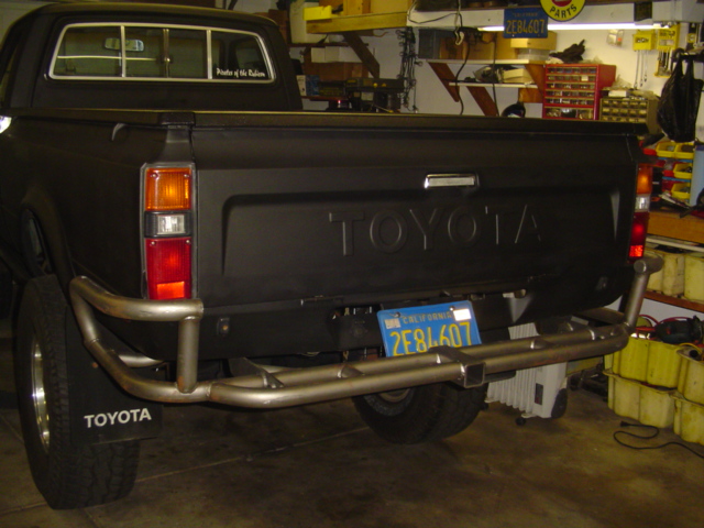

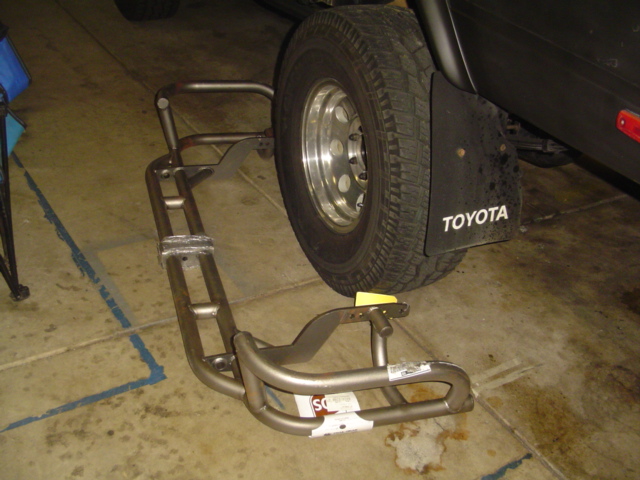

Trail Gear rear bumper. Required a bit of fabricating to fit. I'll post pics of mods needed if requested. Otherwise pretty basic.
