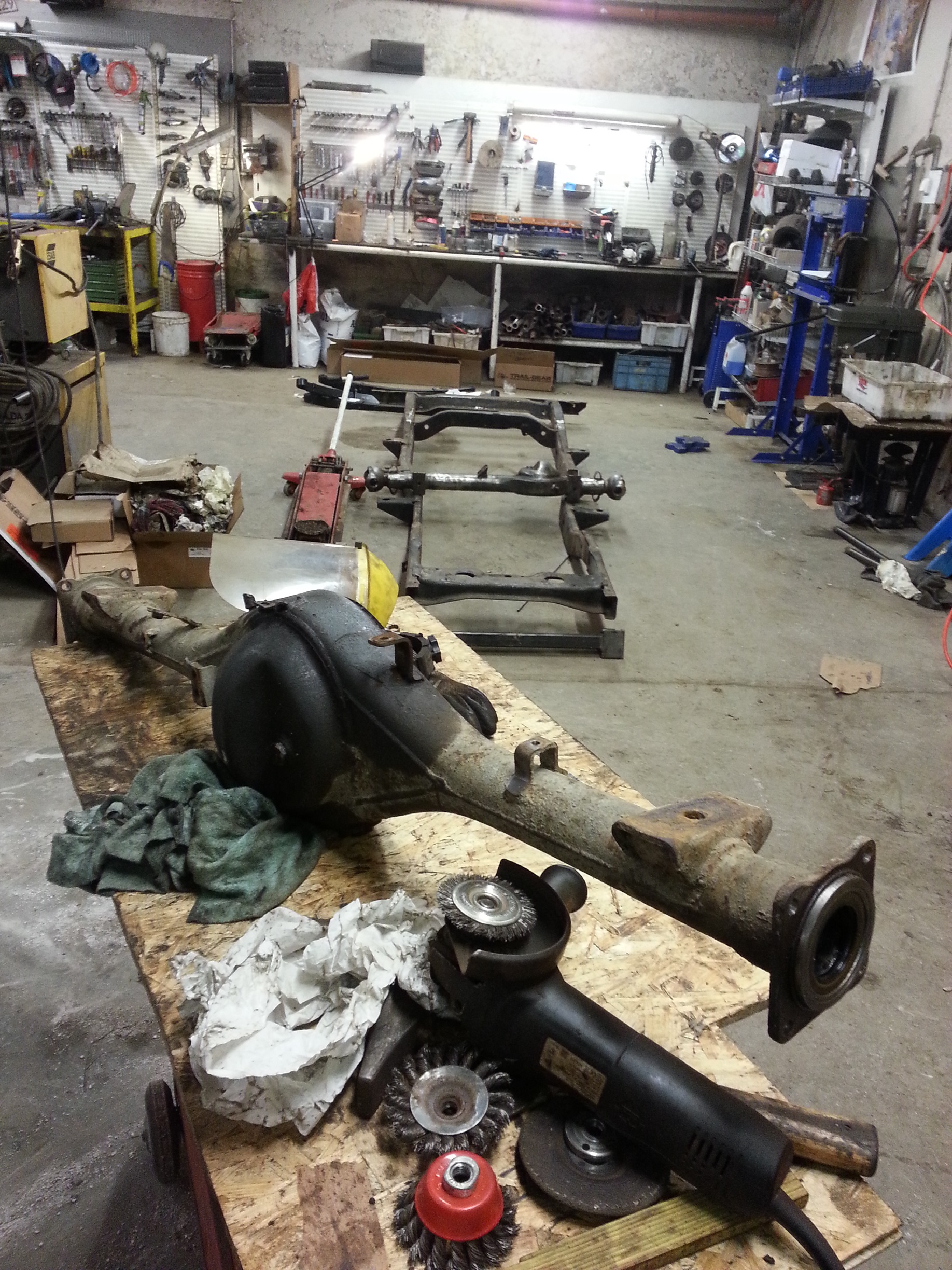

Hi, sorry that writing in English is not my strong side, well here is my project.
Hilux mk1:
Axles: Front hipinion 8 "4.88 long fields with ARB
Rear 8 "with China ARB
Engine: 2,4 diesel whithout turbo (coming later)
trailgear 2,5" superflex leafsprings
Histeer
Longsplines akselshaft ?
Frame mk 2 shortened
Attached Thumbnails Nordsmann mk 1 flatbed-20140210_182129.jpg   Nordsmann mk 1 flatbed-20150329_144025.jpg

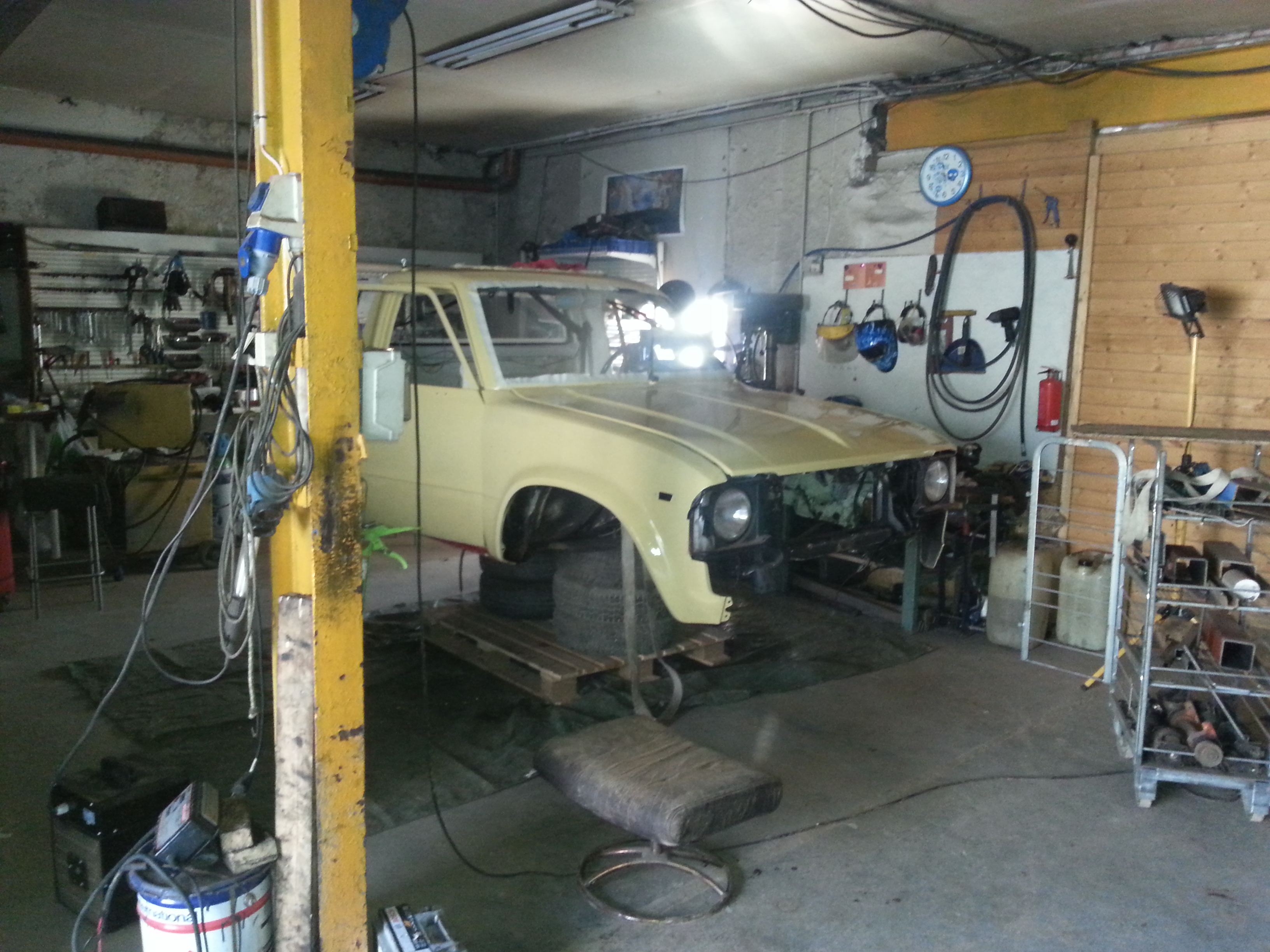

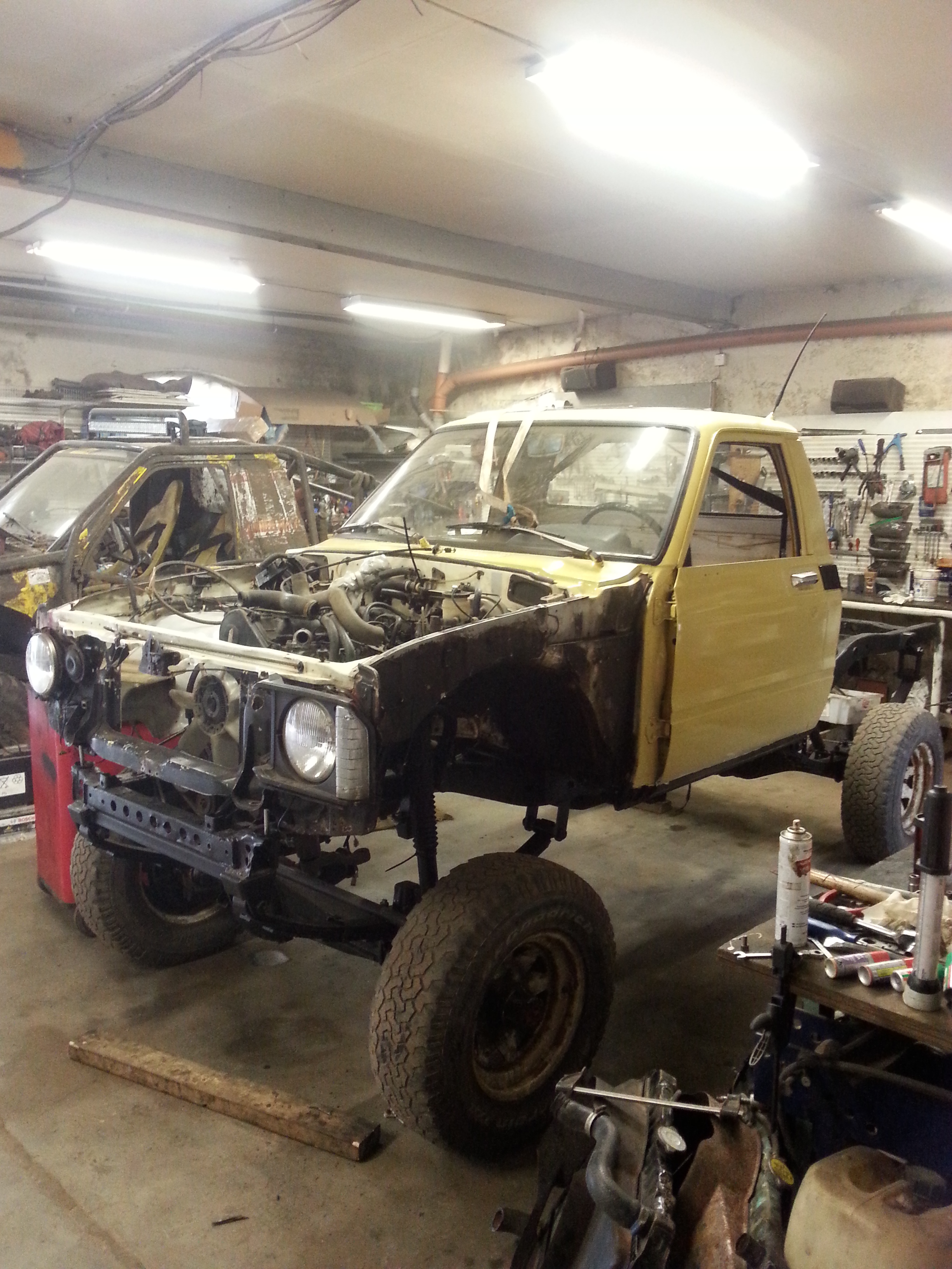

Well, my plan is to build the car for use in challenge competitions.I also hope to make it street legal, but i am living in Norway so i know its difficult .
I have painted the cab whith "yellow sand" well I think it is a little too yellow, but it is possible to paint it again i guess

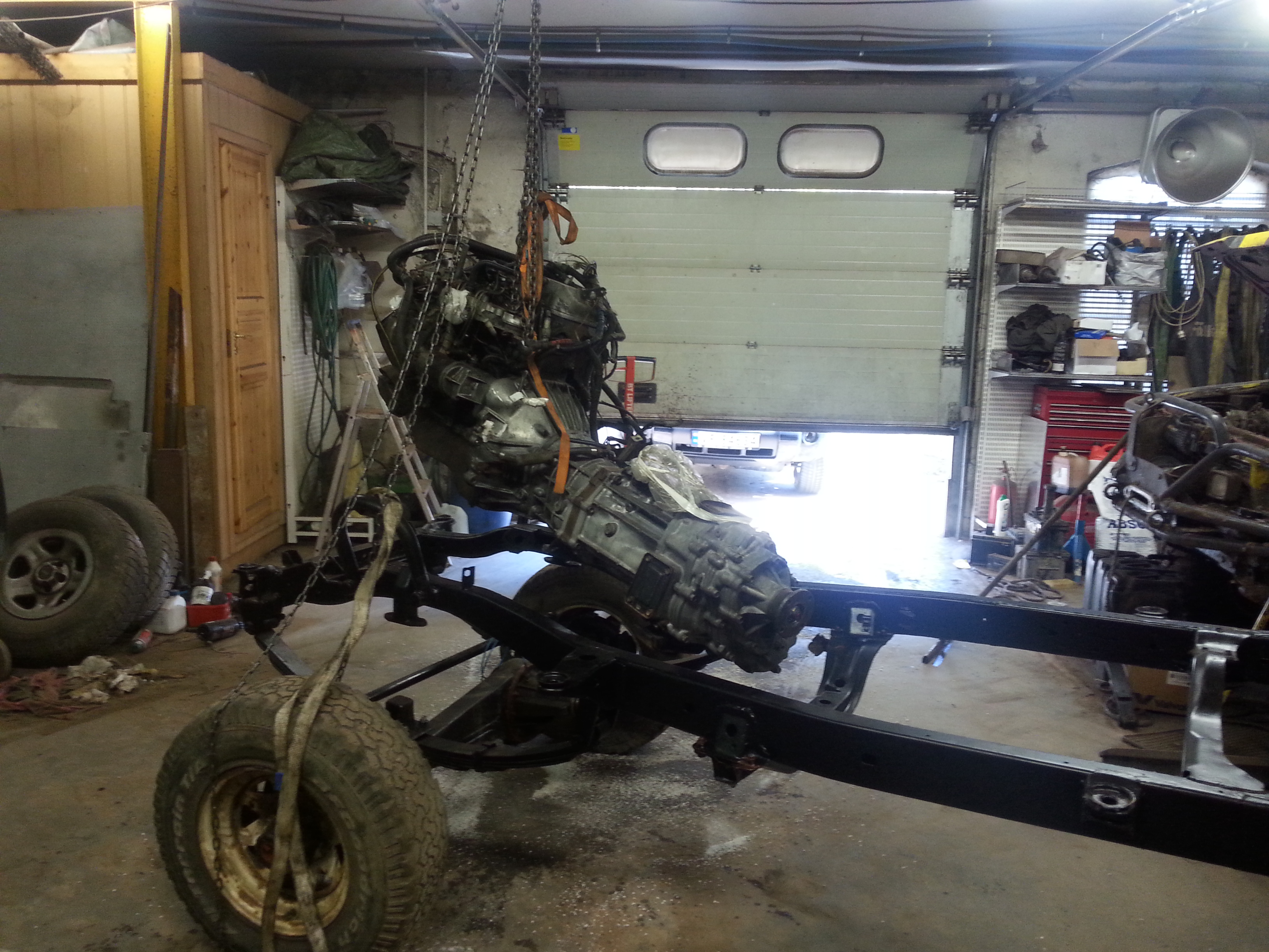

I have also welded most off the brackets on to the frame.
Leafsprings is mounted
Front aksel is completely overhauled.
I mounted the engine last weekend.
the next thing I have to do is shorten the rear propshaft ( the frame is shorten), and make a new in front ( i move the aksel 5 cm forward).
Attached Thumbnails Nordsmann mk 1 flatbed-20150401_134942.jpg   Nordsmann mk 1 flatbed-20150503_114605.jpg   Nordsmann mk 1 flatbed-20150503_145358.jpg

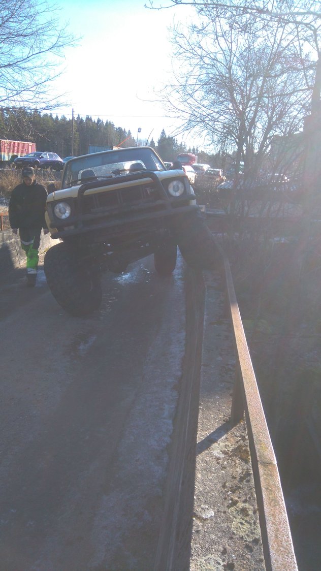

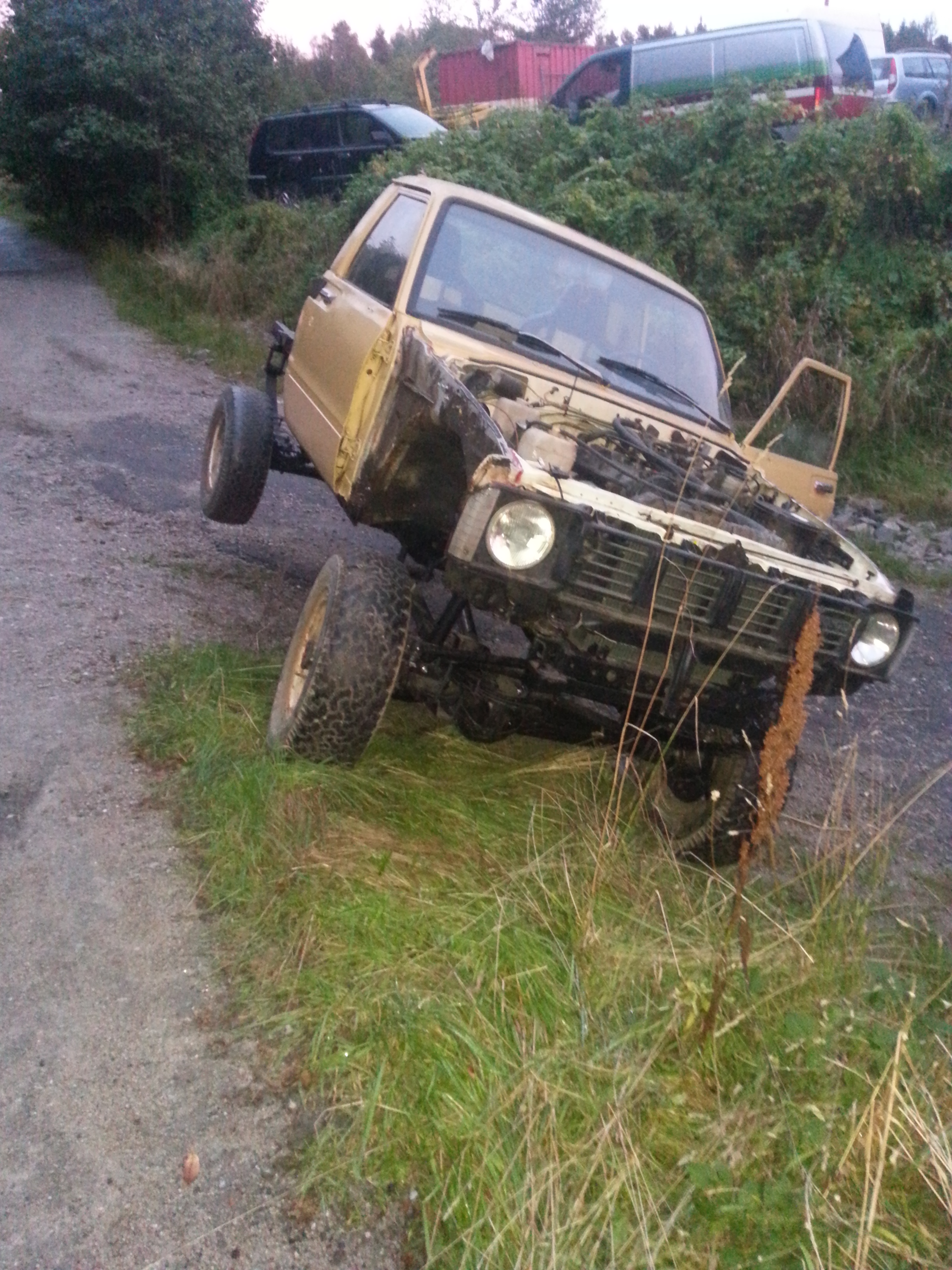

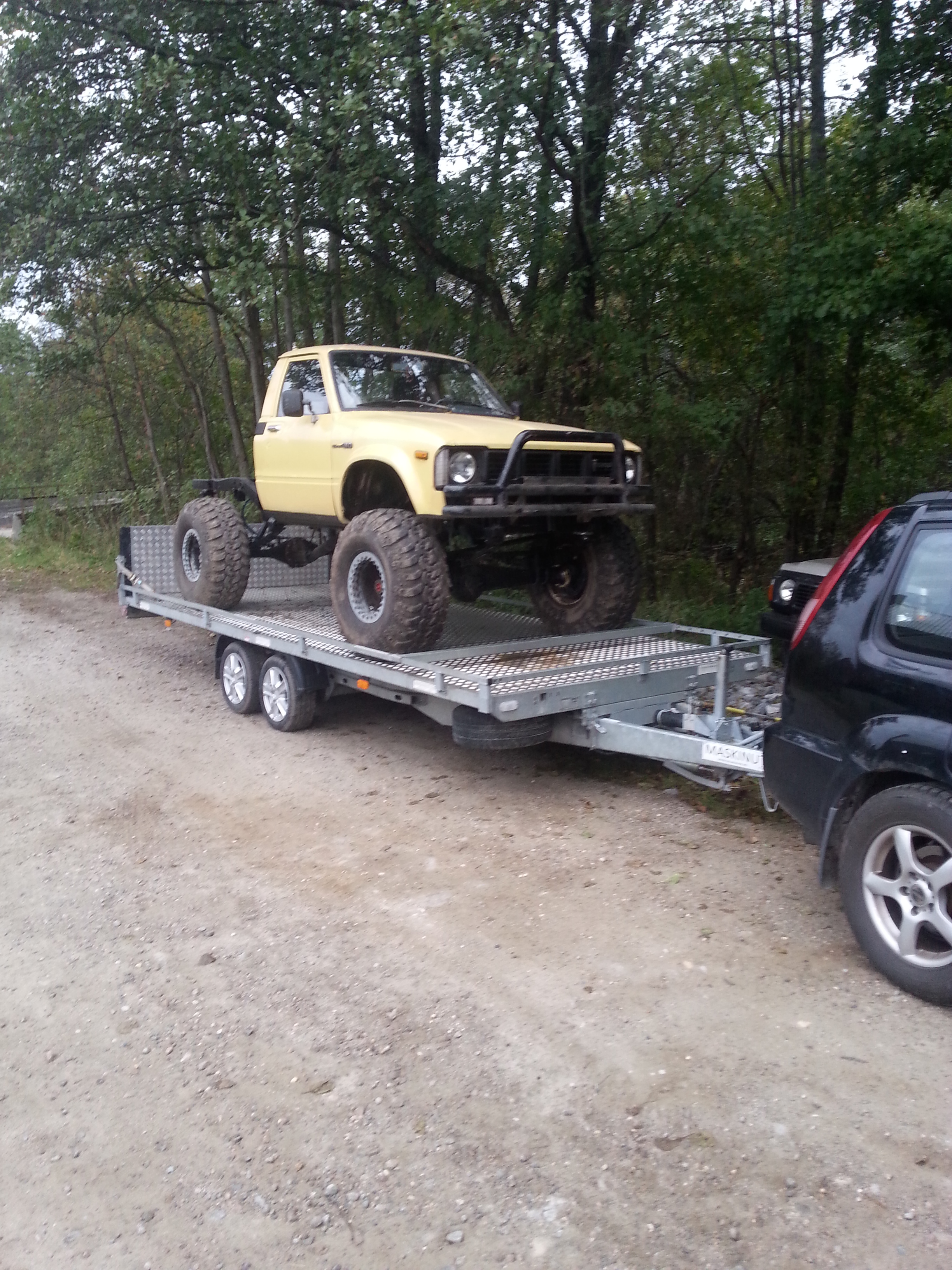

Hey it's been a while since I've been on the forum. Thought I'd post some pictures of what I've done since last time ..
As you can see from the pictures I've fitted tank across the frame for better clearance. Started up the car and tested flexibility, but found that the leaf springs are too stiff. More update coming later today or tomorrow ...
Attached Thumbnails Nordsmann mk 1 flatbed-202.jpg   Nordsmann mk 1 flatbed-203.jpg   Nordsmann mk 1 flatbed-201.jpg   Nordsmann mk 1 flatbed-187.jpg   Nordsmann mk 1 flatbed-20150920_192637.jpg

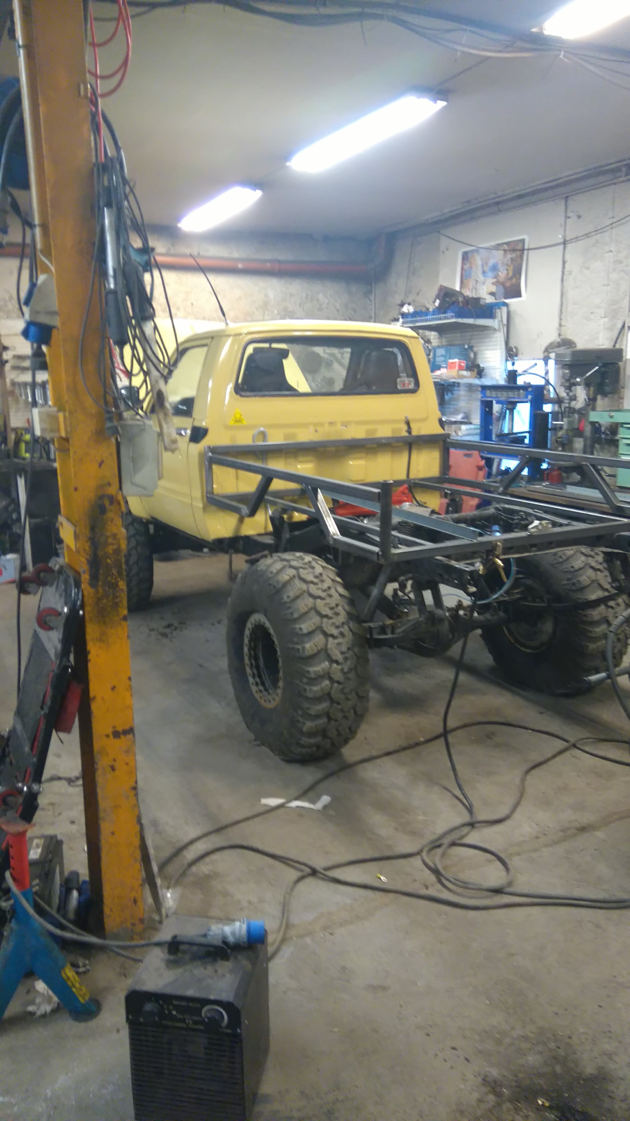

Took off two laefs in front and back. This helped a lot. Mounted on fenders and iroc`s,seats and put a lot off work with the electric, the cab has gaselectric so there were some challenge there.. took a trip into the woods to test, it felt good to driving again..
Attached Thumbnails Nordsmann mk 1 flatbed-185.jpg   Nordsmann mk 1 flatbed-343.jpg   Nordsmann mk 1 flatbed-345.jpg   Nordsmann mk 1 flatbed-20151010_084814.jpg   Nordsmann mk 1 flatbed-20151010_105748.jpg

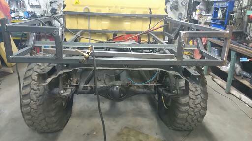

Well, now I'm almost finished with the bed. Thought it looked good with aluminum in fields.I have also built the rear bumper..Much work, but now it starts to look like a car..next step is to build an crib for the winsj.I like to hide the winsj under the bed..more pictures comming..
Attached Thumbnails Nordsmann mk 1 flatbed-330.jpg   Nordsmann mk 1 flatbed-153.jpg   Nordsmann mk 1 flatbed-313.jpg   Nordsmann mk 1 flatbed-327.jpg   Nordsmann mk 1 flatbed-342.jpg
Nordsmann mk 1 flatbed-030.jpg   Nordsmann mk 1 flatbed-028.jpg   Nordsmann mk 1 flatbed-027.jpg

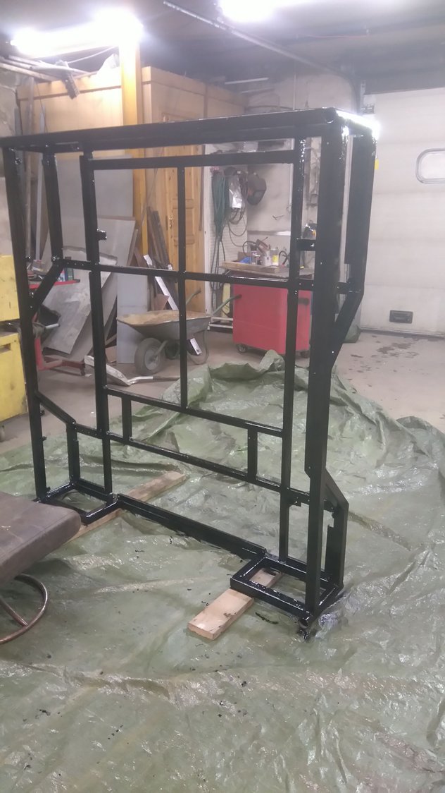

Here is update whith picks ☺
Fit the crip into the frame.Not shore its going to be strong enough..try it i guess.
Paint the frame black
Monting the aluminium.Notis the red thing this I can use to free out the whinsh
